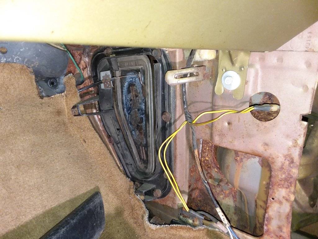

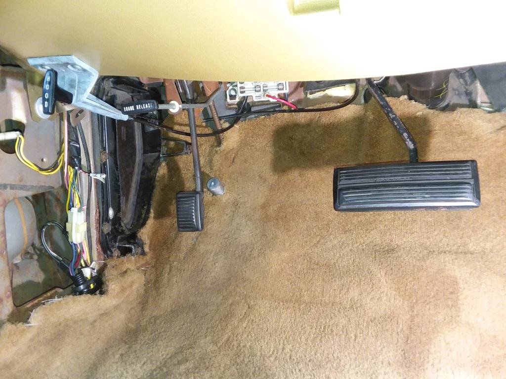

Kick Panel, right side

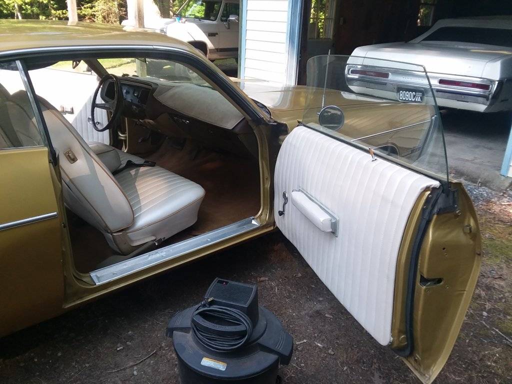

Remove the door sill plate (4 screws). Not too bad
and kick panel (2 screws)

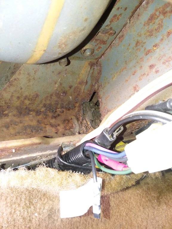

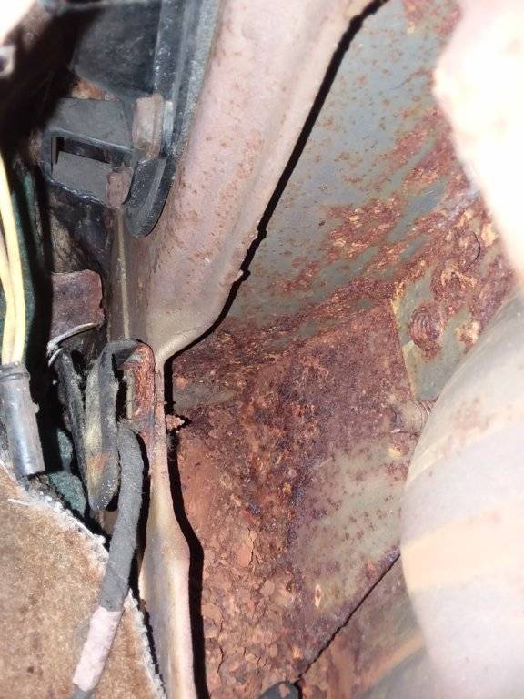

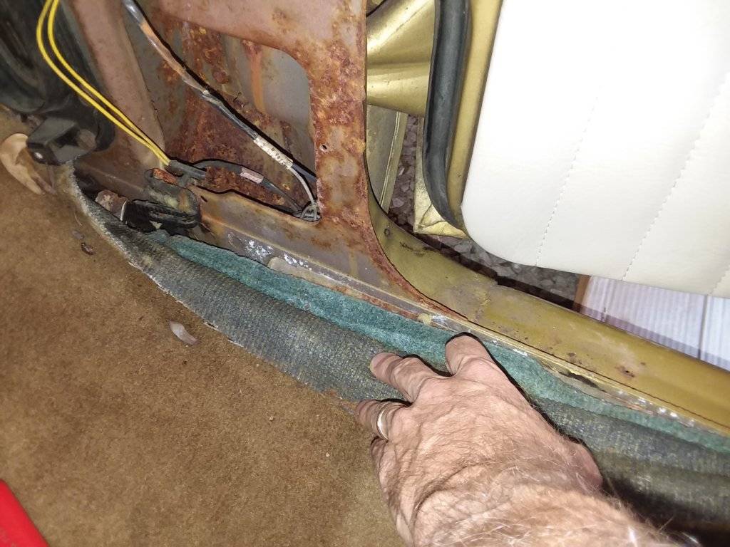

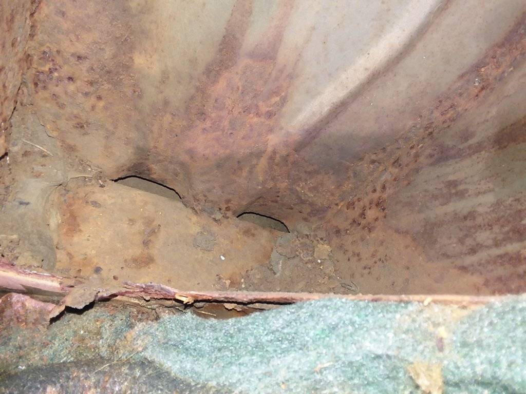

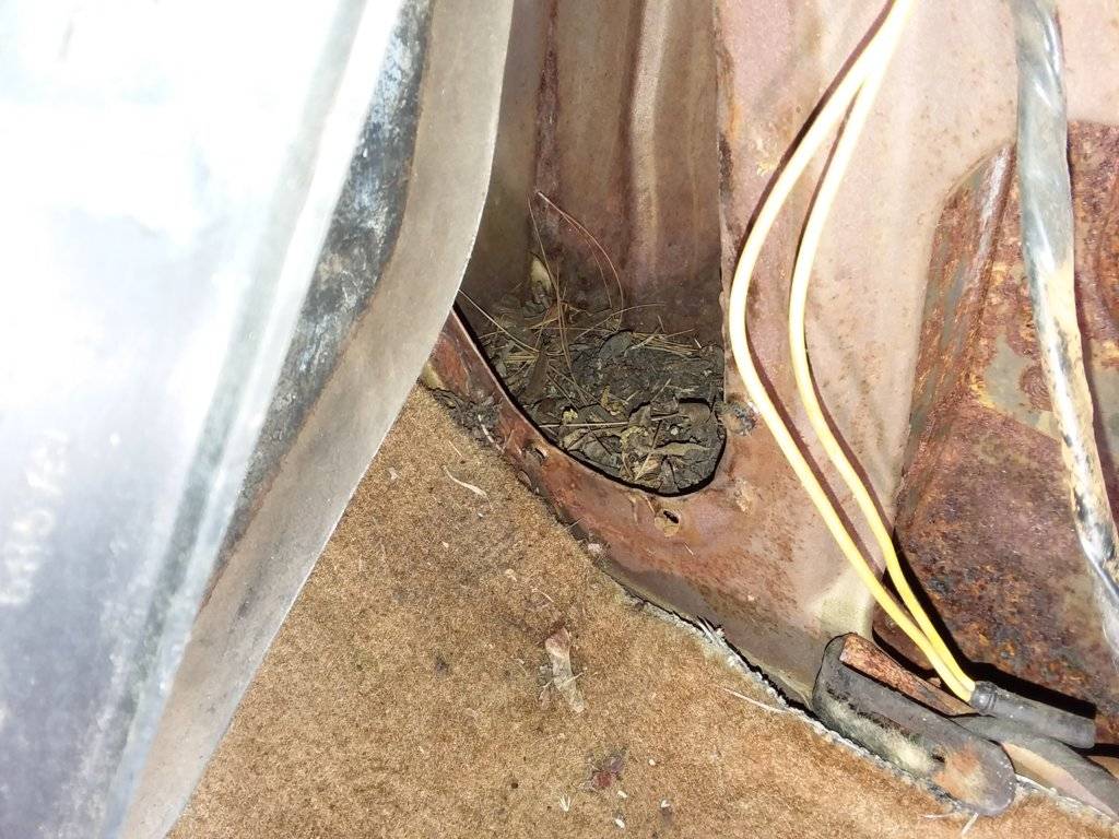

Lots of scaly rust in cavity behind vent door
Wet dry vac area

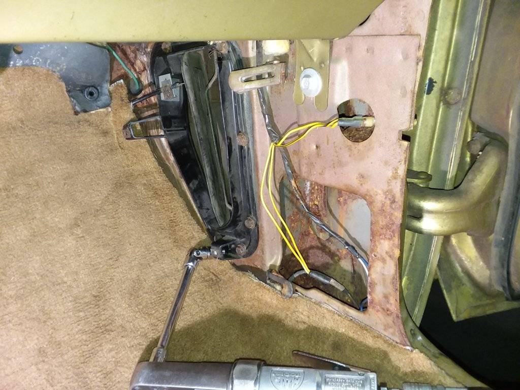

Pulled vent door assembly. Imagine what happened when all this stuff got wet from rain

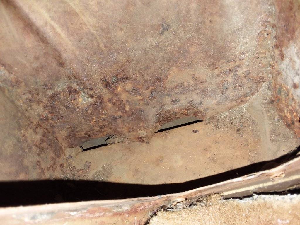

After first pass with wet/dry vac, thought things might be OK. Drain holes look good.

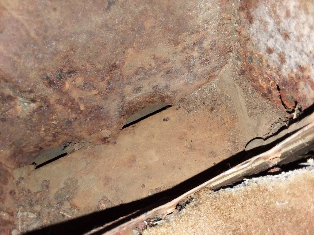

On 2nd look. Rust hole in the corner. ****!
Maybe I can buy some Eastwood Rust Converter, paint the area, and fix that with caulk. For now, need to put things back together. Vent door reinstalled, door open

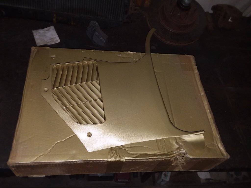

Paint on Kick Panel
Someone already cleaned out left side. 2 rust holes there. For now car stays under carport. I don't drive it in the rain. Will fix this problem eventually. Just wanted to do basic work to see that rust doesn't get worse.
Kick Panel LS
· Still rust particles blowing onto floor, after I drive on highway, especially. I must have misjudged the car being cleaned out in this area
· Door Sill Plate: 4 screws, Phillips head screwdriver. Kick Panel: 2 screws, Phillips head screwdriver
· Vacuum out cavity to rear of vent door cavity. Many rust particles vacuumed out. Big rust hole to vent cavity. Whisk broom and toothbrushes to break rust particles loose.
· Vent Door remove: 8 screws, 7/16 sockets & 3/8 Stub Ratchet. Mtg hole for lower rear screw is rusted out.
· Vacuum vent door cavity: vacuum, whisk broom, and tooth brushes. Hot sweaty job. Drain holes OK. Rust hole under Vent door frame.
· Vent Door: reinstall
· Kick Panel: install, top screw 1st. Door Sill Plate: install. I guess "Every Rose has its thorn," but still love the car. Just need to avoid driving in rain until I can get this fixed. Otherwise, wet carpet.

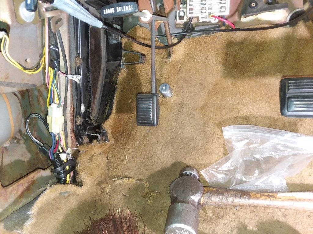

Test drove the car 66 miles to work today. Took the gamble of using the under dash cable and opening the right side vent at the kick panel. I had vacuumed the area, but apparently there was some stuff coming down from the cowl and at highway speed, debris blew out into my face and into the car.
Shut vent door quickly.
Consolation: car still ran okay and is a joy to drive. I just have a little more vacuuming to do.

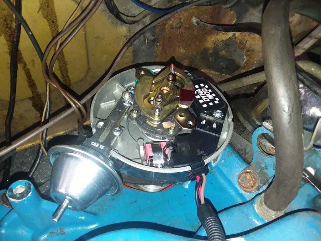

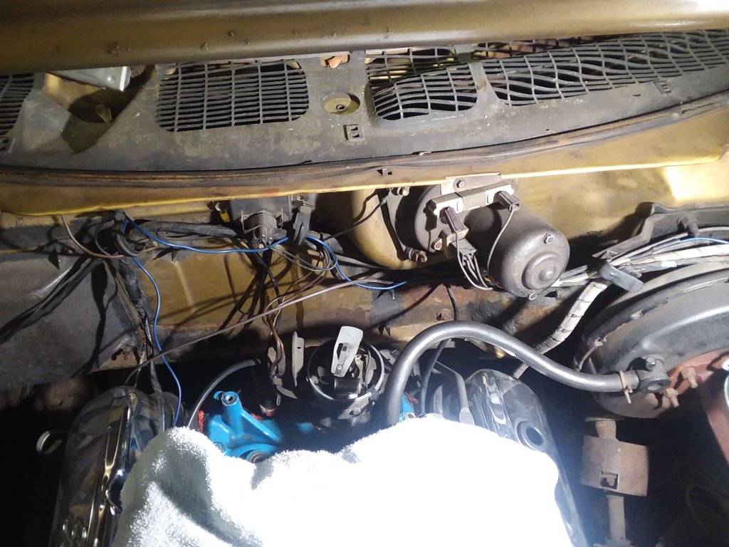

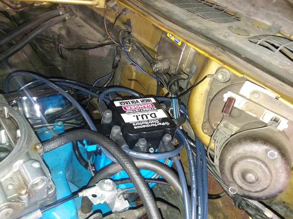

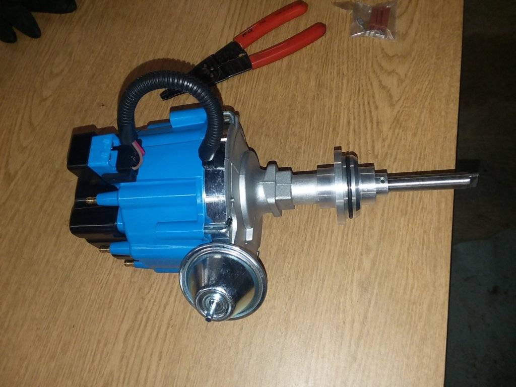

I decided I want an ignition upgrade. I had great success once before with 360 & Davis Unified Ignition HEI, so I went that way again. Original rotor position for #1 cylinder spark plug. I had turned the harmonic balancer Bolt, so that the rotor was in number one position and the timing mark was at 12° BTDC, since that was the most powerful timing that didn't knock with the old points and condenser system.
New Distributor

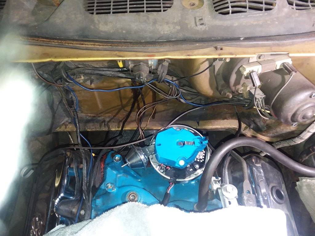

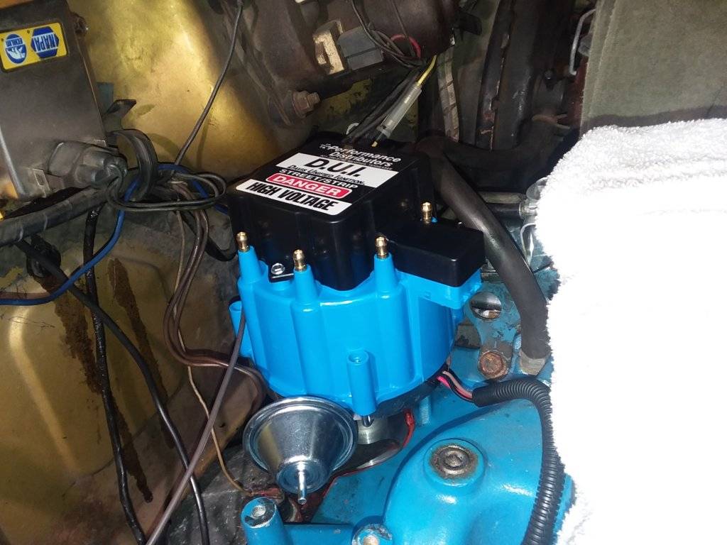

Installed. Ring of black arrows must lineup with points on reluctor wheel. That way, the pickup and reluctor are aligned. By the way stains on firewall paint are from a previous melted voltage regulator. Gotta figure out how to get that goo off without damaging the paint.
New number one position. The position of the rotor is significantly offset from the blade at the bottom of the distributors shaft. Usually, there are about parallel. But in this case there are 120° different.

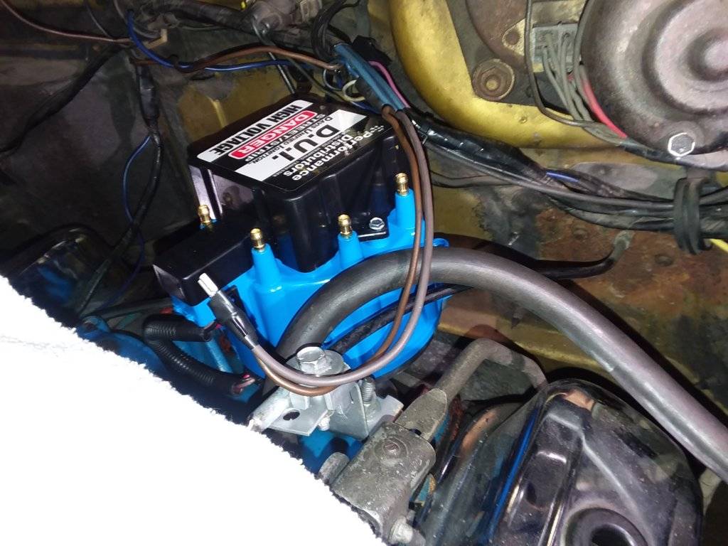

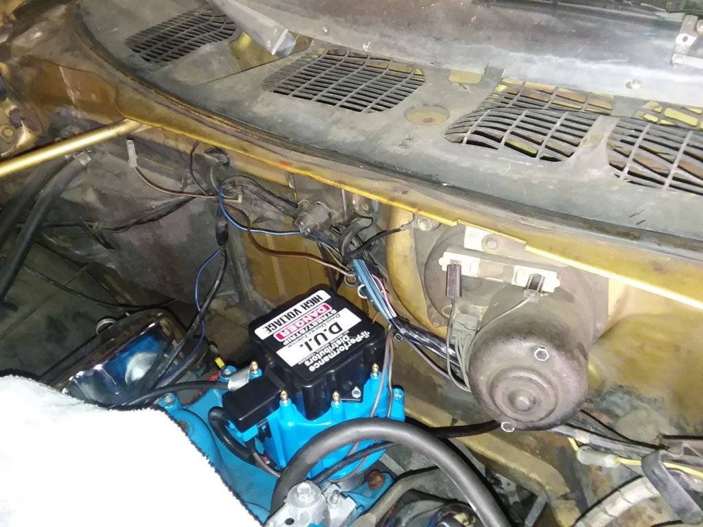

Cap & Coil Installed
to make this system work, you have to combine the 14 gage crank wire that went to the original coil with another 14 gage ignition on wire, which I ran from my auxiliary fuse box. So I made this connector and plugged it into the battery terminal of the coil. The advantage of the system is no ballast resistor, so it gets full voltage all the time, which is supposed to give a more powerful spark.
The end of an afternoon's work
New Distributor
Hey Ben, I noticed in the pic of the original distributor the rotor is pointing toward No2 cylinder, is that with the timing mark set to 12 degrees? If not, when you run the car, and check the timing, does the timing mark bounce around? To me that looks like either a loose chain or a slipped one.

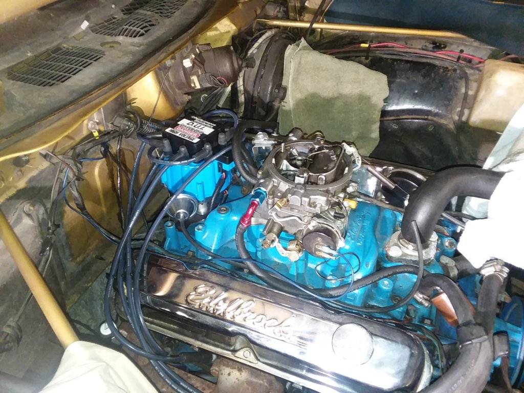

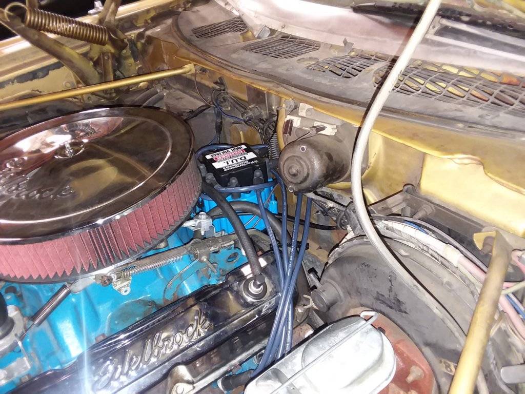

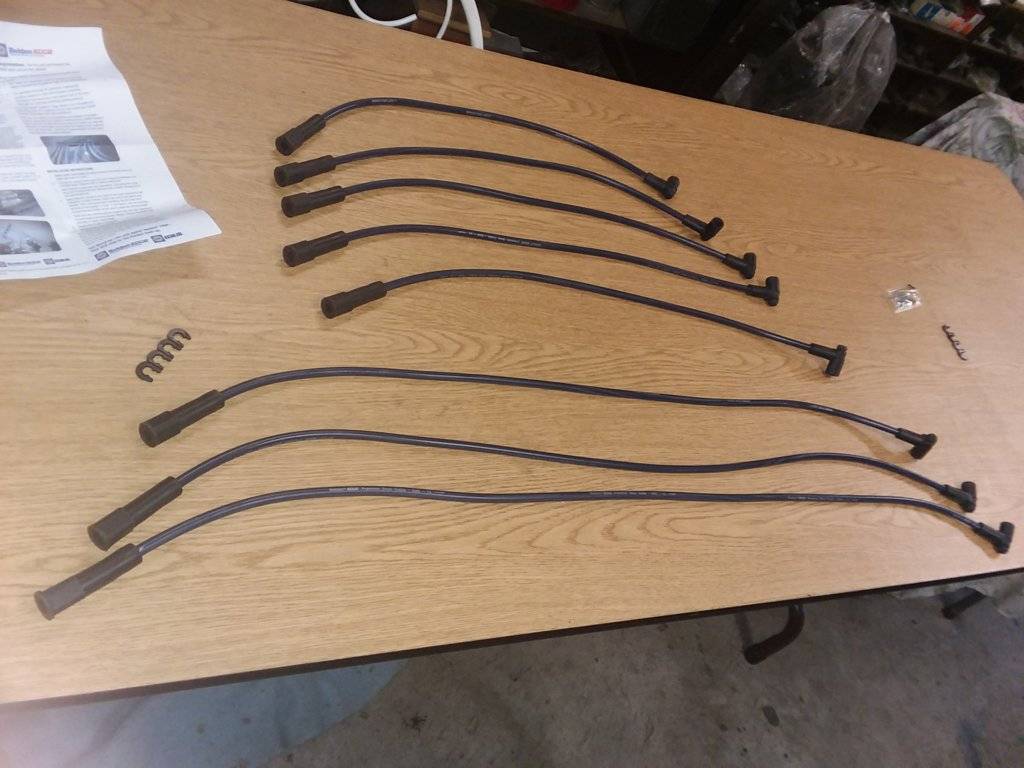

I had measured and used Belden 8mm Spark Plug Wire Set from NAPA before, so I went with that again.
Wires Installed
Other side
Full view
Air cleaner conceals somewhat
I had also opened the spark plug gap to .055
So what happened?
  1. Started immediately; let engine warm up
  2. Timing: I missed the sweet spot by 7 degrees because the arrows were aligned by eye. Advance from 5° to 12° BTDC
  3. Manifold vacuum now 17HG, excellent, first time I’ve had normal idle vacuum. I had 15HG before, which is a little low. Remove gage, plug port manifold vacuum
  4. Vacuum Advance: install hose to ported vacuum
  5. Check spark to each plug with timing light: #1 may have slight miss. Other 7 are OK
  6. Test Drive: Trans did upshift on acceleration, WOT, without letting off the pedal. Medium acceleration/throttle response is also improved. Idle is smoother. Probably will transition to a higher quality spark plugs, although my Champions seem to be doing OK.
Hi Gary. Yes, that is with the timing mark set to 12°. The good news is the timing mark doesn’t jump around, but stays steady when I adjust timing. I had someone rock the harmonic balancer bolt back and forth, while I watched the rotor. It’s hard to say, but there doesn’t seem that much slack. The car's got new paint on the timing chain cover. Not sure if the timing chain was replaced and if it was done right. The old distributor rotor did have some offset clockwise as viewed from the top from the blade at the bottom of the distributor shaft. Not much but enough that number one spark plug position as everything was installed was offset from a straightforward position into the position you saw. Still, I guess the timing chain could be improperly installed.
Easiest way to check is to pop off the drivers valve cover and bring the piston on number one up to the very top with both valves closed, then check the timing mark on the harmonic balance, that will get you an idea of whats what. One also has to check to make sure the harmonic balance isn't out as well since it has a rubber spacer between the inner and outer pieces, the outer piece can sometimes slip with age. I know, more work, and we are all allergic to work. :p
Harmonic balancers tend to slip.... DAMHIK.
Checking with valve cover off is only sure way to know.... worth the effort.
Was reading my FSM. Distributor drive gear slot was parallel to sides of car with #1 @ TDC. Not pointed at front left intake bolt. Suspect a new cam, maybe an Edelbrock cam, carb, intake kit.
My slot is off 15-20° (1 o'clock i guess) from the FSM in the 440, running a purple shaft, not degreed or anything, put in in the garage, lined up the dots, and away I went. Think it's the same in the 383, purple shaft unknow specs.
