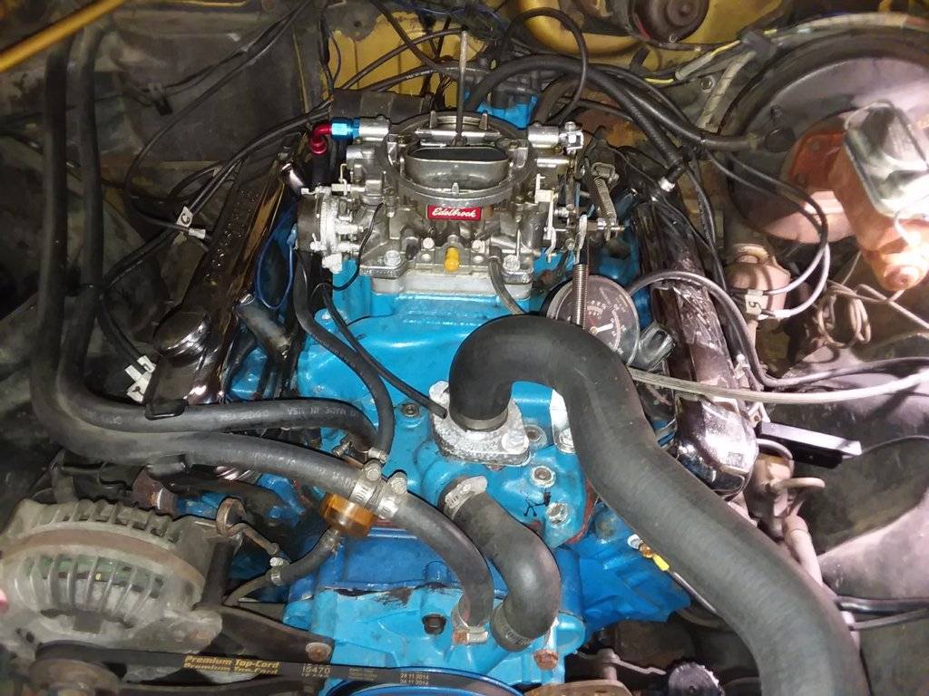

· I hooked up a vacuum gauge to the manifold vacuum port on the left front of the carburetor. I disconnected ported vacuum at the right front of the carburetor and plugged the port. Timing Light: I hooked up the green coil wire to the negative primary contact on the coil. I hooked up the positive and negative battery cable wires to the battery. I clamped the spark plug wire clamp over number one spark plug wire directly above the power steering gear.
· on starting and warming up the vehicle I found that idle timing was 5 BTDC with a dwell angle of 36°. The factory shop manual specifies a dwell angle of 30° to 34°, but I don’t think 36° is going to really hurt anything. I suppose there is a small chance of arcing and burning at that narrow a points gap, but I don’t intend to keep this ignition system that long so I decided not to worry about it. I had set the idle screws@2 turns out. Idle vacuum increased as I decreased the amount of turns out from 2.0 to 1.5
· I decided to advance the distributor, by turning counterclockwise as viewed from the top, to the point of Max vacuum. Using the Advance feature of my timing light, I found Max vacuum at 18.5 HG at 22° BTDC with 1.5 turns out on both idle screws. I test drove the car at this advance and found that I had a heavy knock on acceleration, which sounded like a hugely loose valvetrain.
· I thought the performance of the engine started to really feel better at idle around 15° BTDC, so I’m set timing at that level. Vacuum only decreased to 18 HG, so I was hopeful that I might’ve found the sweet spot for Max vacuum and advance. I was disappointed however to find that the car still knocked on acceleration.
· I reduced timing to 12.5° BTDC. On adjusting the idle mixture screws I found Max vacuum at 15.5 HG with 1.0 turns out. I test drove the car and finally had no knock on acceleration and the additional advance considerably improved acceleration at all different RPM and speeds.

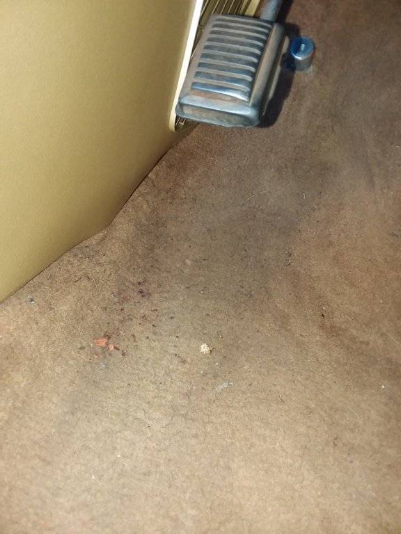

· Debris on Carpet: although the vent doors are closed, debris is coming out near both kick panels. On the driver’s side there’s a couple small rust holes below the vent door, and I assume the wind from traveling at 75 mph on the highway was blowing everything in the vent system out those through those holes, thru the kick panel grill, and onto the carpet. I haven’t pulled off the passenger side kick panel yet, but I think we can guess that the same thing is happening on the passenger side. Hope this will clear up with continued driving, at least until I can have metal work done around the vent doors.
· Some pictures of the great 1972 Fury III in the parking lot at work and debris on the carpet
Debris???? Looks like a little bit of dust to me.
I regularly (twice A year) loosen the rear bottom fender bolts and clean out the wells to remove leaves and other crap that the vac can never get.
I’d check for rust there too. Get it done before it’s too late. Bad rust spot on these and other mopars.
Great job on the time up.
Hi Javier. Thanks for the suggestion on the rear bottom fender bolts. Good idea! The debris has rust particles. That could stop the debris that is coming into the footwells. Unfortunately the left side already has 2 small rust holes. I totally cleaned out the area behind the vent door, but I didn't think about loosening the fender. Maybe run an old engine brush up in there. I was thinking that the junk might be blowing down from the cowl or passage between the cowl and vent door, but the wind could swirl it up from the bottom of the fender.

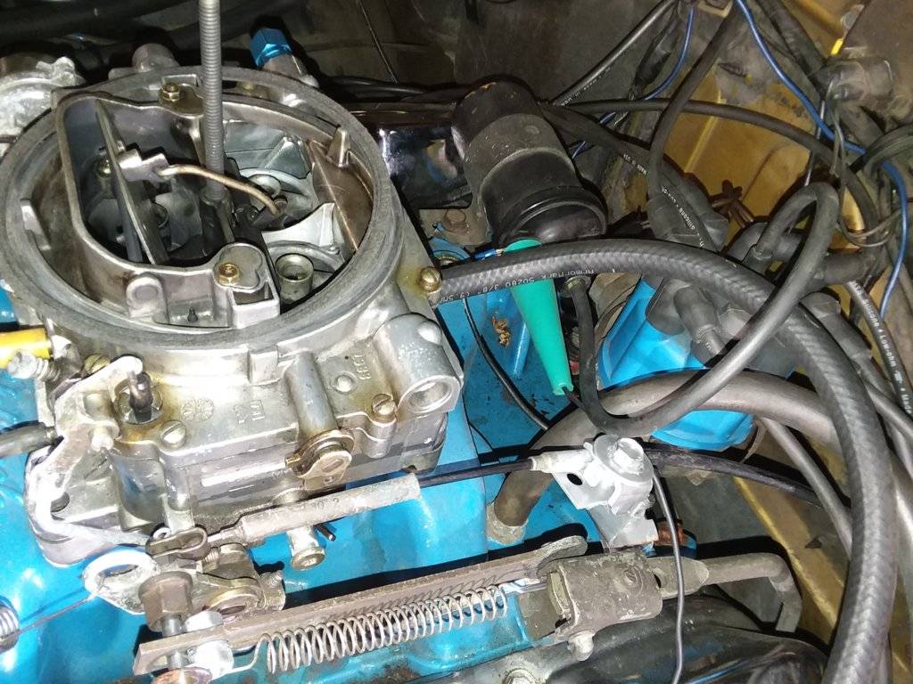

· I wanted to move the electric choke wire off of the ACC terminal of the main fuse box by setting up an auxiliary fuse box and running the electric choke wire off that fuse box. The auxiliary fuse box would then give me room to set up a radio and other electronics that I might want to add.

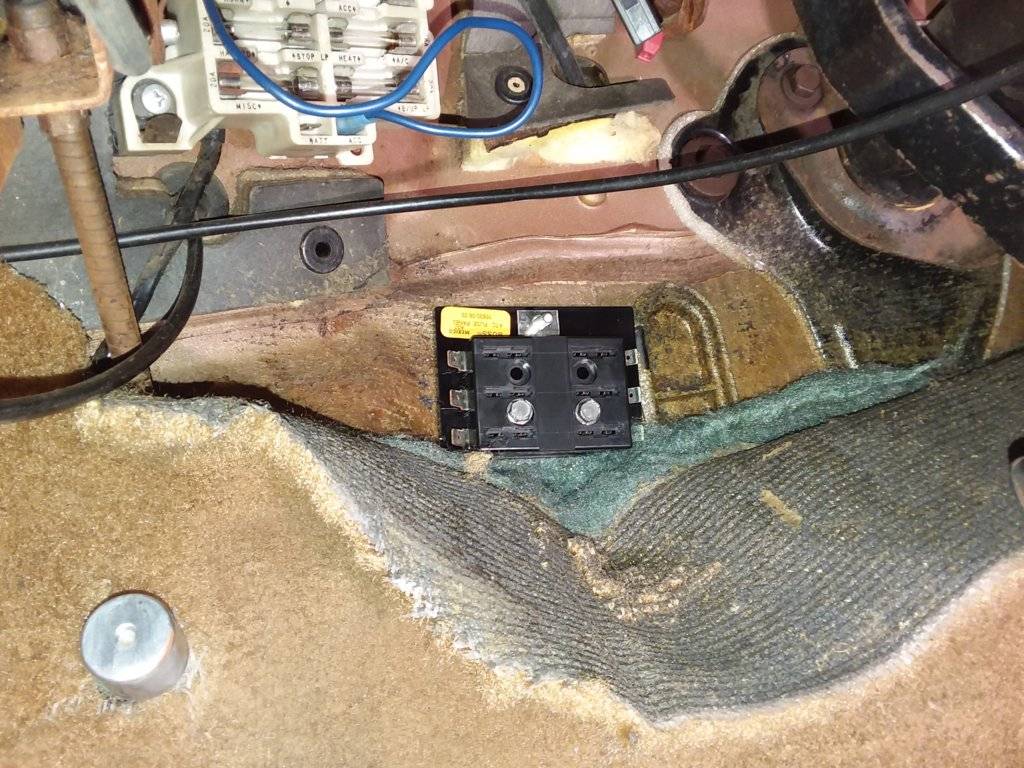

· I pulled back the carpet behind the brake pedal and just to the right of the main fuse box. I found an area behind the top of the carpet where there were no screws or wires. I checked the engine side of the firewall in the same area and found it to be clear of wires. I drilled two 1/8 inch holes, 1 1/16 inch apart, horizontal

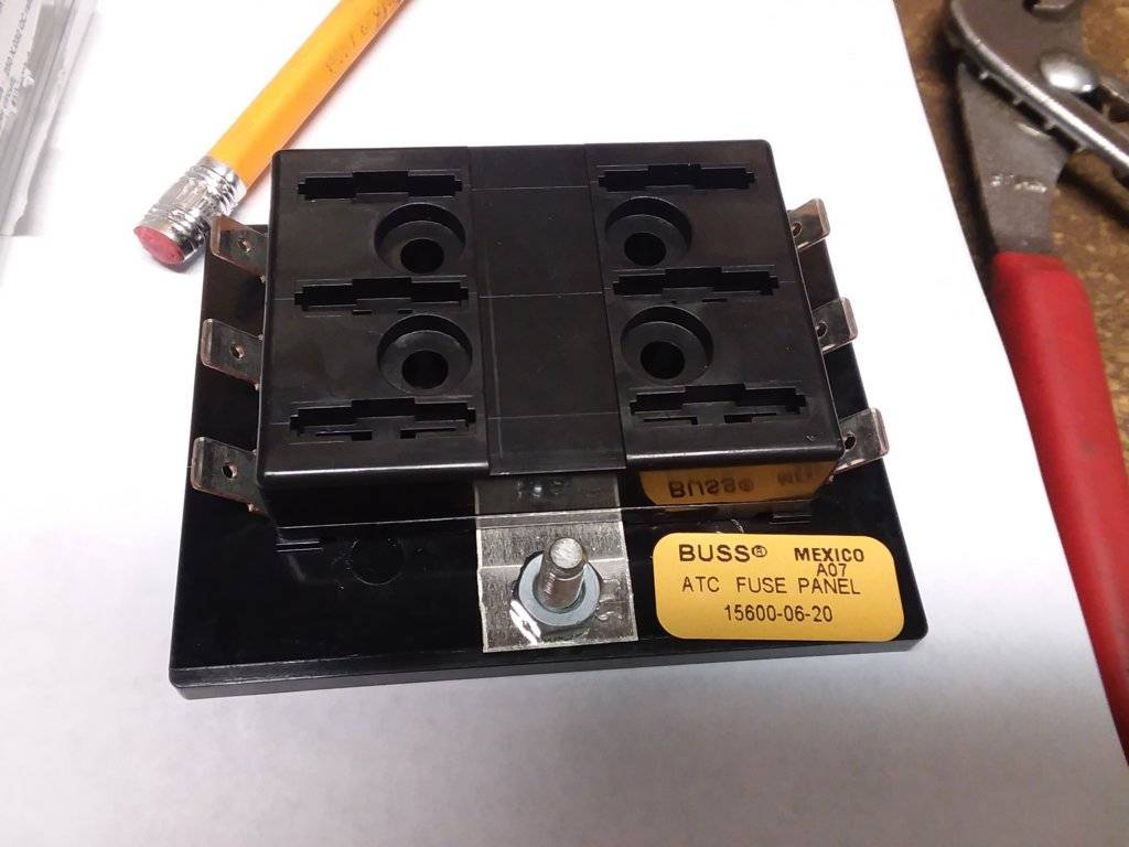

· Auxiliary Fuse Box, Bussmann 15600–06–20, Napa Balkamp 782 – 5316, 6 blade fuses, 6 spade terminals, 1 stud terminal for input. Mfr Description: "A single, common power input makes it simple to wire for multiple circuits - each rated to 20 amps (95 amps total per panel), up to 32 volts." $16.31 including tax, not a bad deal. Mounted aux fuse box with 2 screws, 5/16 inch long socket, ¼ inch socket driver.
· Wiring: I wired 6 inches of red 12 gage wire, spade terminal at ACC on Main fuse box, ring terminal at input stud for auxiliary fuse box, 3/8 inch long socket, ¼ inch socket driver.
· Electric Choke: I connected using a 20 amp fuse. The choke wire does have an in-line fuse, so I was really using the fuse just to make the connection. This is the reason that I went with max amperage.
Hmmmm. Fuse panel under the carpet....
I wouldn’t have done it that way but I guess it’s ok. After all, there are already a lot of wires under the carpet.
I might have looked at mounting it behind or just above the drivers kick panel. There are a lot of the system grounding wires to that area....And, it would have avoided the holes in the upper floor pan.
Please don’t take this as a criticism... your doing a great job! I just would have done it differently.

Hmmmm. Fuse panel under the carpet....I wouldn’t have done it that way but I guess it’s ok. After all, there are already a lot of wires under the carpet. I might have looked at mounting it behind or just above the drivers kick panel. There are a lot of the system grounding wires to that area....And, it would have avoided the holes in the upper floor pan.
Hey Javier. There's always a better way, and I'm always learning. On the kick panel, the area to the rear of the vent door has 2 small rust holes. Moisture might be a concern. OTOH, in the area where I mounted it, my feet won't hit, no evidence of rust, and nothing behind the firewall to hit with a drill bit. I could always revisit the issue and move it, but current location is convenient to a firewall grommet. Thanks for the constructive criticism. Ben

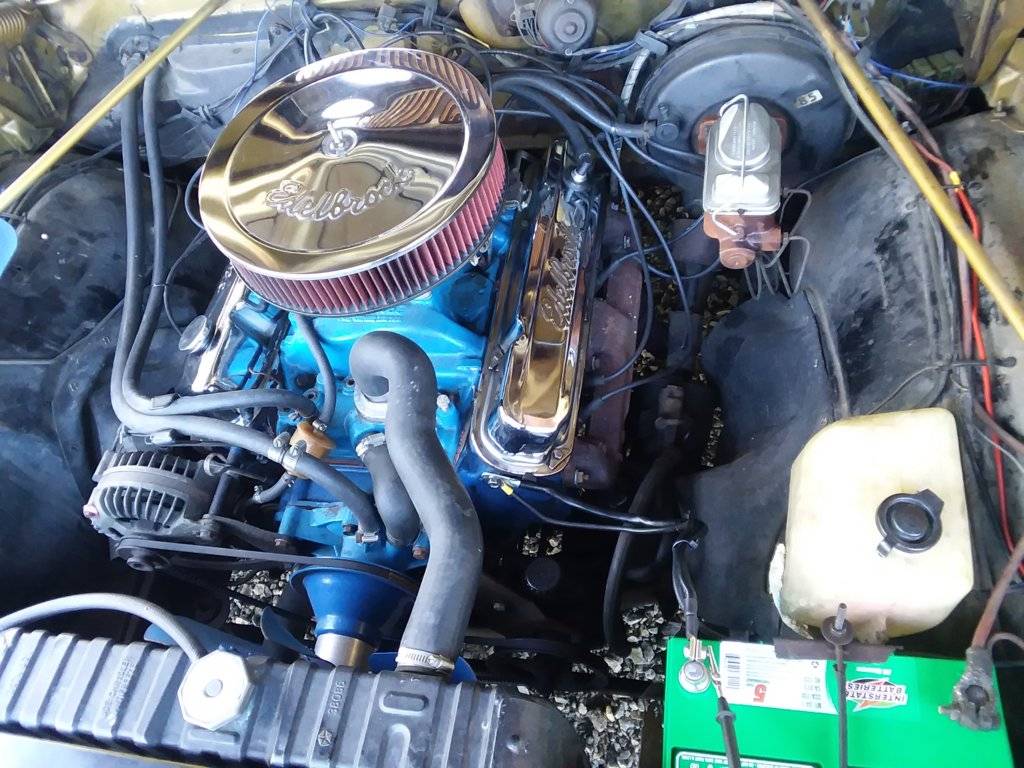

From the under hood shot, it doesn't look like there was anything left behind if there was a cruise installed at one time. I just can't think of anything else it would have been used for.
