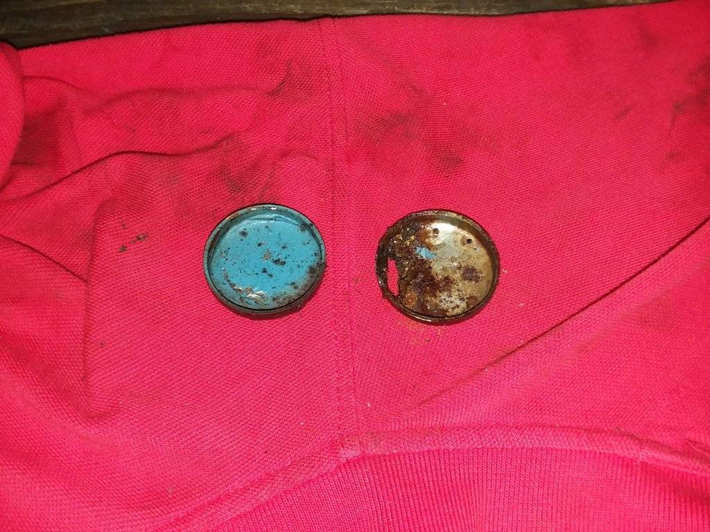

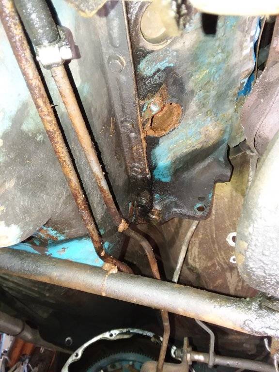

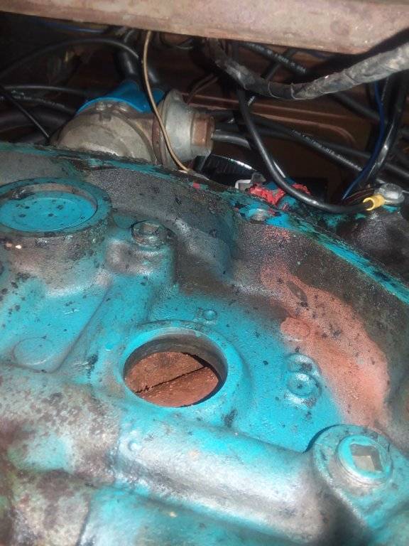

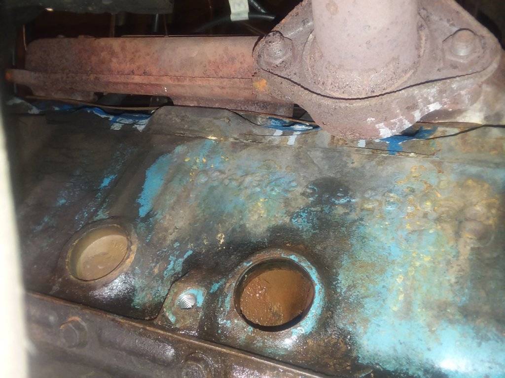

Leaker Removed. Right side wasn't bad. Left side had big glob of rust behind it.
Removed rear freeze plugs on side of block. More rust. Deposits at lowest point, farthest from water pump
After some clean out
Right: side of block
Right rear of block
Left rear of block
Left side of block
Yea you got the culprit on the LR Back there, IIRC the side fronts are a PITA cuz of motor mount.
Are you going to send the tranny out for a rebuild?
(Edit) are you going to attempt the Freeze Plugs in the heads?
Gosh, you are getting stuck into it, Glad to hear you are back on the road to recovery again., take it easy man.
I agree about the side fronts. Those and the heads are going to have to wait. They don't look too bad. Those lower rear freeze plugs get rust particles in back and weather damage in front. Hope the others will be OK for a while.

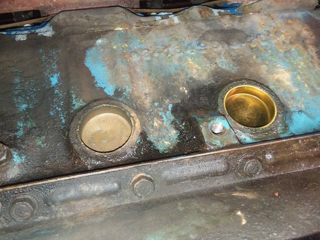

· 240 Grit SP: clean out each FP opening

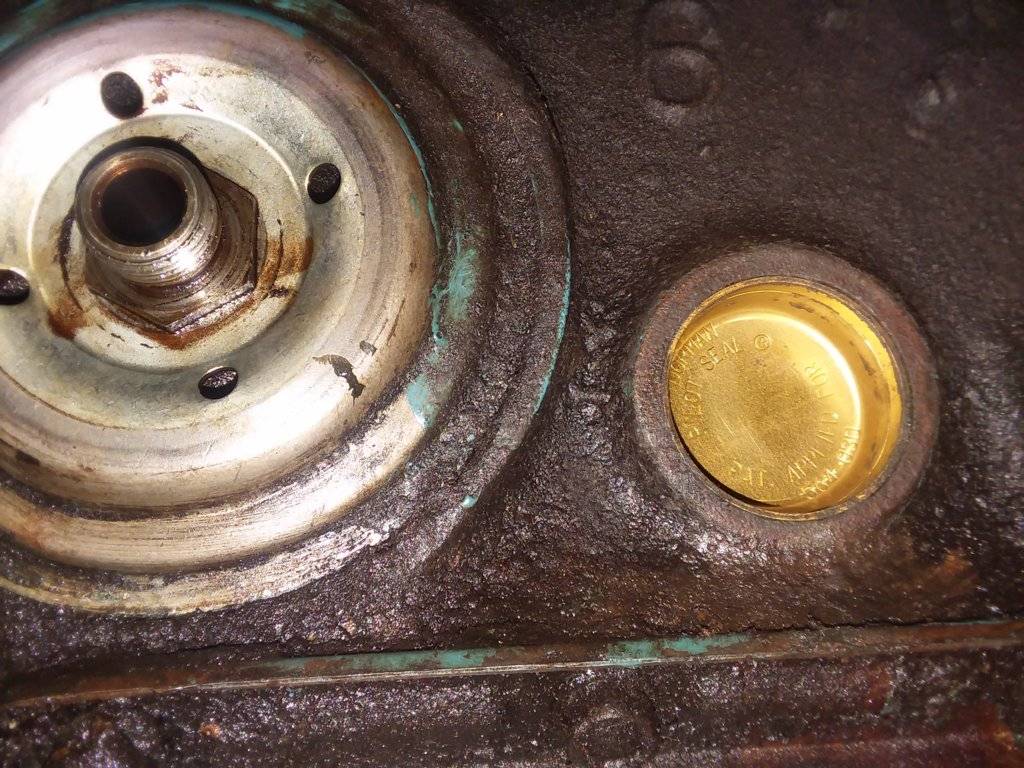

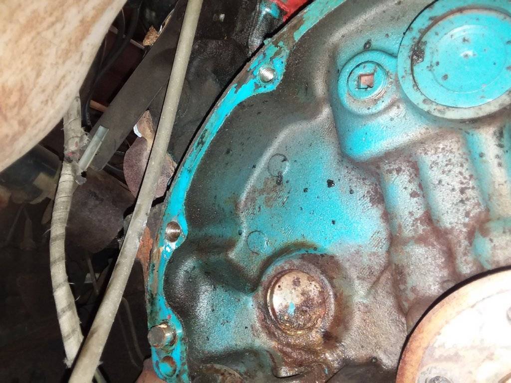

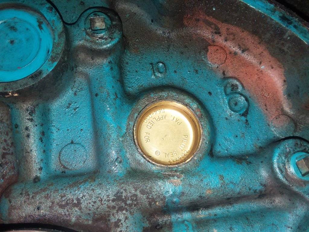

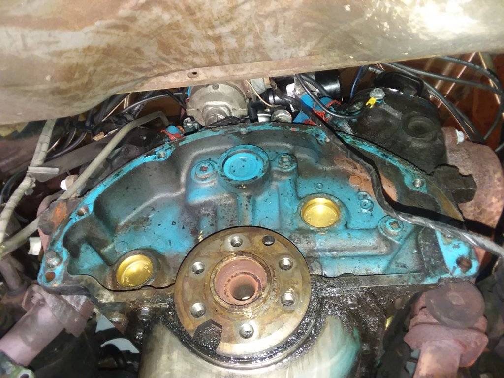

· Brass Freeze Plug Left Rear & Right Rear, side of block: wipe mounting area with clean white rag. Coat mounting surface with Permatex #2 Non-Hardening Form-A-Gasket Sealant. Then coated the mounting surface of the Dorman 1635C Brass Freeze Plug (mount on left side) with the same sealant. (I used Dorman HPX Pilot Seal brass freeze plugs from an old kit for the other 3 replacements. Seals with an outer rib, instead of whole side of freeze plug, Don’t like these as much) I used two ½” extensions, 10” & 6” long (15” total length), duct tape over extension end, and NAPA 48 ounce sledge with Proto 2314-4 driver to drive freeze plugs in, impacts outer lip of the freeze plug. I stopped when the front of the driver was flush with the side of the block.
Left side. Someone already replaced the center freeze plug
Right side
Brass Freeze Plugs, Left Rear and Right Rear @ rear of block: same process except ½” extension, 3” to drive freeze plug into block.
Left side rear, Looks like it was seeping for a while.
Right rear: rib below freeze plug opening interfered with with proto driver and outer edge of freeze plug being totally flush with block. Used 2” square piece of metal laid flat against edge of freeze plug to hammer flush.

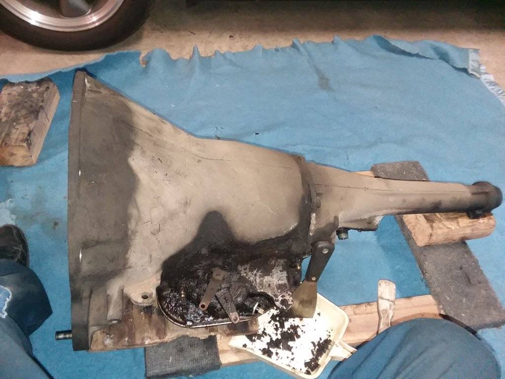

Trans Ug: clean up started
Trans: less slime

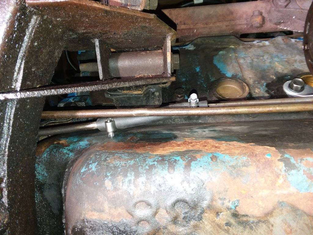

Left Side

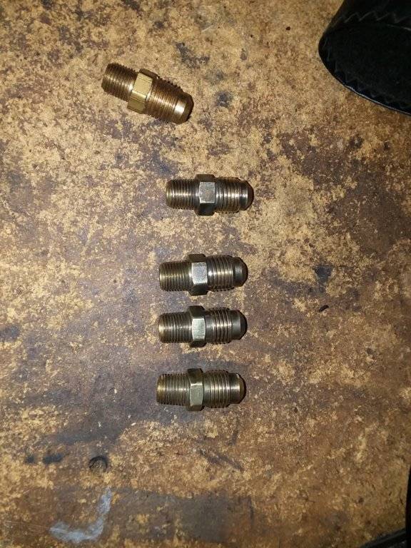

Bent Front Cooling Line Fitting is on bottom in Pic. Reason for greasy left side. I replaced with a spare straight fitting

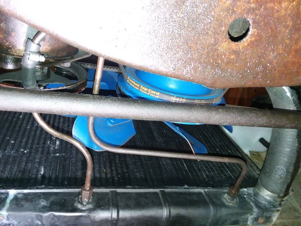

Cooling lines
Someone had cut front outlet line but not flanged the cut. I double flanged both ends. Just showing difference. Expect Cure for big puddles under cooling lines. No rust holes in either line.

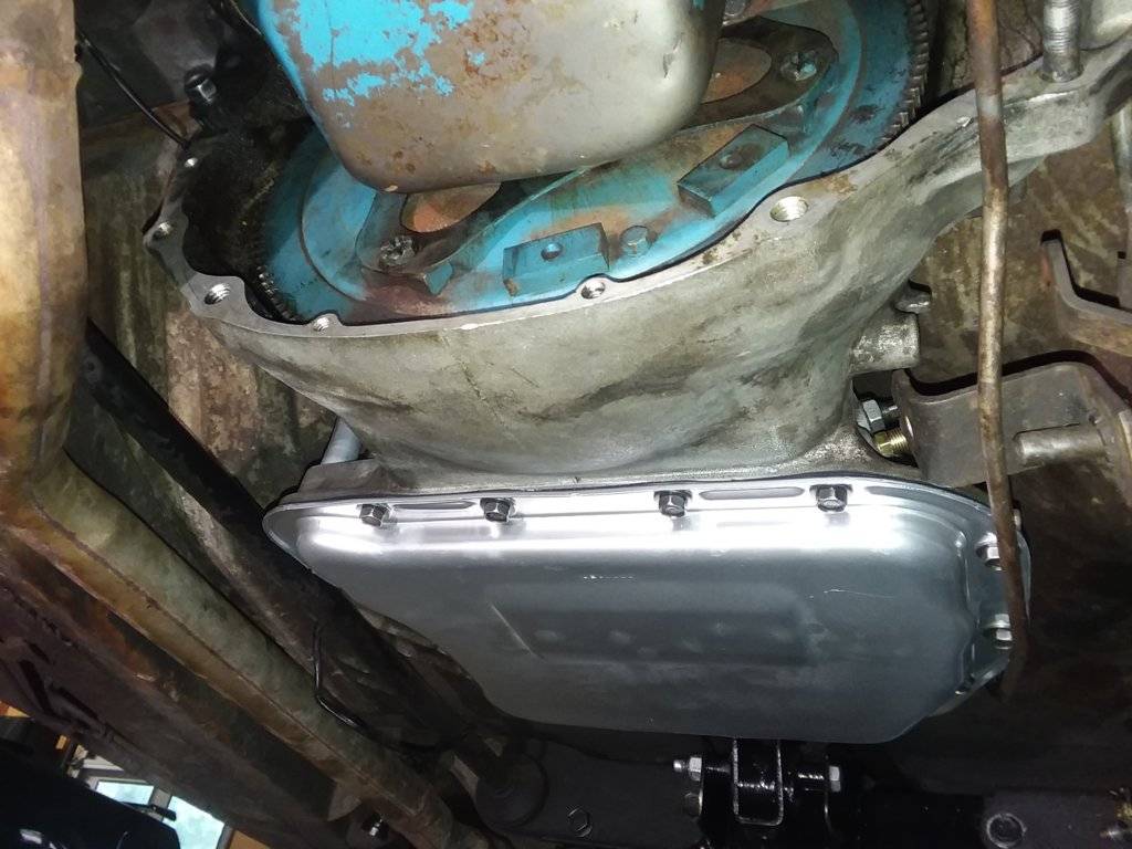

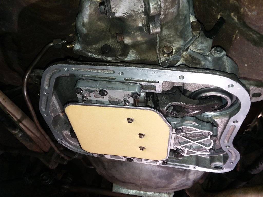

Time for Filter Change
Trans Pan after clean up. More silver paint
Other side

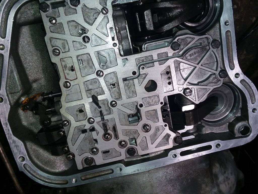

Valve Body
NAPA 1-7957 Filter Kit

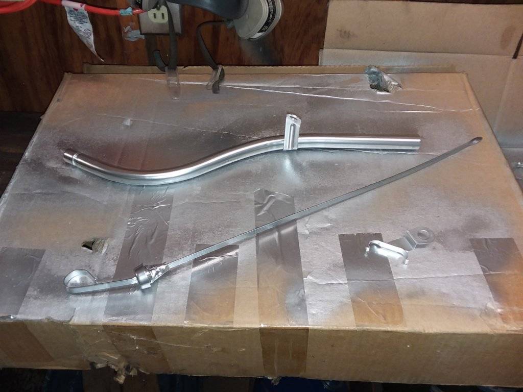

Dipstick Tube: NAPA 1-3901 o-ring and gray Permatex
Pan Installed 150"lbs, Torque Converter to Flex Plate 270"lbs

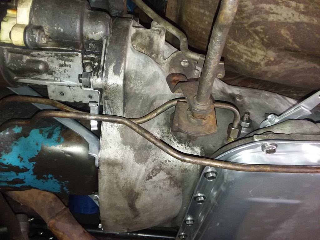

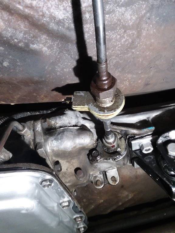

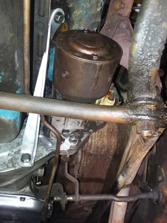

Some more progress at front of trans. Driveshaft is in too.
Trans Finale
Shift lever at trans
Cooling lines at shift linkage bracket
Kickdown linkage installed
Cool factory diagram to help us get it right the 1st time
Shift linkage: rod from bracket to lever at trans

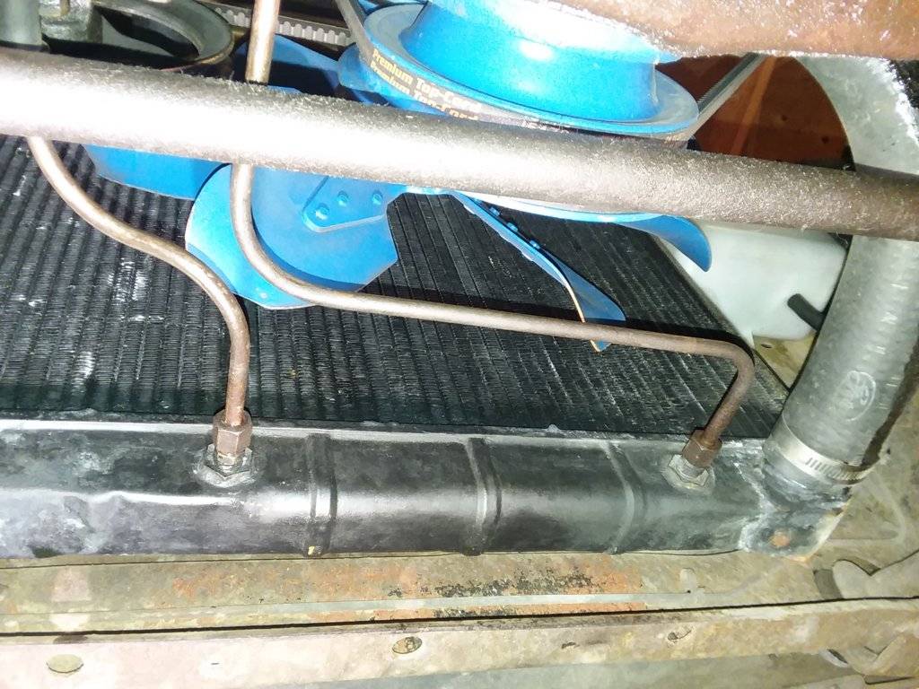

Cooling Lines at radiator
1st hose I had to replace. Double flared both line ends
2nd hose I had to replace. Double flared both line ends

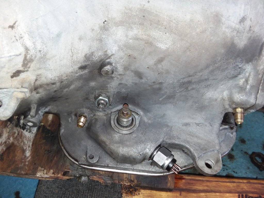

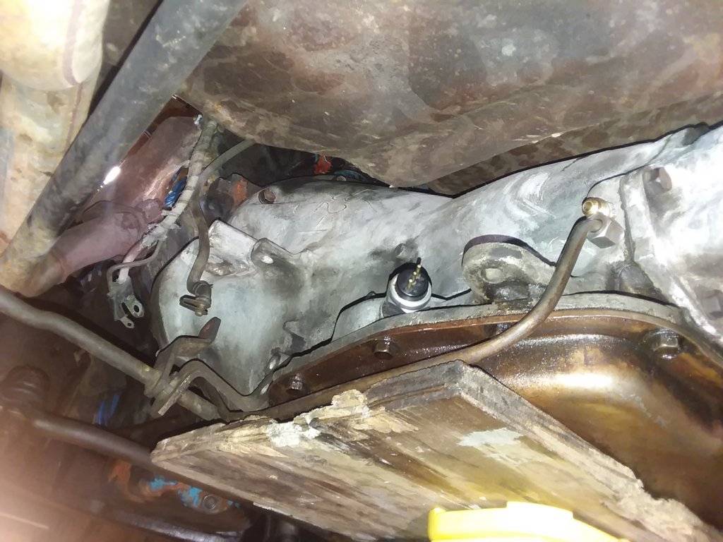

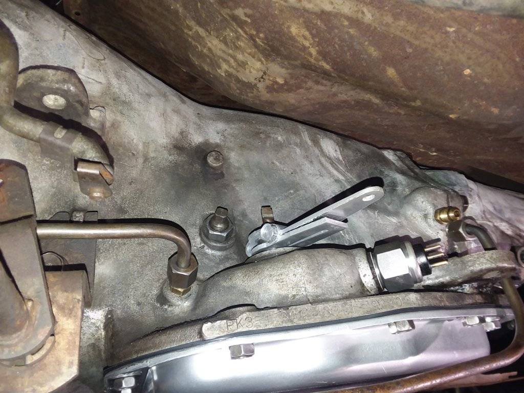

· Speedometer Cable, removed from electronic speedometer adapter, using 1 inch wrench. Adapter: removed at transmission housing, using a rag to insulate the connector from my channel locks. Speedometer Cable: installed on transmission housing, using 1 inch wrench.
· I drove the car again to work. Starting mileage 91646. The mileage on my return home was 91,713 miles. The Google mileage to work is between 67 and 68 miles. The mileage on the odometer for the trip without the adapter is 67 miles. The adapter is unnecessary. Recycle bin.
· Bonus: Without the adapter, the speedometer needle was more steady.
· Cooling System: I drove home with the temperature of 91°F outside. Another positive is that the car did not overheat. 22"Radiator, no shroud.

Was the adapter an aftermarket item, and what was its intended purpose?
