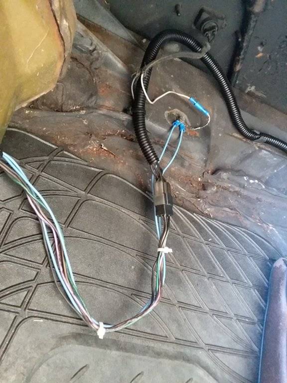

I set up the taillight housings in the trunk using jumper wires for ground
Started car
Headlights, Taillights, Turn Signal Lights, Reverse Lights, Brake Lights: all working!
Windshield Wipers, Rear Defrost, Heat & Fan Blower Motor: all working!

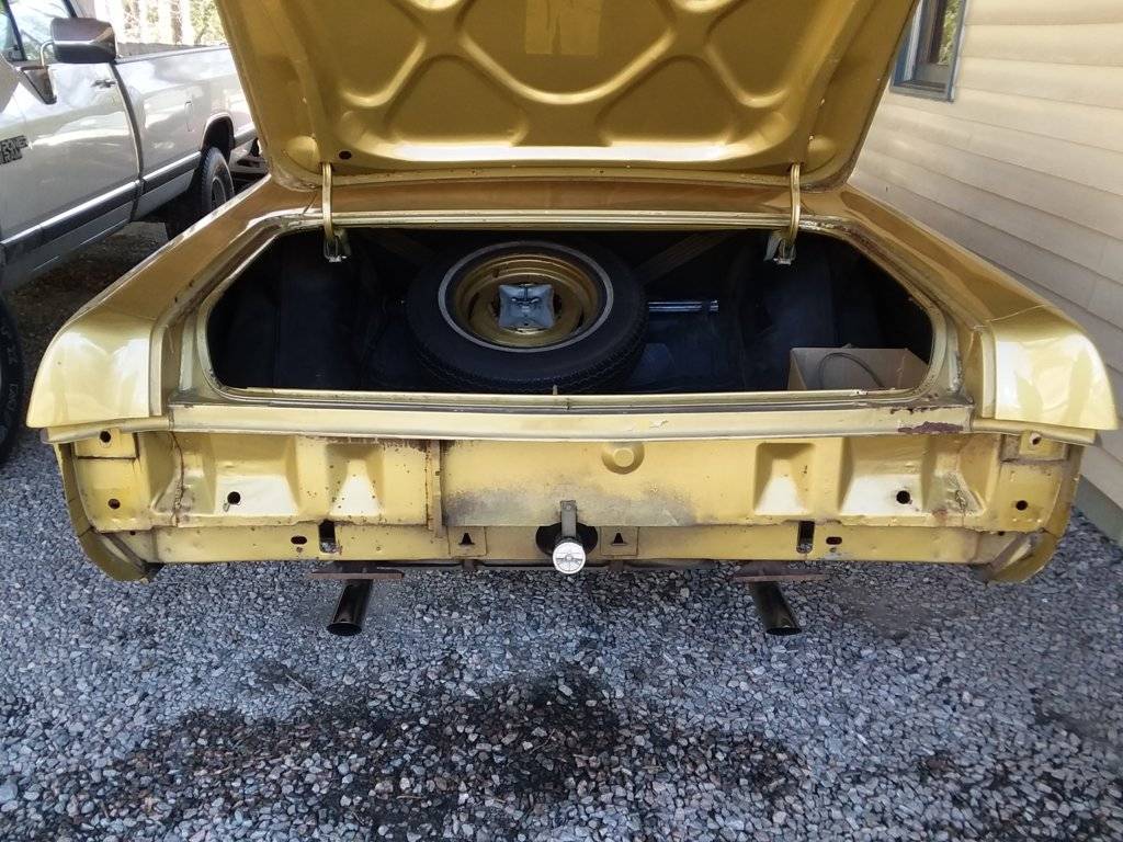

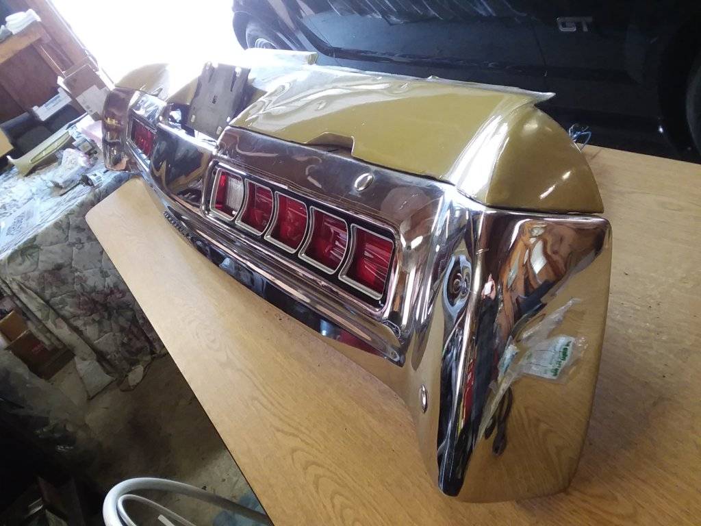

Worked on installing taillights and wiring on rear bumper for rest of day
Left side (Mustang in Background, 2005 Made in USA)
Right Side
Center
Rear bumper is not a finished product, still on my workbench, but I posted pics because I've never seen these views on a 72 Fury rear bumper.

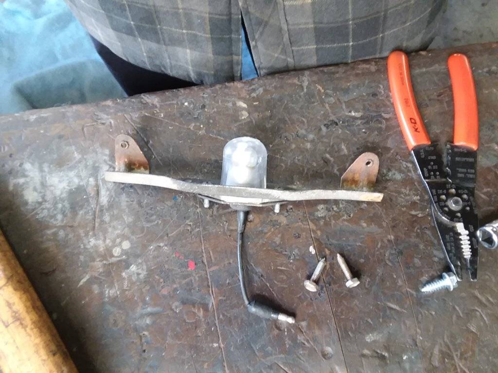

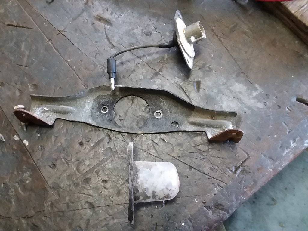

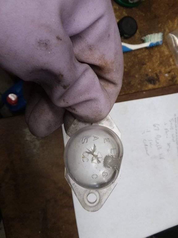

Cleaned license plate lens and sprayed socket with WD40. GE 67 bulb, old, but in operating condition
Use Turtle Wax Chrome Polish to get the rust stains off the lens

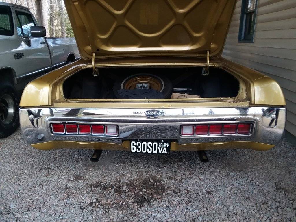

Installed bumper assembly with help from 2 assistants

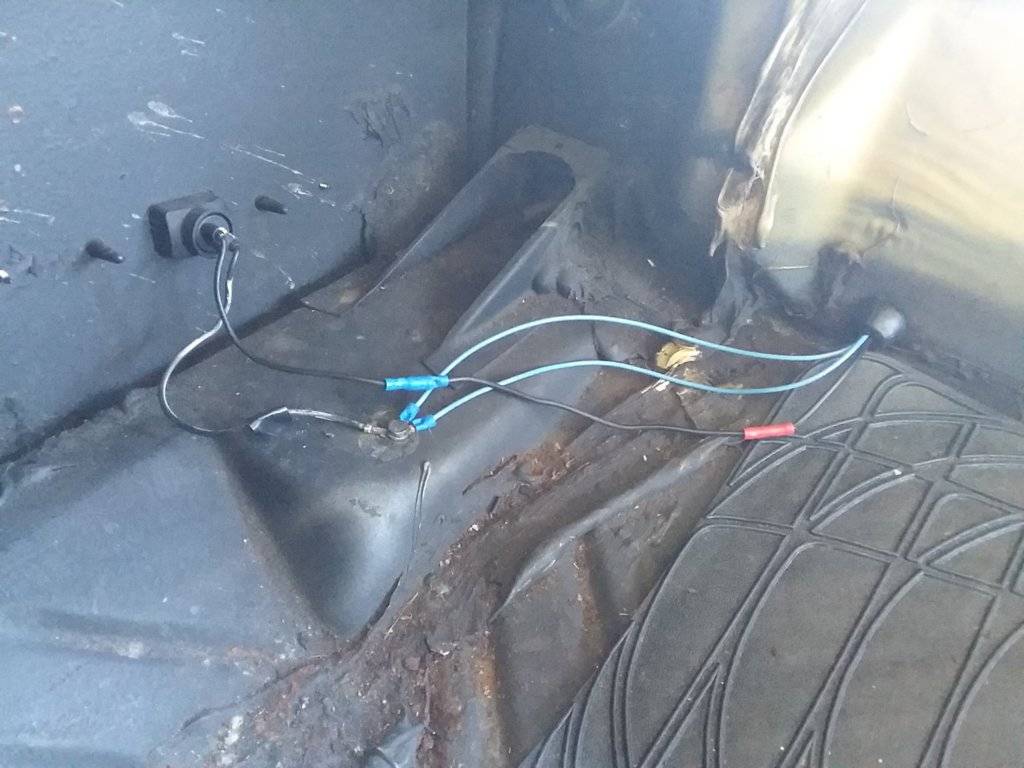

Blue wires are extra grounds direct from the taillight housings. No more TL housing>bumper>bracket>body with rusty fasteners. Ground is straight from TL housings to body ground at side marker lights. LS trunk:
RS Trunk
Prior LS taillight lens had an entire lens square broken out. Got this NOS for $60. Glad to give the old lens a chance to finally be on a Fury.
Light Test: headlights, taillights, turn signals, brake lights, reverse lights, license plate light, all okay
