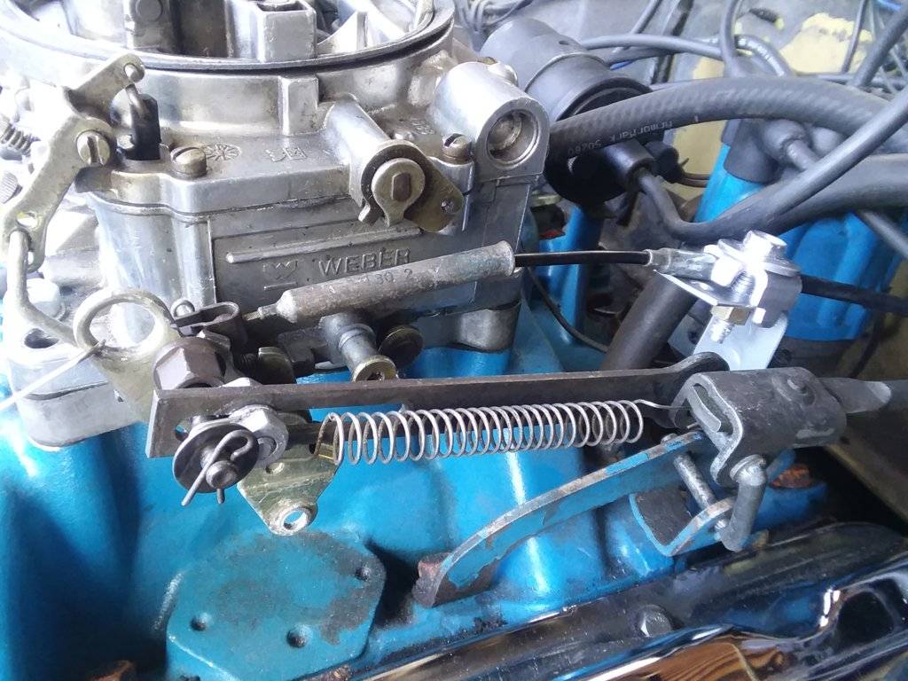

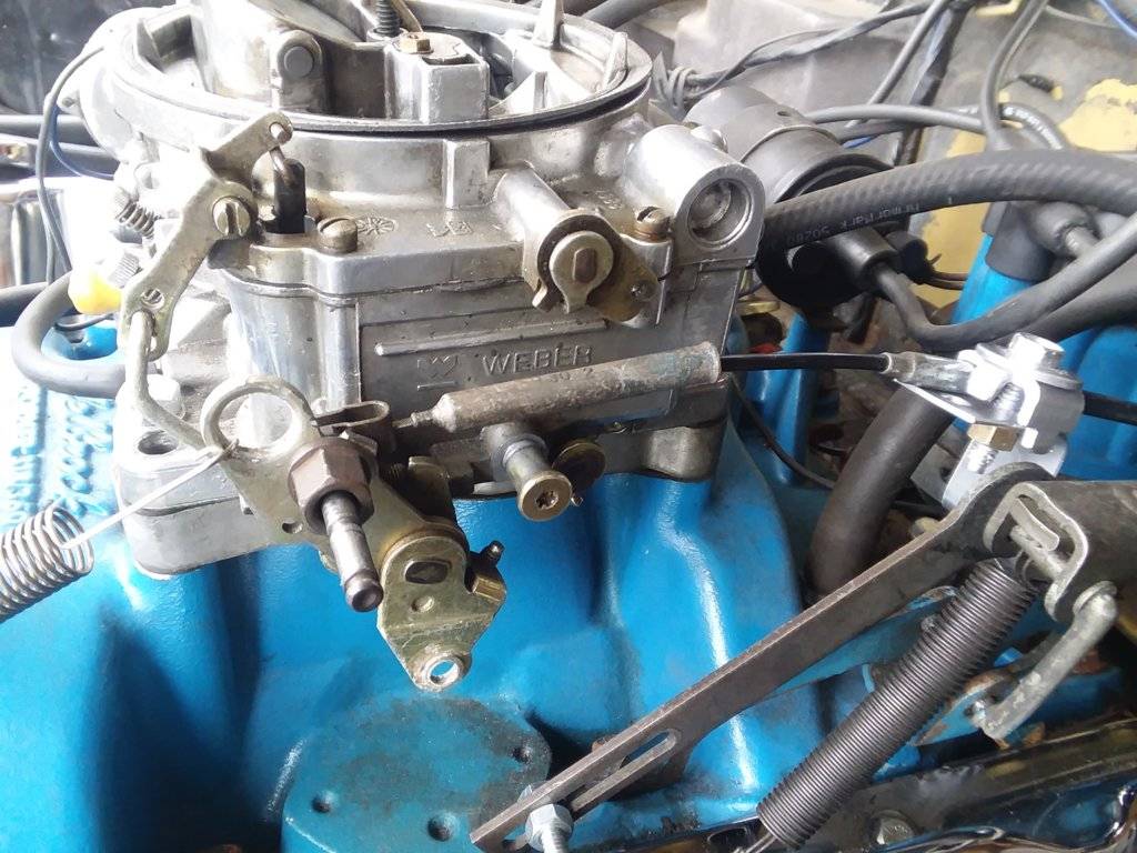

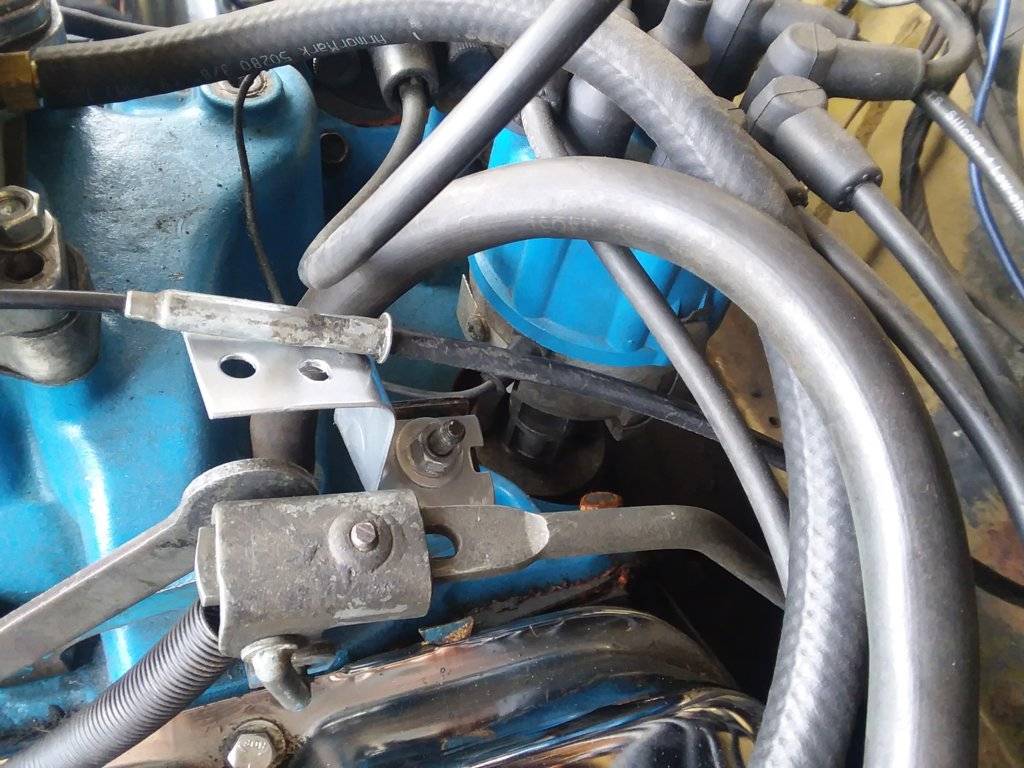

Some carb linkage work. Choke and linkage now operational with fabricated bracket to move throttle cable mount forward. My cost several hours, $0.00. Full throttle blade opening. Full kickdown travel. Maybe this helps someone with a similar problem and enough left over clips, scrap metal, and bolts/nuts to solve the problem. On to the rear brake lights and turn signal lights. Getting closer to a legal test drive.
Looking good Ben, just a quick note, that pivot bracket bolted on by a 7/16 nut to the end of the kick down arm is upside down and back to front, easy five min fix though.
Good point Gary. I had thought to leave the kickdown linkage in stock position, so I didn’t change the position of the adjuster and created a 2nd adjuster on the end of the front slotted arm. But, if I switched that bracket, so that the adjusting screw head was upward, I could see if I could use the adjustment to create even more clearance in front of the fabricated throttle bracket.

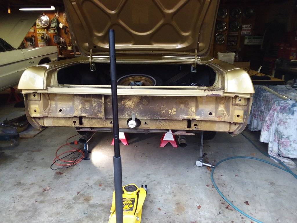

Taillights: my right side brake lights don’t work, and my left outside turn signal, brake, tail lamp bulb is very dim. I have a 1970 Fury, so when I opened the 1972 Fury trunk, I expected to see the wiring along the rear edge of the trunk. Imagine my surprise when I saw that it went through a grommet at the left outside of the trunk and then one wire came out through a grommet for the side marker light at the right outside of the trunk.
Because of a tiny gap between the valence below the bumper and the rear edge of the frame, the wiring is mostly out of reach. In addition, from removing new black tape on the wiring behind the gas door, I found a large pink wire that doesn’t belong there at least by wiring diagram. The factory shop manual says that the bumper has to be removed to access the wiring.
Questions:
1) Does the bumper have to be removed? If so, do you have any hints or pictures for removing it?
2) If not, how can I get to the wiring? As always thanks for your help
Point of Disappearance. Maybe, I'll get lucky and find the problem where the black tape starts. Otherwise: long day ahead.
Can Work From FSM, but Experience/Actual Pictures are still a great help
I don't know about whether the wiring can be accessed or not without the bumper being removed but with regard taking the bumper off, four bolts underneath on the chassis rails and four bolts in the trunk area, two in each corner. Very similar to the 1970 vehicle.

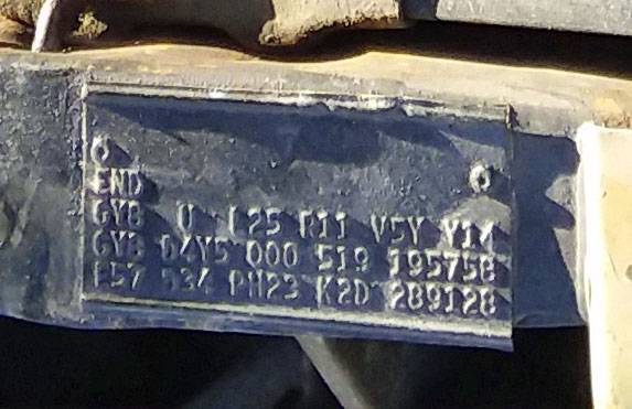

Ben, is the paint code "GY8"?
Thanks
Short Answer: Yes. Fender Tag and Decode Below. I used Galen Govier's Decode Book. If I made a mistake, you can let me know.
1st Row
E57 360 @BBL 255HP, 8.8 Compression Ratio
D34 Std Duty Auto Trans
PH23 Plymouth High Price Class 2-Door HT
K2D 360 1972 Belvidere IL
289128 Sequence#
2nd Row
GY8 Gold Metallic
D4Y5 D=Deluxe 4=Split vinyl seat with center armrest Y5=Medium Gold (looks like they changed my seat color/door panel color. Not bad though)
519 May 19 1972 production date
195758 Order#
3rd Row
GY8 Gold Metallic Roof
U 15 Inch Tires (Has Disc Brakes, so this fits. Not sure why no brake code)
L25 Trunk Compartment Lamp
R11 Radio AM Music Master
V5Y Protective Moldings
Y14 Sold Car (I guess this means someone ordered it, so not for dealer stock)
Thanks for this info, Ben. I am not an expert at decoding so I will let the knowledgeable members chime in. I was interested in the paint code as it is the color my New Yorker is supposed to be.
Taillights No RS Brake Lights/LS Outside BL, Turn signal/Brake light very dim:

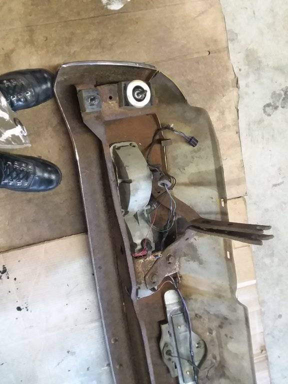

Rear Bumper and Valence Remove as Assembly:
Opened trunk. 2 studs from the bumper, on each side, extend through the rear of the body and into the trunk. Remove all 4 nuts, 9/16 long socket, 6 inch extension, 1/2 impact gun
Wire Grommets: one at each corner of the trunk. Blunted large screwdriver, flat blade, push on edges and to start to push through. On the left side, the grommet doesn’t go through very far without hitting the back of the taillight socket housing. On the right side, the grommet does go through the body and into the area between the bumper and the body.
Under Car: there should be 3 bolts through the brackets on each side of the subframe. There should also be 2 bolts on each side through the valence mounts to the subframe at the bottom of the valence. The problem is that all 10 bolts were missing! Shocker, did not expect that. Guess it makes the bumper easier to remove.
We pulled the bumper straight back and placed on cardboard

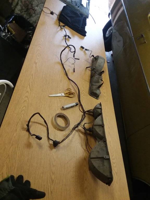

Taillight housings: Remove Screws. Note: the right side connectors allow the right side taillight housing to be removed separately from the wires. The left side has no connectors between the wiring harness and the taillight housing so these need to be removed as a whole.
Bumper Removed. Bracket Slots Visible.

Rear Wiring Harness: Continuity in ohms, Measured on work bench, separated from bumper. 3 bulb sockets/side: O=outside, I=Inside, R=Reverse, Hsg=Housing
· Main Connector, 4-wire: no cross circuit continuity with any of the 4 circuits
· LSO BK Contacts LS .2, RS No, Socket No
· LSO GR Contacts LS No, RS .9, Socket No
· LSO Hsg>Socket LS No, RS No, Socket .1
· LSI BK Contacts LS .1ohms, RS No, Socket No
· LSI GR Contacts LS No, RS .3, Socket No
· LSI Hsg>Socket LS No, RS No, Socket .7
· LSR V Contact .1, Socket No
· LSR Hsg>Socket Contact No, Socket 6.4
· RSR V Contact .1, Socket No
· RSR Hsg>Socket Contact No, Socket .7
· RSI BK Contacts Upper No, Lower .9, Socket No
· RSI BR Contacts Upper .1, Lower No, Socket No
· RSI Hsg>Socket Upper No, Lower No, Socket .1
· RSO BK Contacts LS No, RS .5, Socket No
· RSO GR Contacts LS .4, RS No, Socket No
· RSO Hsg>Socket LS No, RS No, Socket .4
· It looks like there’s no problem with socket housings. Problem probably ground thru bumper. Loose bolts attaching socket housing to bumper and missing bolts at bumper brackets and lower valence. Still, I’m going to pull off all tape, inspect every wire, and replace connections where needed. Someone removed and reinstalled this bumper for a reason. Need to find what he missed.
