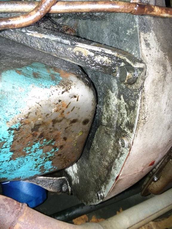

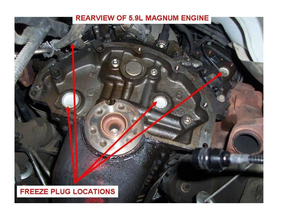

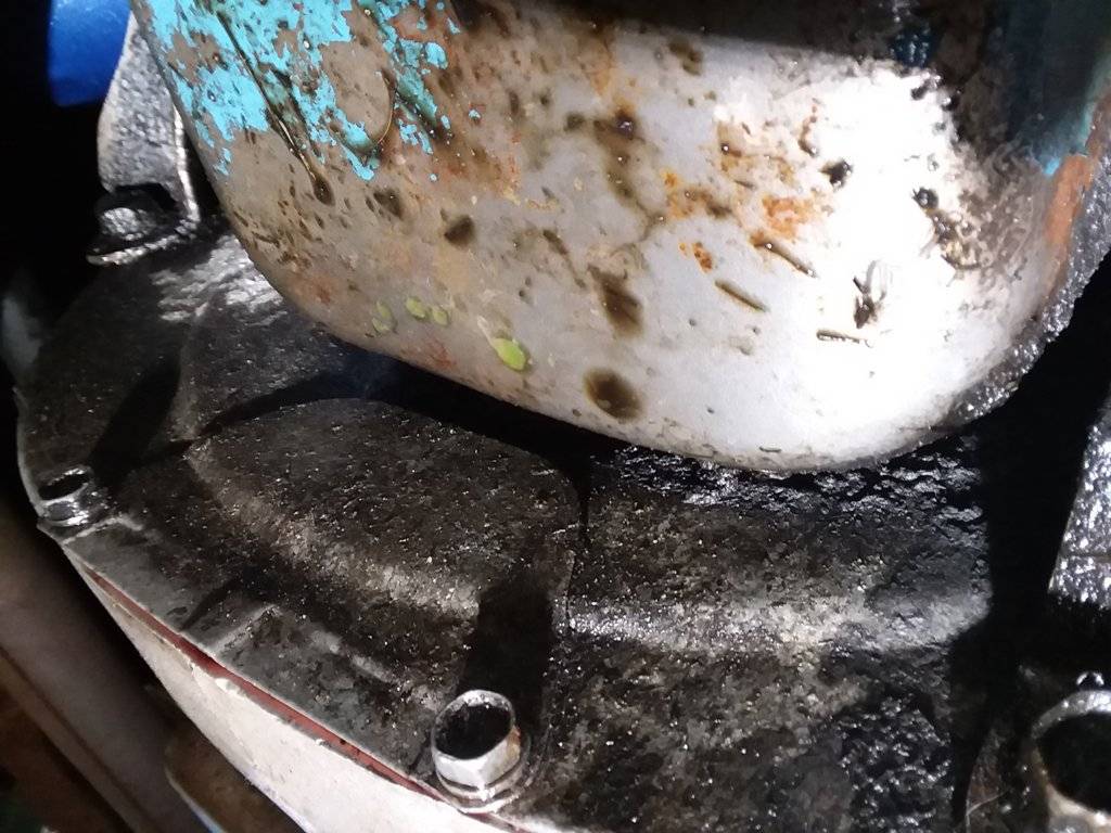

Antifreeze Leak. Looking for Advice
· AF several drops hanging at square lower rear of oil pan. AF drop on curved portion where rear of oil pan meets front trans. Also AF puddle within leaking trans oil puddle on floor below front trans.
· Sides of block: dry. Also oil pan bolts below dry. Freeze plugs: some of the core/freeze plugs have already been replaced with Dorman freeze plugs
· Area below rear of intake: dry
Seems like I have a leaking freeze plug at rear of the block to go along with a torque converter seal leak at front of trans. Am I missing something on the source of the AF leak or do I just need to bite the bullet and drop the trans? thanks, Ben

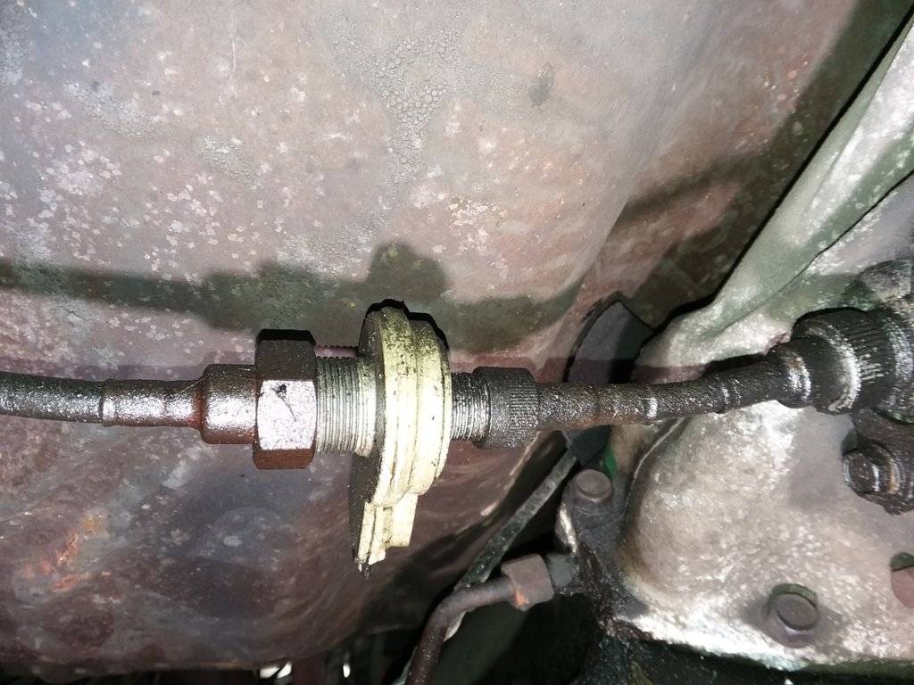

Odd speedo adapter
drop the transmission , rebuild the transmission and replace the freeze plugs on the back of the block . Its not gonna get any better

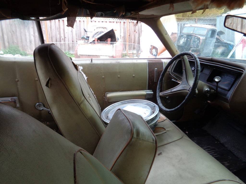

Now we know what my interior originally looked like. I guess the brown dash pad does go with the gold interior. Maybe, because Chrysler thought the pad matches brown-tinted gold exterior paint?

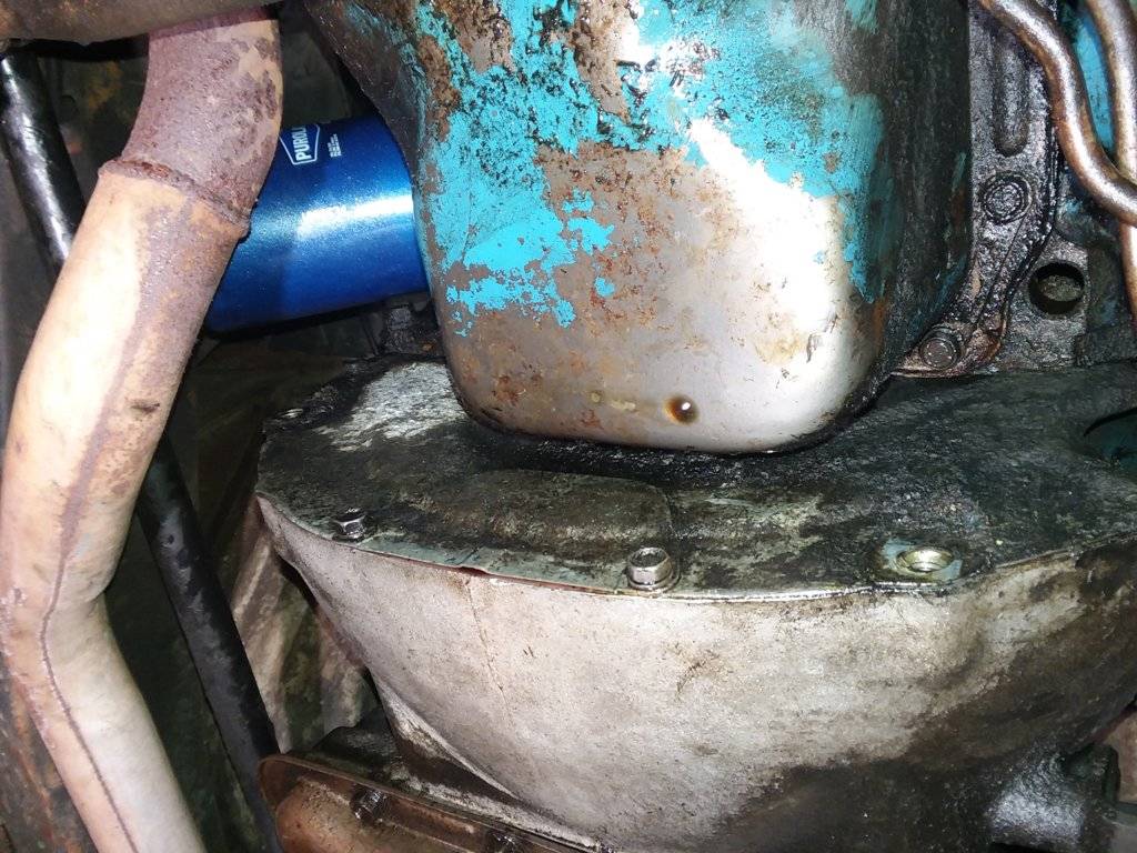

Odd speedo adapter
Freeze plug could be anyone of these. If it's one on the head I'd pull the engine, I blew out a head one and you can't really get at it easy even with the transmission removed and engine tilted down so it's remove head or as some do on other cars holesaw a hole from inside the car firewall for easy access! :eek:
I removed the engine on mine and popped all the freeze plugs rodded out all the pile of crud in the bottom of the water jackets that the super duper flush that I tried just loosened it all up and made the side plugs leak.
Tranny front seal is a easy fix while engine is out. A rebuild can be put off if transmission is shifting and working fine.
Speedometer cable? Rube Goldberg is my guess, hate to see what else he's done to your car.
Plus give that engine a good steam clean or several Gunk baths, (helps you spot where leaks are coming from).

The trans is making a winding noise when in reverse. Going forward, it is quiet and perfect. Would you have it rebuilt?
I agree that the engine needs a steam cleaning. Do you have any advice on where to rent the steam cleaner?
Just so we're straight with each other: I'm going to try to avoid pulling the engine for now. It's good advice, but I am getting help from family members in most jobs because I have Lyme disease arthritis. While it may have been unwise to buy the car, that's water under the bridge, since I own it and I like it. Also, it's not a big deal to just hold on to the car while I beat Lyme. I don't mind pulling the trans, but the engine is a little much. Willing to pull heads if needed.
Thanks for the advice, Ben

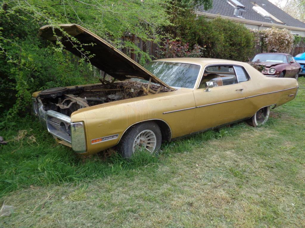

For what it's worth, that's a cool car with the really neat 72 coupe quarter/wheel well styling, no vinyl top, minimal rust. Somebody ought to want that car as a roller. If it is to be parted, I'll try to put together a wish list.

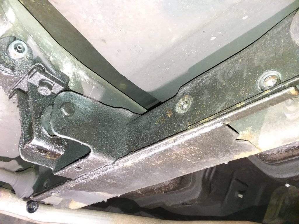

Progress Report: coolant leak behind engine block
Start with starter
Torque Converter Cover 360/727
Some clean up required
Linkage to be disassebled
Linkage disconnected, upper trans to block bolts removed

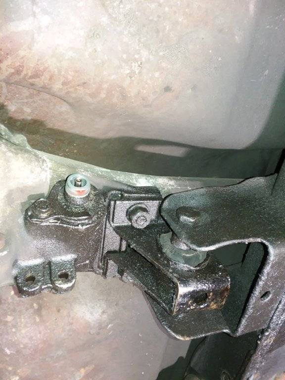

Trans Mount
Trans X-mbr
Dismounted
