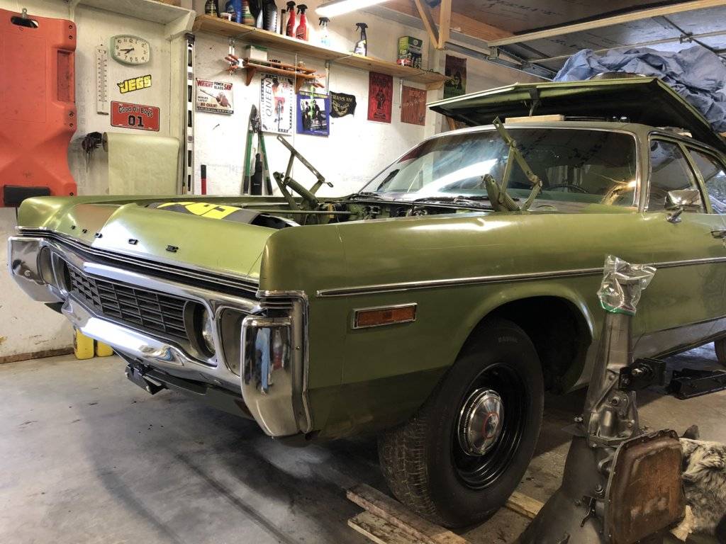

1972 Polara 4 door sedan

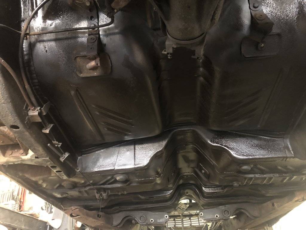

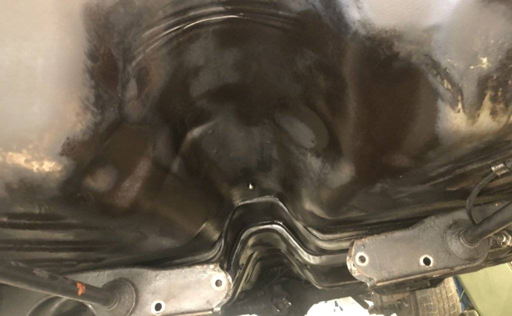

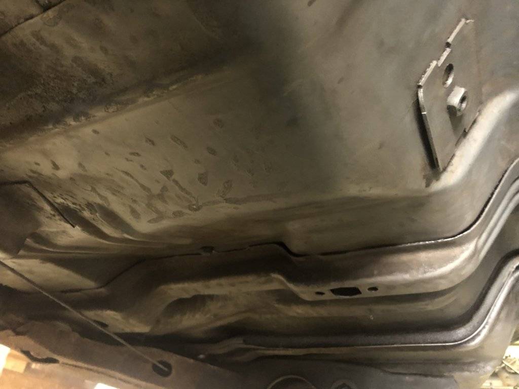

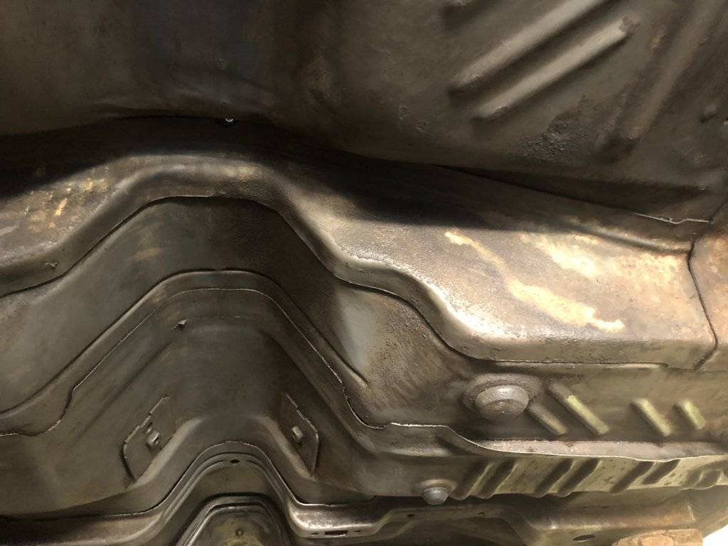

Cleaned up underneath and ready to undercoat.
Just a light coat of rubberized undercoating. I’ll clean and paint the frame later.
I have mixed feelings about undercoating,, does it hold moisture and cause rust or protect the metal from rusting? I don’t know, so I go with a thin coat. Sorry for the poor quality pics, but this thing ain’t on no lift and I’m fat!

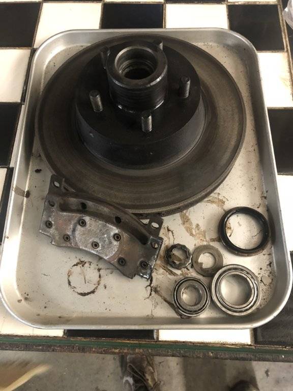

While I wait for the machine shop to finish my engine, I’m checking out the brakes,bearings and such.
When I got this car, I noticed the driver side front dust cap missing from the rotor. The bearings are shot because of that. The pads,rotors and calipers are good, as are the ball joints .

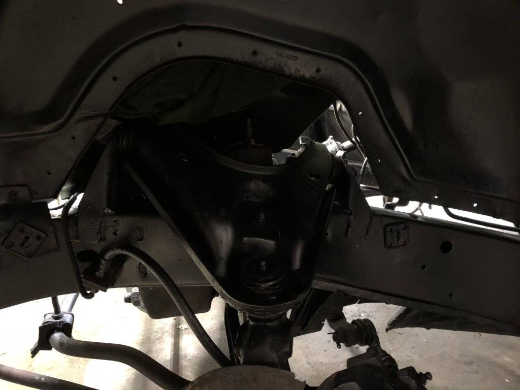

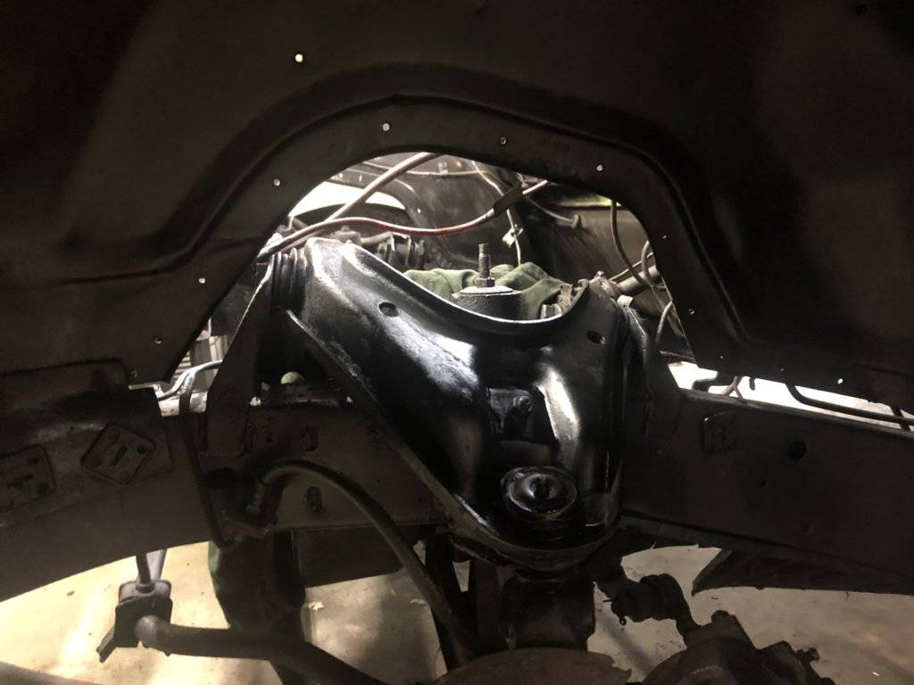

Anyway, here’s pics of 2 hours of cleaning one wheel well and sorting out the bad stuff.
I would have used POR15 or a similar product and then undercoat on top of that. Still looks good though. Food for thought.

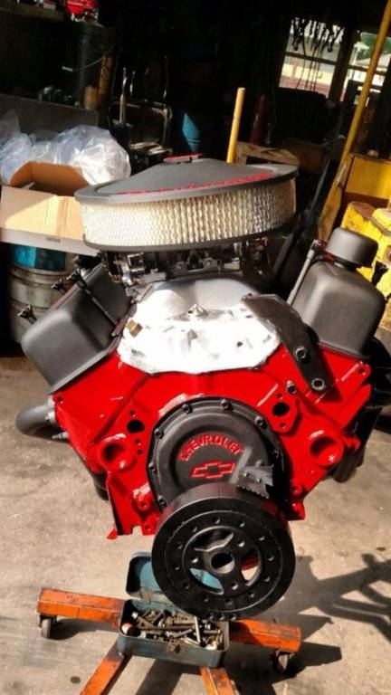

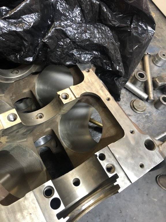

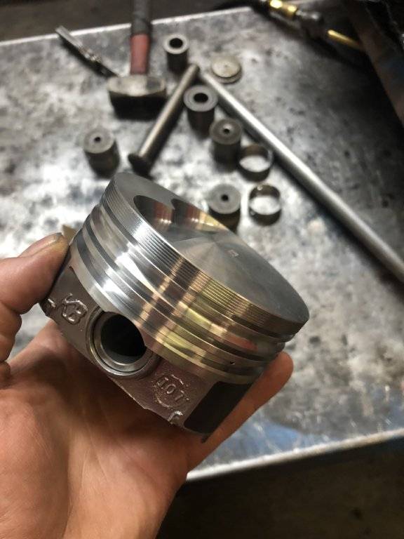

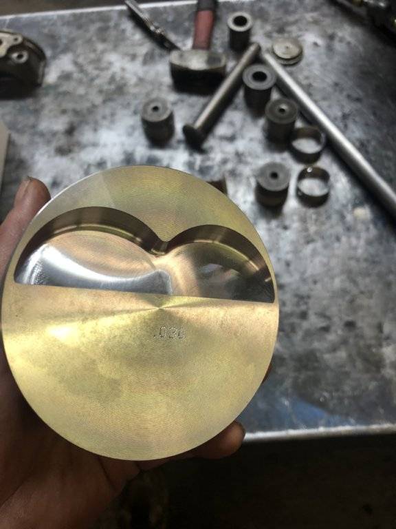

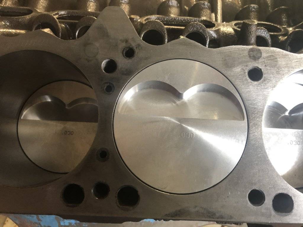

Crank and pistons in, Courtesy of my local machine shop. I’ve got the engine home where I’ll do the rest.
Pistons are .005 in the hole, old guy at the machine shop said it should run good but it’ll be hard on gas! He’s doing the heads now. (Small valve J)
Just kidding about the Chevy.

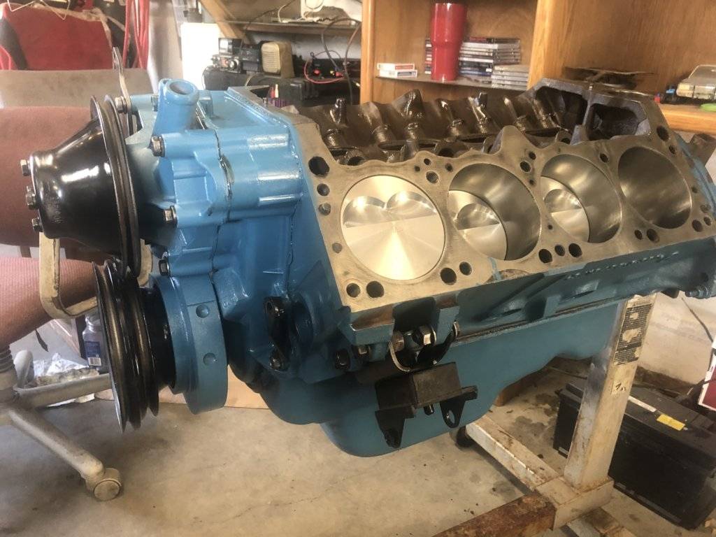

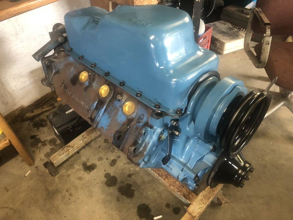

I’m taking my time and enjoying putting the rest of the engine together. I clean and lightly paint the parts individually, test fit brackets and pulleys ,,then, remove the black parts and paint the engine assembly with a final coat of Chrysler blue.

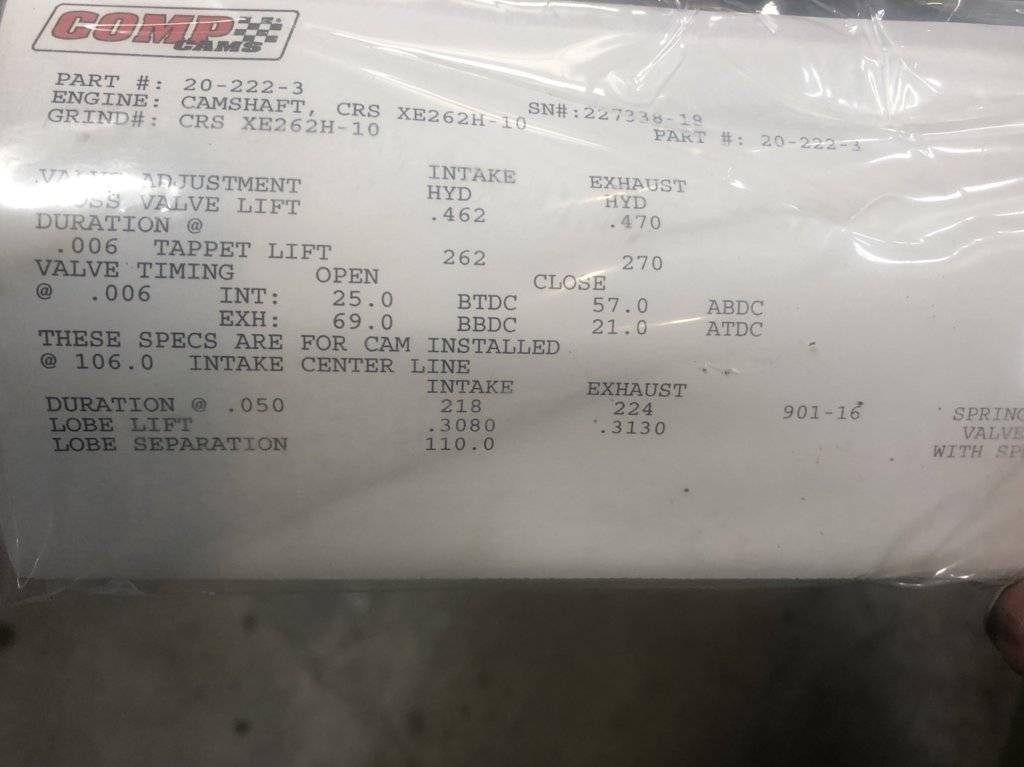

Cam selection. Might be a tad too big for the weight of the car but, I’m putting a 3.23 gear in it later so hopefully it’ll be ok.
