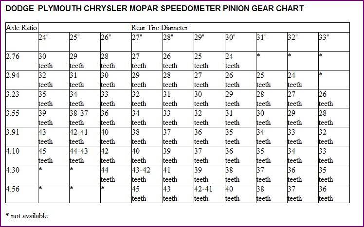

how do I determine which speedometer gear would be appropriate for 3.23 gears? I do intend to install 3.23...I believe it will bring the way my car responds up to where I want it to be. I really liked my 66 coronet with the 2.94 gears...looking at the power bands/rpm/speed/weight...I think 3.23 will be comparable to it then.
there r places that make adaptors for that it has to be with the number of teeth , now u can also ge a gps (I run one in my car it has a speed indicator in it) aflter a while u can tell yur speed by the tack .
Pretty easy, there's a few charts out there.
Here's one. Mopar Speedometer Gear Selection Guide - MyMopar.com
These may get you closer. In my experience, sometimes you have to find one that looks good and try it. Then go up or down a tooth or two to allow for inaccuracy in the speedometer, rounding off and the tire size. Sometimes that's being fussier than you need to be, but I tend to do that.
