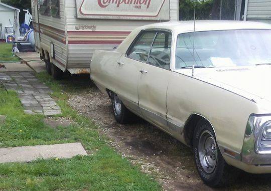

this what i did to my 440 i rebuilt the motor putting stock bearings ,new double row timing set ,windage tray i had a set of 90cc 440 heds i put on it & i used a mopar perfoemance cam & lifters(
Purple Shaft Hydraulic Camshaft & Lifter Kit
  • Chrysler 361, 383, 400, 413, 426W, 440
  • Advertised Duration: 284°/284°
  • Centerline: 108°
  • Lift: .484"/.484"
  • RPM Range: 2200 to 5900
