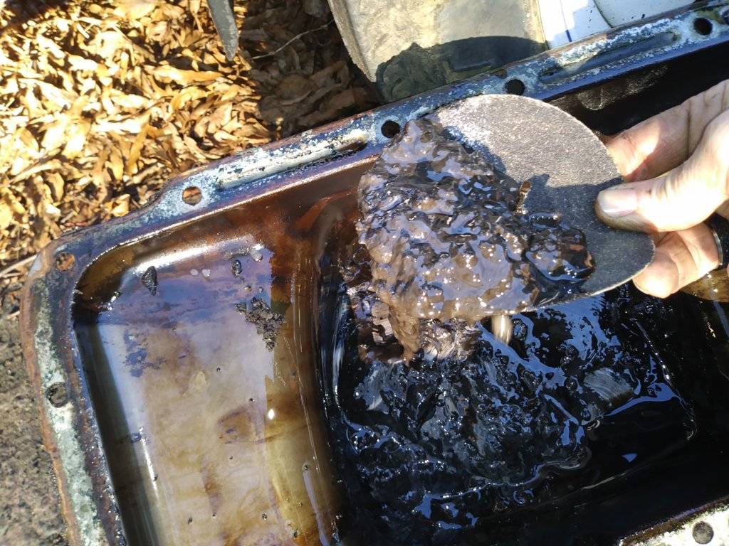

Sift through that sludge and see if there are any pieces of the valve stem seals. They will be broken black hard pieces that appear like plastic. Unscrew the oil pickup and soak it in solvent for a few days. Then rinse it out and see if any pieces will shake out of it. They stop at the screen and get packed in there.
I'm actually changing the pickup and oil pan altogether. Its bent from the oil pan hitting it when it was crushed. I didn't find any hard chunks...other than hard oil. Lots of this in the top above the cam too....cleaning it all out.
The cam doesn't look bad...some discoloration in spots and minor visible wear but no scoring or grooves....will probably keep it for now unless I really need to change it.....not looking to get too far into this and get overwhelmed. Might go ahead and pull the heads anyway to clean them out too...the heat riser passage is pretty crusted over....but the exhaust valves are pretty clean.

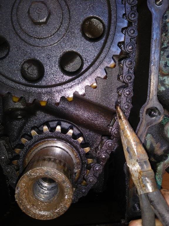

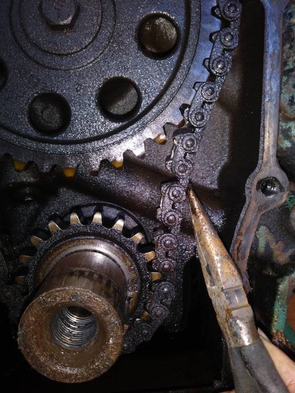

ok the nylon is off the cam gear so its not long before it jumps time replace it with a double row timing set I like Cloyes but u can get one cheaper from jegs

this is a 3 bolt gear u can get a single bolt cam gear too i put the 3 bolt cam in my new yorker & i love it .if u want the cam i put in m get back to me & i will give the part #
Getting better....took me a week but the block is finally clean. Internally there is almost no wear on the parts...even the valve seals are intact. They are getting replaced along with the timing chain and gears. Still have all the bolt on parts to clean and the trans to clean up.
