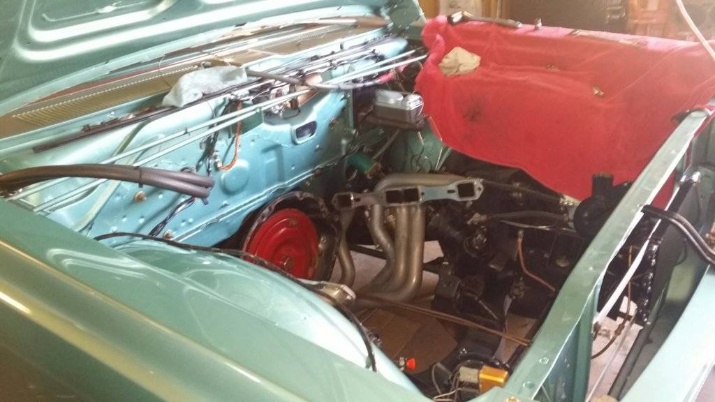

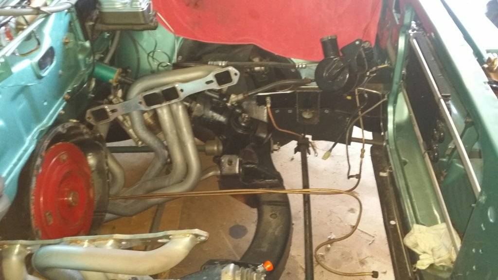

Update-
It's been awhile since my last update so what's goin' on with the motor? So, a few weeks ago my stepdad took off the air cleaner, valve covers, carburetor, alternator, and took out the radiator and drained the coolant, spark plugs, spark plug wires, motor mounts etc. Technically all the stuff to get the 440 stroker motor ready to be pulled out of the car. Although the headers, heater lines, power steering pump were not taken off but rather "moved aside" in the engine bay. He didn't want to deal with the hassle of taking them out, anyway he got everything off/out the motor so all he had to take out was the engine block.
So now, the motor was pulled out from the Fury yesterday (Sunday December 15th) and is now on an engine stand. The transmission is still in the car, my stepdad went through the motor today and says everything looks good from what he saw. Pistons and everything. However just from sitting a few weeks there is now a little bit of rust forming on the heads and block. So, he sprayed some WD-40 on there to help it from getting worse. Now we are trying to figure out a plan for what to do next.
Right now the motor is "looking" like it can kind of be saved thankfully. Plan to hopefully be announced soon. Please note that I would post some pictures but my phone is "out of commission".
Just figured I'd give everyone an "update". Thanks for reading.

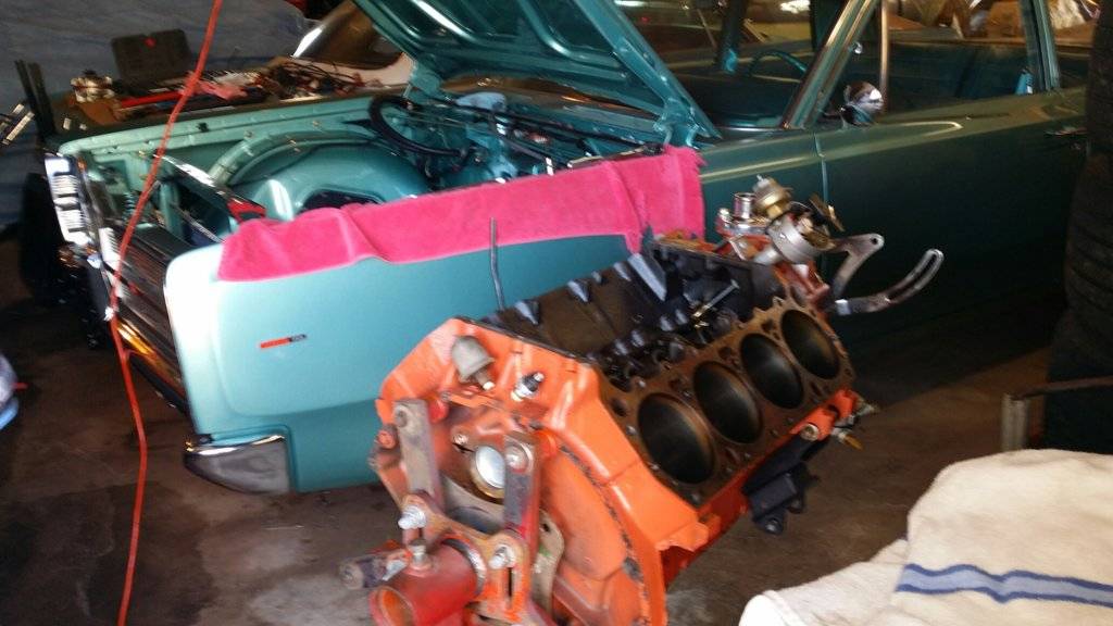

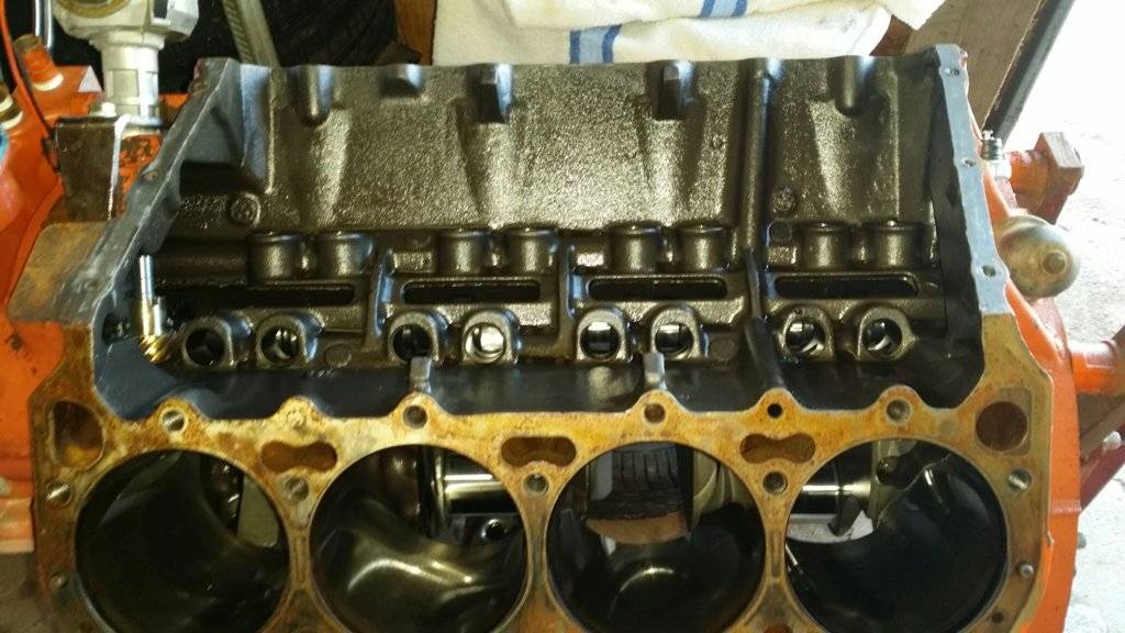

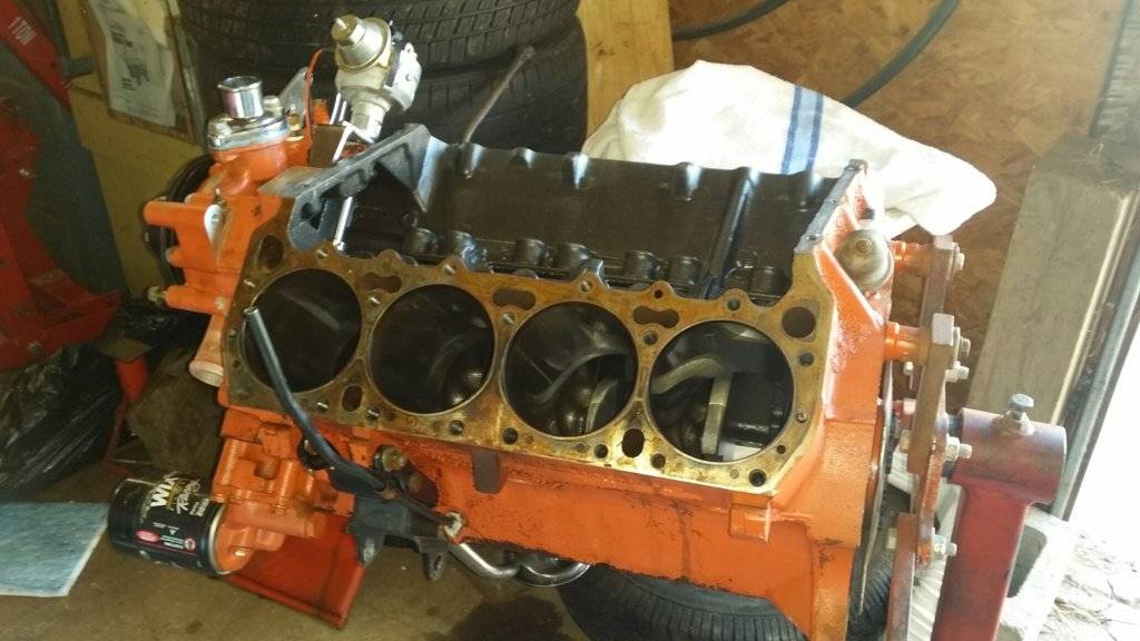

Hi all, It has been about a month or a little bit more since my last update. As of right now and I am trying not to jinx it here, the engine looks like it can be saved! In my last post I messed up and got my information a bit wrong, I originally said it was the 3rd and 7th pistons that were scuffed, IT IS ACTUALLY the 5TH and 7th pistons. Anyway here is the latest....
We Found The Problem! It is as we originally thought, the problem is in-fact the cylinders and NOT the pistons. Another friend of ours named Rich looked at the pistons and he said that the scuffs on the 5th and 7th would not make the car run like it is. So he gave us a measuring tool to borrow to measure the inside of the cylinders.
Yesterday Sunday Feb 23rd- The cylinders were measured, then the pistons were measured for comparison. The cylinder measures at 2,000 difference, and the cylinder measures smaller than the piston so it's a bit tight. It is supposed to measure within 4-5,000
So What Is Next?- Take the crank out and hone the cylinders alittle bit.

Man that just doesn't sound right. You need to find out what the piston manufacturer recommends for clearance for starters. If someone put it together with pistons larger than the bores....... that would be a pretty big oops.
004-005 if a pretty big gap,0025-003 is a pretty common number depending on the material of the piston.
You can get bad readings on the piston if not careful. Measure 25 times, hone once.
