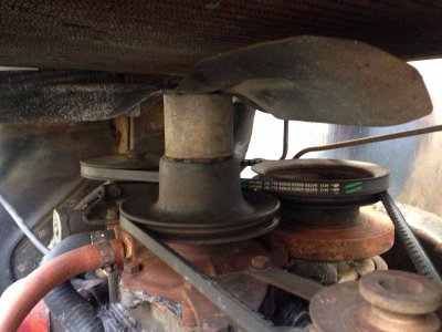

So I just looked at the old fan closer now that I received the new fan and fan clutch and it appears as though there is no fan clutch on the current fan. I have a picture but can't post it for an hour till I get home. Anyone have any input on this? I'm confused.

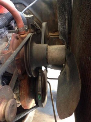

Figured out how to post from my phone. Thoughts?View attachment 35434
You're converting the car from a direct drive fan to a clutch drive fan. In order to work properly, on a non shrouded fan, the direct drive fan needs to be relatively close to the radiator, hence that enormous spacer pushing the fan forward. You're going to need the correct spacer for the clutch & fan, which will likely be much thinner to get the fan spaced properly to the shroud you'll be installing. You may also need to change the water pump pulley as well to make sure the diameter is correct for the fan application (possible but not guaranteed).

There's a lot to be gained esp if you have or find a fan shroud that will work with it. Improved cooling and the clutch fan robs less ponies.
From the picture it looks like there's well over an inch and maybe 2" between the fan and the rad. That's a little far .. probably should be about 1/2 to 1" max w/ 3/4" ideal. You may be loosing some cooling there.

One reply to both postings: No need to feel silly. If I had a nickel for every botched cooling system "improvement" I've seen, it'd have paid for me to restore a car. Your basic problem is the engine and thus the cooling system is not giving up the heat that it has accumulated with the engine running. Your car is 45 or so years old. It's overdue for some basic maintenance. Clean out the system. Oxalic acid works great to break up the crud that's accumulated in the block as well as the rad. You neutralize it with plain old baking soda. Drain everything that's in the system now. Pull of the lower rad hose to dump most of it quickly. Remove the drain plugs in the block to see if you can get flow out of those too. That will tell you how badly the block is plugged up. Seal everything back up, take the thermostat out and reinstall the upper rad hose with no 'stat. Fill the system with water, add about 3/4 of a cup of oxalic acid (if you can't find that, crystal Drano is the next best thing). Run/drive the car for about an hour, keeping an eye on the temperature gauge. If it starts to get even hotter, then bring it home and dump the system. Wait for everything to cool off, and try flushing by putting the hose in each of the rad hoses and check to see what you're getting out of the other rad hose as well as out of the drain plug holes in the block. Repeat this until you can't get any more crud out. Then run the baking soda in the car for 10-15 minutes to neutralize anything that hasn't been flushed out. Put in a NEW thermostat. Your car only needs a 180°F. If you live where the temps are moderate in the summer you can try running a 192°F 'stat, but keep in mind the gauge was calibrated to show 180°F as "normal" not 192°F. If you run the car with a 192, it'll likely show overheating on the gauge.
Your four blade ran and no shroud was all that Chrysler engineering felt your car needed to operate properly when everything is clean internally. Having cooling passages restricted with crud compromises the system the longer you let it run that way. A 7blade fan, clutch and fan shroud will improve your cooling capability significantly. But that's not going to make up for plugged passages.
Start by cleaning what you've got thoroughly and see what that does for you.

I don't recall ever seeing a clutch fan with a spacer but then again I've always worked on BBs. Mock it up and see how close it is or just measure from the bolting surface of the CF mount to the clutch unit and measure the distance from your water pump pulley to the rad face and see what the clearance is. Or just bolt it up and see how it fits.
Obviously you will need some shorter bolts for to attach the clutch fan w/o the spacer
