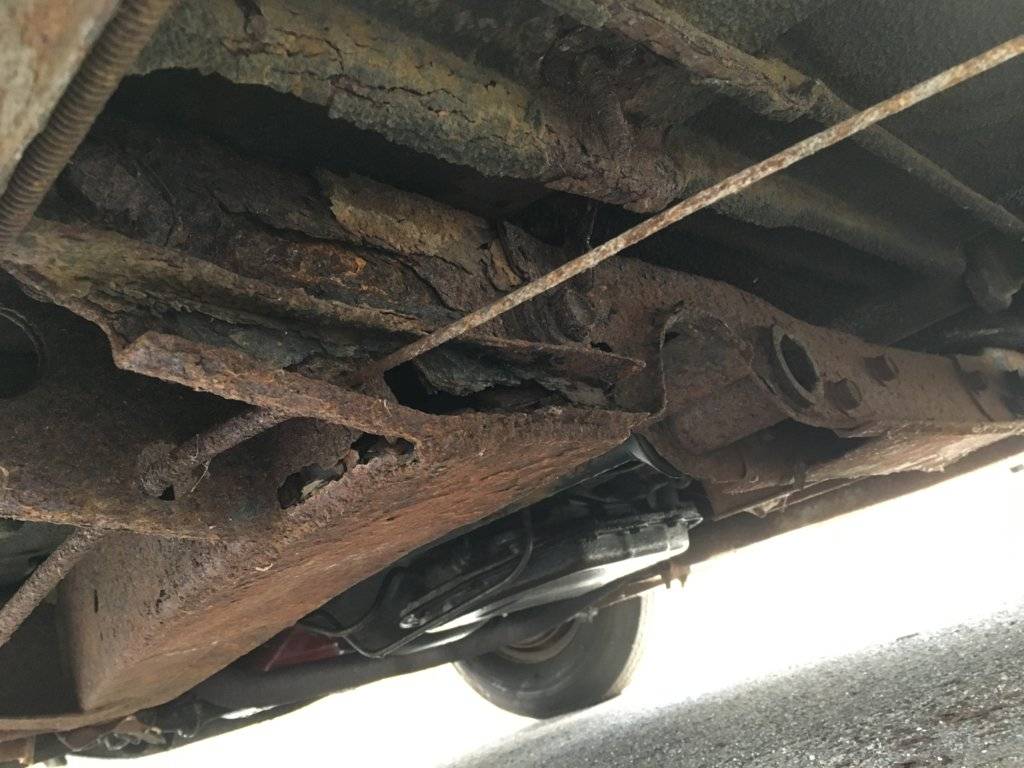

Thanks. On the original frame The rear crossmember near to the torsion bar was gone. Murphy’s law says if I drive it it will be dangerous. See pic. More I poked the more it crumbled. So I figure I would replace the frame. Was able to drive it get a frame off a 67 fury set up for 383 (swaybars). It’s tirned into a bigger project that initially anticipated but equally rewarding so far.

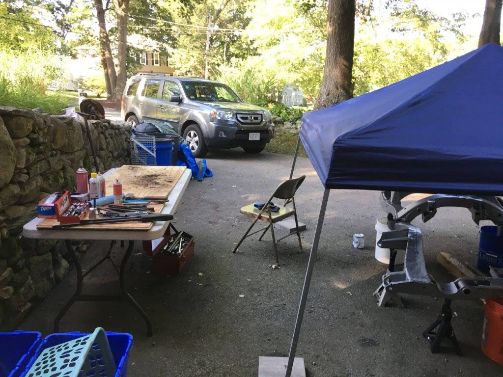

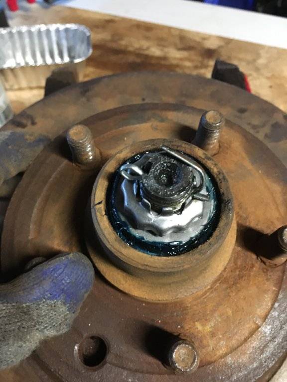

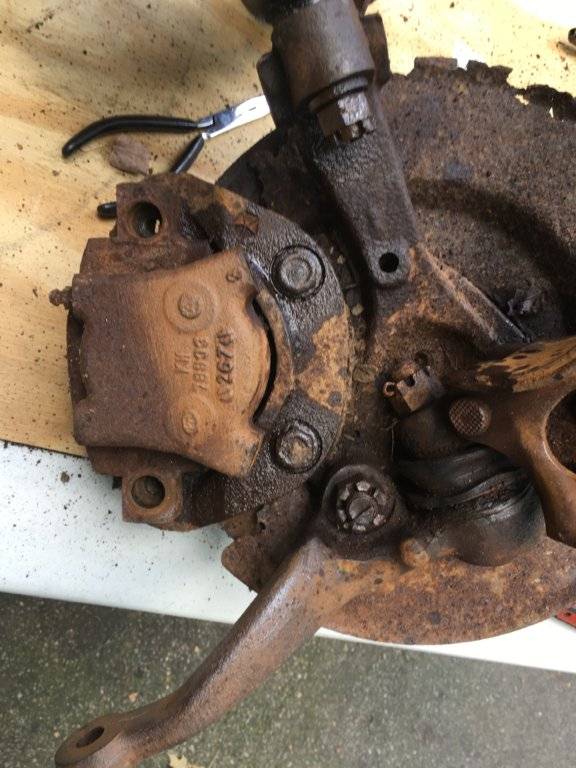

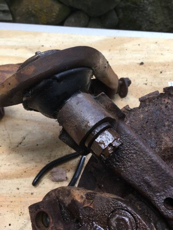

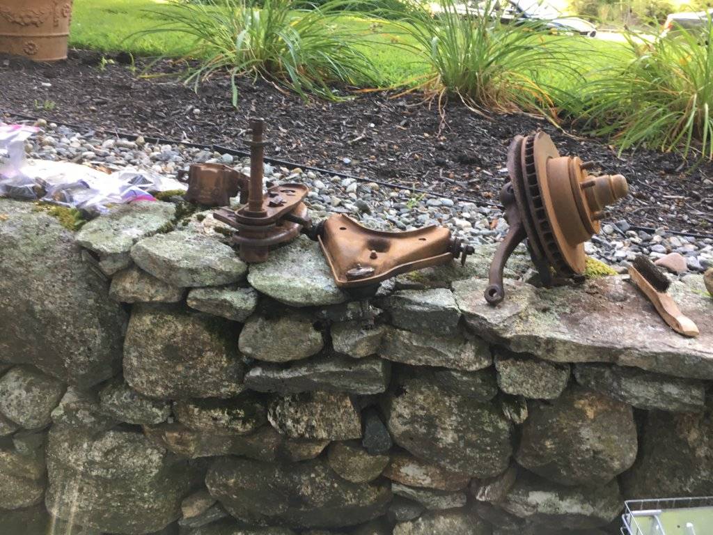

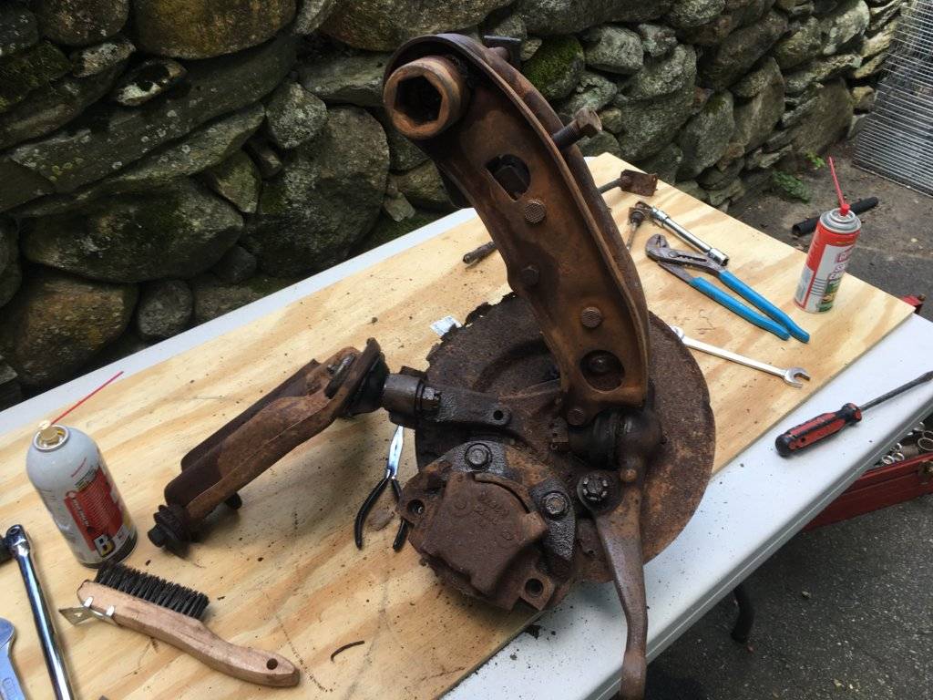

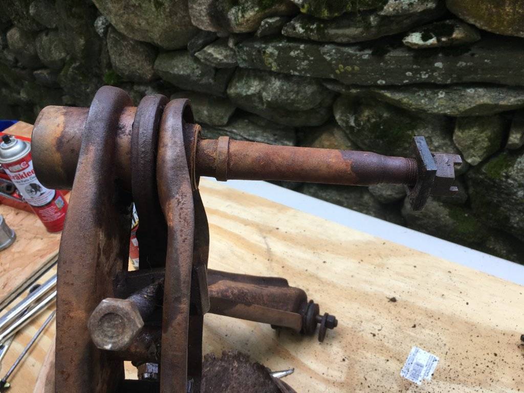

Today I moved onto the front suspension. I previously bought a factory disk brake set up off a 67 Fury for the front end. Came w upper and lower arms attached. Spindle is the prize. So I thought I would start to take it upart, clean up, paint and install new bushings. Today I took apart the left side. Tomorrow will be the right. Bagged and tagged loose parts. Looked better after cleaning and brushing.

View attachment 312504 View attachment 312505 View attachment 312506 View attachment 312507 View attachment 312508 View attachment 312509 Today I moved onto the front suspension. I previously bought a factory disk brake set up off a 67 Fury for the front end. Came w upper and lower arms attached. Spindle is the prize. So I thought I would start to take it upart, clean up, paint and install new bushings. Today I took apart the left side. Tomorrow will be the right. Bagged and tagged loose parts. Looked better after cleaning and brushing.

The spindle and caliper on your work bench is a single piston unit. '67-'68 used a dual piston caliper. Not a big deal unless you are going for an original disk brake setup for 1967. The single piston caliper and spindle will bolt up to your car and is a better choice as parts are much more available. That style single piston caliper was used on '69-'73 fury and others.

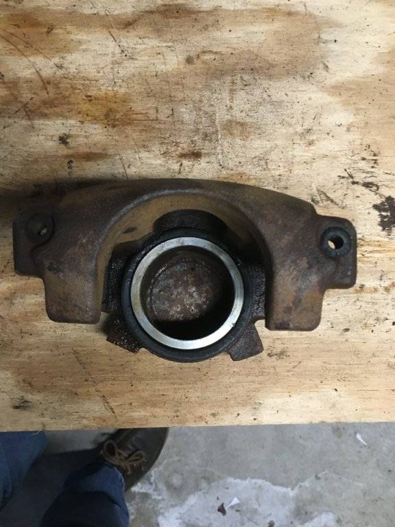

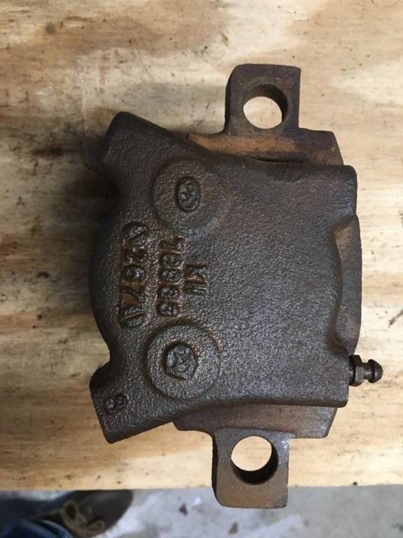

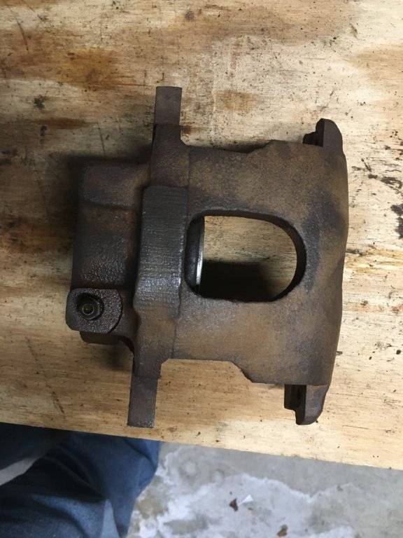

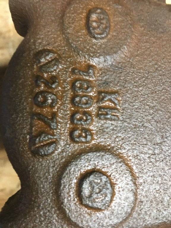

In the garage. looking to rebuild the single piston calipers to the front disc brake set up. looks like a good afternoon/evening project. (goal is swapping drums to disc in front). i am told the the set up i have are from a 67 fury when i bought them this summer. I am looking for a complete rebuild kit for KH 78933 267 single piston caliper.
The piston itself measures 2.75" in dia (or a hair less maybe 2.65? I am headed out to pick up a micrometer as the measurement seems important.) The problem is that i am not seeing this kelsey hayes model # online. maybe it doesn't matter? I did see a set up on RamManin NC website. Yikes- cost is motivation to rebuild what I have in hand at the moment.
Here is my ask....Do you folks know of a good resource for KH vintage brakes rebuild kits? Part 2 - does anyone know how to decode the casting numbers on the side ? is it simple a model #? or tell me the year etc.

When you start the rebuild process, soak the bleeder screws liberally with a good penetrating oil. Bleeder screws on these units sometimes get seized from sitting and will twist off. Major PIA to remove them after that happens. This style caliper takes the same rebuild kit not matter what year they were used so do not worry about that. Rock auto usually has the kits, be sure to go with a US made kit. Most of the kits do not have replacement rubber bushings for the pins so you will need to source those seperately.

After a good soaking...bleed screws came out easily. Awaiting parts from online (piston, rings, clips, etc.) Calipers cleaned up nicely. So did slide pins. Amazing how simple these devices are.

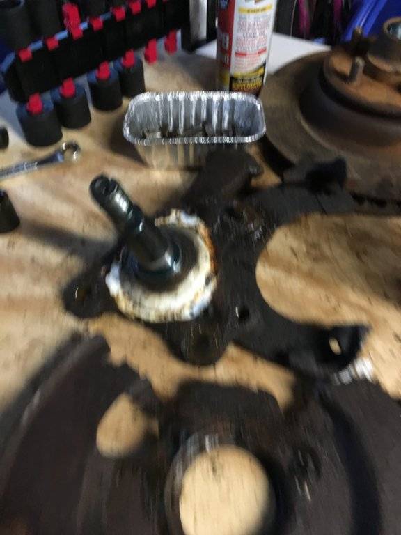

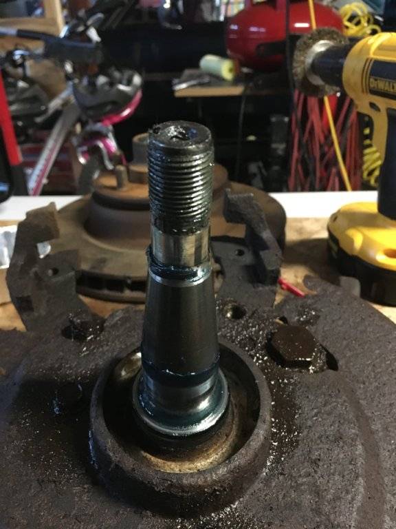

Quick question...separated spindle from assembly. Noticed thin white plyable membrane at base of spindle. I want to clean up the assembly (maybe Brad blast) but fearful of disrupting membrane. I don’t recall seeing this on a my sons camry when I worked on it. Any input on its importance and purpose will be appreciated.

The thin membrane can be discarded if you choose. It is a dust/road wash seal to keep those items away from the back side of the hub seal. You can also use RTV red or black to seal this area if that is a concern. The white expanded foam material that is used to wrap fragile items can also be used in place of the OEM factory foam. A sheet of that material can be cut with a Exacto knife or similar instrument to make a new foam seal. Your parts have a lot of what appears to be grease on them, this can be removed with Brakeclean. Getting rid of grease is necessary to get a quality media blast.
