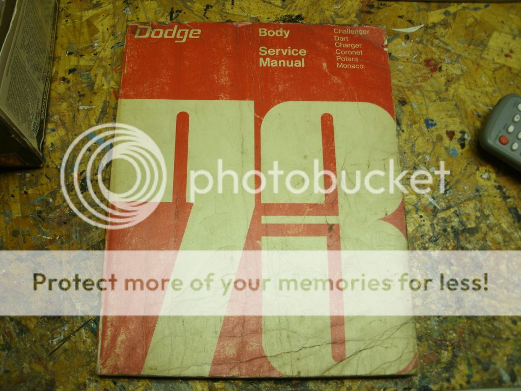

Good part was It gave me time to dig threw my repair and maintnance manuals, found one for a Fusey Mopar.
