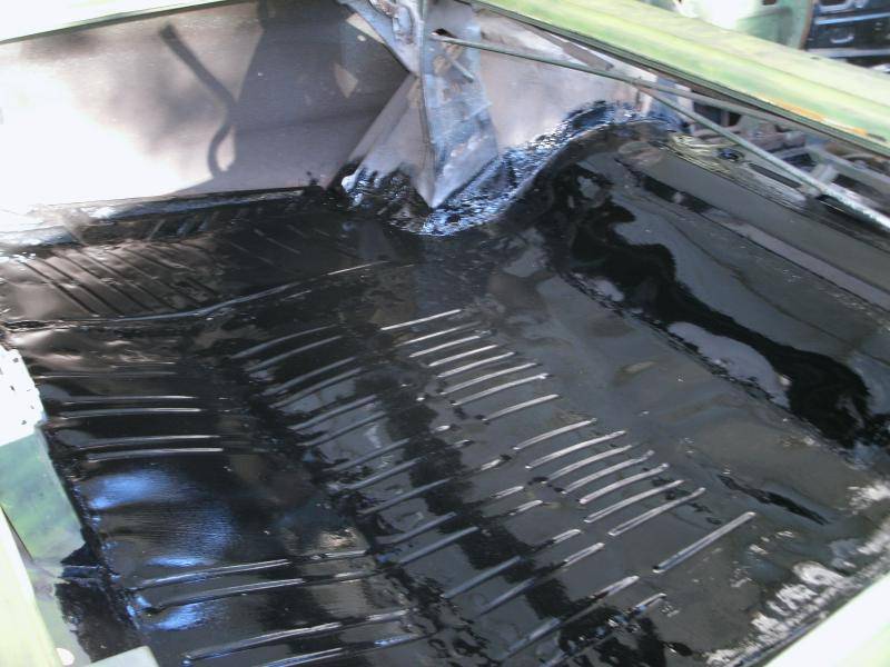

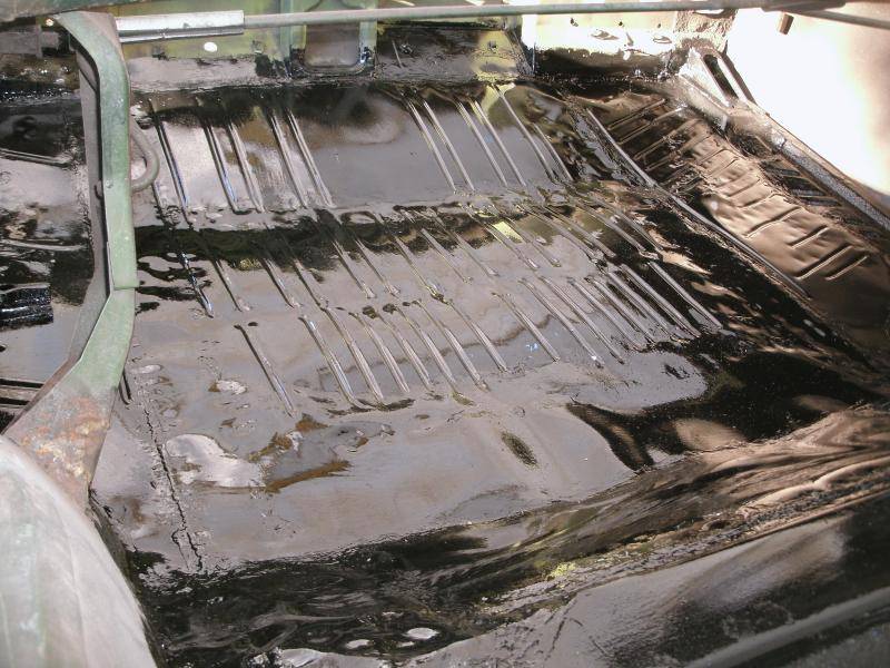

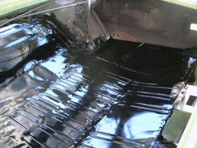

Went to the scrapyard first thing in the morning after I went and bought a new suit, shoes, shirt etc.
Then I went tinkering, waiting for a friend to get off work and stop by, He's a retired bodyman, and bodyshop owner, he was able to sort of teach me what I needed to know and gave me some excellent advice (not that you guys haven't, it's different when the two of you are looking at the car and can point and mark area's)
