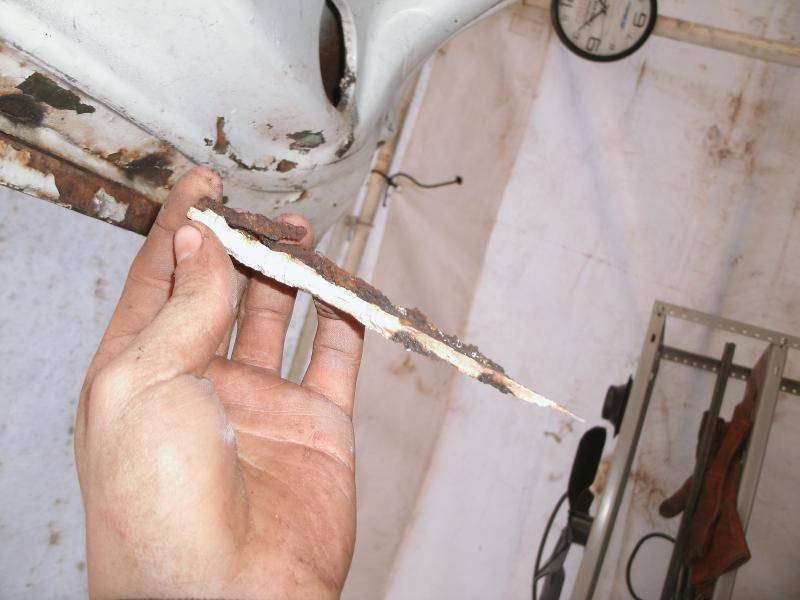

Hmm I seem to remember it being worse....
WTH is this crap?

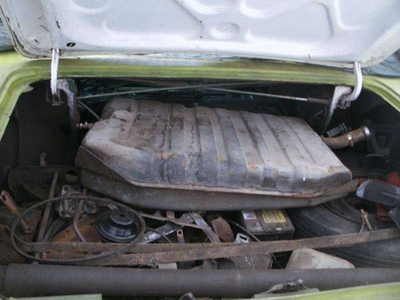

Junk in the Trunk

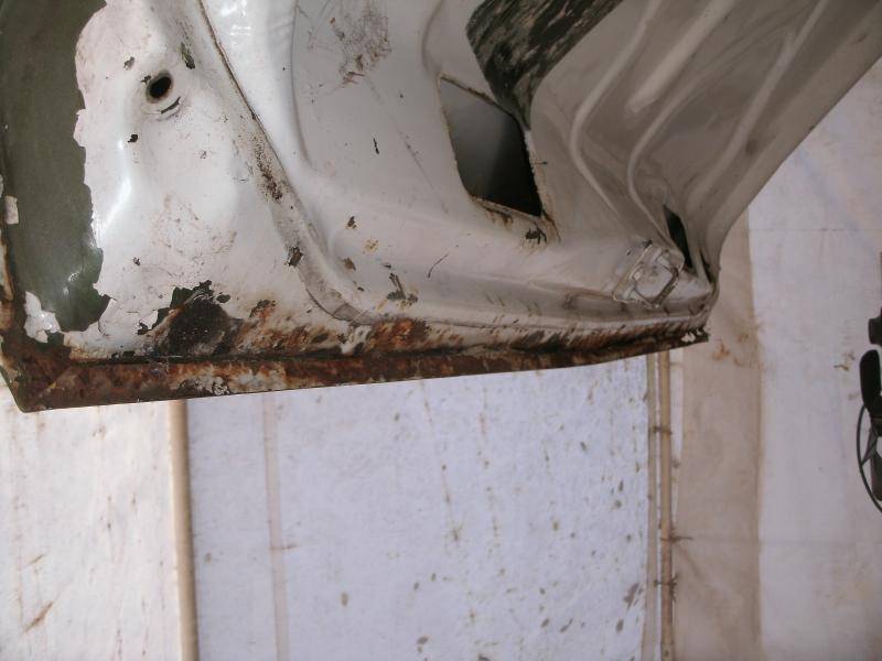

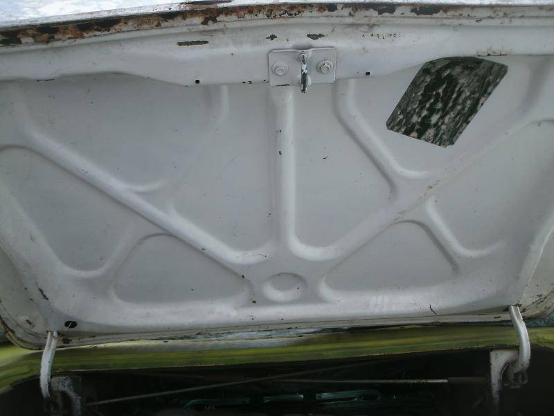

Yep definitely built on a Sunday, my Trunk Jack instruction sticker was crooked

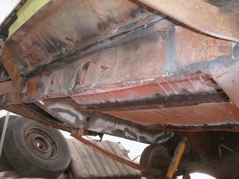

The back panel felt kinda loose, so I welded it to some 1/8th inch steel and welded that to the frame rails, much better, still need to finish back here and seal it all then a coat of DOM 16

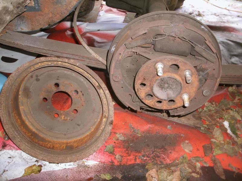

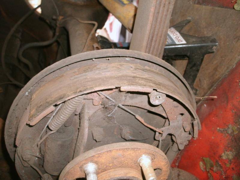

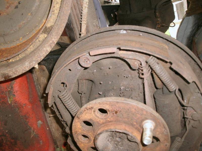

Previous owner and my friend said near the end the Fury had bad brakes........
Fit the gas tank to make sure I wouldn't have problems.......

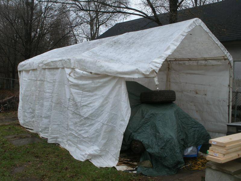

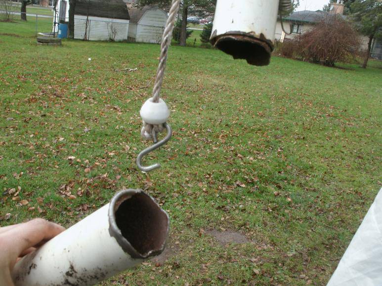

So.........................we caught the tail end of the storm that hurt Illinois pretty bad, it didn't spare Angel any, my day started at 3 AM on Monday, Uncle called, Tent had tried to run away, So I came and did what I could, it was blowing towards the fence, at 7 PM I got another call, it was going the other way, towards the back yard..........
So Angel escaped with a new dent and his tent escaped with a few bent poles, and one snapped off pole, which I guess I'll have to weld or something.
Ended up with today off work (I think it's the first time in 2 years I've had an unscheduled day off)

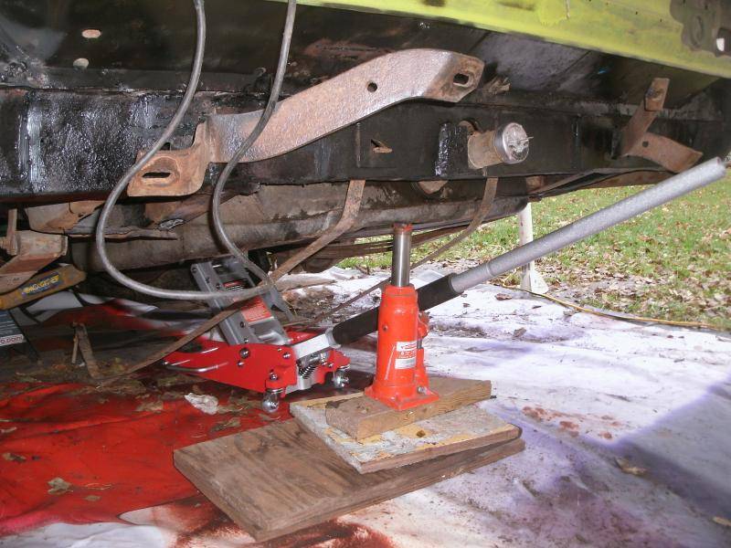

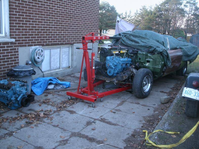

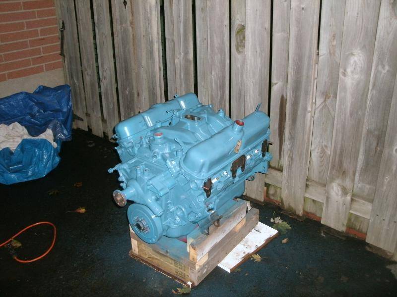

So I brought some tools, engine hoist home and borrowed a friends trailer, car came out of the tent (I owe my uncle some lawn, apparently my 3.08 open diff in the truck rather disliked the wet lawn on the cold rainy day and the slight incline didn't help) And tomorrow the 360 comes out and the 318 goes in, then my focus shifts to body and paint............

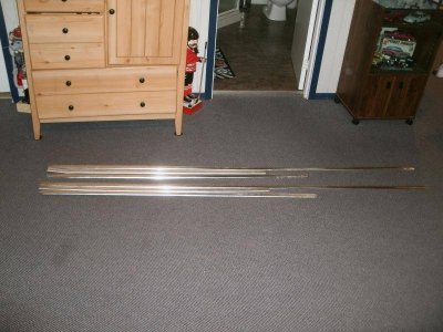

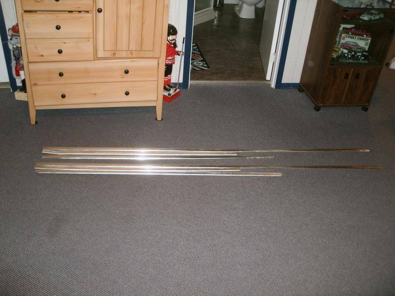

Just when you thought I died, I have returned from the dead!GEDC1474.jpgGEDC1468.jpgGEDC1469.jpgGEDC1470.jpgGEDC1473.jpg

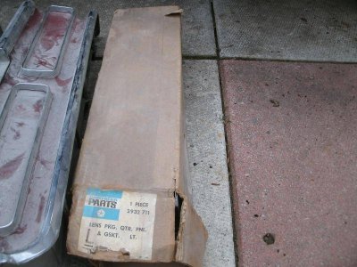

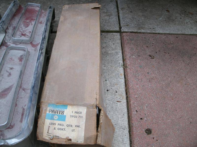

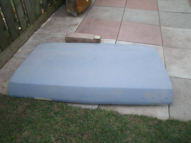

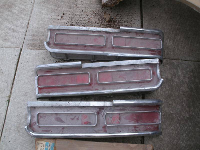

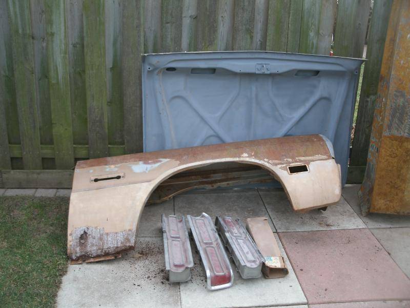

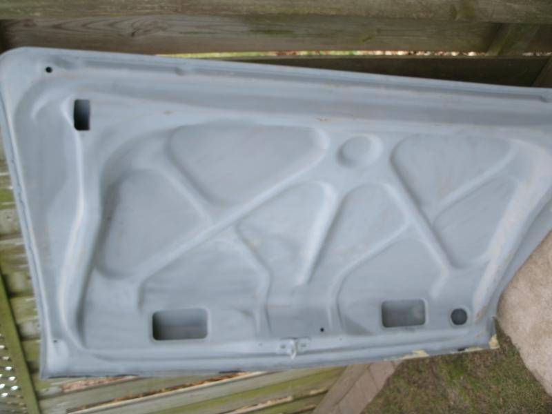

Took a cruise up to see the guy with the '69 Fury Sedan and '69 Newport an hour $100 and my old tail lights later I have 3 good tail lights sans cracks with good bezels, an NOS lens (for a Fur I or II though) a better ish fender and a perfect trunk lid, he actually is a bodyman by trade and pulled the skin off the lid, cleaned the structure, did the lip and resembled it. So thats off my list.

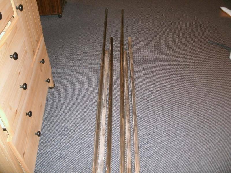

Going to pick up some free stuff tomorrow from a friend.
