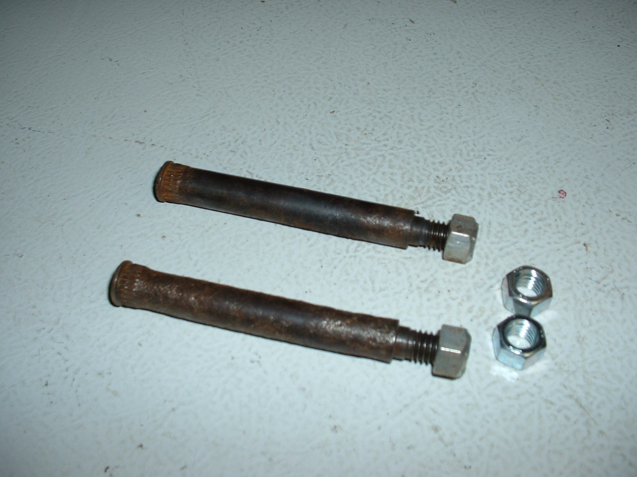

and this is what is available aftermarket
You'll find these at places like Summit all day long
I wonder if you could remove the bolts from these and use them with our offset shackle. It would only work with the short side... but this would fix Gary's issue.
All I need are thOSE pins, if they are correct length. I did not know they were available at summit.
