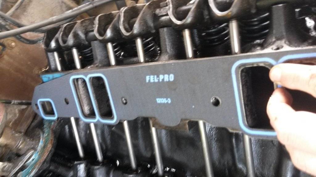

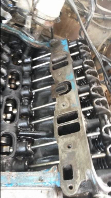

Quick question guys. I got this felpro intake gasket but it looks like it doesn't have a hole punched in for the middle hole in the heads. Does that matter? The intake itself doesn't seem to do anything with this hole, it just leads to a dead end so I think it might be a heat sink or something? Anyway are these gaskets okay to use despite this?
Your gaskets are for non egr, non heat riser application. If the intake doesn't have a crossover passage... don't worry about it. You might have cold running issues without it, but should be ok when the engine warms up.

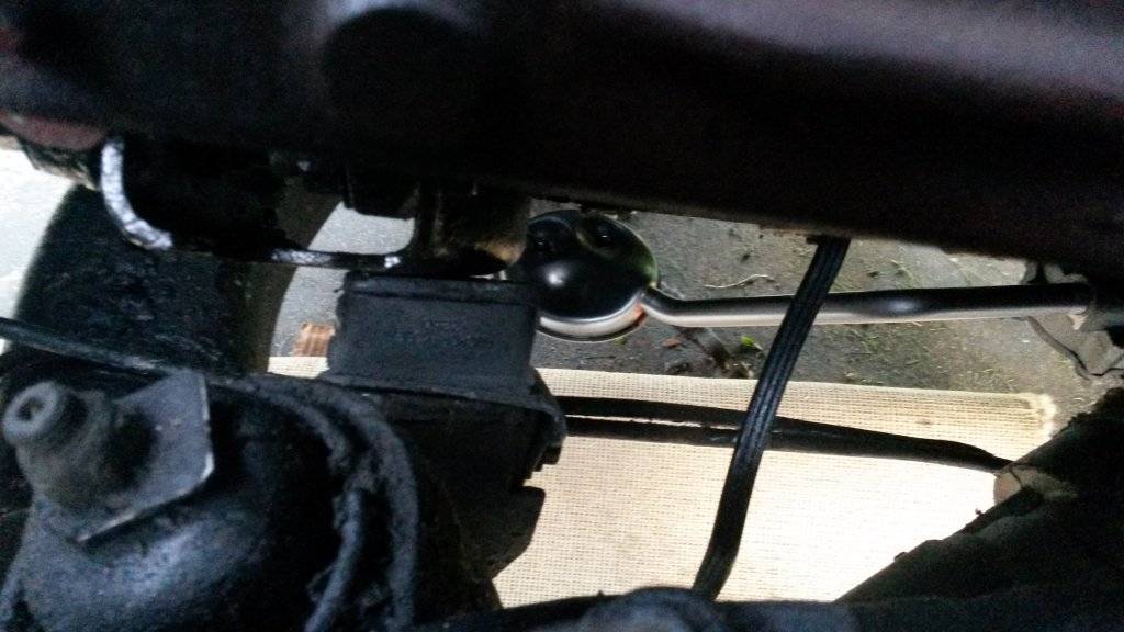

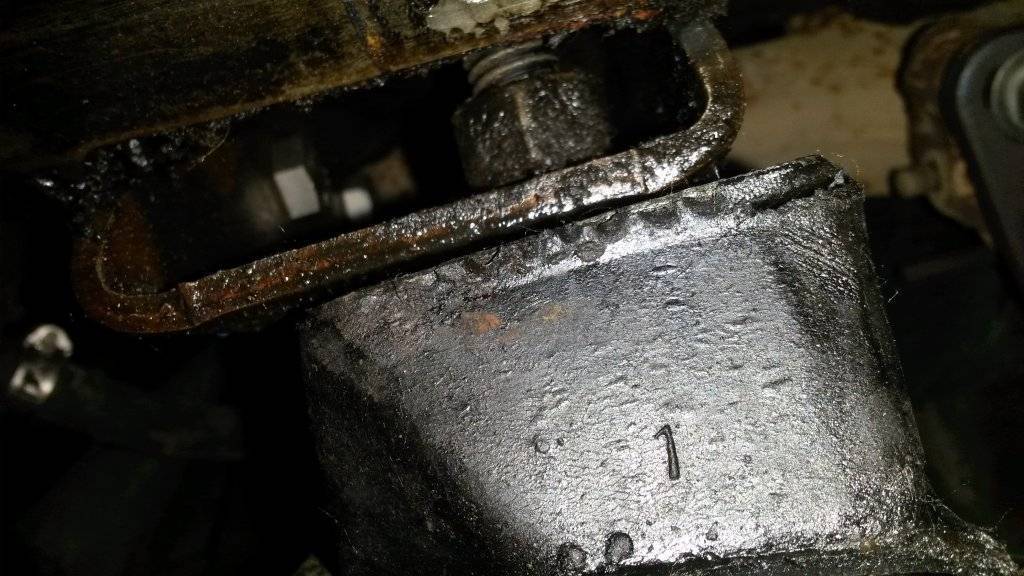

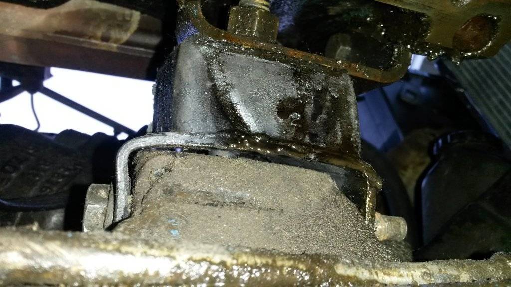

I spent a good chunk of time yesterday scouring my oil pan, trying to get as much old oil off of it as I could. I got the new oil pump and oil screen put on too. I gotta double check them to make sure they are on okay before I put the pan on. My dad said we should probably adjust the engine mounts while we are down there because they still look kinda off.
Hmmm... they're not really "adjustable".
I'm guessing a new set of mounts may be in order.
Yeah that might be the case. They aren't quite sitting right, between the engine mount and the mounting surface that is. Some of the rubber isn't making full contact with the mounting surface. I'll take a few pictures to try and illustrate what I'm talking about.
I guess they could be the wrong mounts. But thats sort of weird because they fit and everything. Maybe it's another case of subpar korean parts.
You might as well replace them while you're at it. You will not break the bank with a new set.
That might end up being necessary, Which is too bad because they are pretty much brand new. Less then 500 miles on them probably.
Those are the engine mounts. Two are I'd the driver side (the first and last i think) and the other one is of the passenger side.
