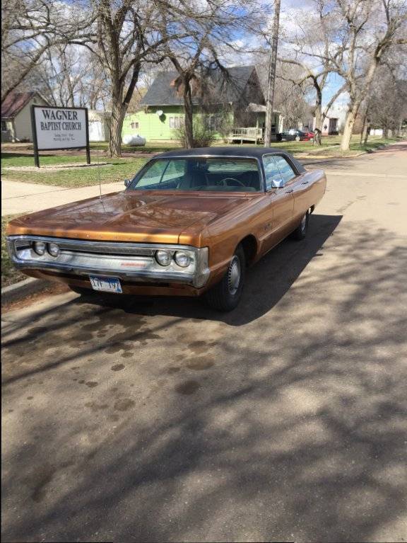

'71 Sport Fury

Not to steal your thread, but look at her now:
Nice going with your efforts so far; keep at it. I used to ride around in a 71' Sport Fury..had a very healthy 440. Terrorized the foreign iron constantly. Good times..good times.
