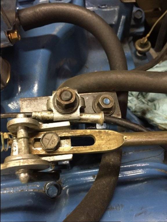

I used the factory setup on my 71 FuryIII. I made a plate out of flat stock and moved the throttle cable bracket back a little. No problems with acceleration or shifting. Worked like a charm.
Oops. I also filed out the slot in the kickdown linkage so I had more adjustment.
Could you post more pictures Bart?
Did you use the solid bar kickdown linkage or the segmented one? Did you just modify the 2bbl bracket?
I drove my Fury to Helena Mt last month, so I can't get other pics until I move over in May. I used the solid bar on the factory 2 bbl bracket. All I did was take flat stock, drilled a hole in it to mount, and filed a notch on the edge so the nipple or tab on the throttle cable retainer would sit flush. I made the notch oversized so I had some adjustment in it. Use the solid bar linkage, and grind or file out the slot towards the front of the engine for additional travel. You want to keep pressure on the shift lever of the transmission at all times, so push the "bar" back so the lever is about 1/2 way through its travel, then tighten it down. You then take it for a test driver. If it kicks down at part throttle and shifts when it is supposed to, you did it correctly. If not, loosen the bolt and adjust it a little at a time until it is where you want it! I think mine ended up less than 3/8" forward of the original setting.

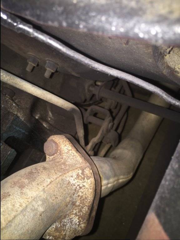

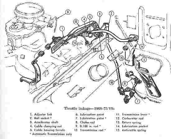

thanks Bart, I'm still trying to get the 4bbl segmented linkage to work, it looks like it has this elbow thing needs to be hooked up to something (number 7 on the kickdown linkage according to this diagram) But the only thing within reach is a bolt that seems to go between the shift linkage and the starter. Otherwise if that isn't it that it just flops around I guess? But that couldn't be right. could it?

I think there should be a boss on the transmission for that piece. This is from my '66 Fury.
