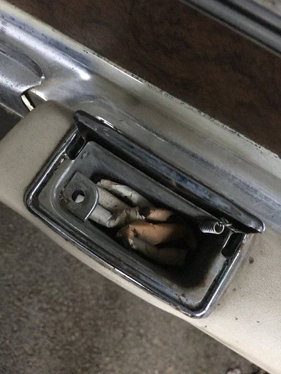

:rofl: You might be overdoing the "preservation" thing...:thankyou:
I'll try to post a photo. I think one had lipstick stains. Trying to imagine a C-body carload of smoking people rolling down the interstate in Oregon in the 70's. Forest fire waiting to happen. "Oh wait, we ALL have ashtrays. No problem." Smoky Bear is pleased.

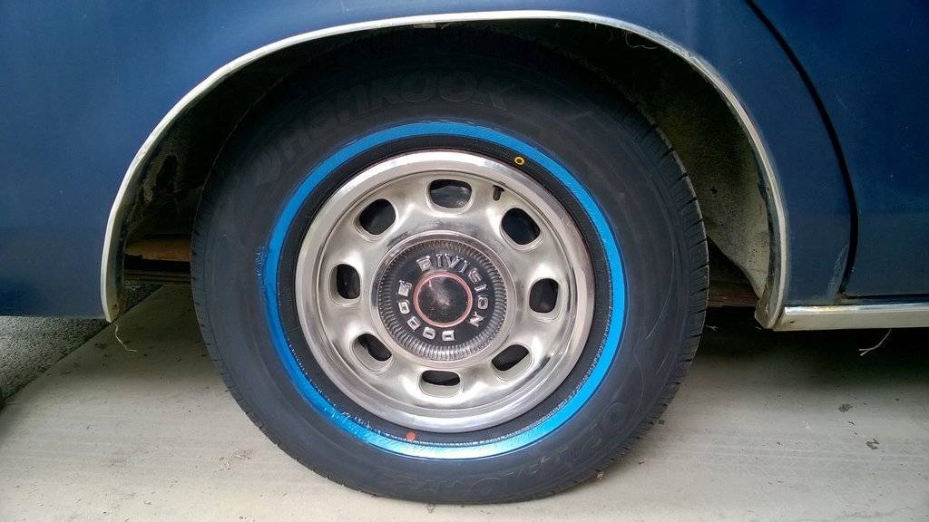

Got new white walls. Drove up the street with them. World o' difference....glad to be rid of the old tires.

Went on extended drive to auto parts store. A little nervous, but with new rubber I took it up to 50 mph. It did fine. I continue to be impressed with the engineering of a car that was designed to be maintained by people who could be trained fresh out of high school and make a career of being a service technician.There are a lot of things I like about the digital age, but not being able to fix personal transportation with just simple tools like a socket set and a screw driver is not progress, in my point of view.
Oh well. Enough philosophy. I feel like this little road trip was an achievement. I can see things on the horizon that are going to require professional help, partly due to limitations of my skill set and partly due to time. The brake and coolant systems need flushed, the A/C should really get functioning again (hate to think about that $$$), wheel bearings should get checked/re-packed, headliner needs replaced, as does the carpet and the upholstery...and the paint....pretty soon your talking real money.
But doggonit the wheels look bodacious. Thanks to...Steve?... in AZ....(Revision: Thanks Chris!!)

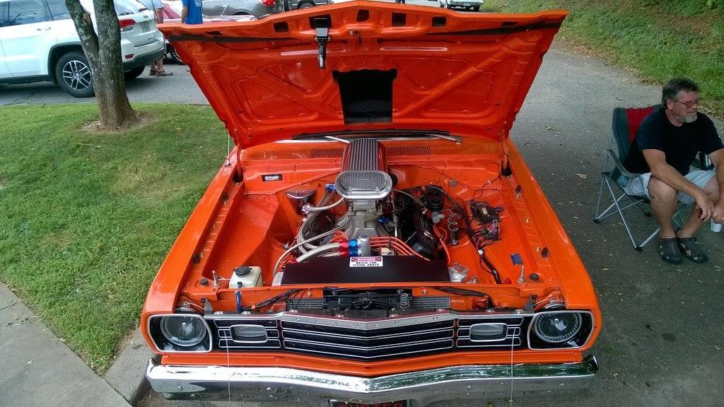

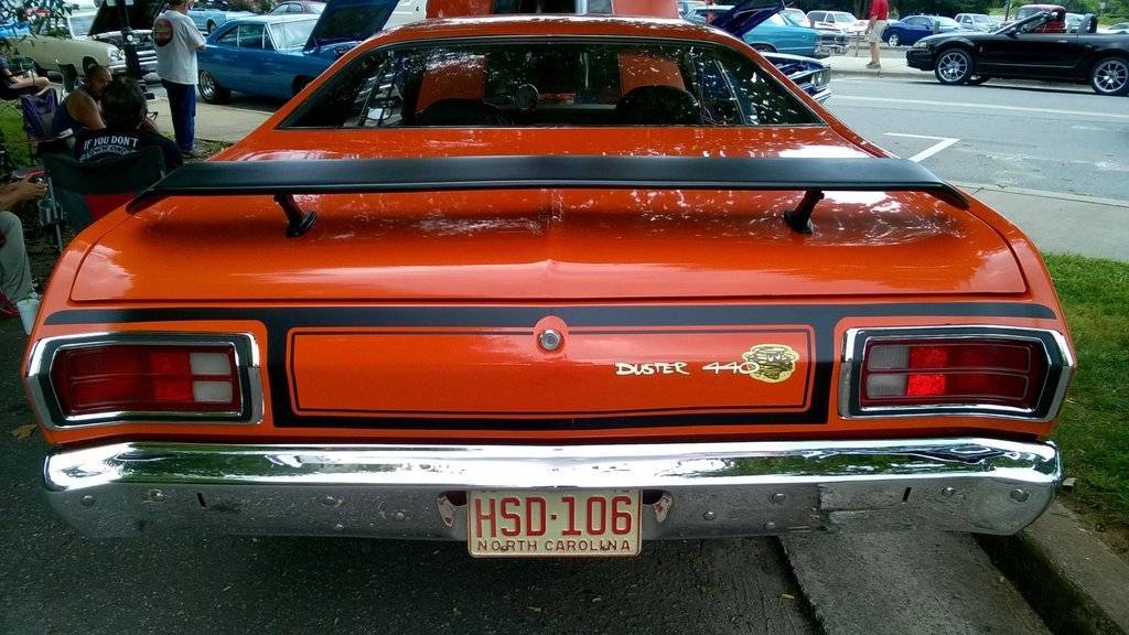

We had a cruise night in my town. I will post a few photos here just for fun. The Duster decal artwork should cause a chuckle. A little "revisionist history"...

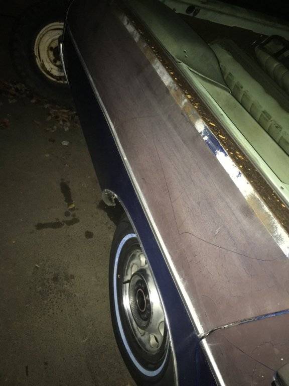

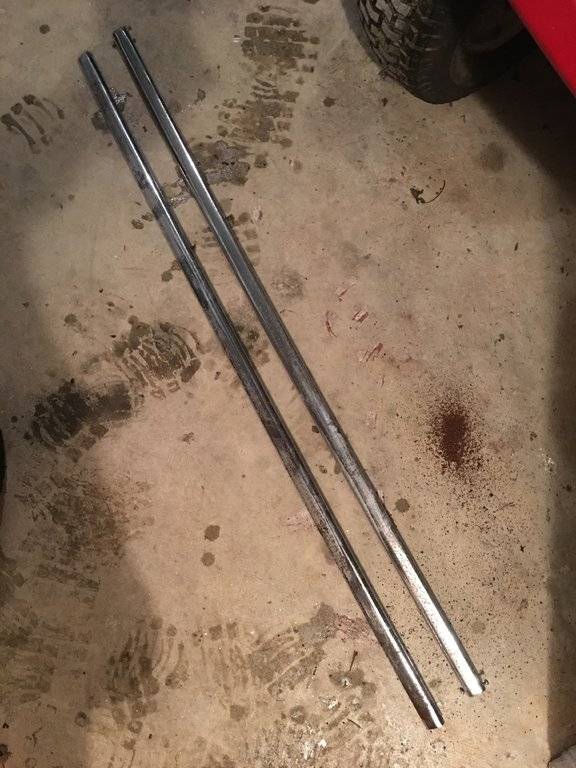

Need this silver rub strip trim, for the Left quarter, if anyone knows of somplace where I could get one.
