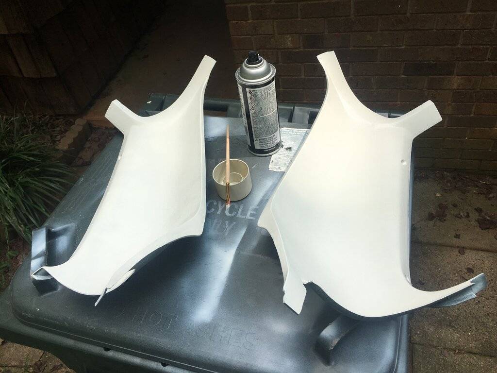

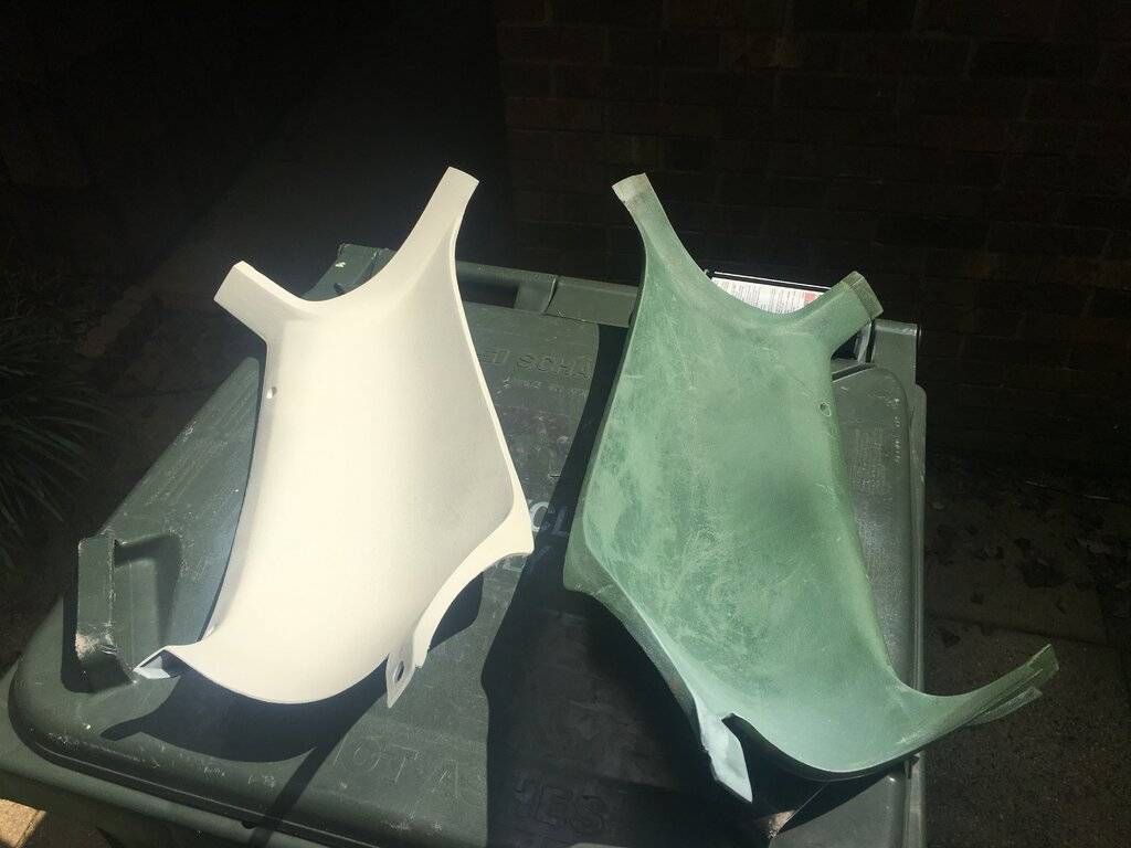

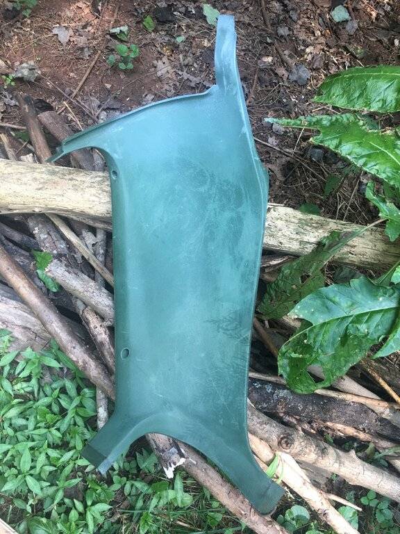

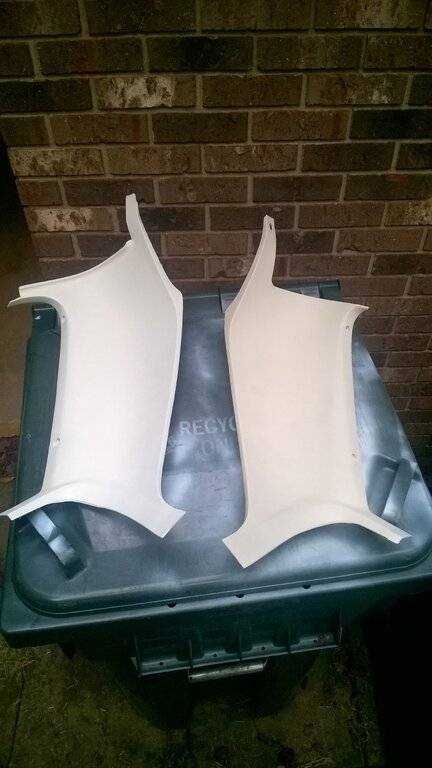

Well, while waiting on the interior I used some SEM paint on the D-pillar plastic panels. They were originally from a green ‘junker’ at Leon’s Salvage, I think. I like the results, but the color I chose is too white and not enough “sand/beige” to match the factory color of the other old panels. I’ll probably get another can of SEM a darker tan shade. Otherwise, pleased with the results.
Darkening up to make both closer to original. I have since painted both to look like the one on the right. These were both green originally.
First one was SEM “Super White”, 2nd color (closer to original) was “Phantom White”.

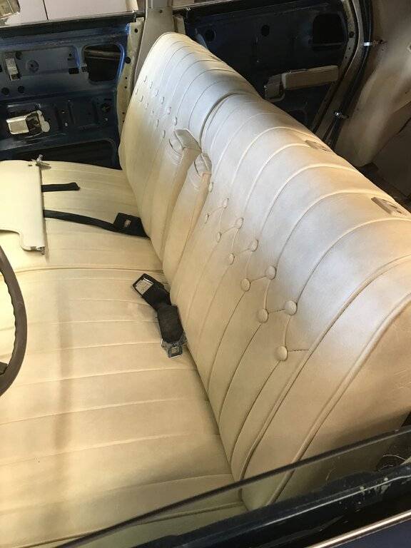

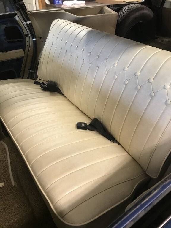

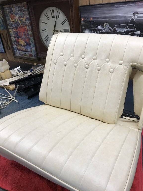

Got some pics from the shop. Pleased with progress on seats. Pleats, moveable armrests, piping/welting, diagonal stitching with buttons, all were a high end addition for seats, “back in the day”. I’ll post more pics when I get them.
Thanks everyone. The interior is getting a much needed transformation. Carpet, seats, headliner. Can’t wait to see it in person. I’ll post more pics as available.
WOW. Is all of that a duplicate of stock or an upgrade? Leather or vinyl? Looks fabulous.
Duplicate of stock, it’s vinyl. It was hard to match, it is a high grade vinyl. They made something ‘similar but different’ on early 70’s Cutlass, but that GM spec stuff had more “shiny metal flake gold tone” to it. This material came on a roll, from SMS. There are actually two different types of vinyl in the seat. The side facings are a slightly different material, closer to pure white. I used to work in an OEM seating company, so this stuff has been kind of fun to see come together.

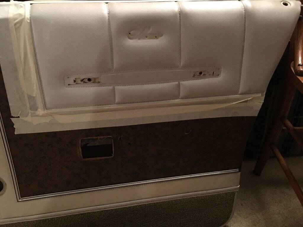

Going to try my hand at de-din-gee-ing the door panels. They’re not in bad shape, the white panel in the upper armrest area just needs brightening up. I got some SEM paint for the job. It’s “Sailcloth 15603”. I told them I didn’t want gloss and I didn’t want flat, sort of in between.
I cleaned some of that fine Oregon loam out of the cracks. I’ve cleaned these a bunch before with Dawn-type soap and lanolin hand soap. They just refuse to brighten up, sadly. I’ll probably wipe them down with an alcohol wipe to get any residue off them.

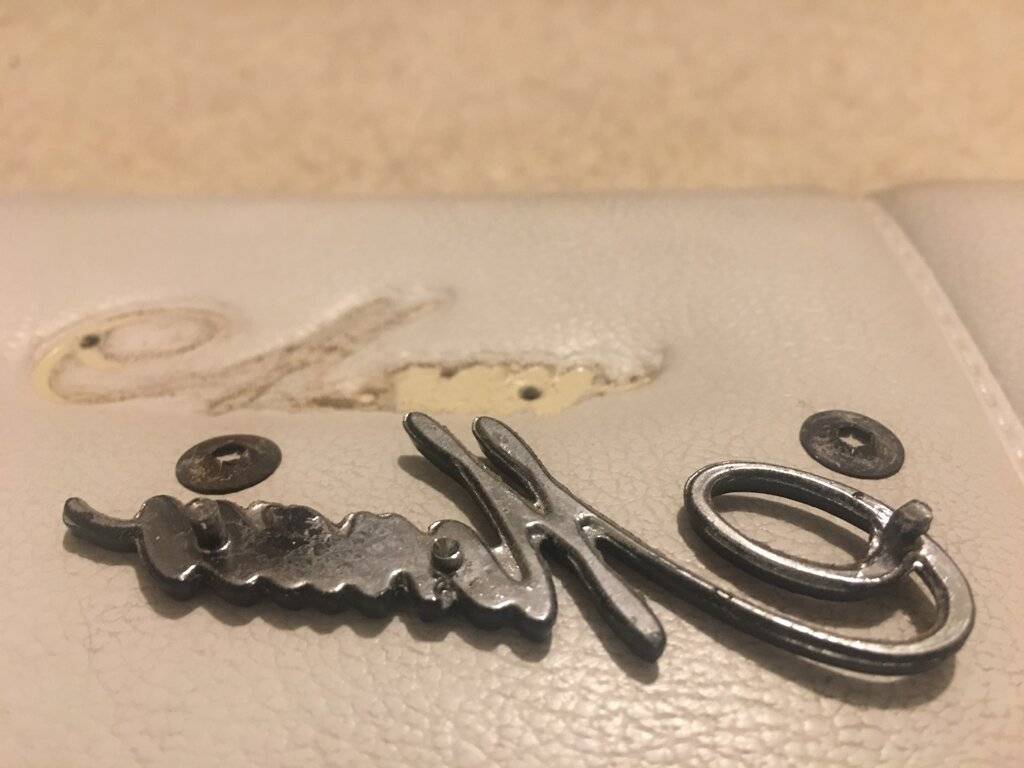

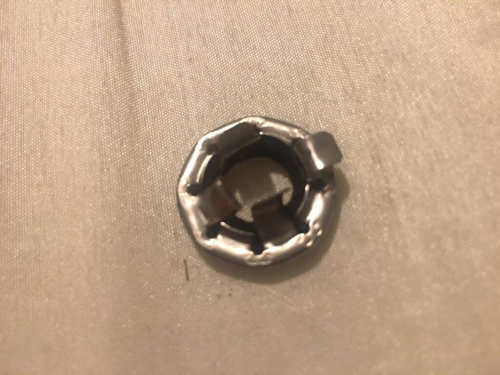

First step is removing the “Monaco” emblem. It is staked on. It’s made of METAL. Not plastic! I just used an old pocket knife and gently pried on the washers and they fell off with a little effort.
Here is the backside of the emblem, and the stakes that secure it, along with the (2) “lock-washers”, or whatever they are called.
Removing the door lock post hole surround. Or whatever it is called. I found an old Solingen pocket knife with a broken blade in the spare drivers seat I bought from a junkyard out of a 74 Monaco. It’s the perfect tool for this job!
