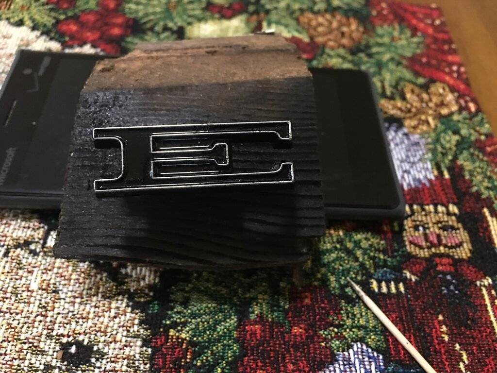

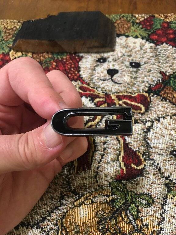

The tailgate letters. I really hadn’t looked too closely at these before now. That may be a result of the trauma of having paid a ridiculously high amount for them. “I just gotta have ‘em.”

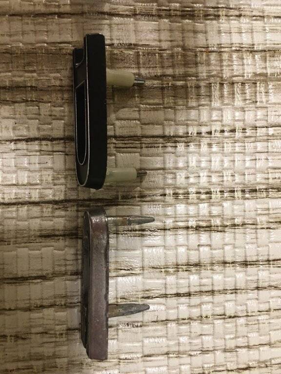

They have special retainers on the back...
Apparently the plastic retainers are available from Auveco. And I have heard some chain auto parts stores carry them. Will have to investigate.
If anyone finds the part number or a source like Auveco, let me know. I am the world’s worst at finding stuff like that. A buddy at the local speed shop said Auveco has them though. I guess I could always call them...didn’t have much luck doing a search online. Not sure the description.

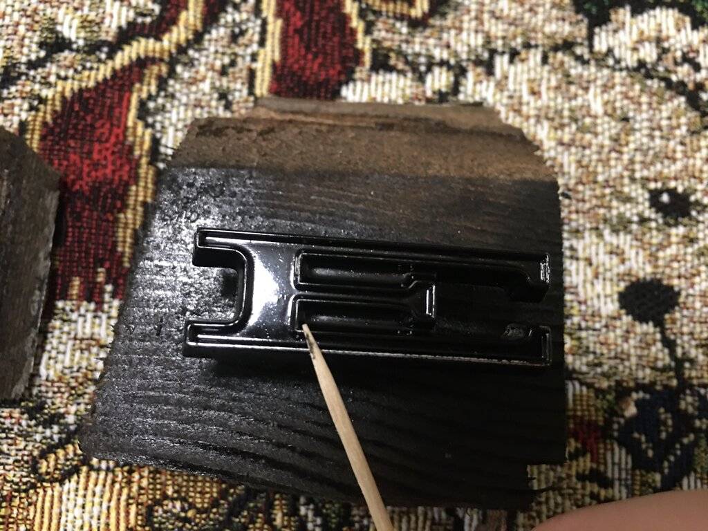

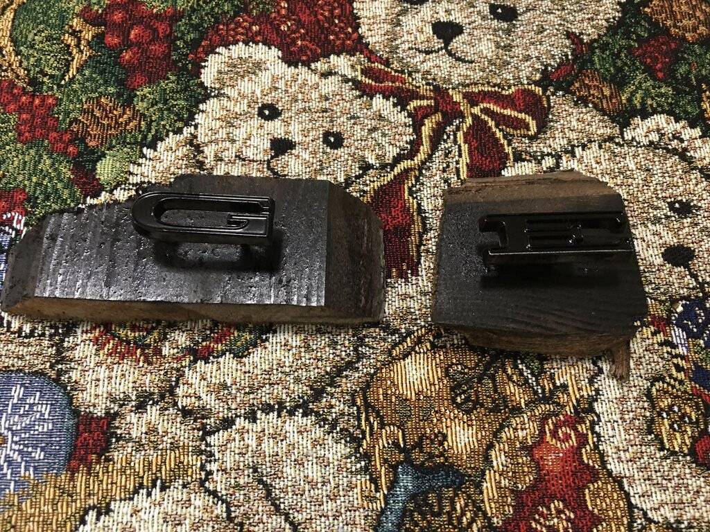

Looks good vWhat also works good to reveal the chrome, is to put some acetone on a rag wrap it tight around a piece of stiff cardboard or 1/8” hardboard and wipe across the top of your piece. The acetone will polish the top and the cardboard will prevent the rag sagging and wiping the middle of the paint.
Hmm. That’s a good suggestion. Thanks for sharing it. I’ll have to remember that.

Those letter look very good now and should give even more class to the rest of the exterior appearance.

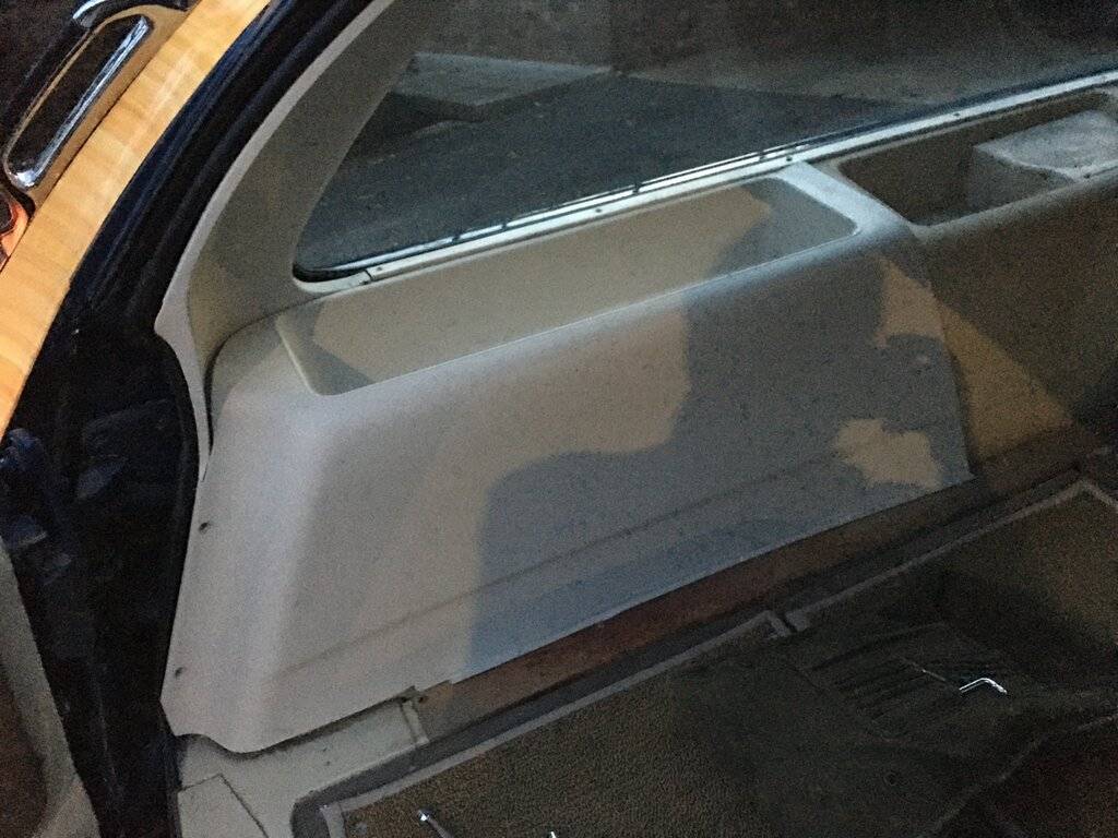

The rear overhead light bezel and lens. Out with the old, in with the less old...
Thanks to 70SportSuburban for the inspiration to think about the little things like this. When you go to the junkyard you have to be like the hog butcher. Use everything but the squeal.
I’ll clean up the two forward panels and SEM coat them later. Right now I am trying to make the basement den look more like an office and less like a parts warehouse.
