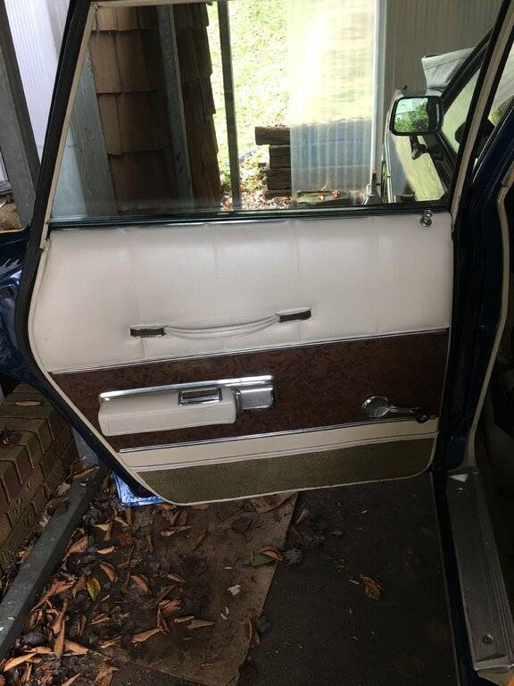

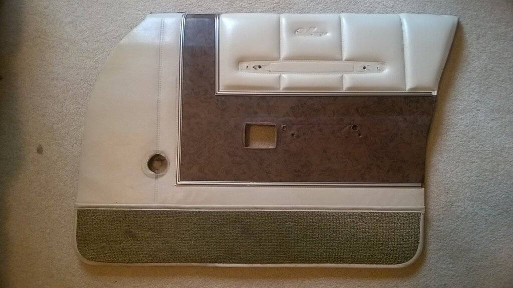

So. I painted/SEM coated. And the finish turned out well. But... upon closer inspection, it appears - looking at hidden pieces of the material - the colorants used on the upper “plush” portion of the door panel vinyl were originally the same beige/tan/sand color as the lower portion of the door, which is made from a flat sheet vinyl. Pretty sure it was not a two-tone door panel originally. So...I am going back to the color I used on the plastic pillar panels. I think it will look more original and cohesive with the rest of the interior. I’ll post photos as I go. The warm days are going away, so I need to prioritize finishing this.

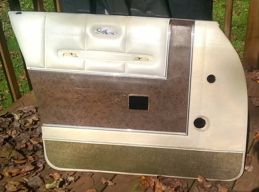

This is what the first try looked like. “Something Just doesn’t look quite right.”
The finish turned out ok, even tones, not too flat, not too gloss, but the color was just too white.

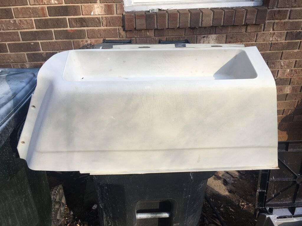

I still had some of the tan paint I used on the plastic panels. SEM “Phantom White 15003”. So I used it. Here is a panel re-painted with that. I decided against painting the lower part of the panel, to see how close it matches. I think it is much, much better.

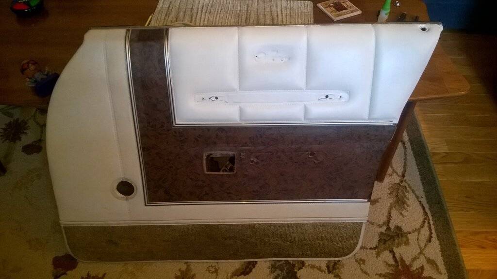

Here it is with the Monaco emblem back on. I’m satisfied with this. All four panels are now re-painted in this.
Side by side comparison. Incorrect B. Sheet on right.

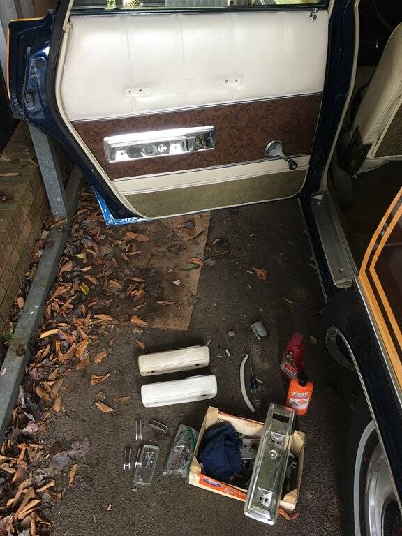

A little Saturday morning fun. SEM painted the armrest, which was a little nicer one I got from Murray Park.

I got rid of the “dead” plastic, the outer textured portion that had been blasted by UV rays all those years. Then it looked better. Still some big scratches but not too noticeable.
I scraped off the old plastic using a metal file cleaning brush. (Kind of like a curry comb from combing a pet!) It has stiff bristles on one side and metal bristles on the flip side. It required a lot of elbow grease but you also want to be careful because the plastic can be weak in areas that have seena lot of sun and been blasted by UV radiation. I guess maybe it was good this car was from rainy Oregon!
70 Sport Suburban recommended using steel wool, but I just had Brillo pad type wool and it was too fine to do this right. The really big steel wool like you’d use to clean an outdoor gas grill would be a good tool for this job. Use a little soap and don’t work too aggressively.
Finally, the SEM coat. Phantom White, as before. Pleased. Thanks 70 Sport Suburban for the tips on how to deal with these panels.
It’s not perfect, but it’s infinitely better than it was. And for $15, I can’t complain. Maybe someday I’ll go to a swap meet and find a nicer one.
