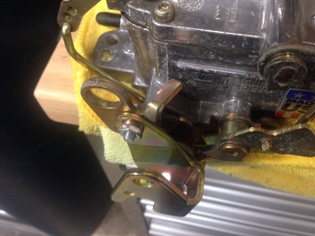

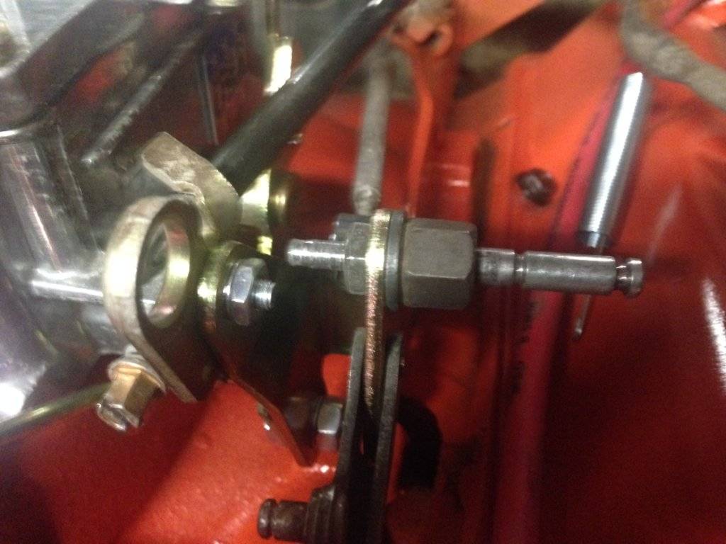

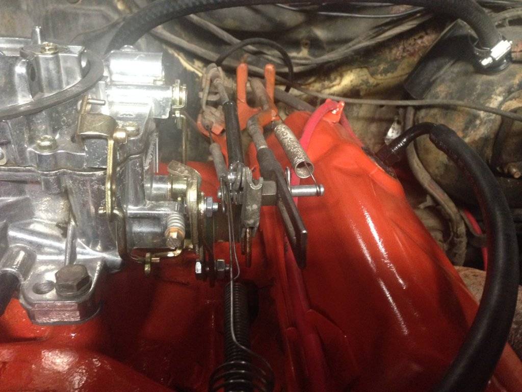

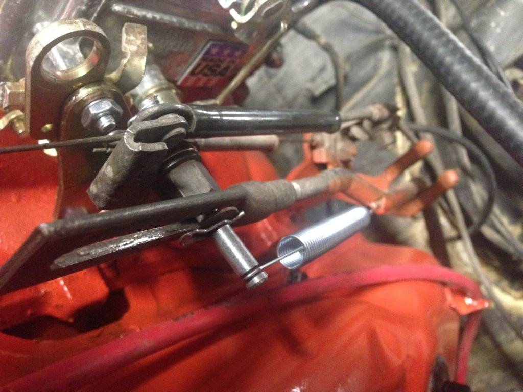

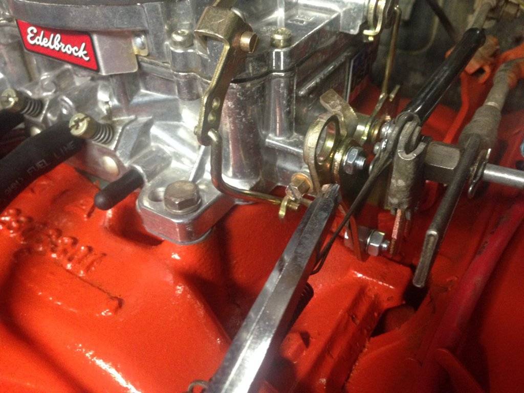

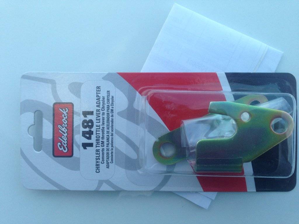

When you swapped over to the Eddie carb and the linkage didn’t work maybe you needed the Mopar linkage adapter 1481
That looks like it would have done the trick, I will keep it in mind in case I swap back, but I feel that I have the Tq close, I just ordered a jiffy kit to swap out the accelerator pump, I will post again with my results, thanks for the help
I plugged off Egr valve and that did not help.

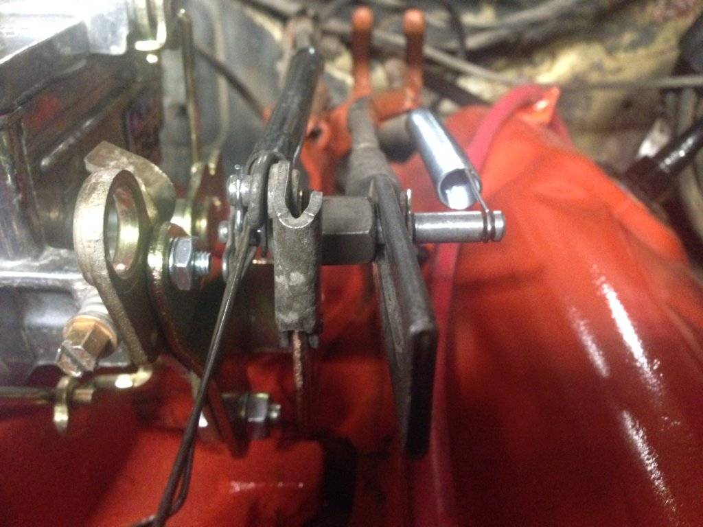

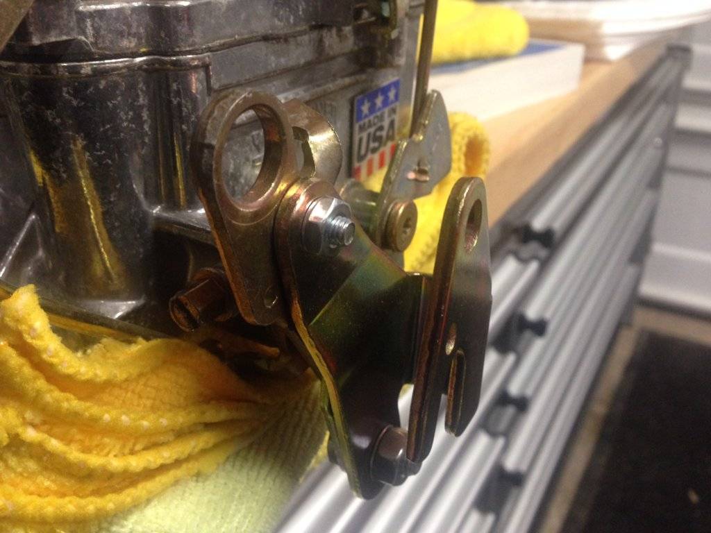

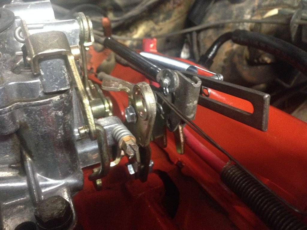

I then decided to swap to an Eddie 1406, I removed the Tq and I noticed that the linkage on the 1406 would have required some mods, so I decided to put the Tq back on because I didnt have the time to make the 1406 work.

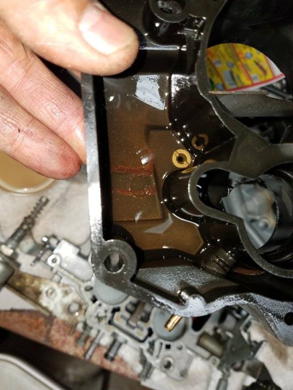

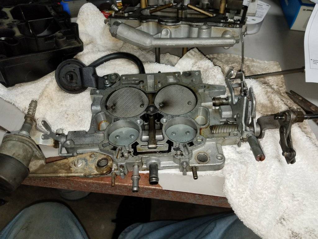

After making numerous adjustments and getting her to run better, but not 100% I ordered a jiffy kit and tried my own rebuild. The carb had a sticker which indicated it was rebuilt in 2014,

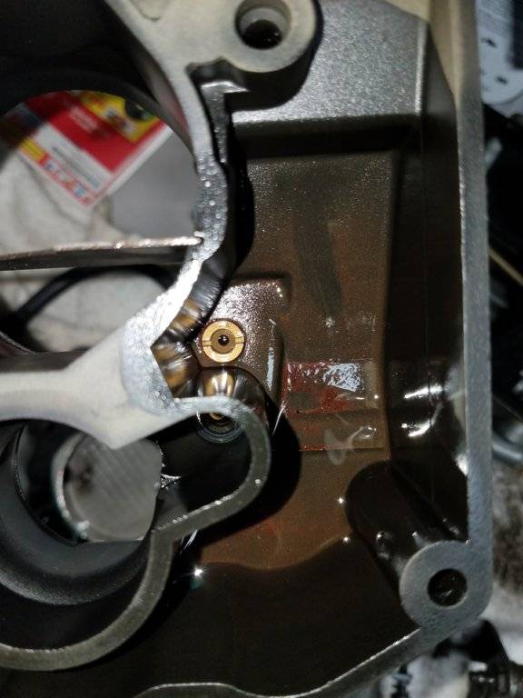

when I opened it up I found rusty looking fuel bowls, and gummy throttle body. I also found a stripped seat which had been repaired by the co. that rebuilt it in 2014. I also found the metering rods to be different sizes.
