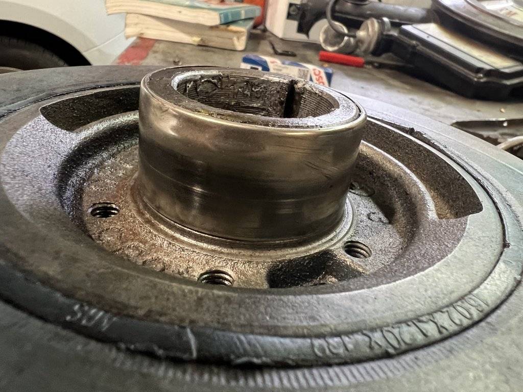

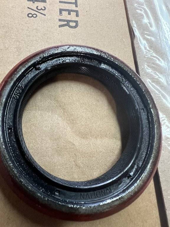

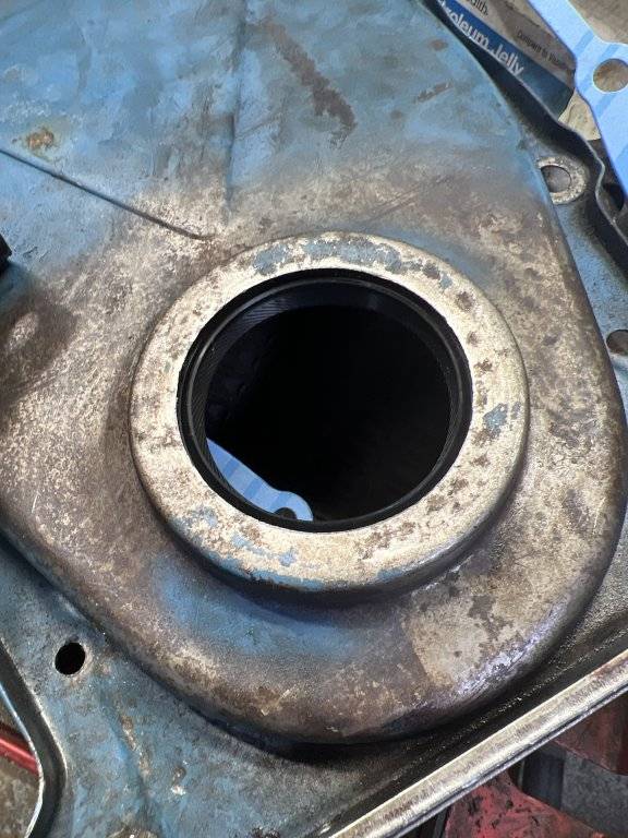

Found a leak at the harmonic balancer/timing chain cover….. posted a few questions regarding replacement… seal was also ripped.
Need a new harmonic balancer. Just posted some questions regarding fluid filled v original on the drive line transmission subject line. Here on FCBO.

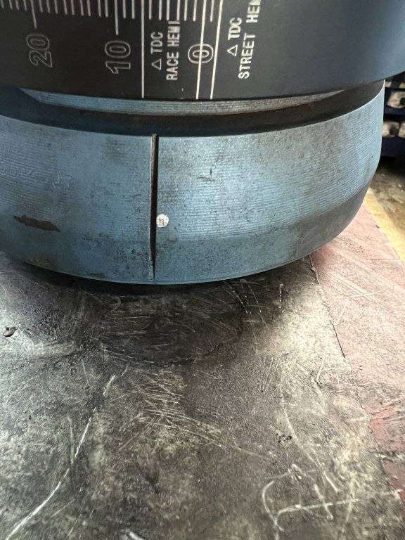

Harmonic balancer with swollen damper rubber and deformed seal mating surface
Ripped worn cover seal
New valve cover arrived. Nice and flat no wobble on table.
Well…. At least I know it won’t leak. Even more disappointed in original rebuilder. He should have noted this or perhaps he was the one who messed up the balancer….
Maybe it's just the pic, but that looks to me like one of those repair sleeves was pressed on. I don't know how those are in the long term...

Agreed… it is some sort of sleeve.
Looks like whoever installed it pounded it on or has no idea how to use a press. It is deformed (not flat along the rotational axis of the sleeve and damper on the surface of sleeve…. Not wear related)
Oil soaked bulging rubber mount for outer ring also “no bueno”.

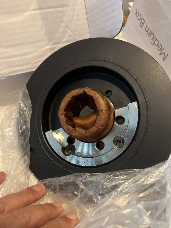

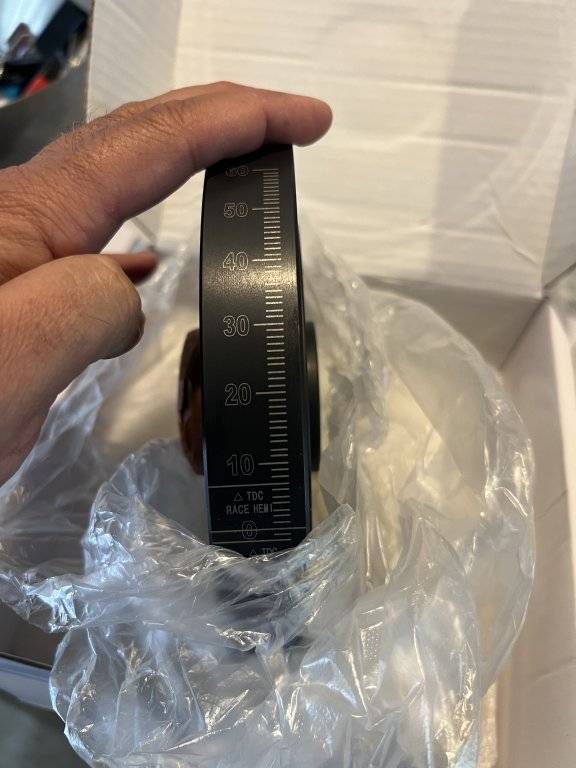

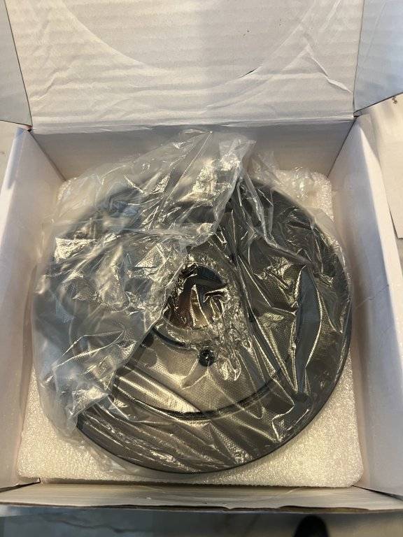

New harmonic balancer arrived last week and it lines up pretty close with the original.
Came well packed and free of any damage.
Eccentric weight came with locktight on screws as evidenced by the other side/end of screws.

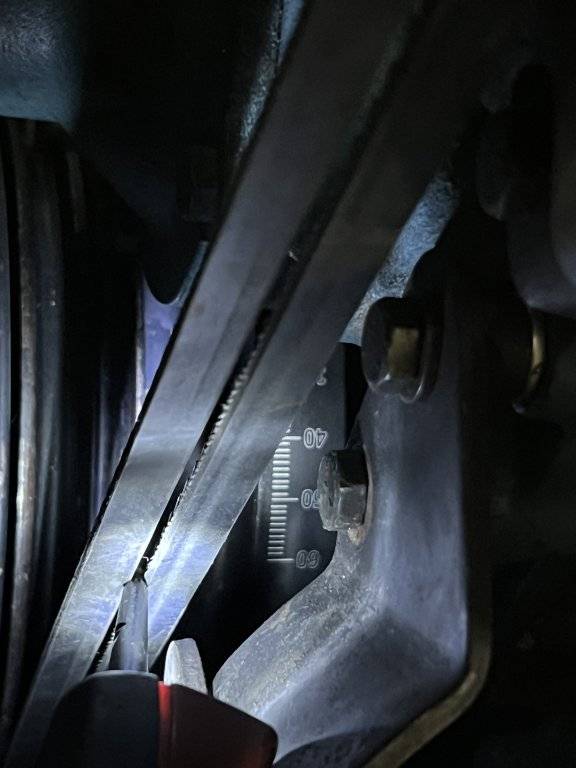

These markings may come in handy if (when) I add ignition timing control from the snyper computer.

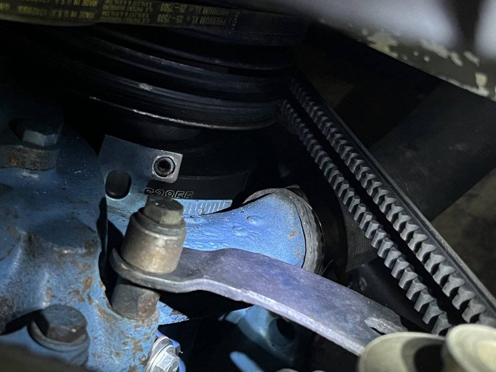

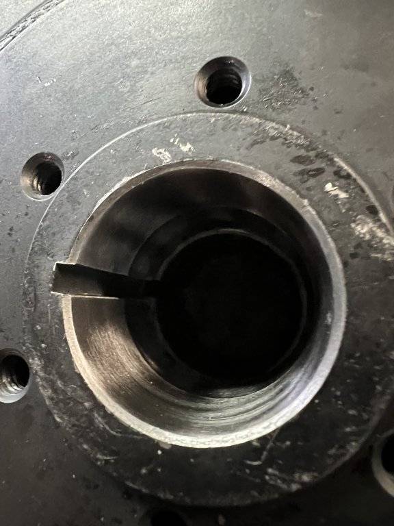

Using a straight edge from my micrometer to align old and new key ways …..
You can see the difference in alignment between the old and new timing marks.

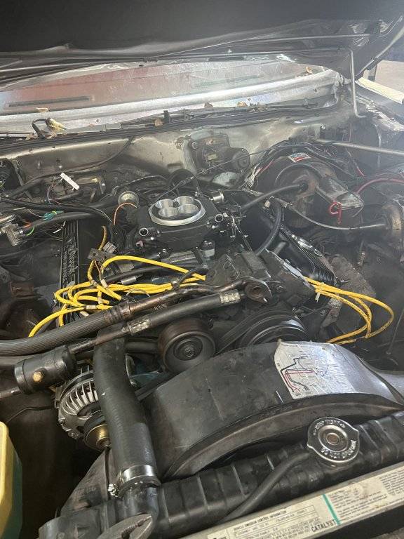

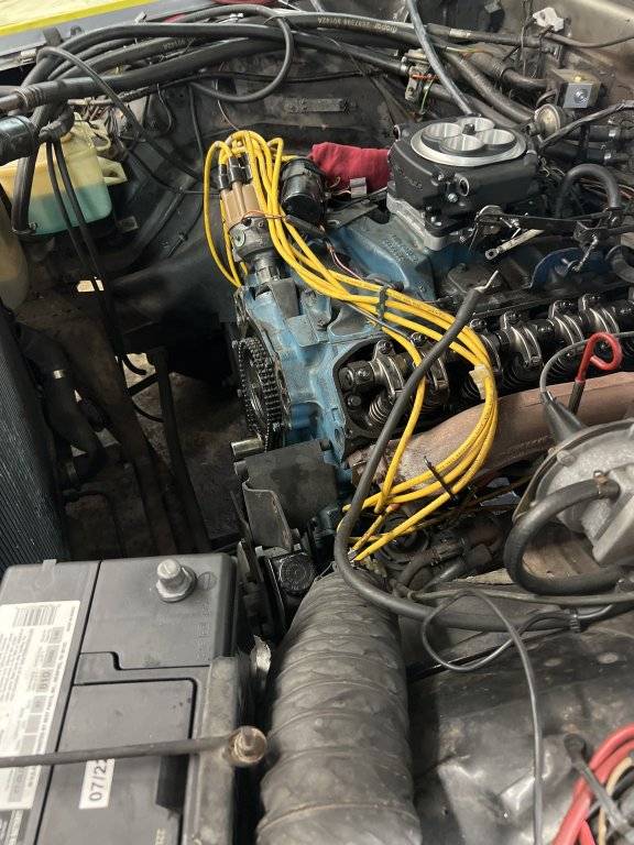

Snyper going in and the wiring fun will soon begin. (Had to step out of town for the weekend to visit my daughter.)
Bought last week was also a dual terminal battery to wire in the Snyper (as per instructions) directly to the battery. They don’t make a group 27 with duals so I had to step one size down. Still 800 CCA so it shouldn’t be a problem.

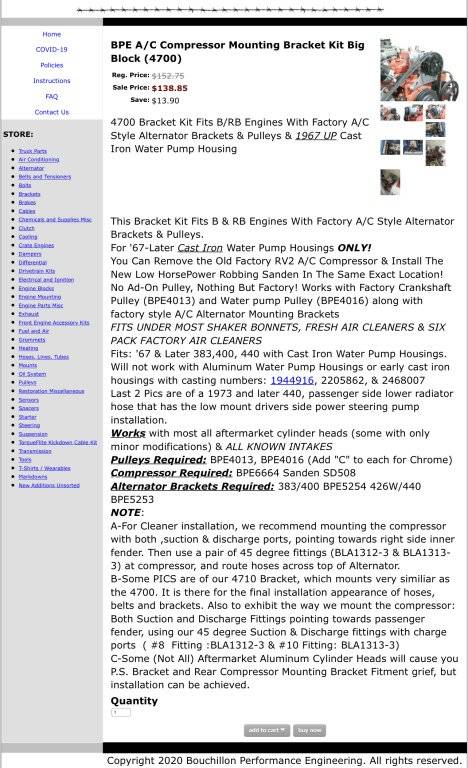

Jav. What’s your source for the compressor and brackets?
Bouchillion makes brackets and will sell with or without a compressor.
BPE A/C Compressor Mounting Bracket Kit Big Block - Bouchillon Performance Engineering

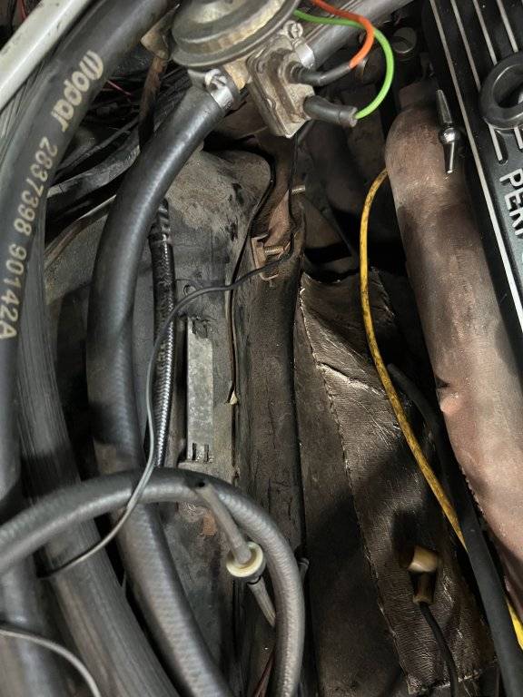

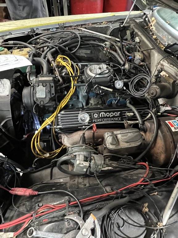

Things are getting snugged down. New vacuum lines going in and super and new (old?) electronic ignition are now in. Didn’t like some of the connections made so I’m redoing them. Also old lean burn harness is being retired.
RV2 is in for the pulley and to get the hoses out of the way for now.
New harmonic balancer in and checked and it is spot on.
Although I need change out the pointer.

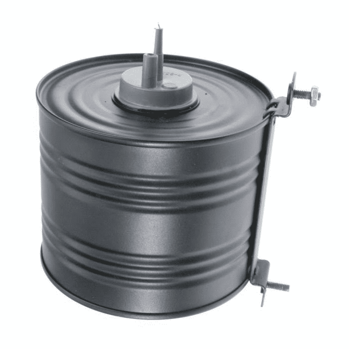

Still looking for the lost vacuum canister for the A/C…. If anyone has one they can spare, I would appreciate it.
You can use a Ford Mustang repro in its place.

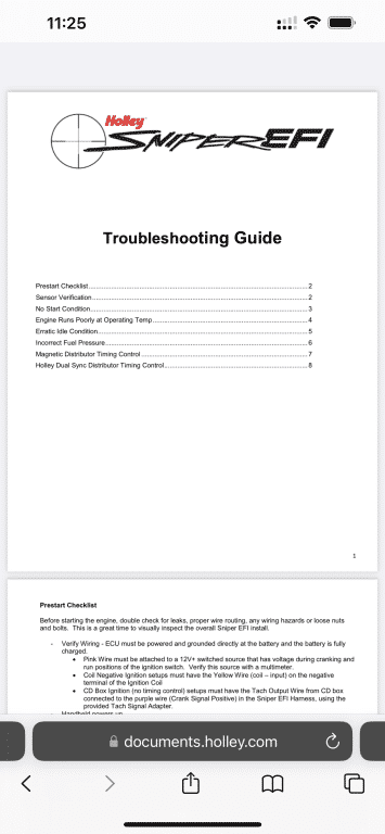

No ignition signal to the computer. Something is either mis-wired or not continuous.
Starting with troubleshooting guide tomorrow afternoon.
Huzzah!!!!!

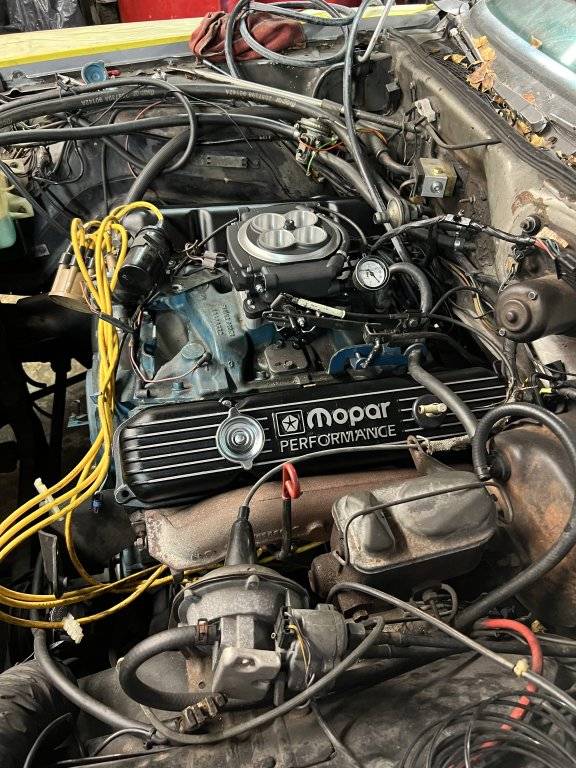

It lives again!!!! Got to the shop. Sorted some wires… asked a few questions. Checked the polarity at the coil… backward.
Fixed
Ran through the set up wizard… check. Cycled ignition to reset with the loaded parameters I checked and…… Boom. Spun about one turn and fired on the first try.
Ran it up to temp but didn’t drive it yet. Still too many things left to do.
1) put in new distributor ( it wasn’t working because the pick up was not close enough to reluctor for good signal.)
2) have them put old distributor back in the wagon. They took it out suspecting the new one was off but didn’t know what was wrong.
3) passenger side exhaust manifold leaking coolant through studs at rear. Looks like an old Stanley steamer with puffs and whistles. Pull manifold and confirm studs are set correctly before tightening
4) I removed the excess wiring for the LeanBurn connections and sensors (no longer needed. 2 hours of careful unwrapping and reading the FSM.) Need to clean up and route new wiring according to plan. Looks a lot cleaner already.
4a) finish installing ignition.
5) get a new stud for the air cleaner.
6) remove lean burn from air cleaner and cover openings. Was thinking of leaving it but it’s just in the way. Besides… it covers up the fuel pressure gauge.
7) sort linkage for better operation. It will run up to 95% of appending as is according to the TPS. But…. Not happy with how it works just yet. I’m a bit of a geek that way. Need to create some clearances to avoid close contacts. Raise the throttle cable mount a bit for better angle of linkages.
8) Test runs so computer can learn.
9) check pushrods for clearance. They sound a little ticky still (to me)
