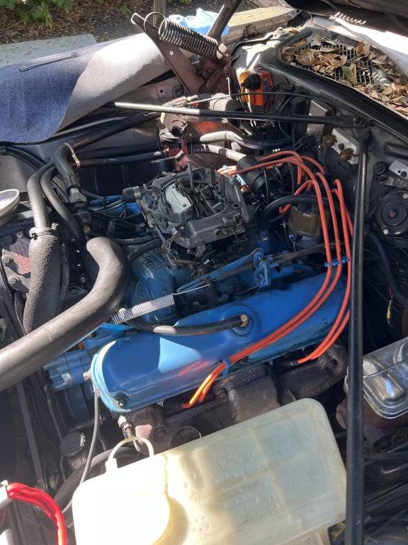

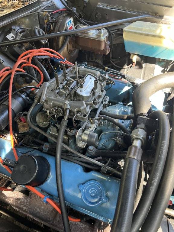

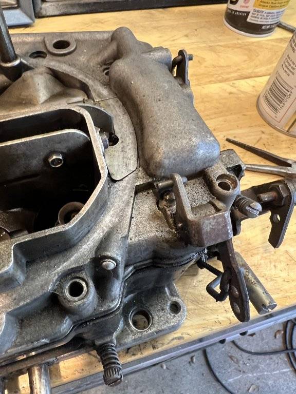

Here you go. Before and after of today’s fun…
Before…
Before
Before
After
After….. been 10 years since I went through it. It was running a little… off.
Back to normal now. Nice and even. Not sniper smooth but close enough for 50 year old carb.

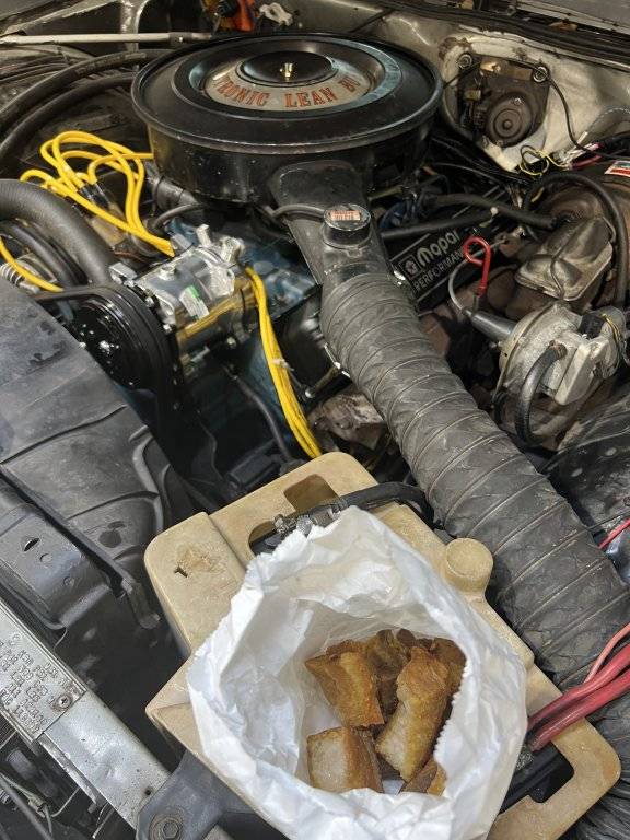

So. Wait. What!! You gave up on the sniper and installed a small block with Thermoquad? Nice, Nice....
Even got that little thingie because it idles like **** if the AC kicks on...
It won’t be needed when I replace that auxiliary engine of an RV2 soon…..
in for a penny….
By the way…. That 340 can pull. Purple shaft and built up block to 9.5 comp. A little light on low end torque compared to the 440 in the wagon or even my old 318 in its predecessor…. but loves to rev. Comes to life at 2500 rpm and sings all the way to 5500…. especially when cool.

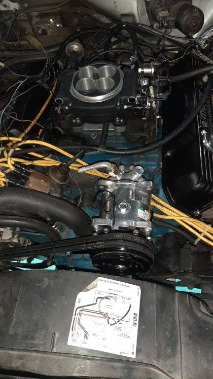

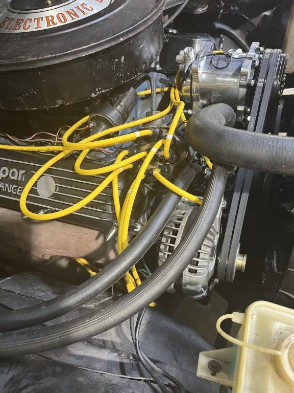

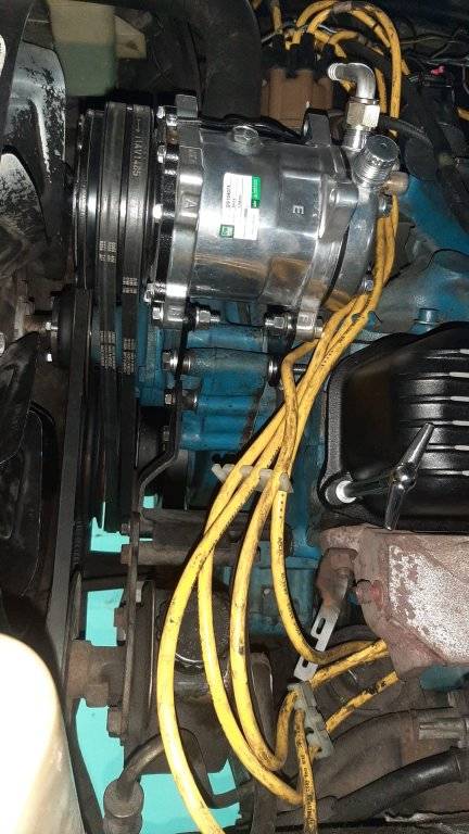

Install of compressor in process…. What a difference…. So much room!
Overhead view…. Had to put a few spacers on the alternator to get it to line up.

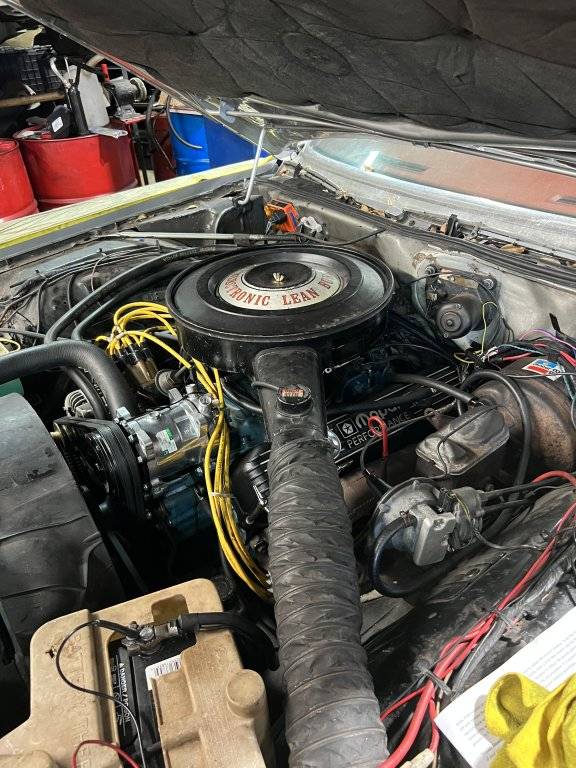

I think that vacuum diagram will need to go.
Better overhead view.
And, yes, it’s taken from a ladder. Nothing but the best for my buddies here on FCBO.

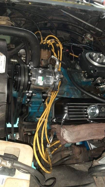

Driver’s side view.
More general view. Old lines go out tomorrow with length for new ones I calculated today. Expansion valve and dryer ordered today.

On the Sniper front….. still working details.
Replaced exhaust manifold nuts and managed to stop the Stanley Steamer leak.
Not getting a good vacuum signal from the Sniper distributor port but I’m pretty sure it’s an idle setting issue with the throttle. I’ll play with it a bit more tomorrow…. After we put some gas in the tank. Between the line flushing and bone dry tank, we managed to burn through what little was left of the three gallons pretty quickly.

I'm concerned about your using shims to get thru Sanden properly aligned.
Using a genuine Sanden and the bouchilon brackets, I had a perfect fit. No shims.
Some research last night tells me to check the IAC/throttle setting regarding the distributed advance vacuum signal.
Hey when I installes my compressor with the fittings straight up one of them was hitting the hood! Make sure you have clrearance!

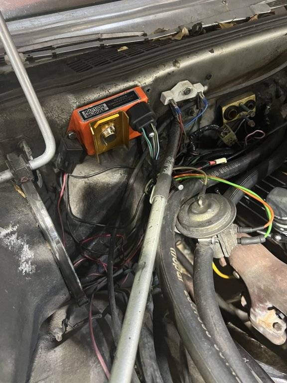

Some details done over the last few days.
Changed out the ignition module and sorted and started wrapping some of the wires. Still need to combine and put proper clips on the wires going to the ballast resistor. Next time.

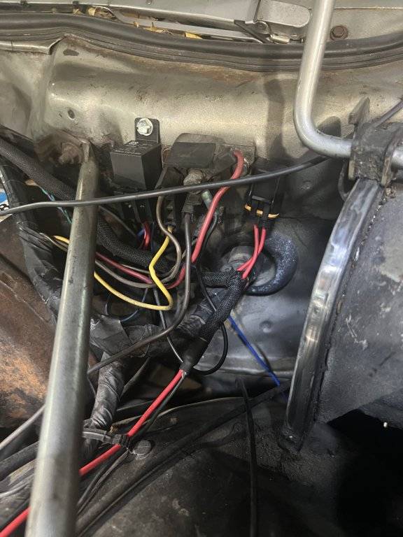

Placed the Sniper main power and fuse on the firewall next to the starter relay. Looks clean and in a logical place. Other side of the starter relay is the relay for the fuel pump.
Instructions were unclear at this point as to the source for power and ground for the relay. Main sniper harness has a blue line marker “Output Ground for Fuel pump Relay” while the instructions called for a separate independent ground. We went with the marked ground in the harness. Worked fine.
Likewise, power for the fuel pump is in line with the main power to the Sniper Computer after the 30 amp inline fuse above. Again, instruction for both the sniper and the fuel pump did not show this.
Numbered the wires for future reference (for the boys in the shop not me) as it’s been a lot of testing and swapping of distributors, caps, rotors etc to get this far.

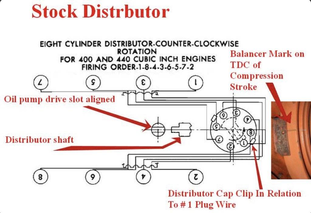

Maybe you've mentioned it in this or your other thread, but is there a reason your distributor is setup 180 degrees out? Stock #1 position is around 6 o'clock?
You are correct. But it makes no difference. My biggest concern was that the advance was more or less up to allow for ease of timing adjustments.
It’s one of the reasons I labeled the wires. When I get it home I’ll address it. Thanks.
From our sister B body site…. For later reference.
