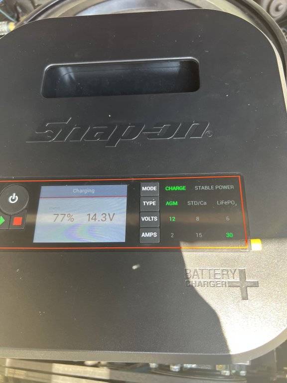

Great new battery charger at the shop. It actually started at 70%. Alternator was putting out all it could at 14 volts and the system would not stop charging and wouldn’t produce more than 12.2 volts at idle. After two days of intermittent charging and resting, all is now good.
You may well have some little short draining that battery. Don't be surprised if you need to jump start the car again. Starting at 70% of WHAT is my question. You got enough charge into that battery to turn the motor over, but something sucks current off, OR, your alternator won't charge decently at your idle. Mind you, the OLD alternators were pretty crude, so 12.2 V at a 600 rpm idle wouldn't be too low. With everything turned OFF, use an ammeter at the battery and see if current isn't still trickling out.
Good idea…. Will check it.

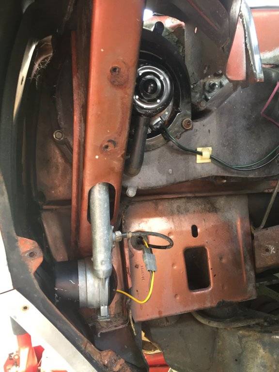

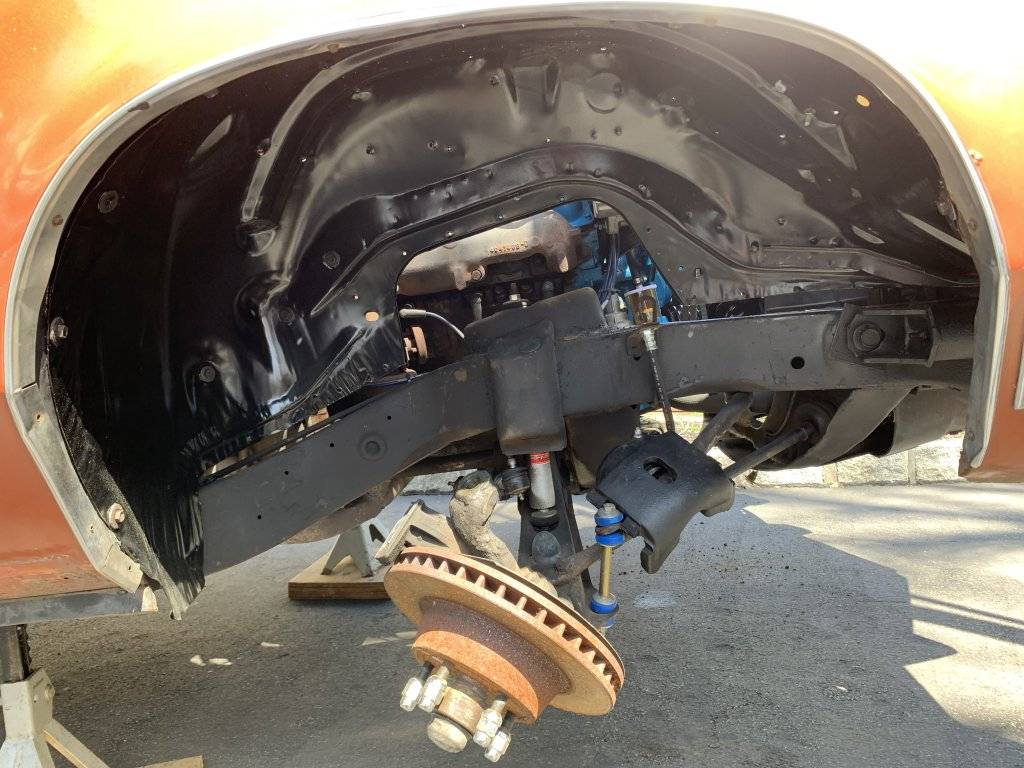

Pulling front passenger side wheel house for access of/pull A/C fan to vacuum out debris…. From the noise it must be quite a lot. (Perhaps someone’s home?)

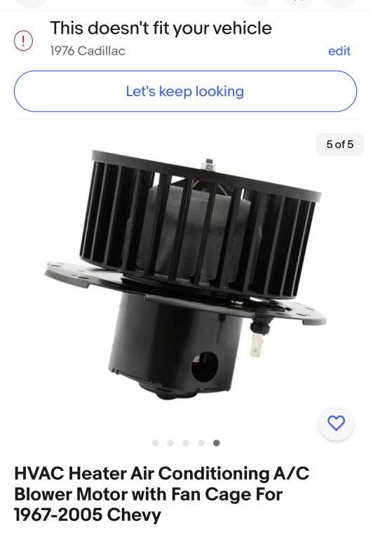

Also, replace the fan with a GM unit. Exact fit, more powerful.
One of these?
Surprise cool thing also in progress.

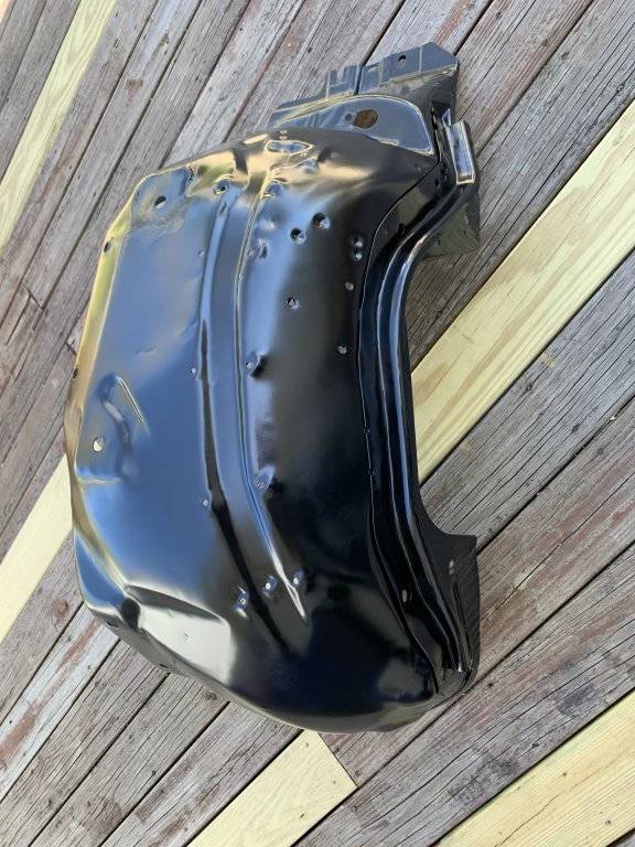

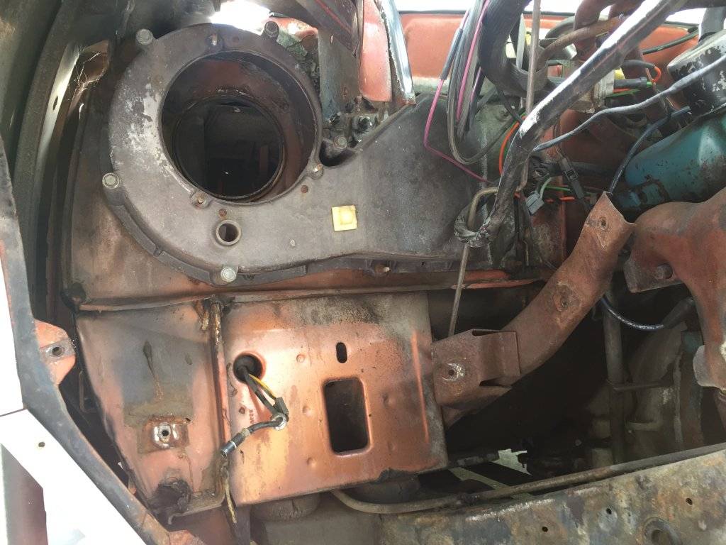

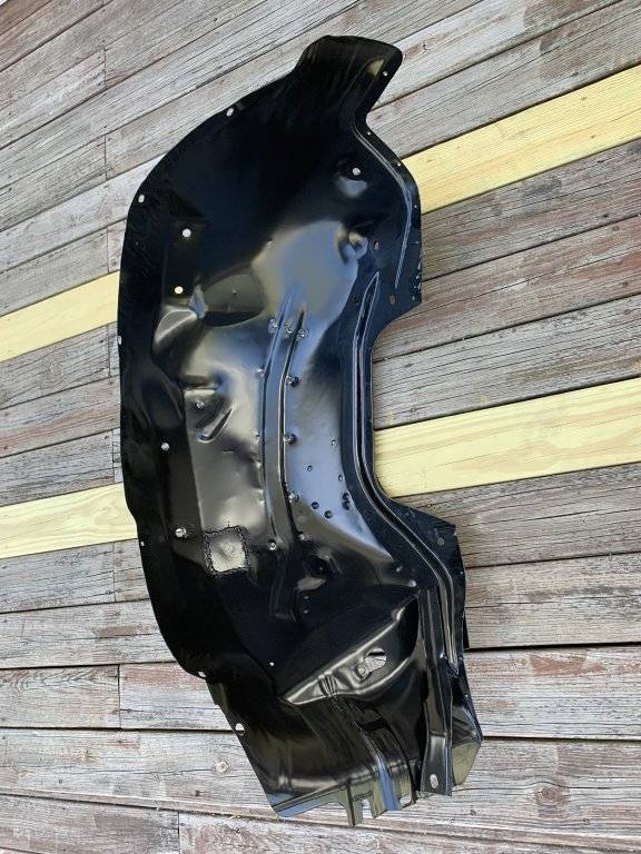

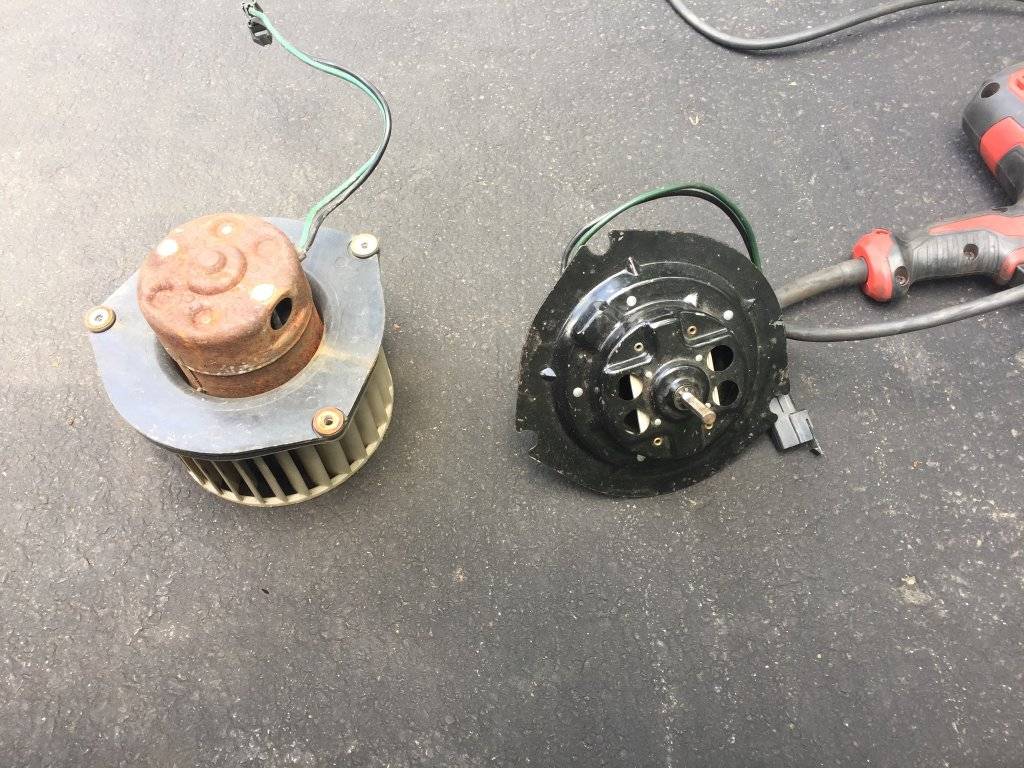

Did the same to mine a couple of summers back. Don’t know if you ever pulled the inner wheel well before, but should come out pretty easily, going back in can be a little tricky. I had both of mine powder coated while out. And was being careful not to scratch. So that move added to my difficulties. Also Give me a chance to install a new fan motor and newly refurbished power antenna.
Not intending to hijack your thread Jav, just sharing some pictures of what you’ll see when you drop the inner fender well.
Thanks! Very helpful my friend. Especially the views of the fan.
Did you change the fan?
Certainly, glad to help. I did change the fan motor but not the squirrel cage. I don’t know that tue OE motor was bad, but I happen to have a new one, so I just walked out.
