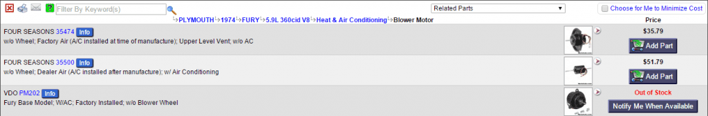

It's right there. 3rd one down. PM202I'm going to check this weekend If I can figure out how the inner fender should be removed. I was looking on Rockauto for blowers motors to replace mine for a new unit just to discard any problem, but... there are not blower motors available for '74 Fury with factory A/C
Can I use other blower motor?
