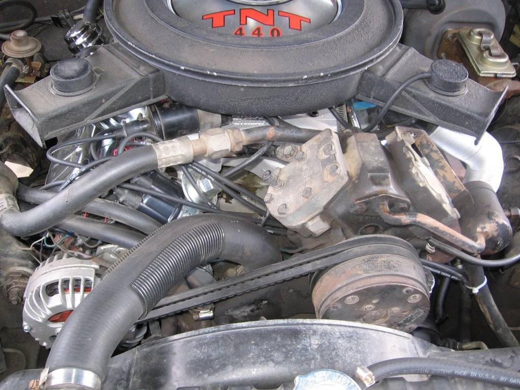

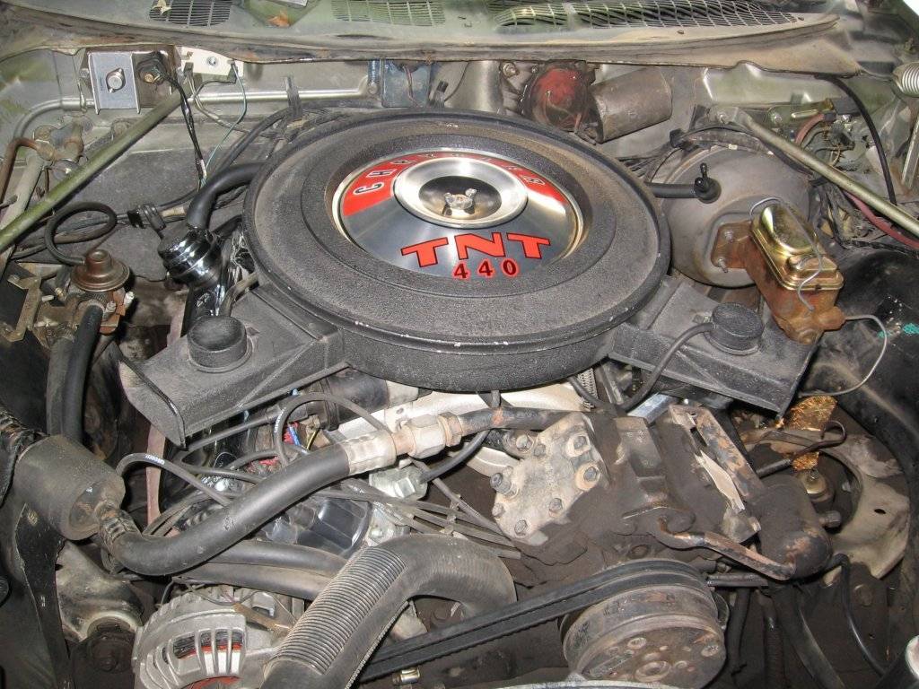

Here is a recent picture of my motor - you can see the wetness on my compressor.
OK, not as recent as I thought, as this was 2012, but you can see the wet spots on the compressor here. The top of it is fully wet today.

You have watch some of the so called R12 compatible refrigerants. They can be flammable. Containing propane or methane. If you find that you system has lost its charge. I would first find where the leak is. From the looks of the pictures it may be the front seal of the compressor. That's were my leak was. At that point you have to decide what route you want to take. For me it was easy, I'm not concerned if my engine compartment looks original. Sanden style compressor and brackets, kept stock condenser and evaporate had the hoses made.
