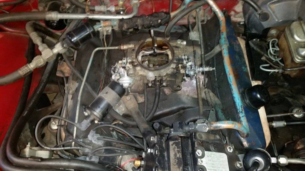

Big John - that is essentially what I did with both my cars. Except for the carefully hidden pressure switch it looks and functions as stock. You can see the pressure switch underneath the low pressure hose.

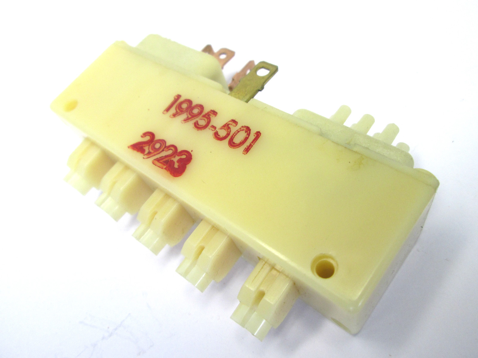

Check to see if the proper hose is getting cold with the A/C running. If it is nice and chilly, chances are you have issues with the vacuum controls or the associated components. This is a rudimentary check, but it could give you at least some information.
these do get brittle and fall apart. the last one i had go bad the back of it, where the prongs and vacuum nipples are ,separated from the housing.
If I recall correctly there is a guy out there who rebuilds them using little brass tubes for the vacuum fittings.
I'm thinking you're in the right area. I Can see the Freon moving through the dryer "eye." So I know the compressor is doing its job. But something is keeping that, as well as the coolant for the heat, from entering the cab. It happened when I first bought the car and drove it to Delano on a cold day - all of the sudden my heat went away! I found a bad hose on the vacuum "ball" reservoir on the font of the car. replaced that and all was well - until these past two months. That hose is good, however.
Yes, and the original one did fall apart in 2010. I replaced it then. I'm hoping it hasn't gone bad again. It's not expensive, just a pain to replace!
