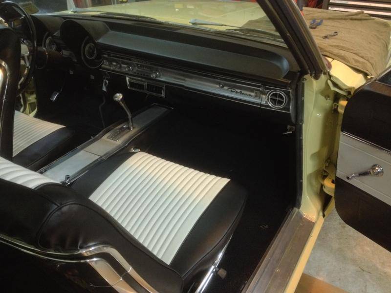

Well, after 5 months of waiting, I'm gonna start putting the exhaust in the Polara today as soon as I get off work. Read the instructions from tti, fairly simple and straightforward. I'm only planning on the headers today, going out with the girlfriend this evening and need some rest. Averaging 4 hours of sleep the last few days means I need to sleep. I'll do the rest Tuesday, so long as I don't run into any problems. I'll take pics and post them for all to see. Waited 3 years for this. Work tried to force me into overtime and I told them to fly a kite, I'm not waiting another day! Three hours til I begin!
Update: Dog needed a walk, so that's what I'm doing right now. I had fun getting the old exhaust out. Bolts were fine coming out, but the old heavy pipes weren't. Big pain in the butt. Had to get a cut off wheel tool for my drill and a couple of discs, cause I am a cheap ads and only spent $11 instead of $80 for a tool I'll use once every 8 years. Get to take the studs out of the heads after the walk (brought the granddaughter to the park). PB Blaster is waiting for me, hoping they pop out easily though, fingers crossed. I'm taking pics but will have to tease you until tomorrow for putting them up. Gonna go gangbusters til I go out to eat with the girlfriend tonight. Will keep you posted. Trying to do as much today, it will be 30° cooler tomorrow.
Foiled by the studs. Got 5 out of the passenger side header. Drivers side a bit fussy, didn't get any. Soaked them with PB Blaster and will give it another go in the morning. I shall overcome!
Here's a couple pics. You guys know all about taking stuff apart right? Willing to ship the old exhaust to anyone interested free of charge!
