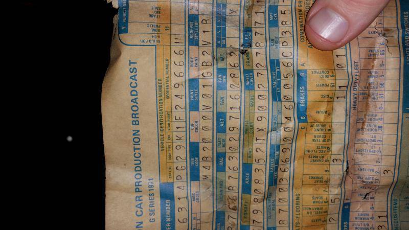

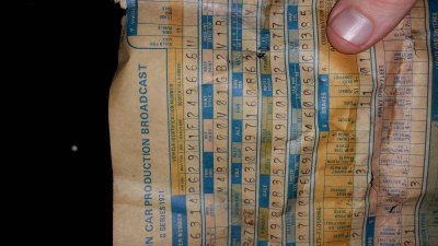

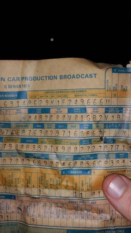

Pic of the build sheet i DID find in the back seat

I'm ok with that :) as long as it as a38 on it, good enough for me. Another strange thing, i looked up the vin on the broadcast sheet i found. PG is listed as a plymouth "new york taxi" 2 door hardtop.
sometimes codes are year specific like gold duster package....besides..who the heck has a 2 door taxi :O)
what you need to do is post a good pic of that broadcast sheet to start then folks here can eliminate the assumptions
True Derik but a second tag could just say special mask special paint special order...no numbers at all
I have a friend who's local with a true 73' NJSP fury III. I'm going to take a look at it if i can. It was ordered through Capitol motors in trentot and is from West Trenton too, i believe.
Correct me if I'm wrong but I got this impression he was asking if this car should have a second tag listing SPECIAL ORDER and/or SPECIAL PAINT due to the Y39 and 999 codes.
The PG VIN threw me at first also. I thought it was a typo given the closeness of the G and H on a keyboard plus its a 29 car. So I looked at the trim code. The M4 code seems to go best with a PM car. Hmmmmm
Yes, posting the full sheet might help clarify exactly what this came from. There could be model specific codes that we cannot see from the first picture.
yes l realize that..is why a good pic of broadcast sheet would help eliminate the assumptions...lve still got a lot to learn to...is why lm here :O}

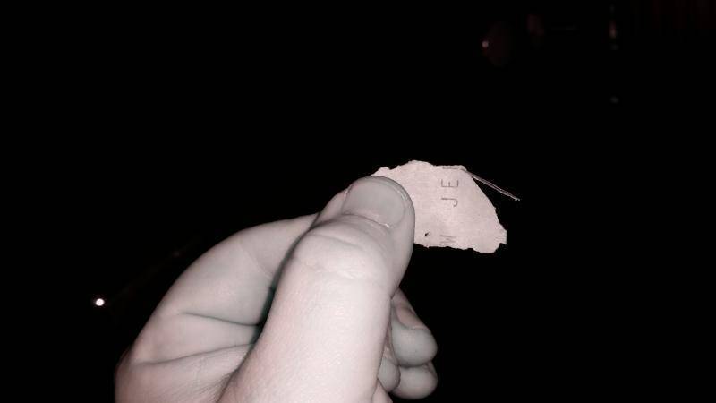

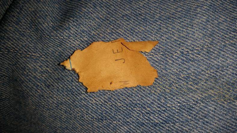

Checked under the front seat, only found this remnant fellas. Critters have been in here :(
