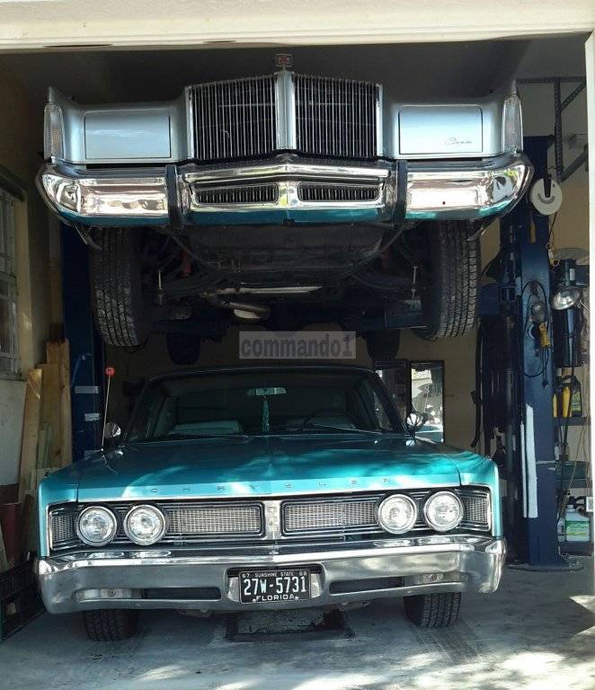

It was honestly a space issue, then I realized the scissor lift would be in the way too.
You thought you had a "space issue". Right....... :rolleyes:
picsart_03-23-10-58-26-jpg.74208
You have me bea Stan. That is what I can maximizing every inch.
Yet my wife needs every square inch of the entire two-car side of the garage to park her Mazda... :BangHead:
Cost of doing business... at least the classics are beyond harm there. Mine was upset initially... she had the delusion that she might someday get an indoor spot. One Imperial or Two Imperials, I explained that was never going to happen. She still needs to buff the Toyota paint off my Suburban from the last time she used their Sequoia. Fortunately all four corners of that thing were scraped up so they didn't notice.
