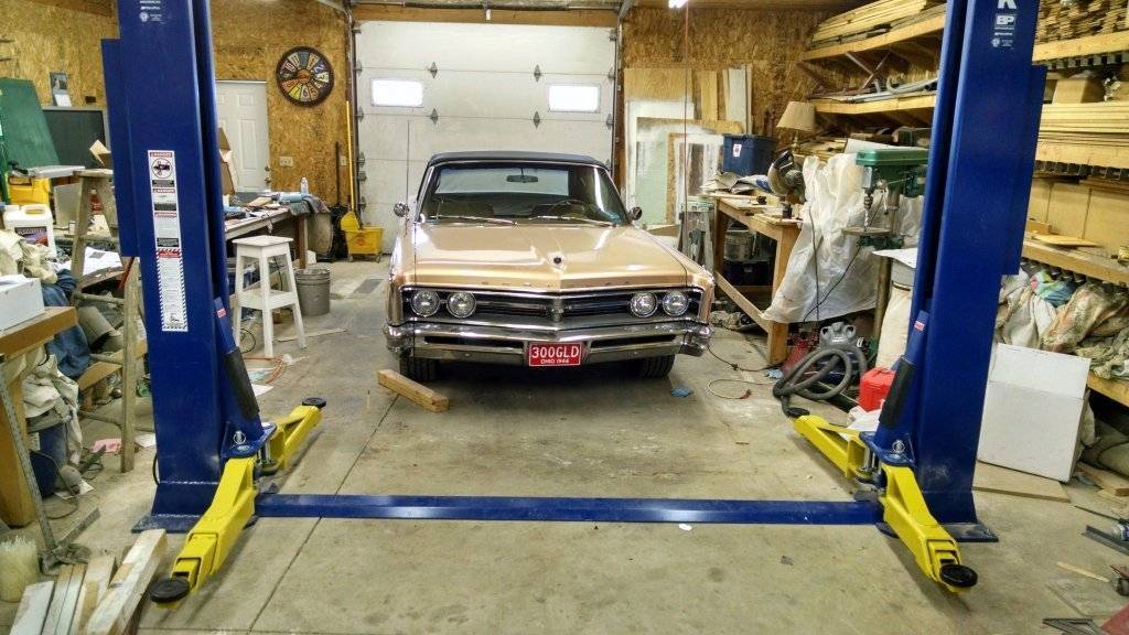

It is officially installed. I did a dry run no leaks ran perfectly. I will put a car on it later and get it adjusted.
BTY it mentioned in the manual to measure the distance pole to pole at the base and at the top to assure they are straight to one another
. They are exactly the same measurement down to a 1/16 of an inch.
Very nice mine gets like 1/8" wider at top on the stamped lift unloaded which I figure pulls in near top because no crossbar. Congrats
