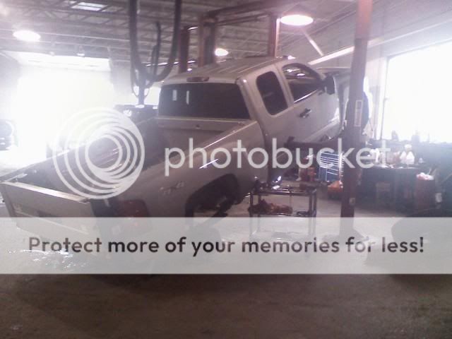

The pad was broken on this lift. The weight of the lift gate didn't help.
My son had just walked by (he was a salesman) and his back was turned when it crashed down.
Glad no one was hurt. Above ground lifts should have a lock on each arm, I would bet one or more was disabled to allow it to get all the way down... usually they just fold up the bedsides. Dodge dealer I worked for, I had a guy who dropped a Ram about once a month if he needed to or not. They kept him employed to pay off his bodywork tab, I think he had them figured out.
I have tried, and tried, and tried, to figure this one out. I can't.
Talent... I'm sure it got hung on something coming down... but thats like clearing a pool table with one shot.

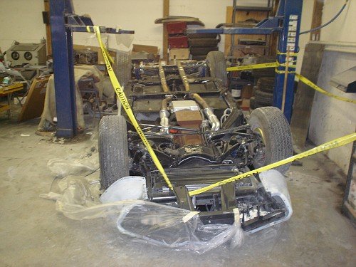

My brother worked at a Chevy dealer in Denver in the mid-'80s. One of the line mechanics had a '74 Chevy Impala station wagon on a similar lift. It had been up there for about two hours or so; in the meantime, a vendor delivered two 55-gallon barrels of 10W-30 motor oil, and sat them toward the rear of the car while it was elevated. The mechanic did not know the vendor set the barrels there, plus he was at lunch...You guessed it - the car slid off the driver's side pads and fell upside down on the two full oil barrels, which of course, split wide open and 110 gallons of fresh oil got everywhere! The roof of the wagon was severely damaged and the interior was full of oil. The customer had just walked in the service department to check on his car when it happened. IIRC, the service manager got fired, the mechanic got in a shitload of trouble because he did not have the car on the rack correctly, and the vendor employee got fired by his boss for leaving the barrels in the wrong place. The customer got a two-year-old used car from the dealership as a result, as compensation for the loss of his ten-year-old wagon.
