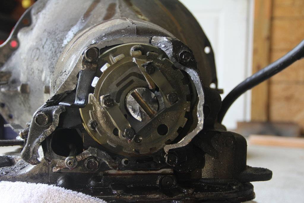

I've had rear u joints fail and drop the shaft, but never with results like this. I did have a slip yoke bushing overheat and seize which resulted in a twisted trans output shaft. It turned out the reason for that was a drive shaft that was about 1 1/2 inches to short. I was just starting to experience a slight vibration before it happened.

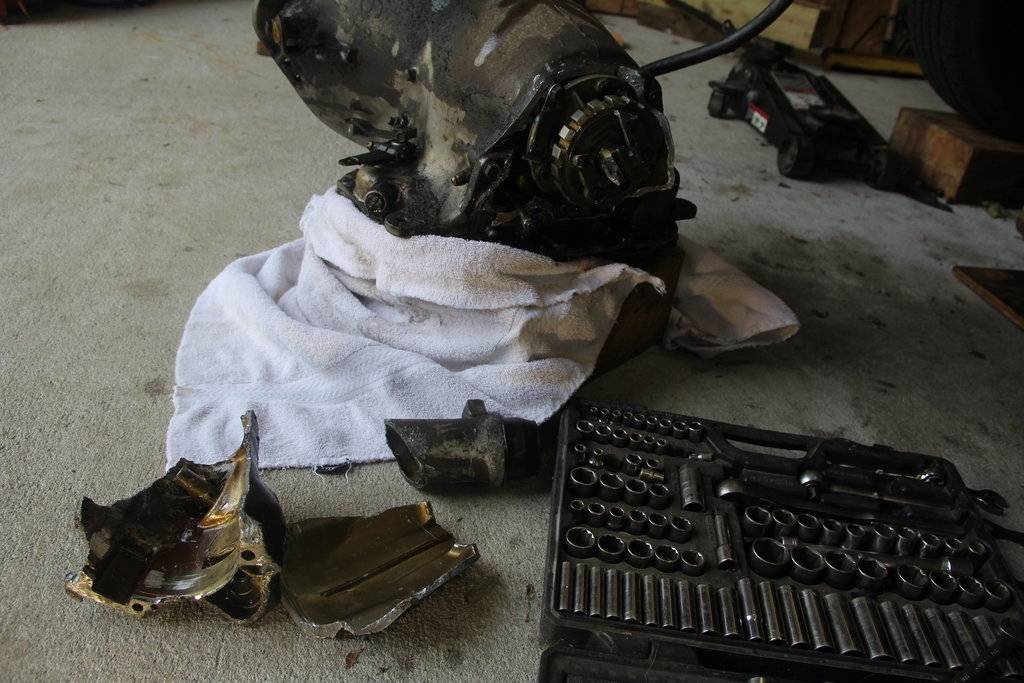

The sprag failure that I've seen is mostly to the main case and parts grenading thru the tunnel, so I'm not sold on that being the cause. Odd the tail shaft housing is destroyed here.

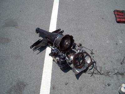

Back in my misspent youth I had a similar failure. Was under full throttle operation, the transmission shifted into high gear at about 65mph. The next thing I knew, the car was doing the proverbial bunny hop. Then there was a very loud crunching noise as the drive line and tail shaft seperated and hit the street and went bouncing along the road behind.
Later took the rear end apart and found that a gear tooth from the ring gear had broken off and somehow gotten wedged between the ring and pinion gears. That broke the carrier and locked the thing whole up which in turn caused the failure of the drive line and tail shaft.

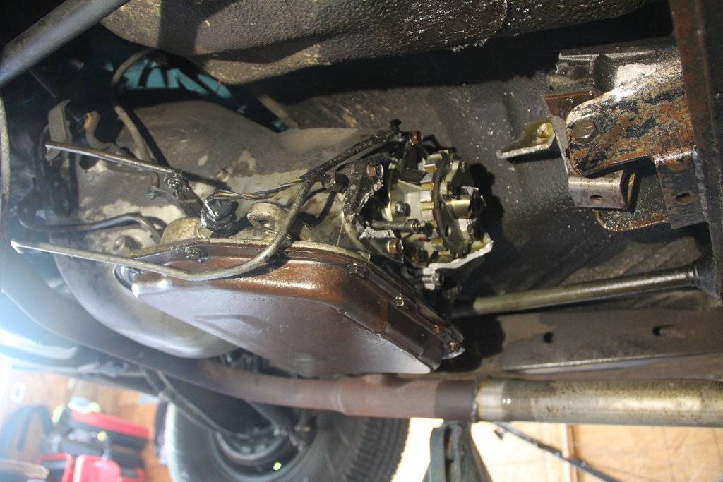

Maybe get some support under that pan so your your engine and trans assembly isn't hinging on your engine mounts.
Damn you Matt... damn you!!
I had to go out and put support under the trans to get that and the engine up a bit. After two hours of sitting outside with Diane I just couldnt look at the car any longer in that state .....

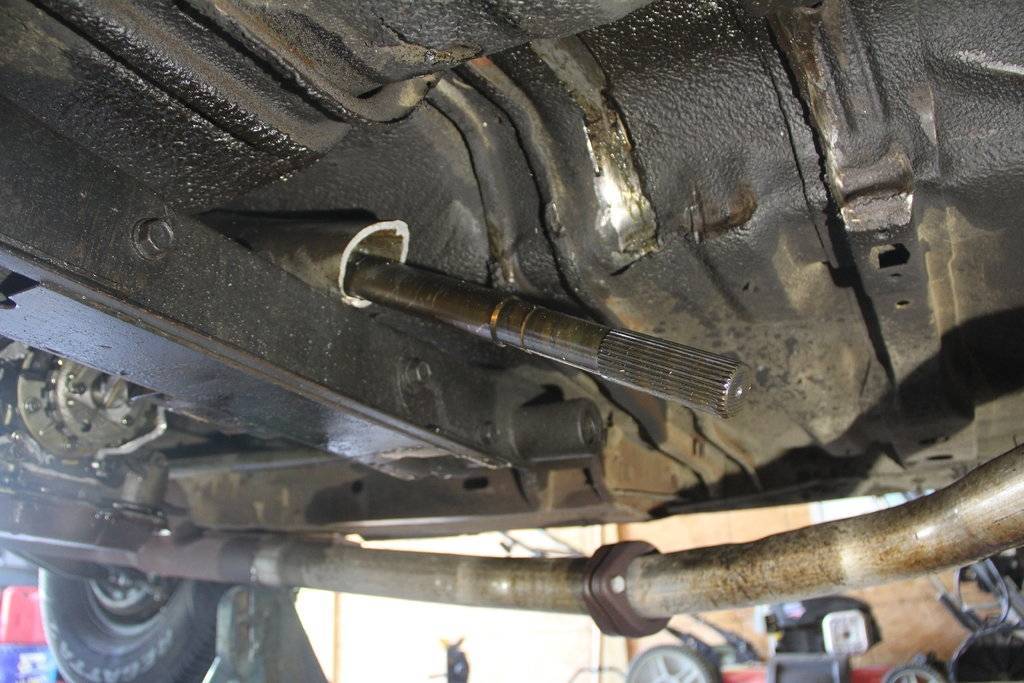

Could the parking pawl mechanism somehow have failed and suddenly engaged, locking everything up such that the failure point was the output shaft? Normally when a vehicle is moving more than a certain low speed, it will not engage for safety reasons. But I would think the pawl itself and some teeth would be gone too - very wierd. Given the slot in the remaining part of the output shaft, it was probably the weakest point of the system.

The shaft broke right at where the governor passes through it.
Since the shaft is still there, the ball bearing for the shaft is still there too. I don't think it's the cause, but see if it still turns or if it seized.

Could be wrong but not much happening behind the parking pawl except the drive shaft and rear end.
The gear on the back of the case still rotates.It does seem to be scored
