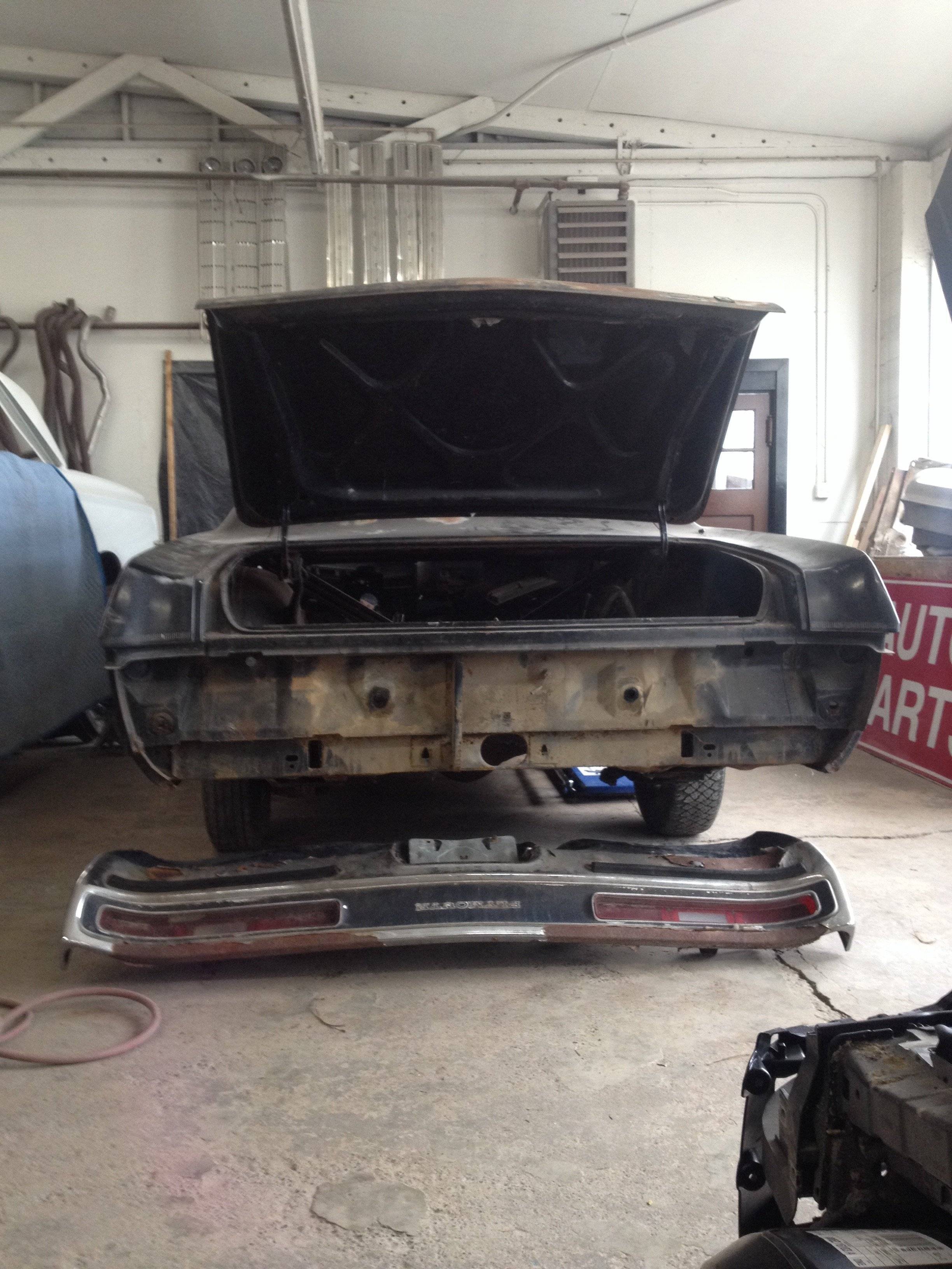

Rear bumper and valance removed. No surprises, no rust out and in much better condition than expected.
We are very happy with that......

That looks great under the bumper! All the years seeing only the front of that Fury on a block of wood, we finally get the rest of the story. More pics!
Looks upper solid back there...way better than what I would have thought. I would be very happy. Keep up the great work! I am soo glad this car is getting done.

We are very pleased with the car. There is a lot of metal work to be done, but the car over all is better than we thought,...it could have been worse!
