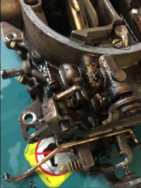

New plugs in and running like a champ. Slowly finishing up stuff on her. Yesterday I torn down the carb for a rebuild. It was pretty gummed up on the outside and the secondaries were super hard to open until I cleaned it.

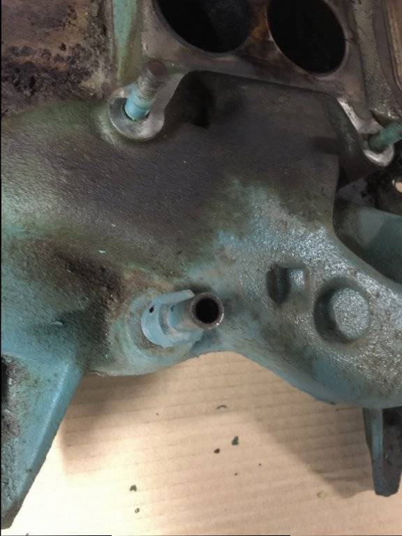

I then decided that the intake manifold was dirty and could use a repaint. Pulled that off, but broke this in the process.
It's vac port for the brake booster, and the small nipple for another vac line that goes to the fire wall snapped. I'll have to figure that out unless someone has a spare. Other than that I'm pleased and love the car. I've also purchased kyb shocks from summit and I'd love to have them installed soon.
The other vacuum line runs your HVAC controls. If you just broke the nipple you shouldn't have too much difficulty finding a replacement they have been used forever on Mopars. Someone here will know where to find NOS

I've seen those on eBay.
I broke the little titty off of mine one time, long time ago. What I did was drill the hole out some, not real deep just a tad larger then the titty that broke. Whipped up a small drop of JB weld and stuffed it back in and let it dry. Been good for the last 17 years now. Good Luck

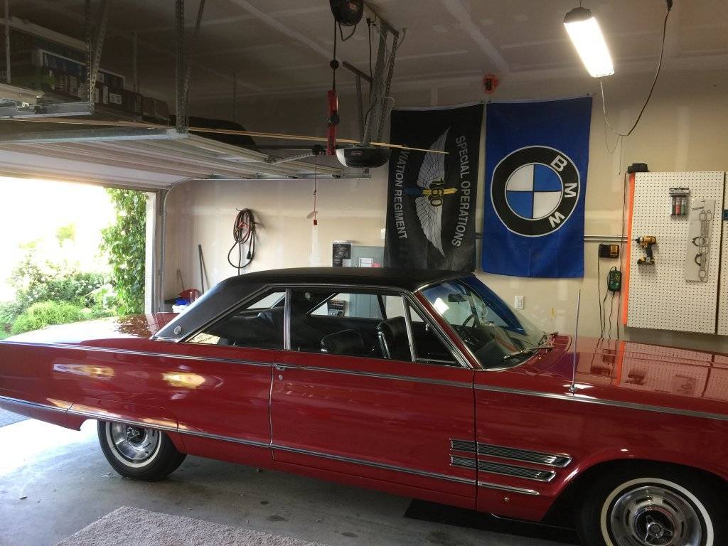

Got a good cut and buff done on it. Had a few guys who do side work do it. They spent 7 hours on her. Pic for clicks. Now I'm just going to finish the carb and get working on the transmission leak.

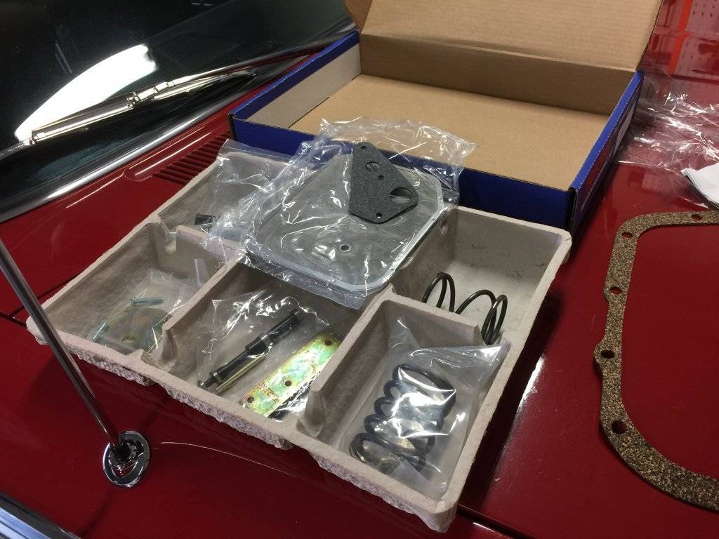

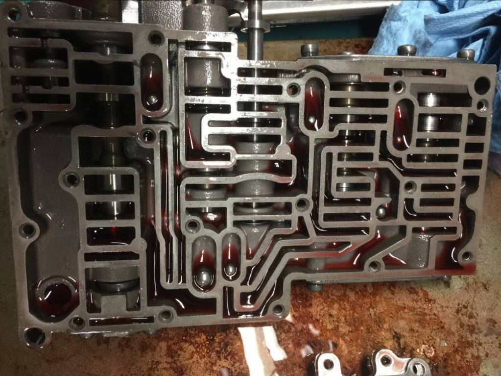

Thanks for the advice. Lately I've been busy with the trans. I pulled the valve body out to get the seals the the shifter arm and also put a trans go reprogramming kit in it. I'll have that finished up by the weekend. The shift kit was easier than I thought. I just made damn sure I followed the directions.
