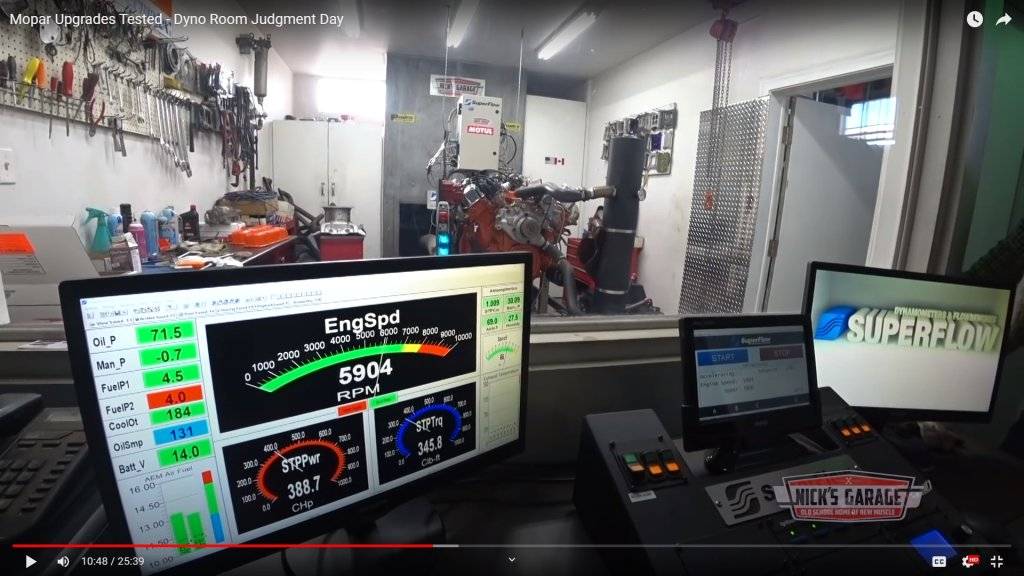

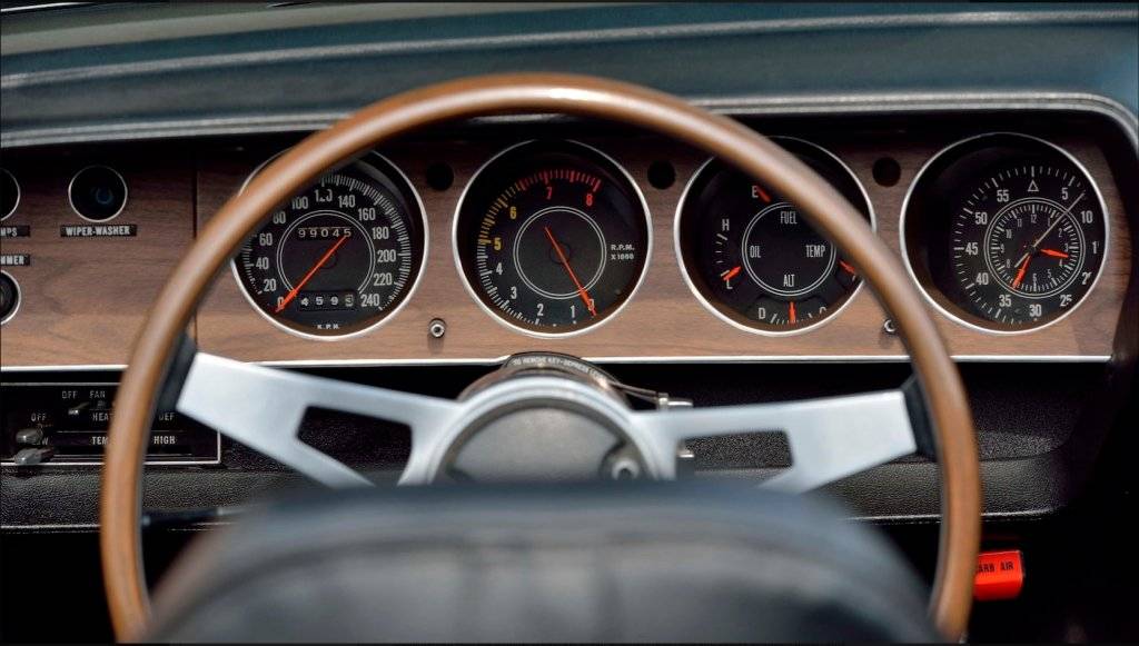

Just a quick image from Nicks Garage's Dyno Pulls, granted most of what I watch are 440 builds and I've been always waiting for him to do a full 6.5k rpm pull as argumentatively can't be done on a BB Mopar but has been disproved with the 6.5k 440-6bbl/pack & Hemi rallye tach. Most I've seen Nick pull a 440 is to 6.2k, even the Hemi's he has been restricted by the customer(s) to 5.5k on the 'vintage' blocks as if he blows it up on the dyno he owns it.
Mopar Upgrades Tested - Dyno Room Judgment Day (5,904.rpm DYNO PULL).001.jpg
1971 Plymouth HEMI Cuda 6.5k Tach
(edit) better picture quality
Appreciate the pictures and the information, feels like I have the front row seats at Nick's!
6.2K... yup, I don't think I'm brave enough to go that high!
(Even if the engine is capable of getting there)
