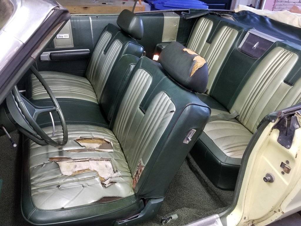

No matter how hard I scrub with 303 cleaner and soak with 303 protectant, this giant hole remains! :(

I tried different angles, but they don't want to move. Maybe they are rusted in place? I'd like to remove and replace the driver side and clean under both. As usual, the FSM is completely useless on this topic.
Just pull up on your headrests. Since it's a convertible, you can stand in the back seat and do it.
Getting the headrests out is not an easy task. My upholstery guy removed them for me and had me take the headrests home. It took him quite a while and I think he had to dig in through the seat back to get the one out. They do NOT move up and down and are really not meant to be removed, so it seems.
Otherwise, it looks good. I think a call to SMS for some new material may be in order.
The upholstery guy told me that the seats are beyond repair. The vinyl is too old and brittle to patch it up. It needs to be redone from scratch, but I'm not in the market for that right now. I'm going to do a little more cleaning in the interior, maybe replace the driver headrest (if possible), and try to find something to cover that bad spot. Then it's on to the engine compartment and mechanical issues. Hopefully I can drive it around a bit this summer.
It is quite strange, but it does seem to be the case. It seems like they should have been integrated into the seat if they were not designed to move up and down. Did you just leave yours out and upholster over the holes?
No, they're going back in. Mine are in nice shape.

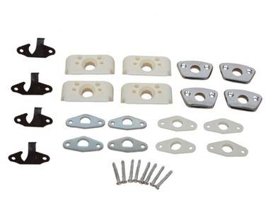

they should pull straight up. no tilt. they won't pull out because there is a notch on the bottom of the posts with a clip attached to the seat frame holding them in.
clips on the left are what holds them in. they can only be accessed through the seat back.
note: bench and bucket seats use different hardware and bezels.

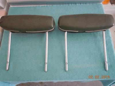

The pictures show the type of headrest in my bucket seats. The seats in 70Tom's car use a single post that is rectangular. Not sure how they work or even if they are adjustable. I suspect they're fixed since a single post headrest would tend to twist or rotate in a crash. I noticed in my google surfing that there are kits to install the two post headrest in bench style seats. If you eventually recover the seats, that would be a good time to switch headrest styles.
