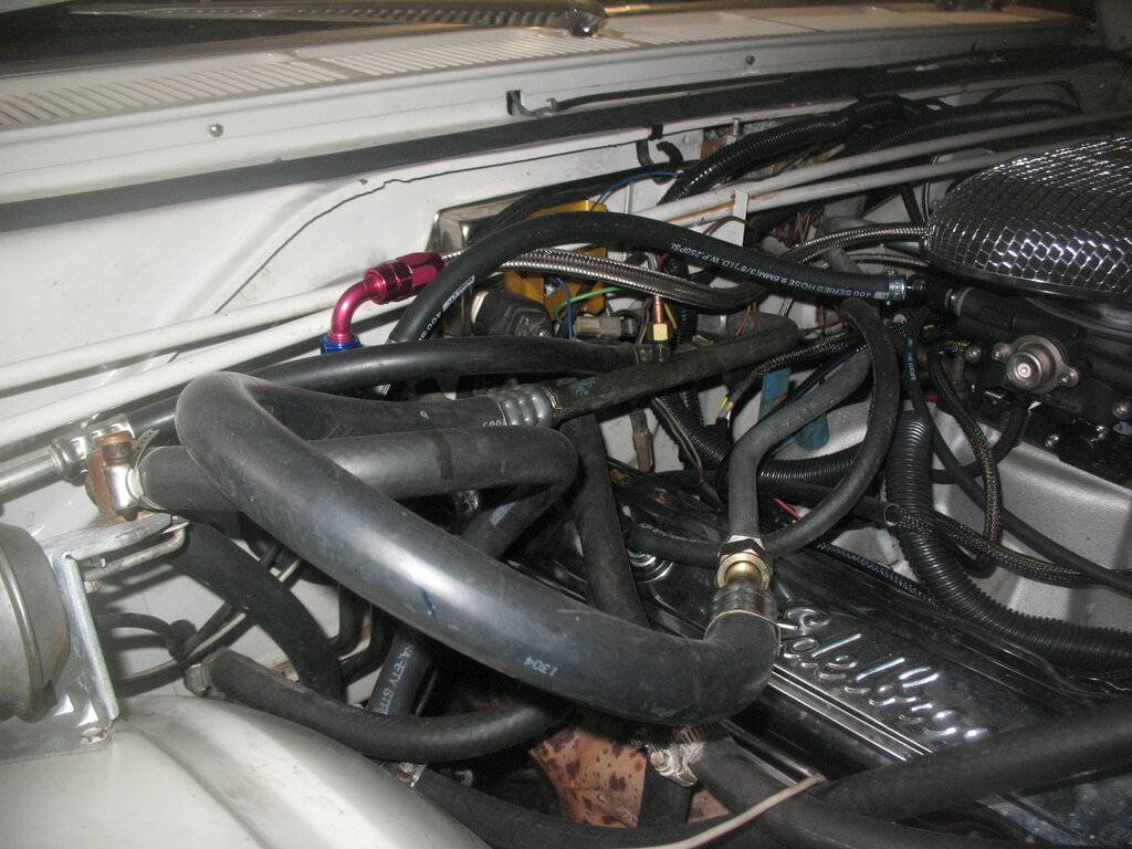

I looked into finding parts to rebuild a RV2, some parts are available but they are becoming rare. I did find a complete RV2 online but it was over $500, That was 10 years ago. The law of money says nothing ever get cheaper so the Sanden route is what I did. In the process I had to go to billet aluminum brackets since a sanden isn't compatible with RV2 mounting. I went with CVF racing brackets for a 440. I did have to change the power steering pump to a later version. The original pump from '66 is not readily available but the later one is. Here's a photo.
Once all this was installed, a new condenser was ordered along with all the hoses and fittings. A hose crimping tool had to be bought too.
At this point is was install everything. While doing this I replaced all the o-rings in the system with R-134 versions too. An AC gauge set and vacuum pump was borrowed from Autozone to fill the system with oil/R-134. The oil type is stated on a sticker attached to the compressor. There was a copper pipe that went around the back of the engine, I bought an aluminum pipe of the same diameter and had my brother bend it with a tool he uses to install AC systems in houses. An AC shop can do this if you don't have an AC guy around.
I did this back in 2012 and it is still working great. I realize this is more expensive than a RV2 swap. But the RV2's are notorious for working great from the factory until the warranty on your car expires. And R-12 is very hard to come by. It also looks really cool when showing off your vehicle.
The one piece that was critical is the pipe connecting to the evaporator valve. Don't discard this.

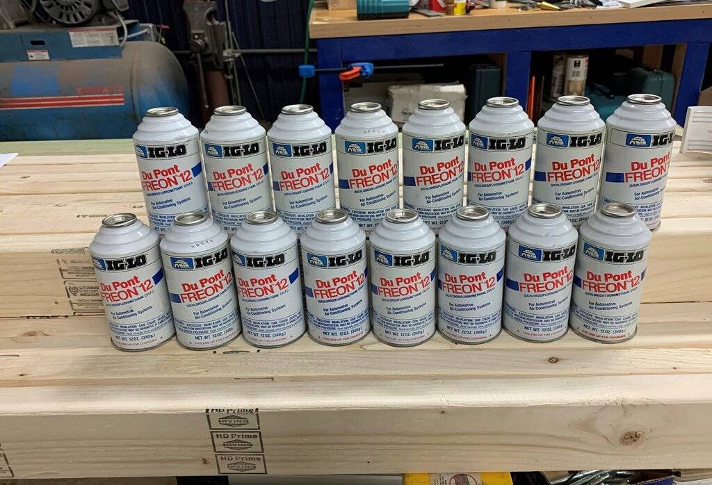

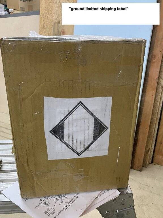

Just thought I would add this to the thread.R12 is still around and if you use "Search Tempest" on Craigslist it can be found.There were over 50 ads for R12 all over the USA. Some cheap and some ridiculous. I just received 16 brand new NOS cans of IG-LO Dupont R12 for less than $200 shipped.It can be shipped via UPS legally using the symbol shown in the 2nd photo.Per the UPS hazardous materials dept. Just attach the symbol in a 4 1/2" square format to the box and call the contents auto parts.Went from AZ to ME no problemo. Both my Fury and my Dakota are R12 and I want to keep them that way.

A few things I noticed when seeking to buy R-12 when it was still around. First thing is that the orig 1lb can size can hold less than 1lb of R-12, but the dialog on the can should state how many ounces of gas is in the can, as produced. They can look like 1lb cans, but only have 10 ounces of gas in them, for example,
On the last day that buying R-12 was legal, I bought some at work for my stash. When I went to check on them about 2 yrs later, they were "light" (i.e., empty). Leaked from the crump on the seal, I suspect. So much for that bright idea!

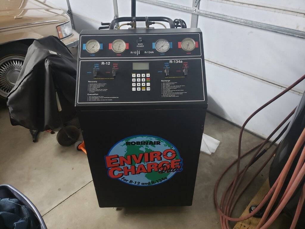

I picked up a a/c machine pretty reasonable , it can recover , store and recharge. I ratholed about 120# of R12 and about the same of 134. So I think I,am good for a bit . :steering:
