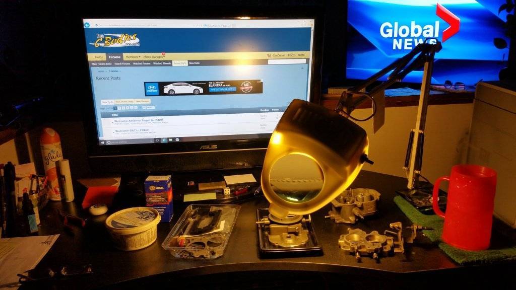

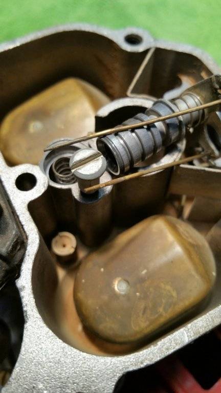

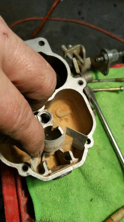

Carb kit....we need brains Pete and Grahams no where to be found...anyway took mine apart after takeing butt load of pics....looks to be 2 check balls couple springs ect...dosnt look to bad realy but then l haven't opened kit yet....already worried about the extra parts l'll end up with....

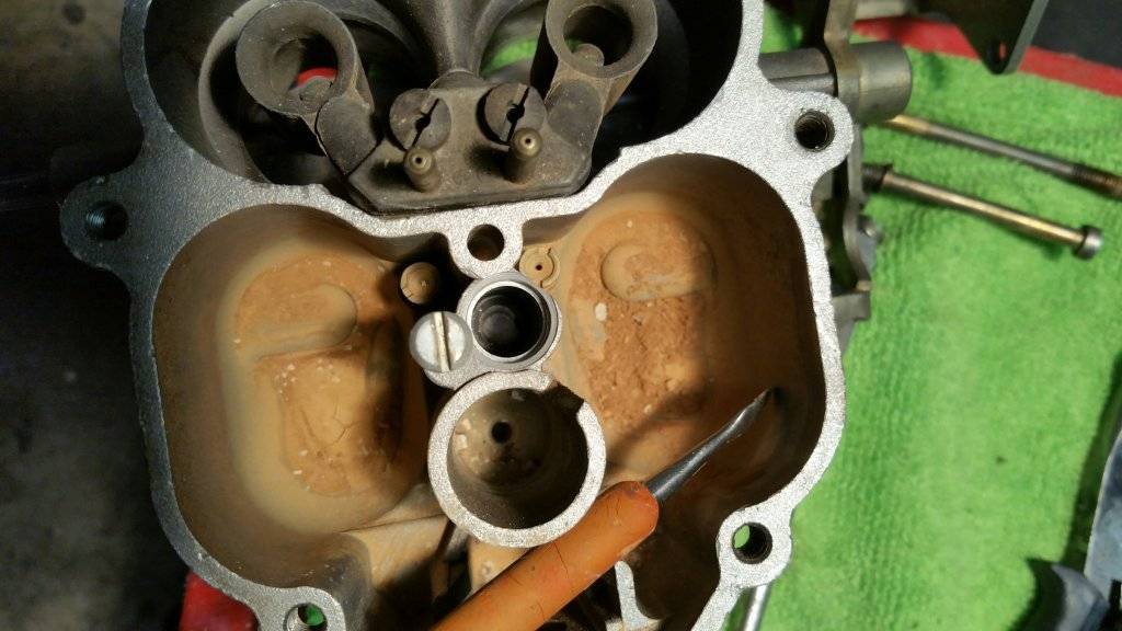

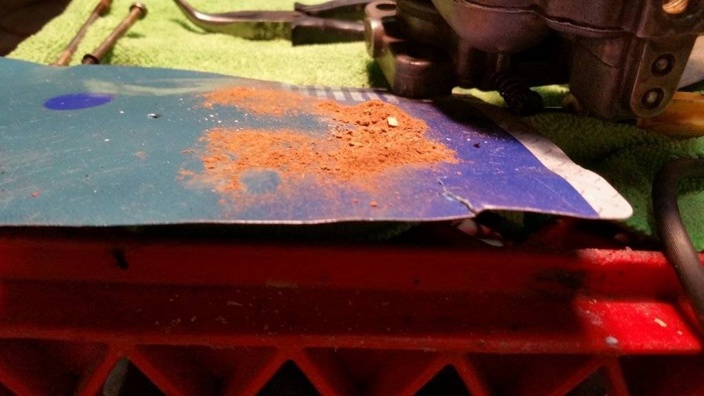

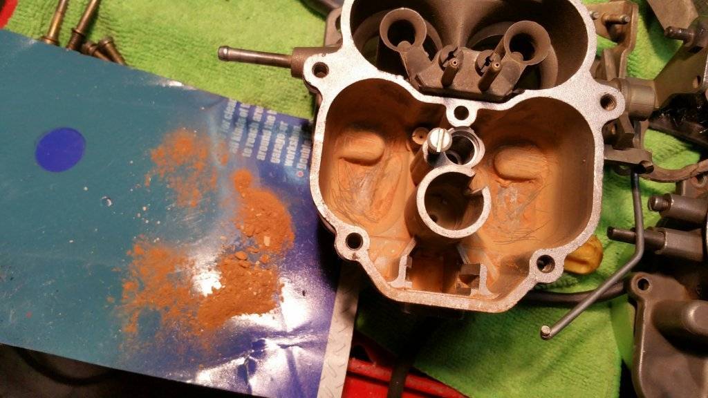

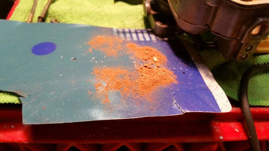

when l opened mine up found alota crap in bottom of bowls and plunger looks worn and tired

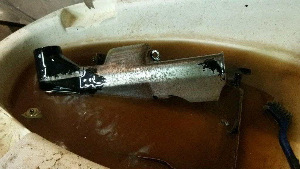

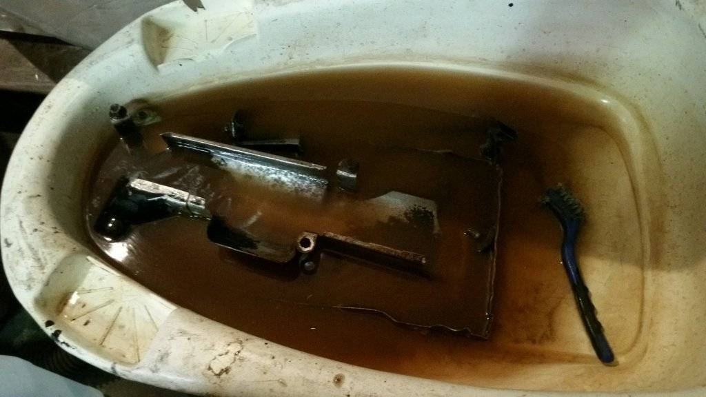

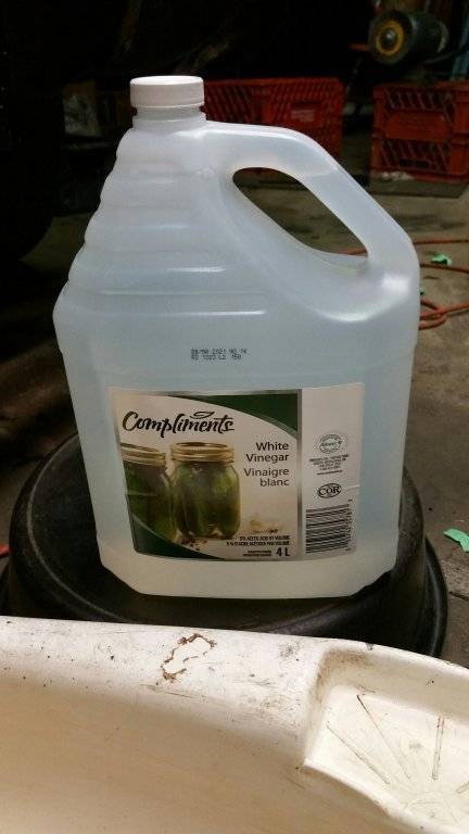

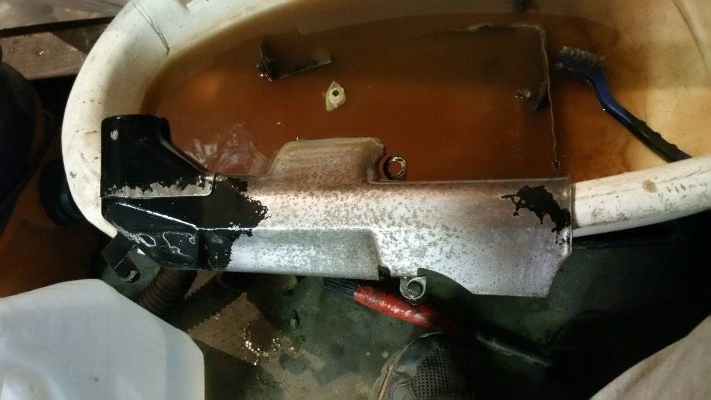

also decided to try out vinegar to try to remove rust from driver side heat shield over exhaust manifold...was in pretty good shape and coulda just taken a wire brush to it but wana see how well vinager works and if l can get the piece looking like new...first bath to small...baby bath for my babys parts just fine...nieghbour threw it out years ago and l snagged it outa her garbage....use it quite regularly for my diesel oil changes...works great...

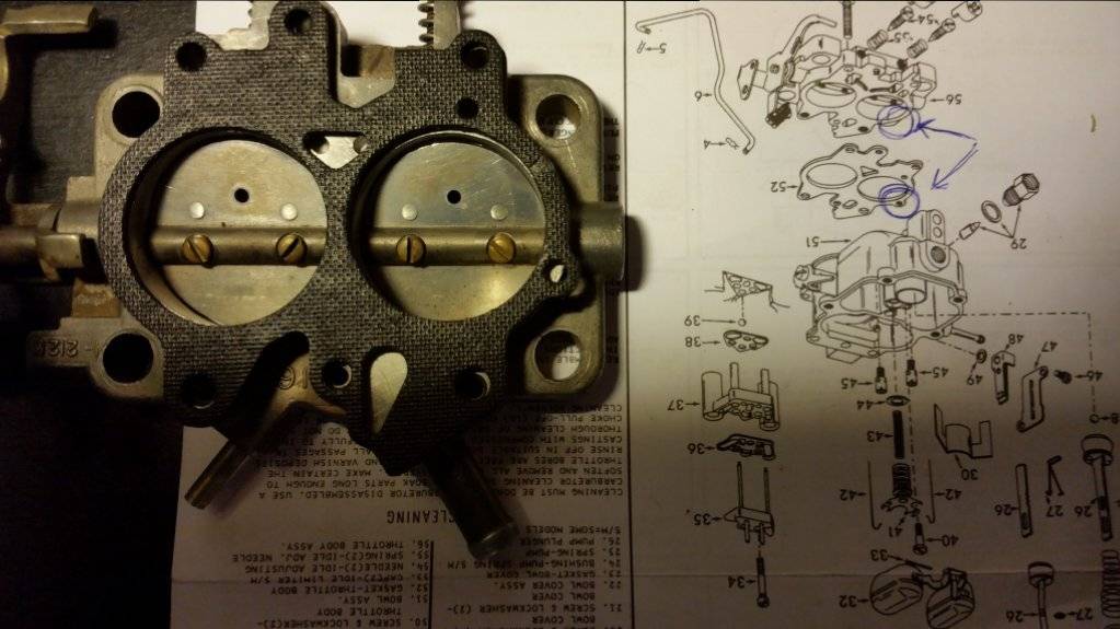

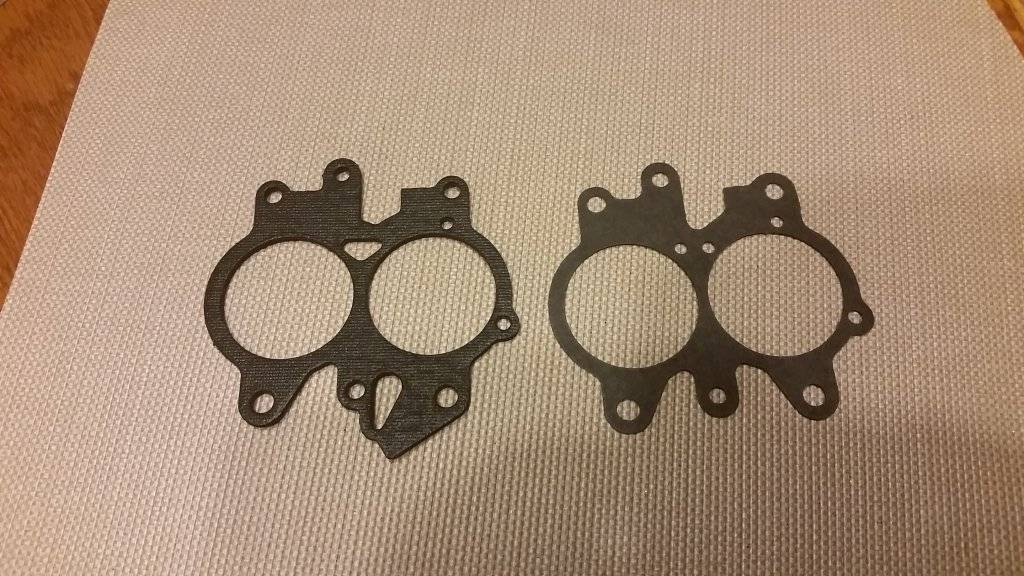

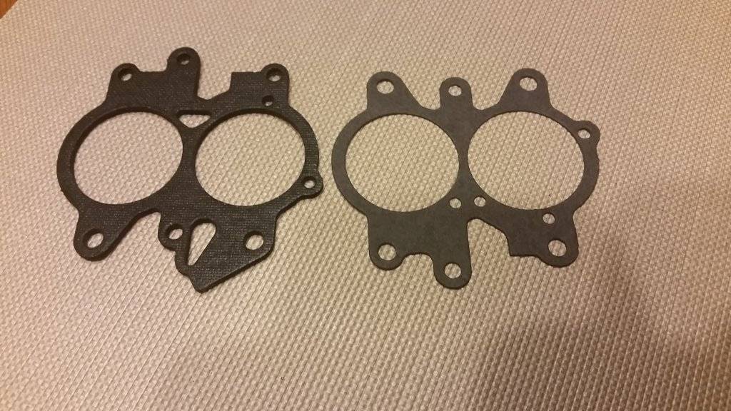

Hmmmmm.....where dose a newbie start......guess the instructions sheet is as good as any......was hopein pete would do his first so l could learn from his mistakes....not the other way around lol..ah well no guts no carb......
Lve spent 30 mins just figure in out where to start....now lve got this gasket...and hole.....
OMG couldn't wait for me eh? Sorry been busy teaching Six Sigma to an Auditor all day just got in.
You should soak the body overnight to get all the varnish off. How much wear on the throttle shaft? Bracket is normal do you have a drill bit to set the float?
I knew I should have kept your carb kit at home....:BangHead:
when l saw the gasket thought l was lost...when you mentioned the drill bit knew l was lost

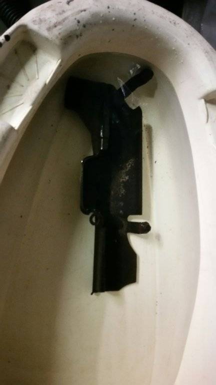

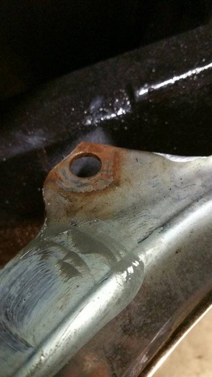

well we'll start with the vinegar test...is working great to be honest...love it...its cleaned the rust offa my heat shield to the point it looks new...very impressed...will be doing a lot more of this in the future...have battery tray in there right now as well
24 hrs in vinegar/water bath

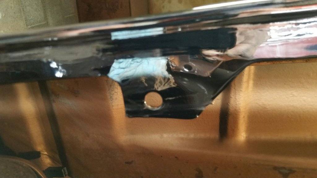

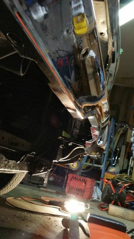

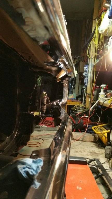

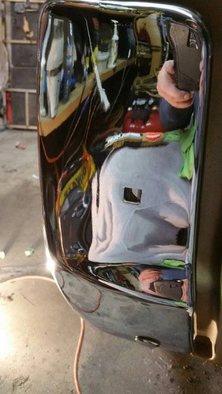

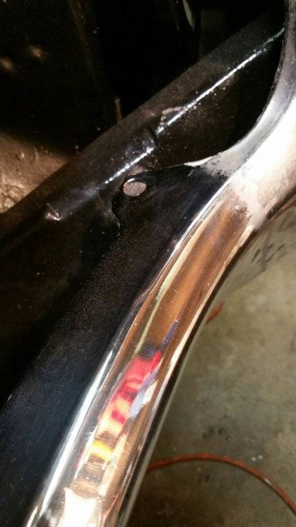

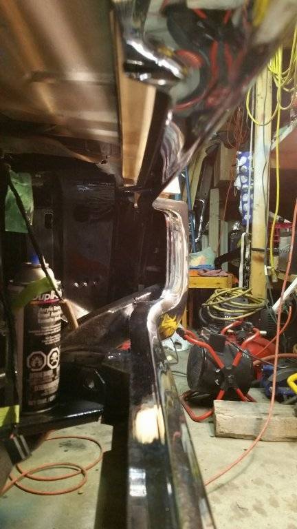

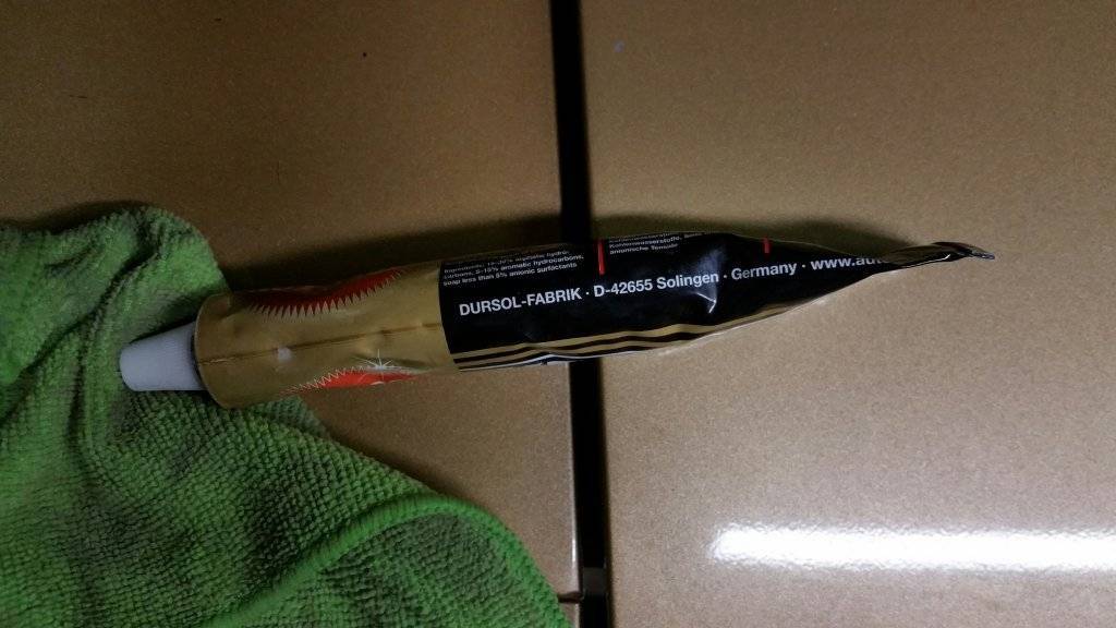

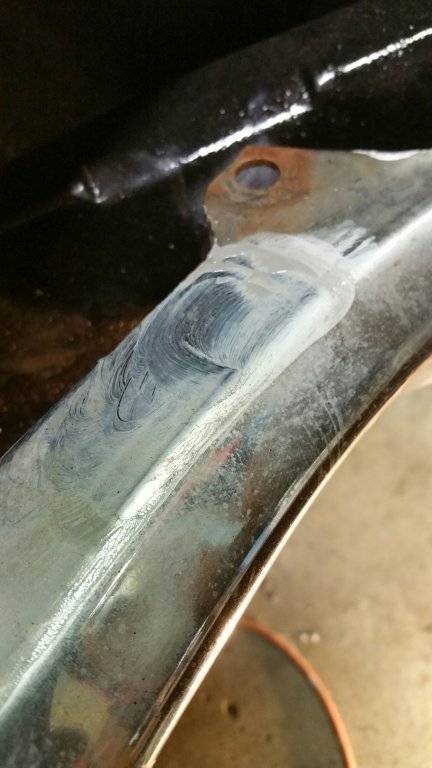

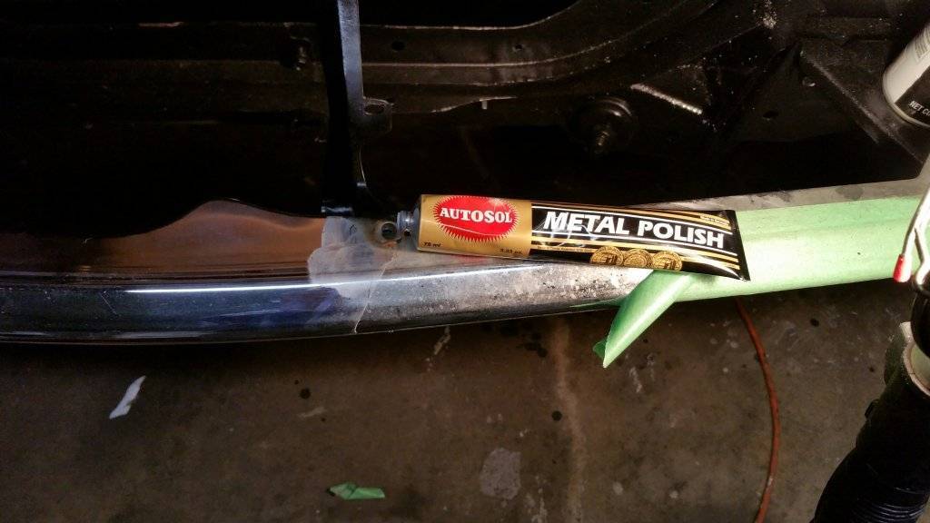

also decided to see what kinda shape bumper was in so decided to clean it up...was in crappy tire other day tryin to figure out what to use for polishing the bumper...was mequires..and all that other heavily advertised polishes'...decided to go with one with awards from Germany...

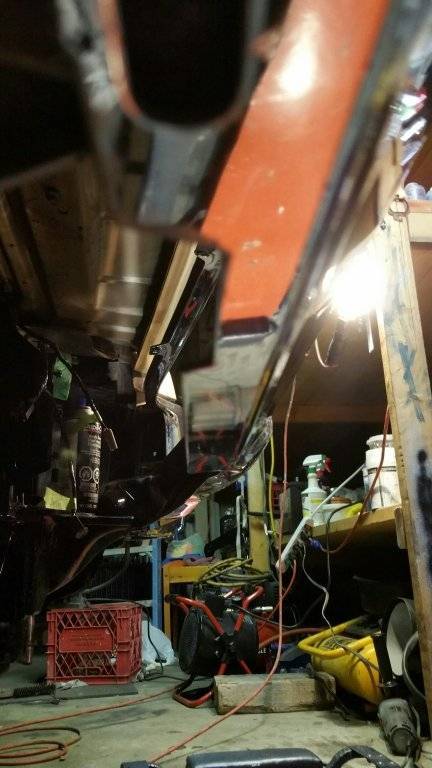

was nice to be on my back for a change insteada being stuffed in the engine bay....
comfy for a change....
tried using my porter cable but is was noisey and didn't work all that well....what l found that realy worked was my finger or thumb and ya just grabbed a dab and had at it...little gos along way...kinda like claybaring..you can feel when chrome is clean...quite happy with this polish...would recommend to anyone

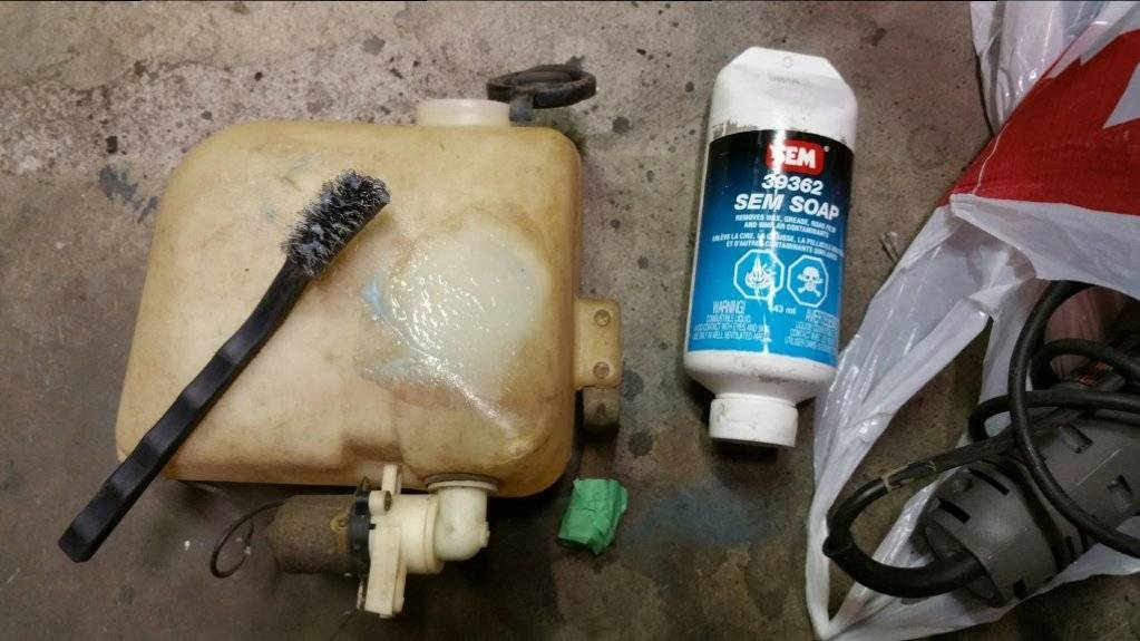

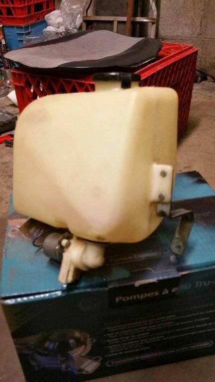

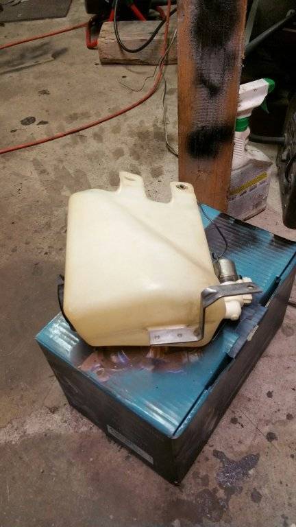

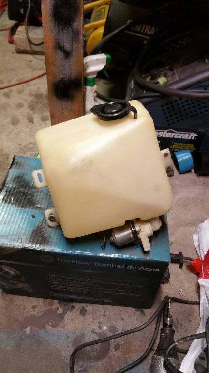

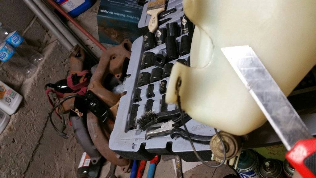

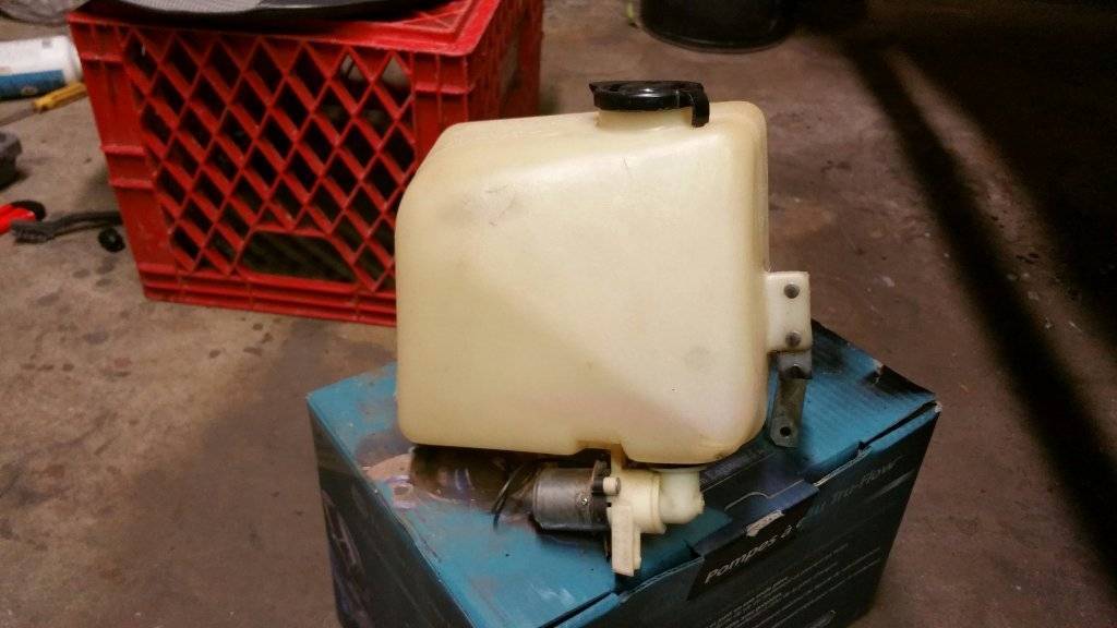

also grabbed a wire brush some SEM saddle soap and cleaned up my washer reservoir....worked pretty dam good and cut off any excess production flashing which cleaned it up pretty darn good ld say....

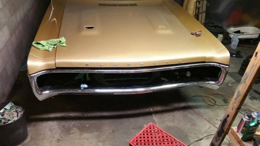

pic below is not paint difference...is just the heat blows alota dust down there and haven't been on the hood whereas lve been crawlin all over thos fenders knockin the dust off..
