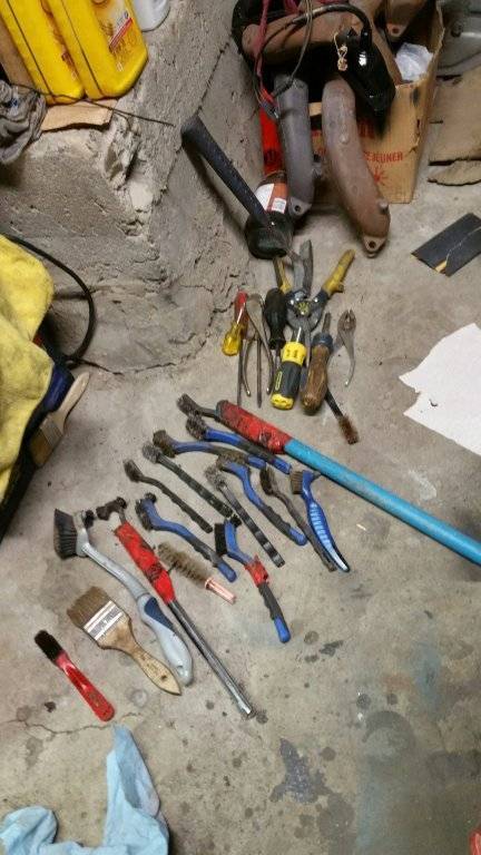

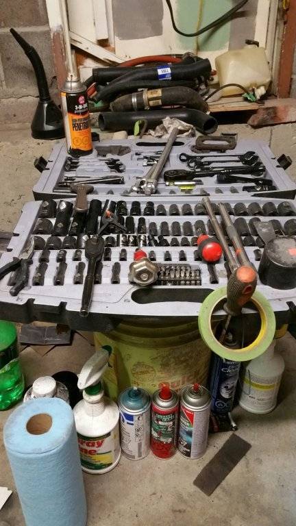

clean...lol...l wished...whole underside was covered in 40+ years of oil,grease and dirt ...like l said at the start 1 inch at a time...scrap excess oil dirt and grease off...then hit it with
then rinse...repeat as needed...once a areas clean prep and paint...l use a number of tools
patience and perseverance

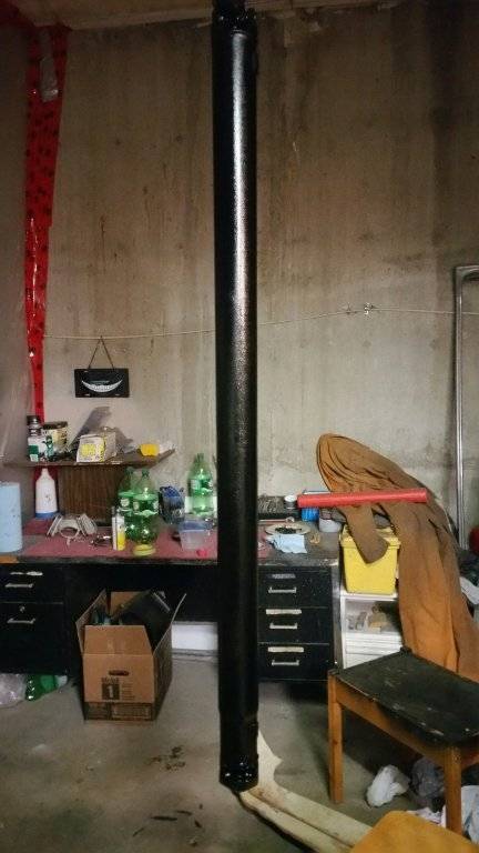

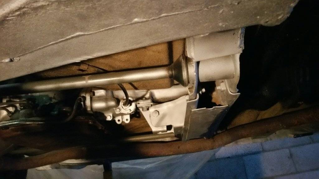

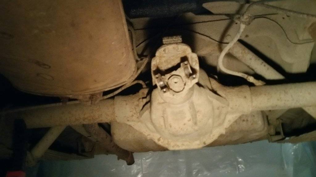

welp decided to remove my driveshaft to check out ujoints and make access to driveshaft tunel easyer...trouble was cars on a angle...front high back low...tranny drained and l got a sock and bootfull before l managed to get out from under there with darn driveshaft on my chest
drive shaft joints show and move as new so am not touching them...driveshaft done

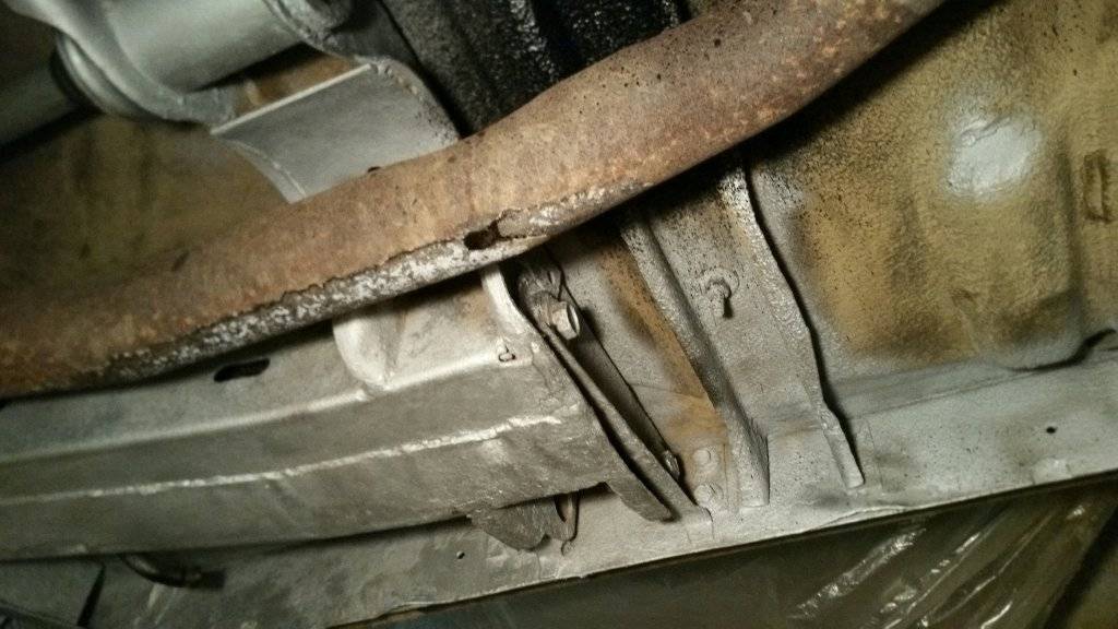

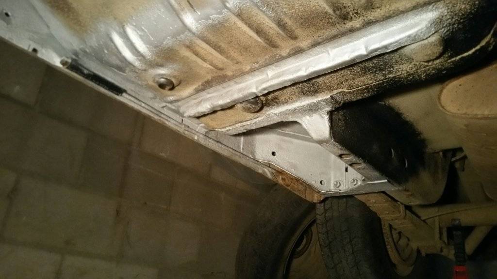

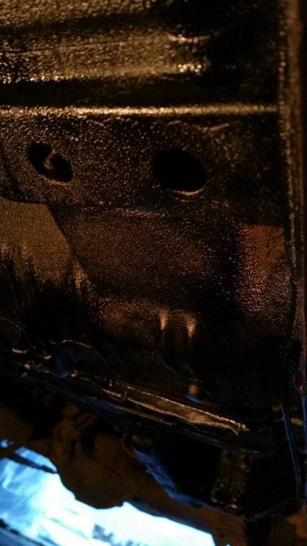

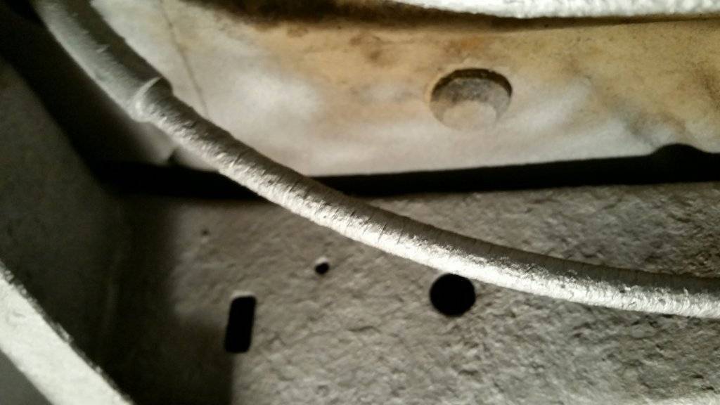

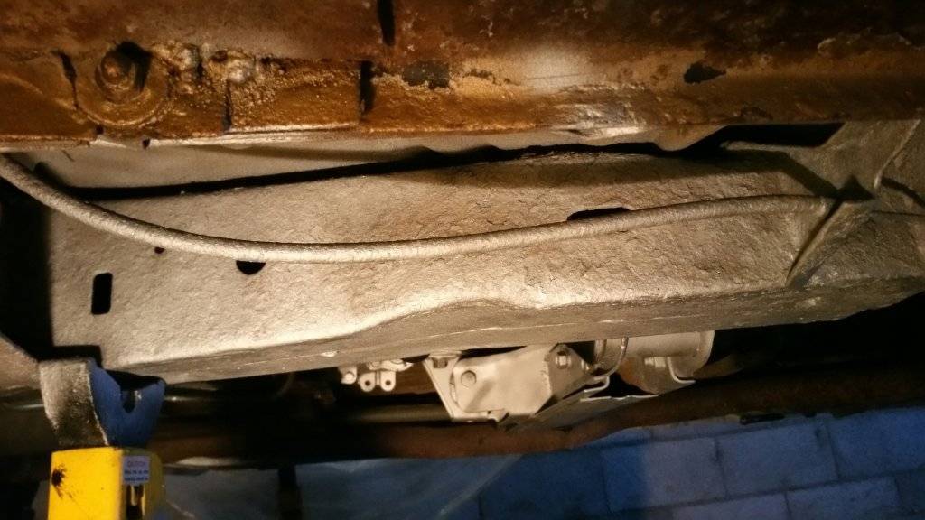

also started coating underneath car...any exposed metal or rusted areas were prepped then hit with Metal Blast then Rustbullet to seal it then hit with undercoating to seal all back up...95 % of the undercoating was still present and in great shape so clean up underneath is a brezze so far...
have worked my way back to infront of rear tires...few touch ups to tend to yet...

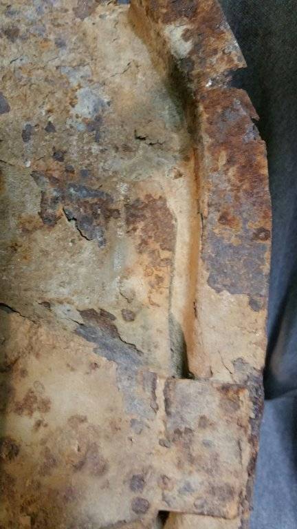

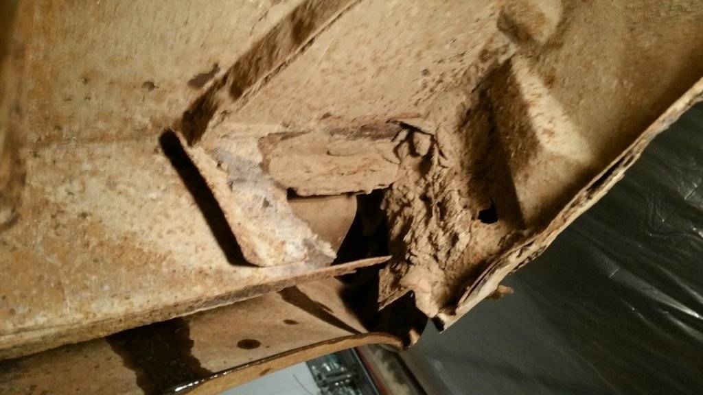

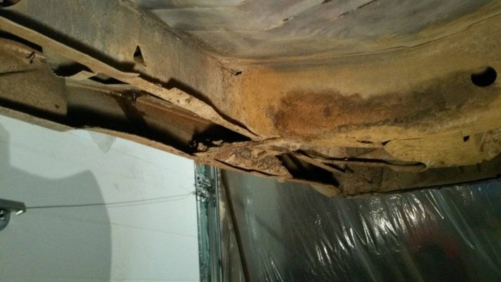

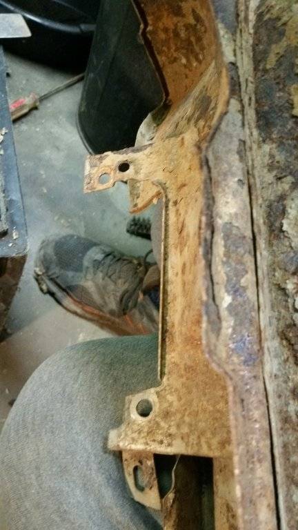

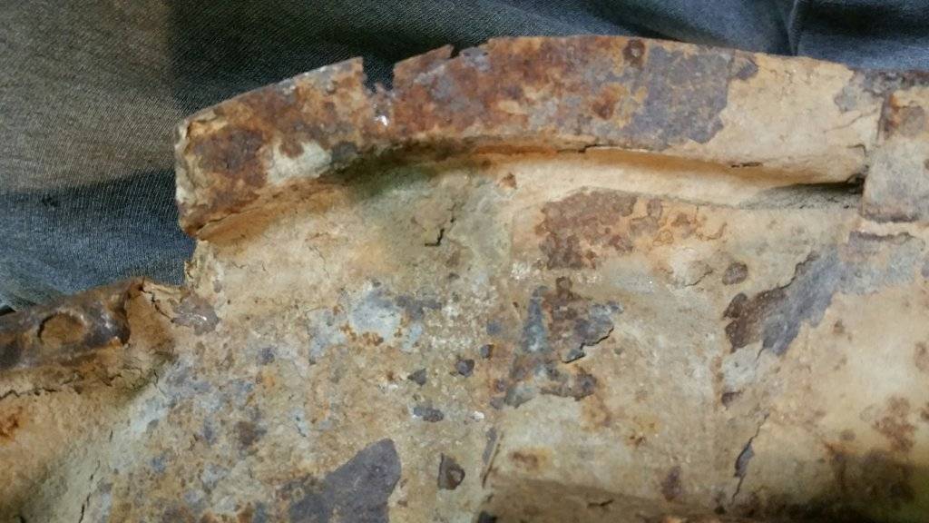

been spendin alota time sortin out how lm gona go about it...know its saveable...question is can l save it or do l have to pass it on to someone else.......am goin for it

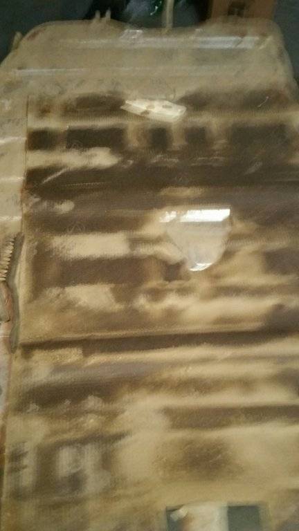

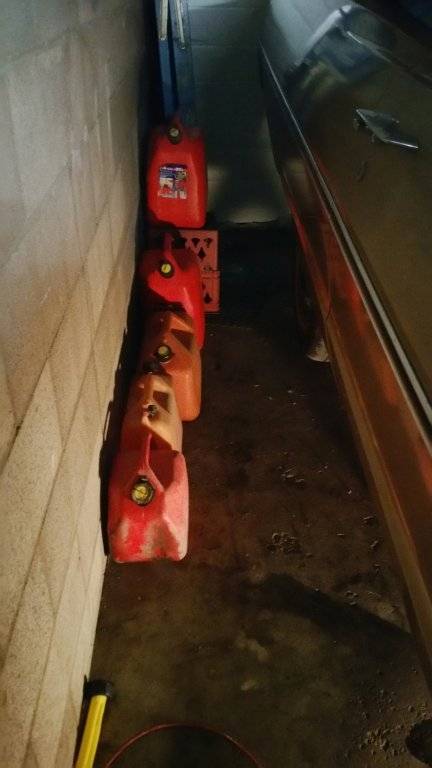

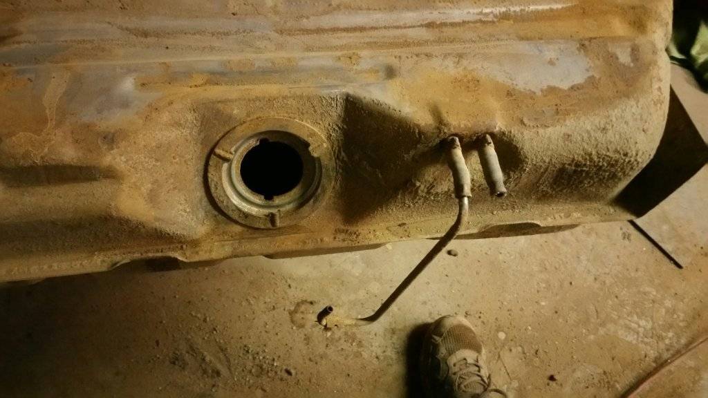

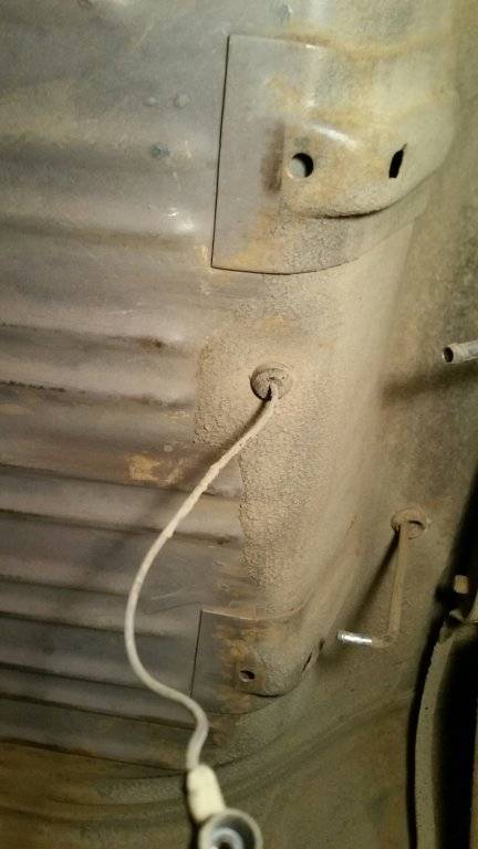

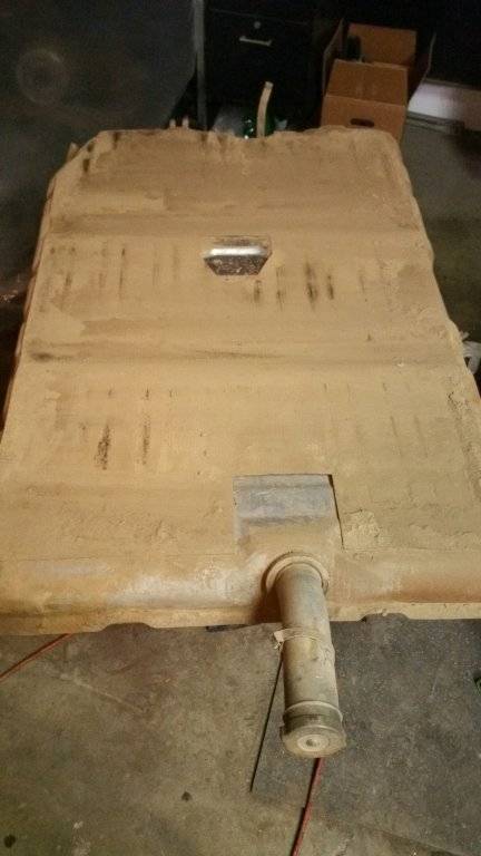

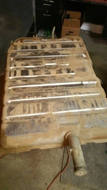

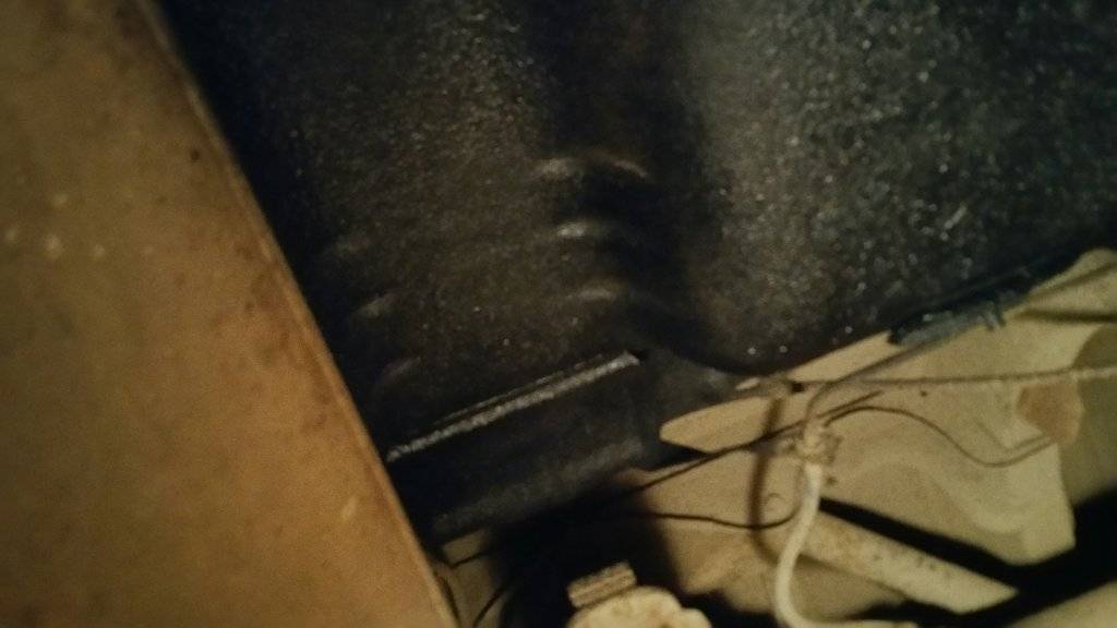

tackled gas tank today......fuel wasn't registering...also easyer to detail without it in the way...straps came off np...usually you need to cut them when their that old...figure l got 20 gallons outa the tank...anyone want some old gas :O)
sometimes things aren't always what they seem
inside of tank looks like sender...float on sender had actually totally disappeared...looks like tank will be going to local rad shop to see if theres anything they can do for interior...think their cost is almost as close as a new tank...we'll see over the next few days

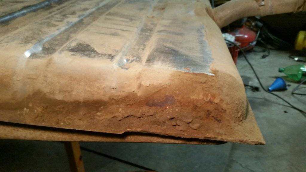

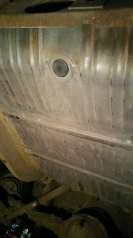

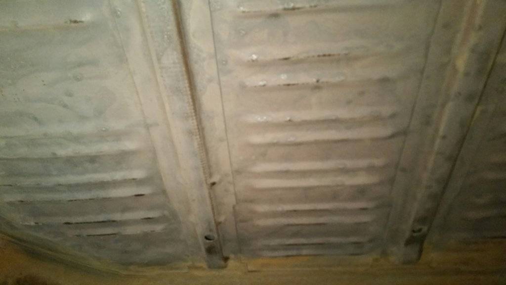

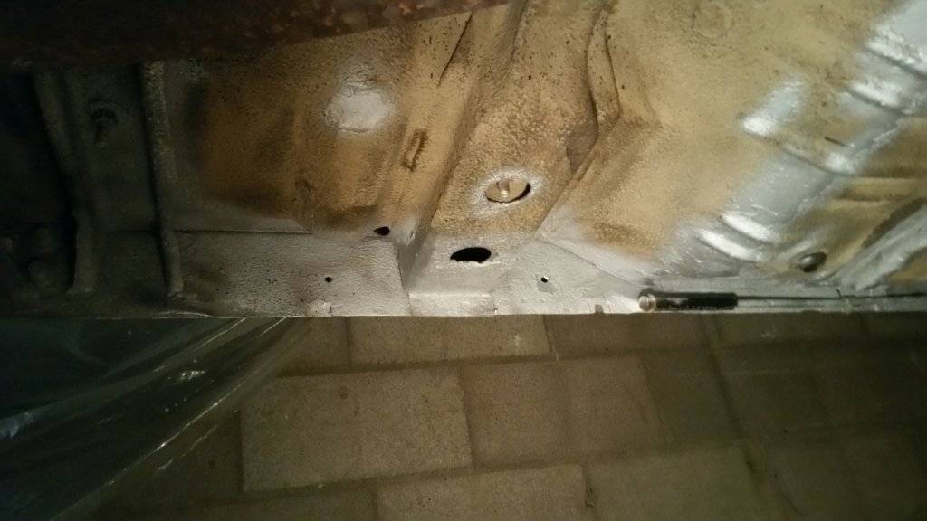

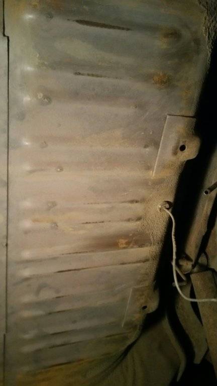

trunk pan looks like new...:O)

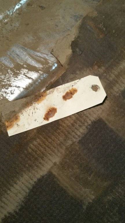

these two little catch areas for straps are a main cause of rusting around that area as they collect dirt ect...cleaned them out...sometime next summer on a realy warm day need to blast dirt and dust out of catch points in frame that l cant reach with air and water...if l had the time & the place..would rip the whole thing apart and have it dipped

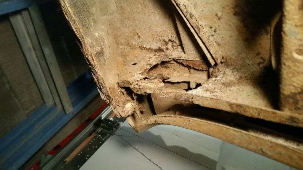

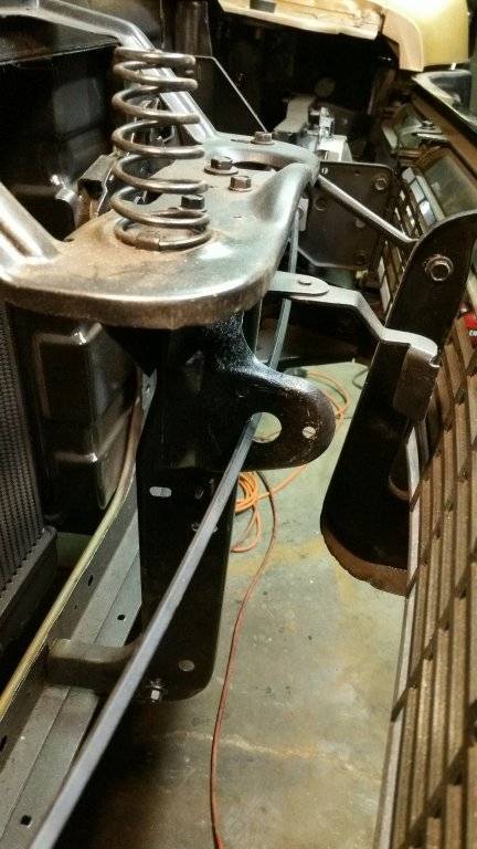

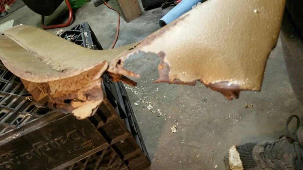

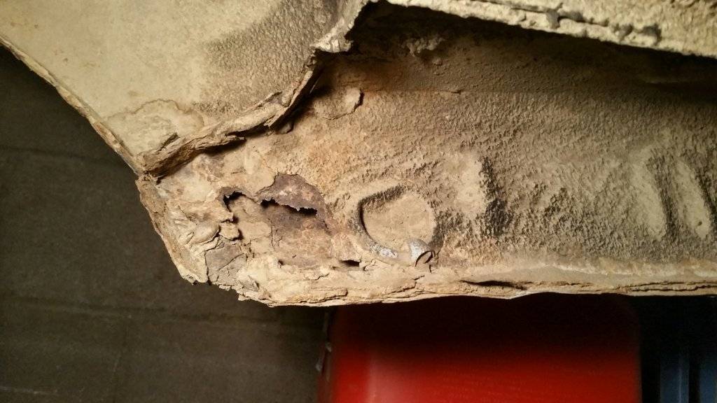

also after looking at lower rear valance do believe whole bumper will be comeing off ..least theres only 4 bolts holing it to the frame...hopefully my 1/2 breaker bar will make quick work of them...you were right again Bill :rolleyes:

I would definitely go with a new tank. Spectra tank are made in Canada but for some reason they are way cheaper in the States.
Keep up the great work.
Dave
thank you sir.. l do the best l can with what l have ...local rad shop quoted me 400 can..if l can get one in for that will go for it...other one was us company 327 us plus shipping ect would put me in the 500 can $ range with exchange at a time lm tryin to do this on the cheap...ah well...new sender...new tank sounds good...dam it...old tank looked great on outside to...ah well such is life...
I don't see the point in fooling with the original tank when the numbers are that close... IF the new tank is the same gauge metal and fits correctly, you would be far ahead to start from there. IF the radiator shop service includes an ethanol resistant coating... that might change my mind.
Whatever you do... she's looking good Critter:thumbsup:
Will probally go new....but have noticed in a pinch the satalite cornet tanks are dam close to original and 2 vent style but is 19 gals opposed to oems 22..24 ?..thier only 3 inchs smaller and a heck of a lot cheaper around 150 us ...looking 450 plus if l get dinged with brokerage ect....bloody border
