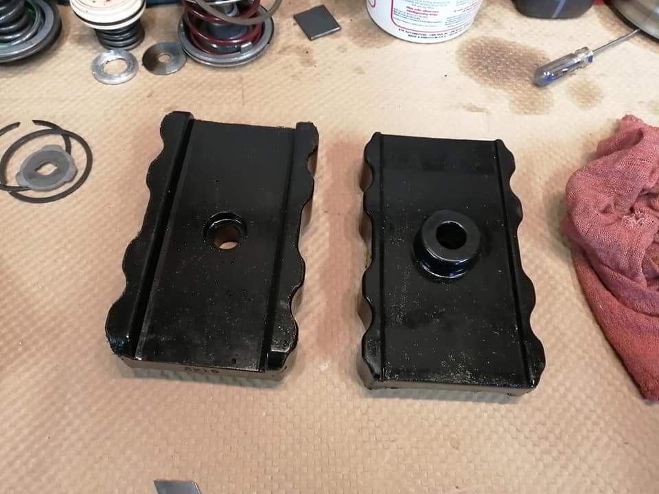

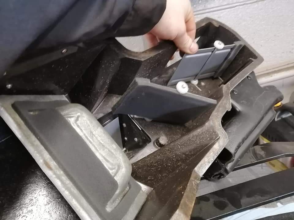

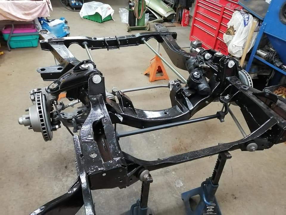

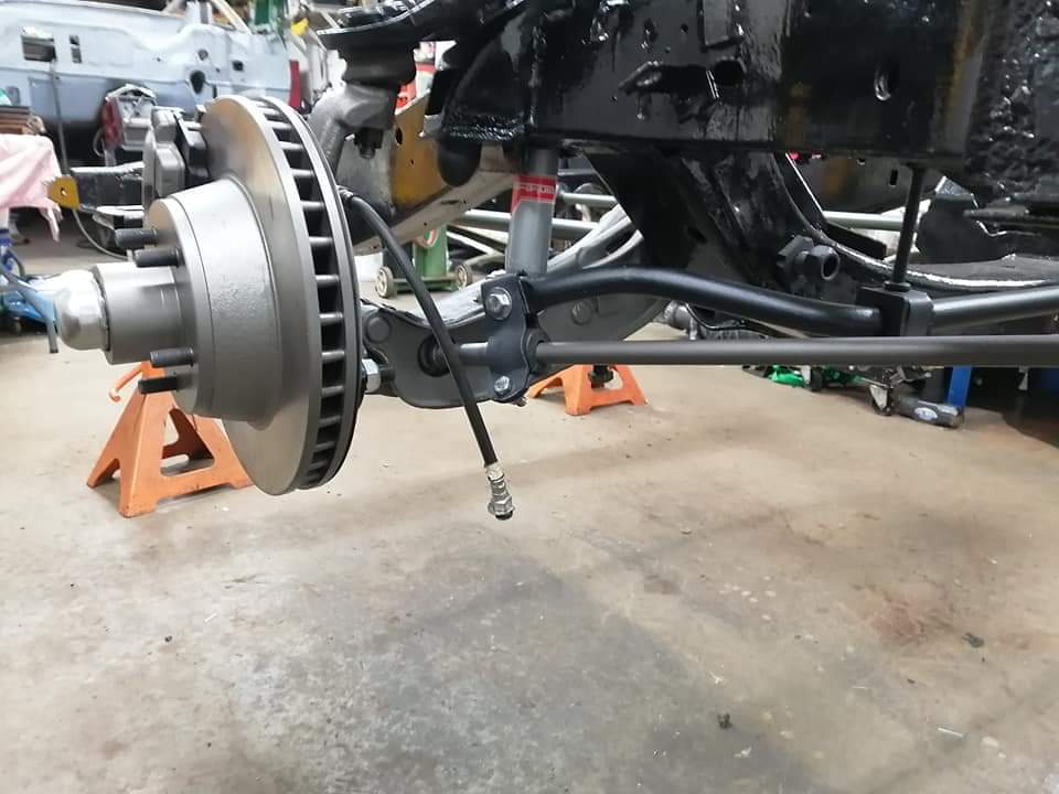

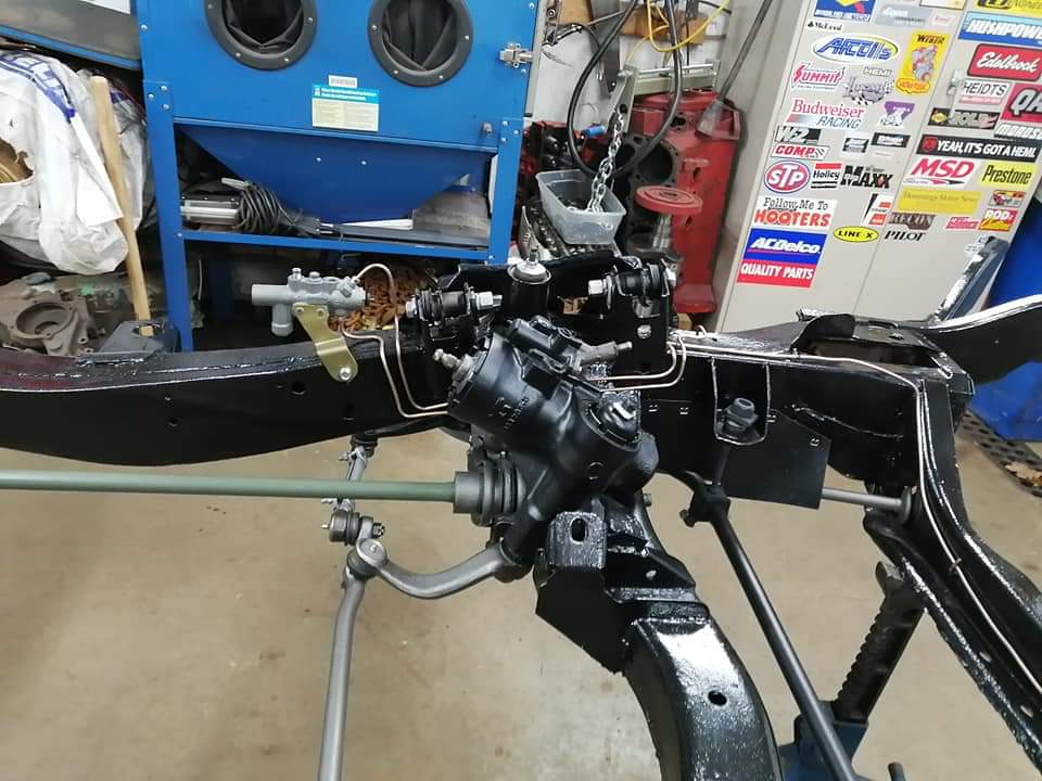

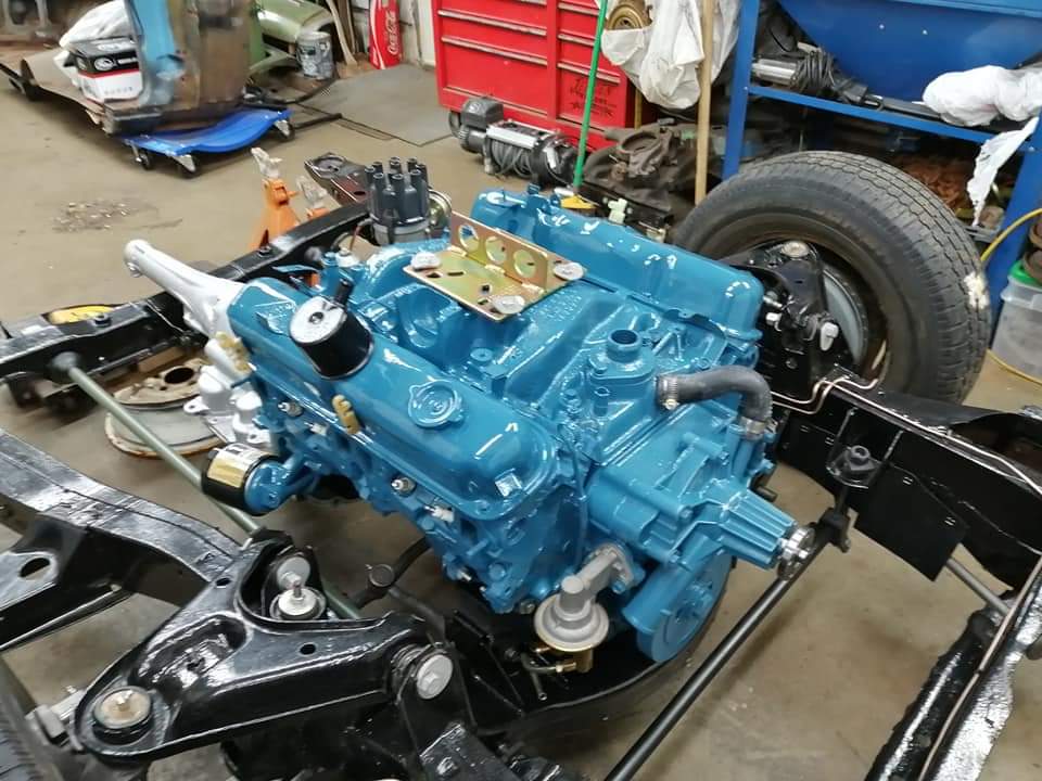

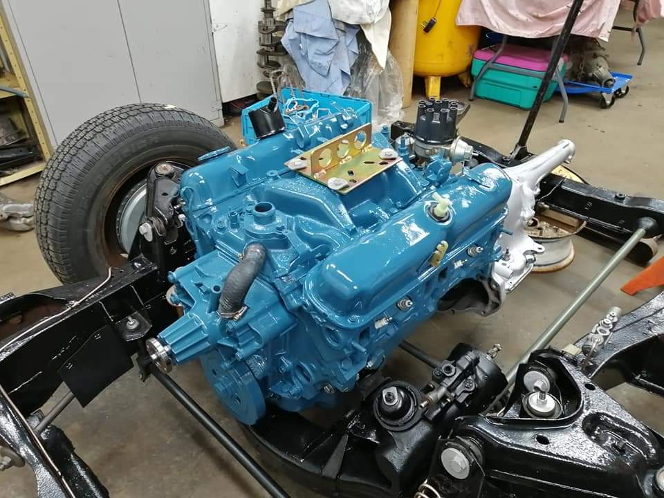

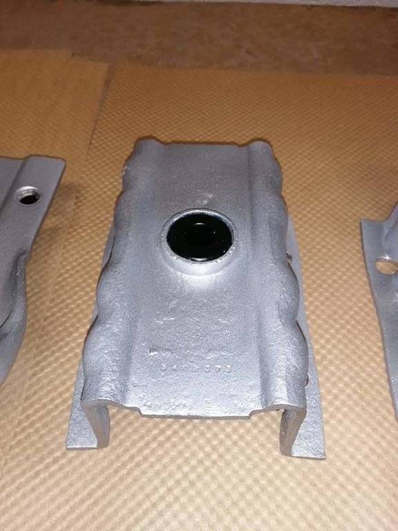

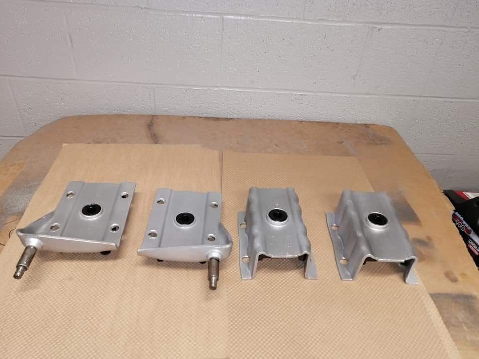

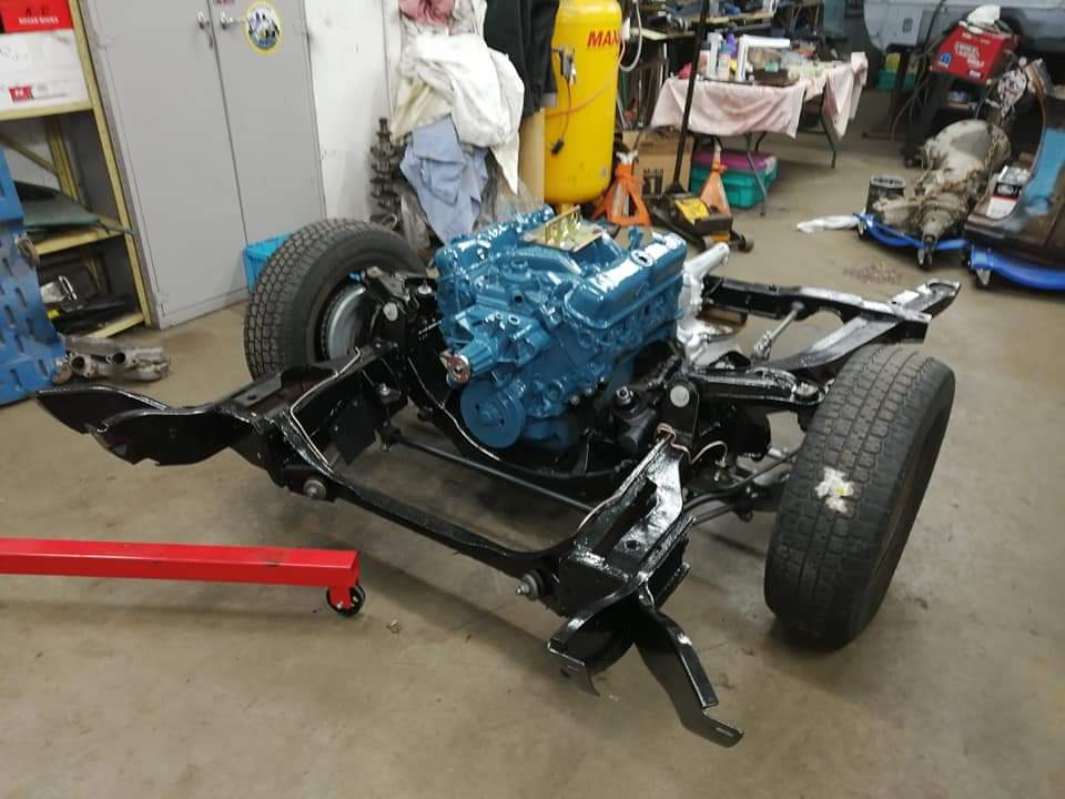

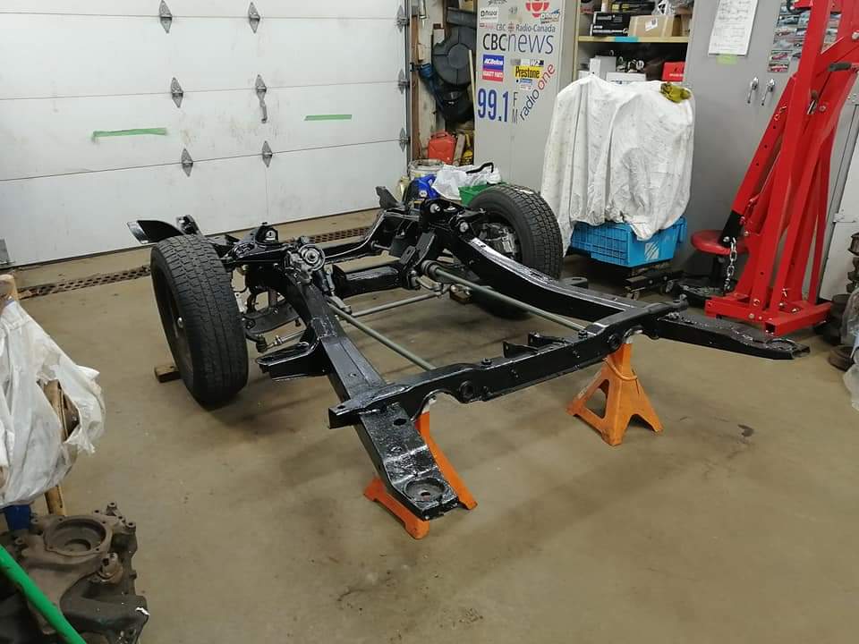

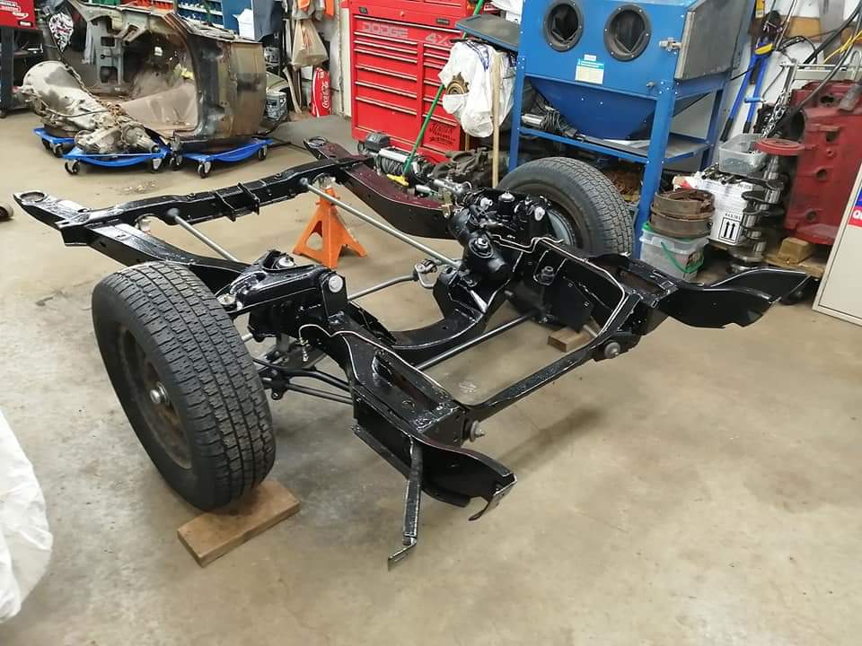

Nick,Where did you buy the isolator rubbeers?? I need a set for the Waygun. Thanks!Here's a neat find, I took a chance.... And didn't **** my pants.... This time...

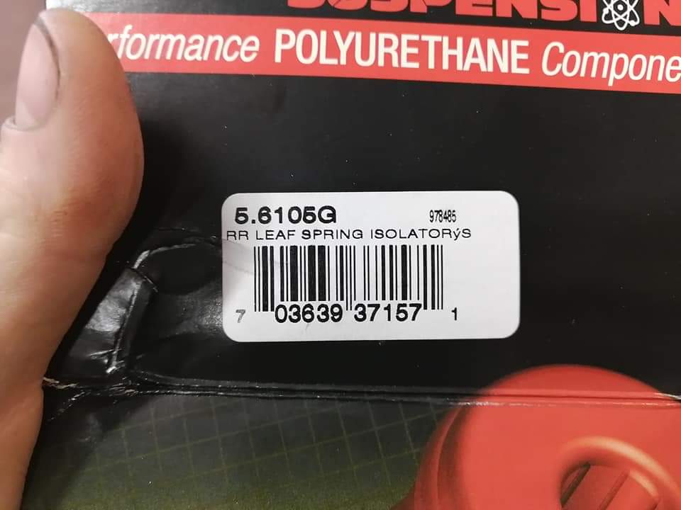

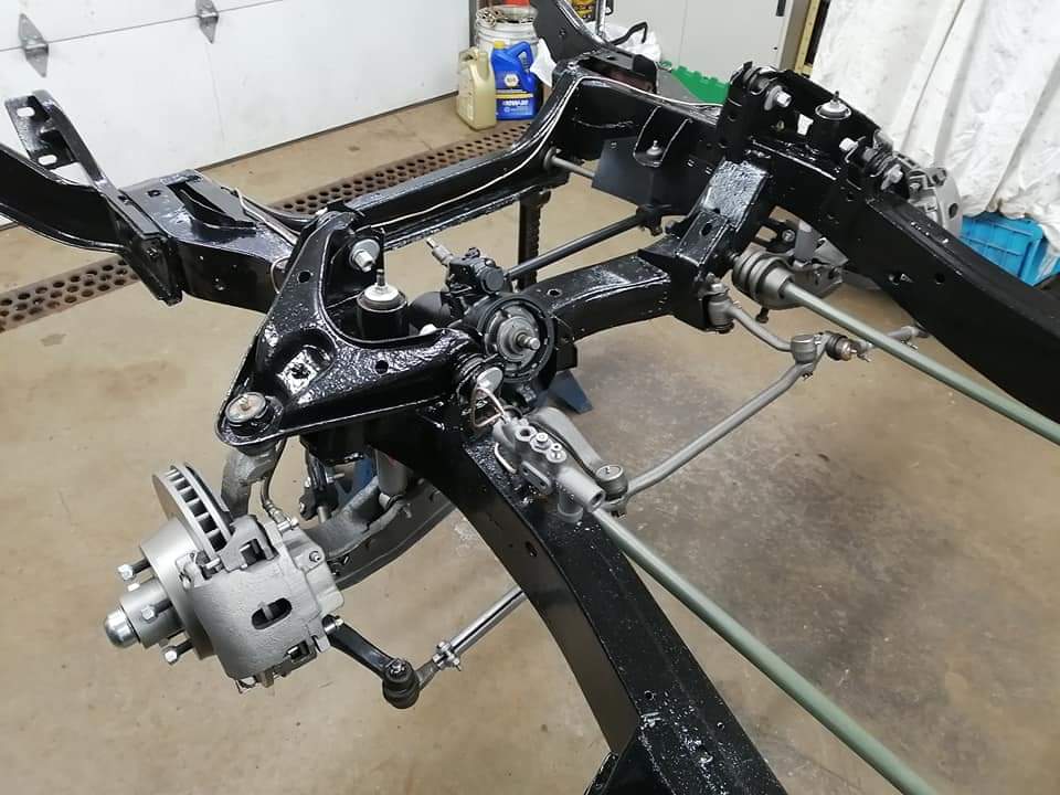

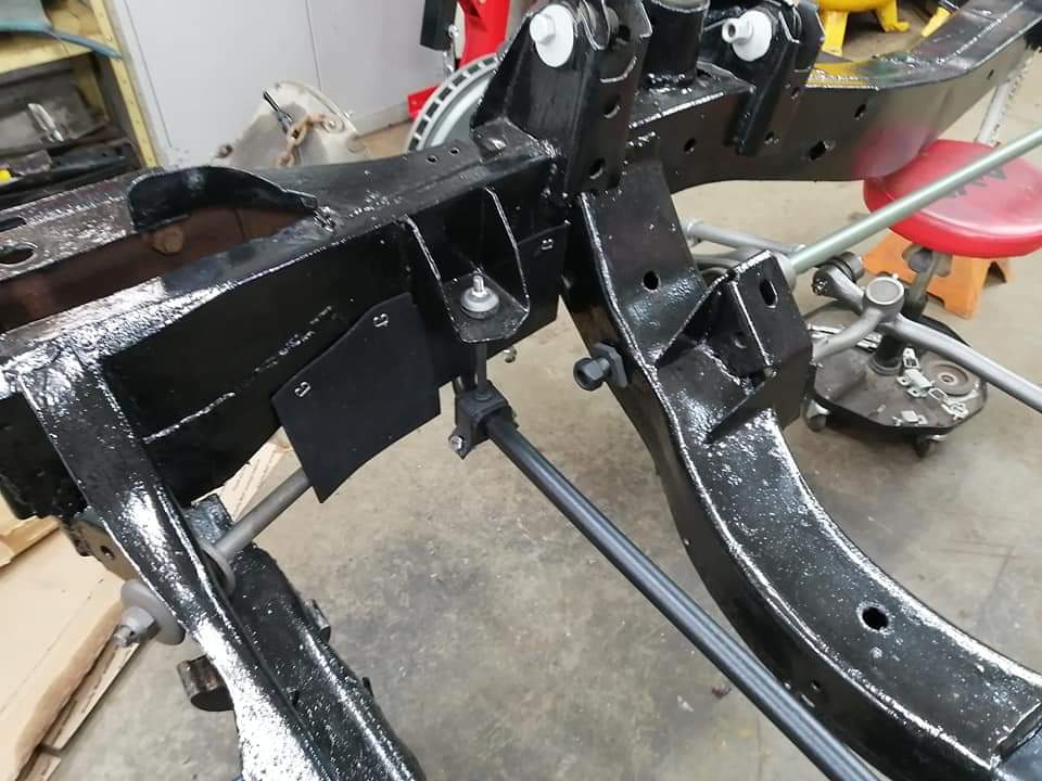

Energy suspension makes a set of polyurethane ISO bushings marketed for the 73/74 B/E crowd, quick reference of my parts book showed that 73 B body and C body ISO rubbers were the same P/N.... So I took the $100 chance... Sure enough, perfect, firmer ride, deteriorated rubber replaced and no loss of ride quality by doing the complete delete...
View attachment 360494 View attachment 360495 View attachment 360496 View attachment 360497

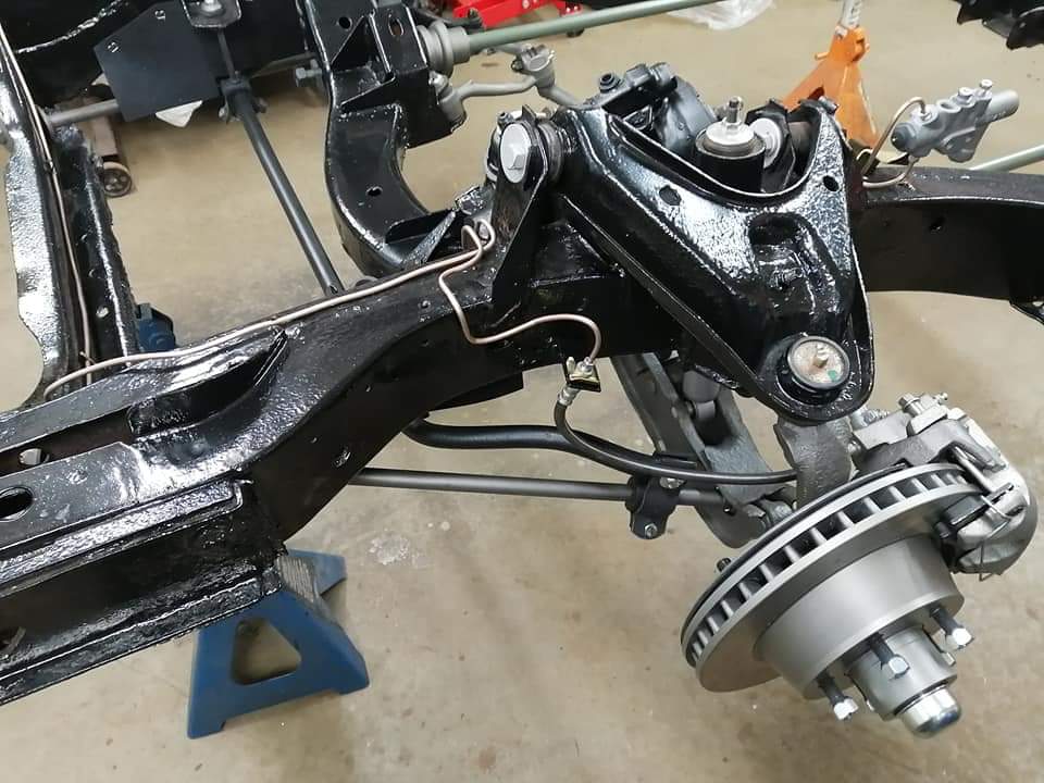

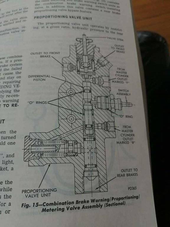

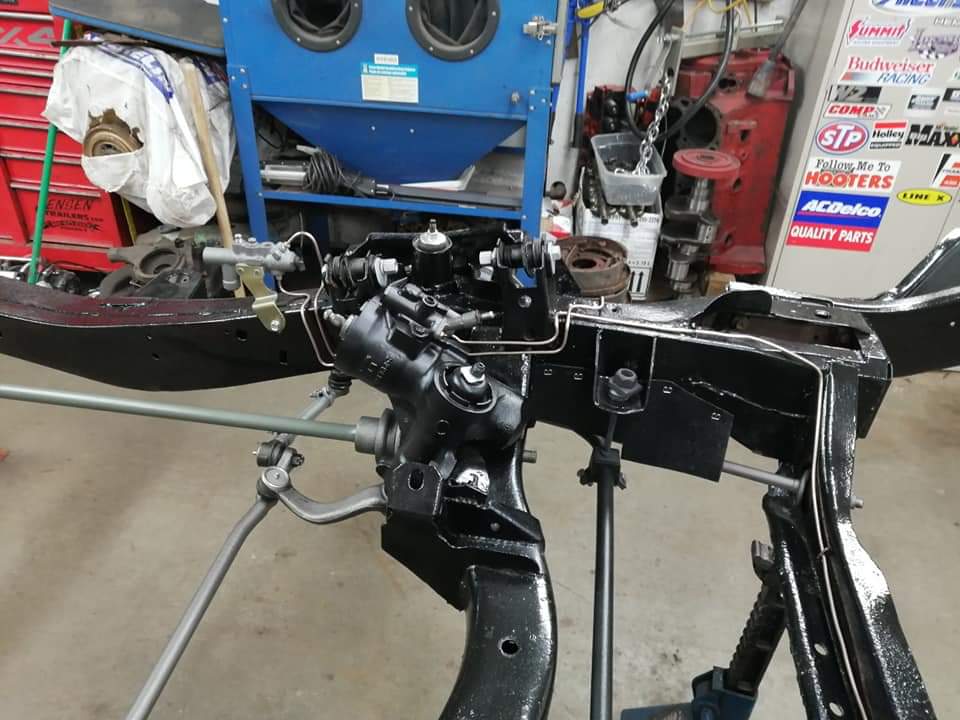

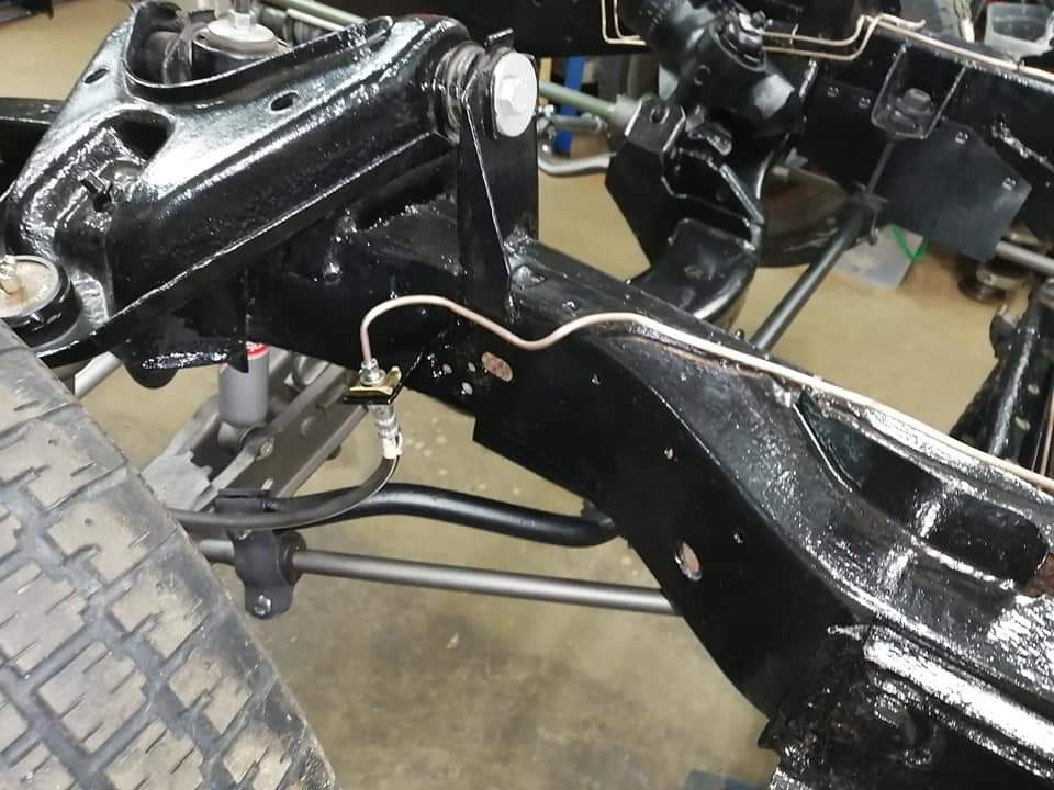

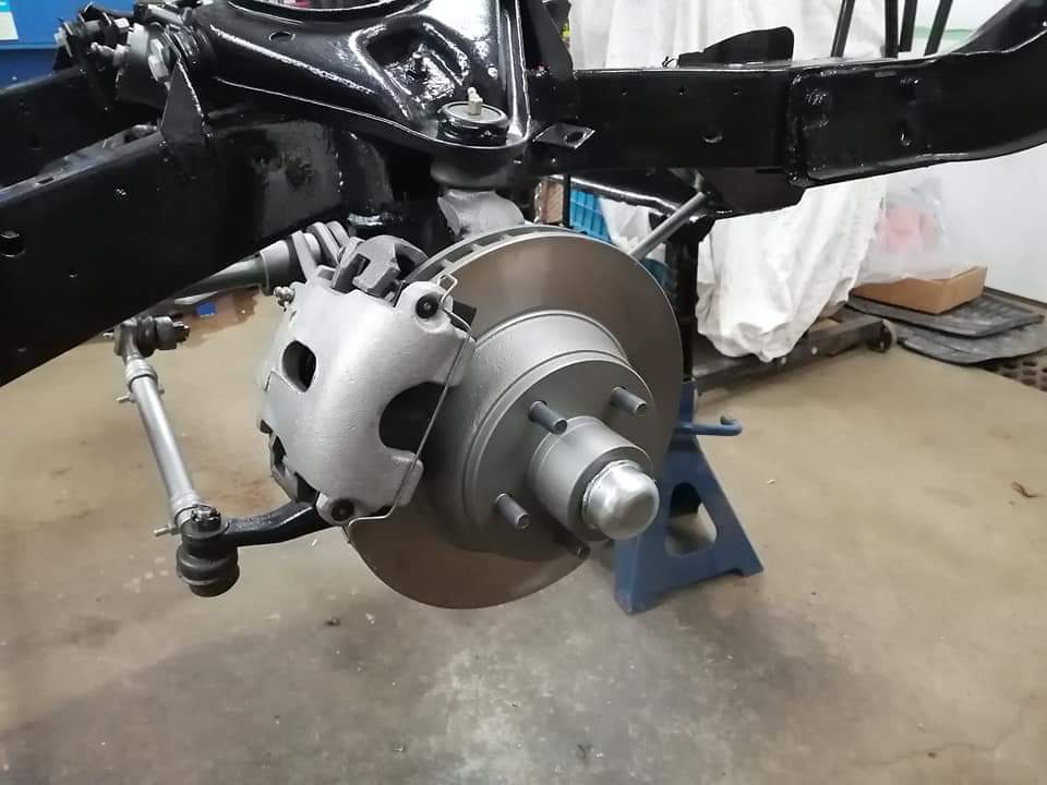

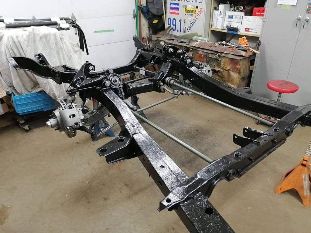

Time to plumb it up.... I take great pleasure in running lines, my customers always comment about how OE they look.... My own stuff is no exception.... I love the NiCAD line also, it's expensive, but IMHO worth it....
View attachment 360502 View attachment 360503 View attachment 360504 View attachment 360505 View attachment 360506 View attachment 360507

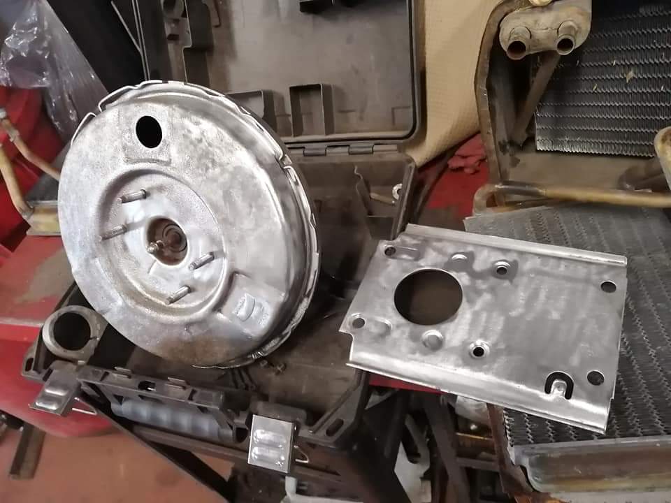

I'd also like to note that the prop valve is now in its correct location, not bolted to the damn inner fender.....
