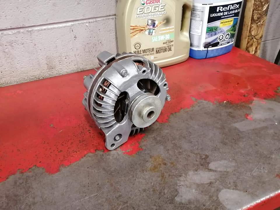

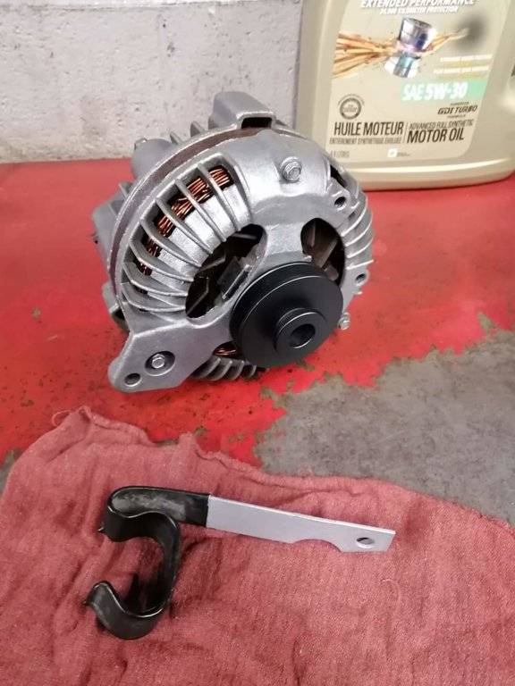

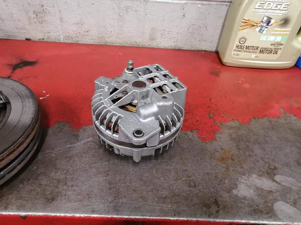

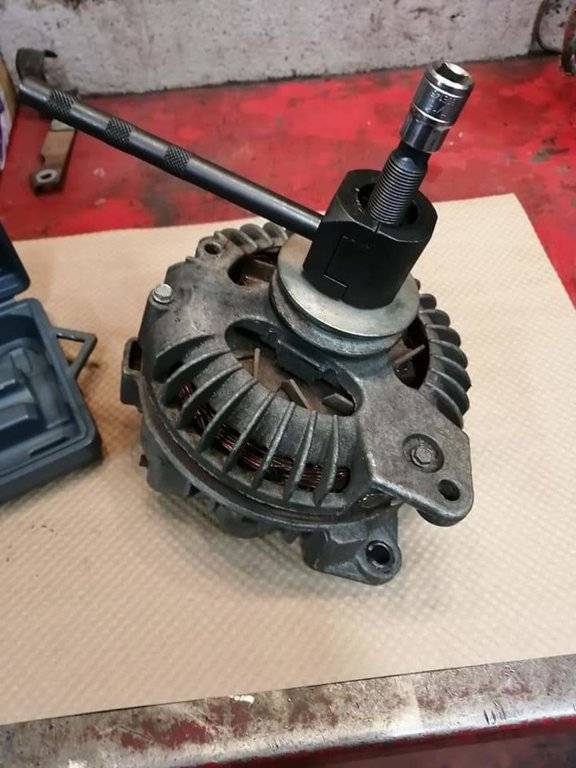

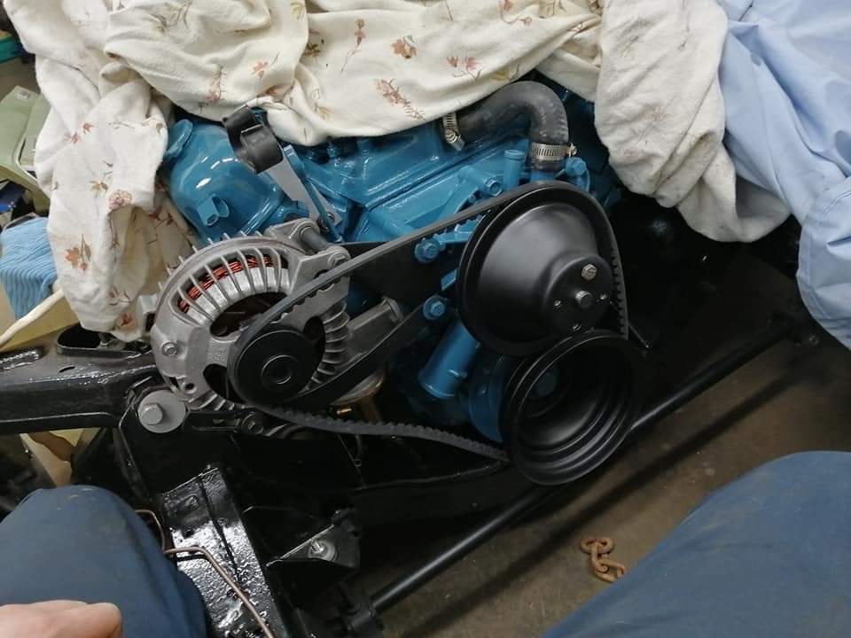

The heater hose bracket didn't seem right to me, so back to my spares cabinets and drawers I went, I found another that seemed more correct, I took it and a squareback alt I had that was on my ragtop when I bought it, to work with me. I know this alternator was a fairly recent rebuilt at that time, and has been in dry storage since.
I took it apart, cleaned winding, brushes and Armature, and freshened it up a bit. I also cleaned up and painted the bracket.

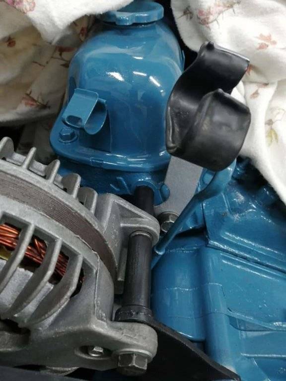

After dinner I put the alternator on (loosely for now) and swapped the heater hose support brackets.
View attachment 362956 View attachment 362957 View attachment 362958 View attachment 362959
View attachment 362960 View attachment 362961

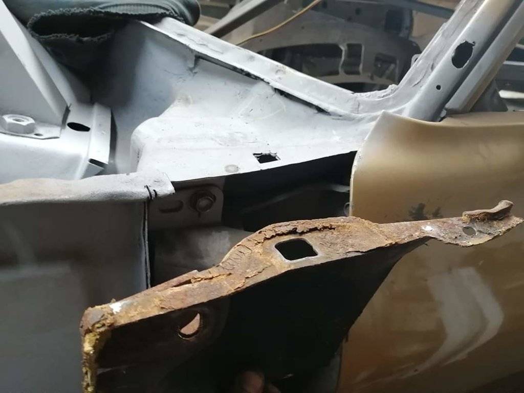

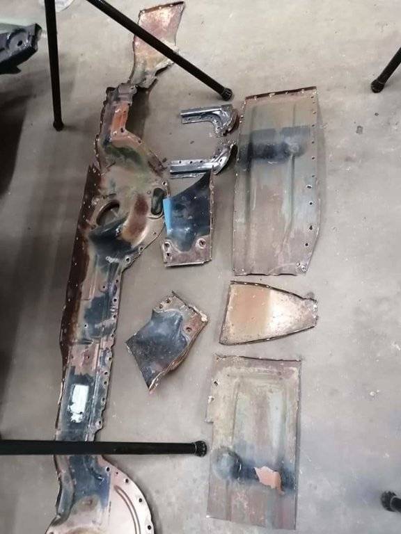

Wednesday after work I started picking away at my donor pieces, I started with the brackets I need to fix the one side of the trunk..... More on that when I get to it....

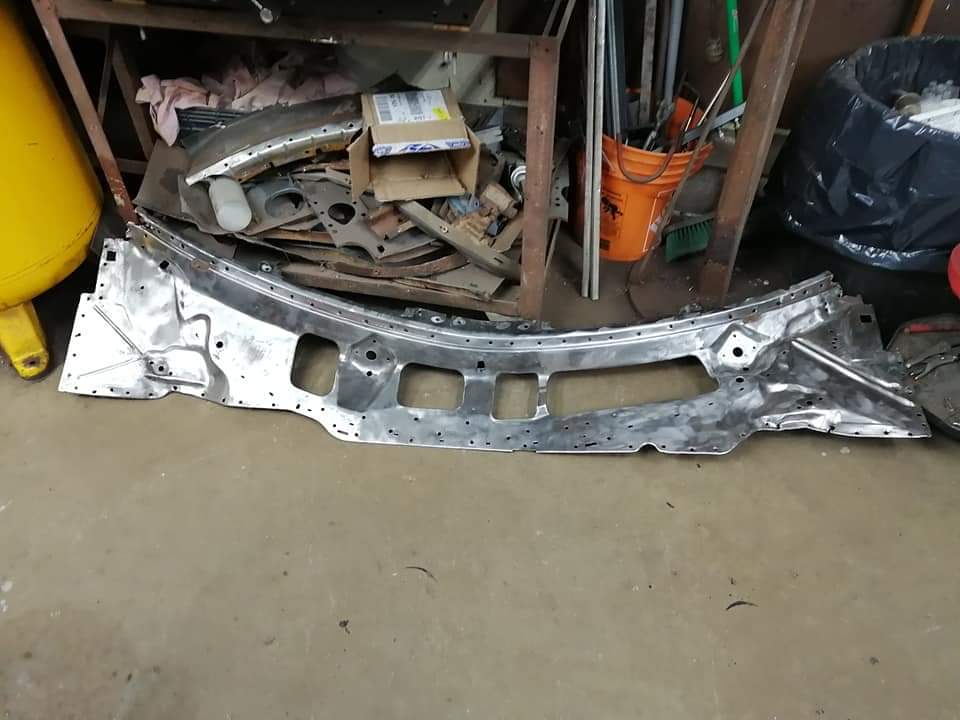

Then I stripped the donor firewall top, it's pretty decent for a Canadian car.. 109 spot welds hold it on...
