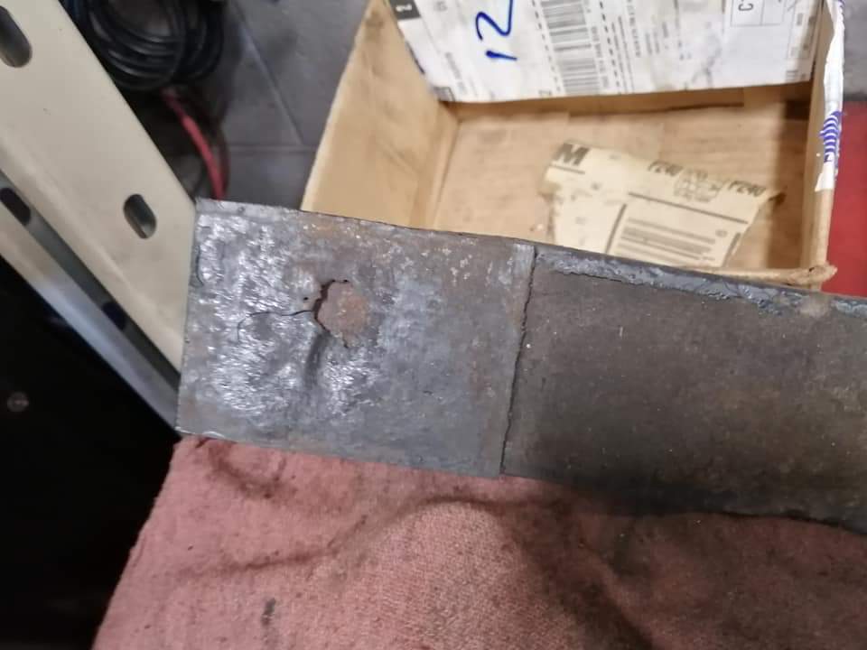

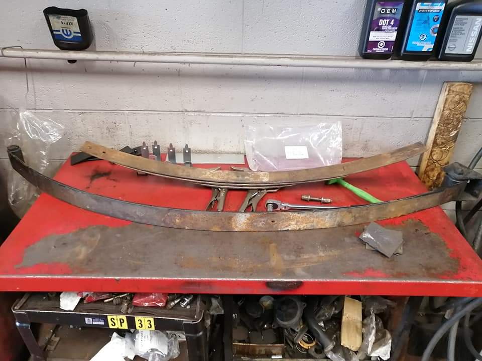

Today's time filler.... Rebuild my leaf springs.
I had these springs re-arched in 2017, and a leaf added, I test fitted them and they were Way too high, the headlights would be pointing at the road in front of the bumper only, soooooo
I pulled the extra leaf, and when I did I noticed the plastics were worn. I started researching if there was anything I could do, I find out there was a kit available, quite a few places have it, but the best price on it was from Mancini in Detroit.

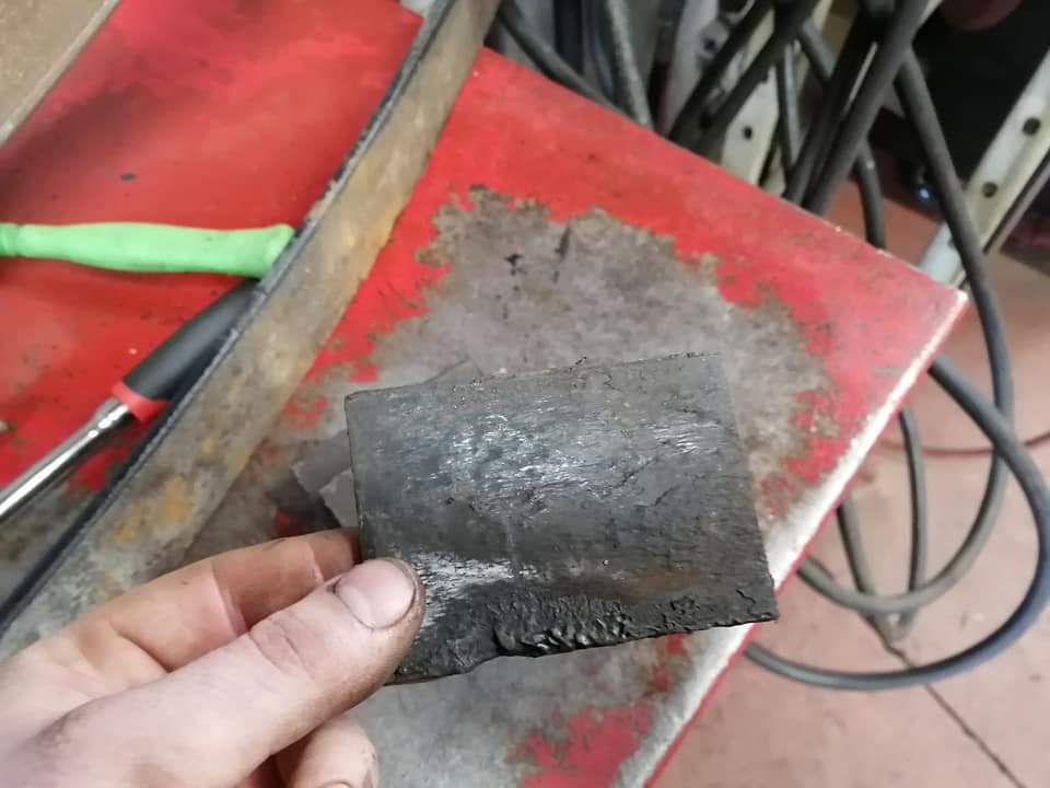

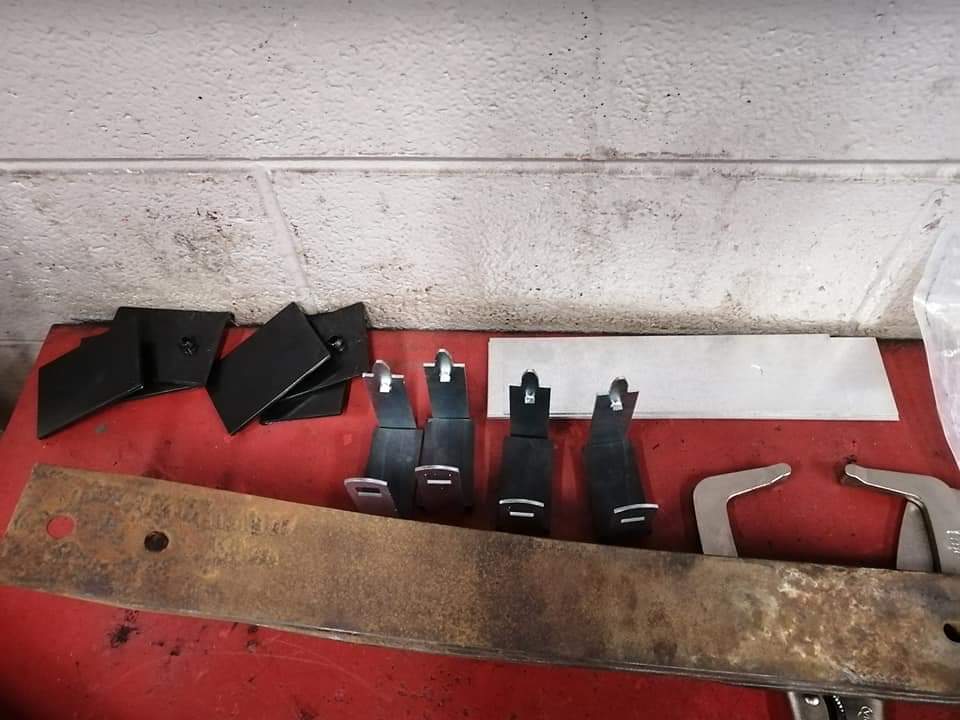

So today I pulled them apart and they were worse then I had thought, the zinc plates are completely gone, and the plastics are shot.
I forgot to bring my new bushings (front and rear), so I'll have to do them tomorrow.

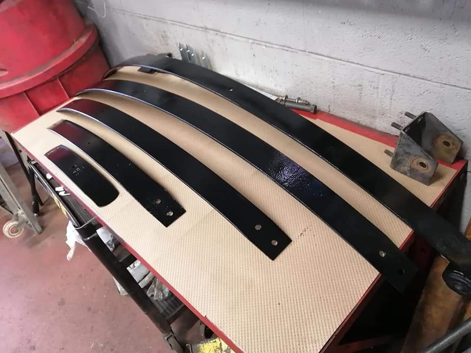

I'm going to paint them with a epoxy based chassis paint.

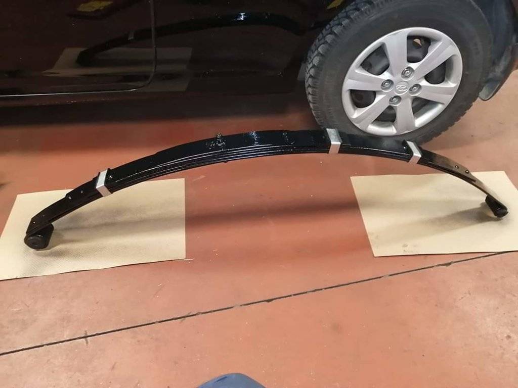

Cleaned and painted
Reassembled this morning after curing over night. Forgot the damn bushings at home again.
View attachment 363932 View attachment 363933 View attachment 363934 View attachment 363935 View attachment 363936 View attachment 363937
Cleaned and painted

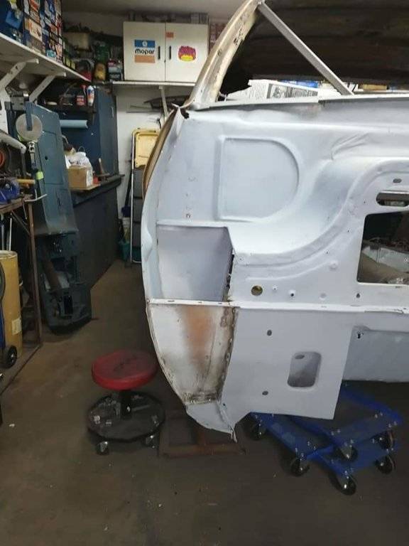

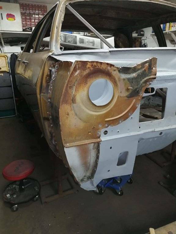

Last night I split all the donor panels after drilling those spot welds, then I cleaned the paint off my repair section for the cowl top.
Fitted it and Welded it in, so the collision damage is now gone.

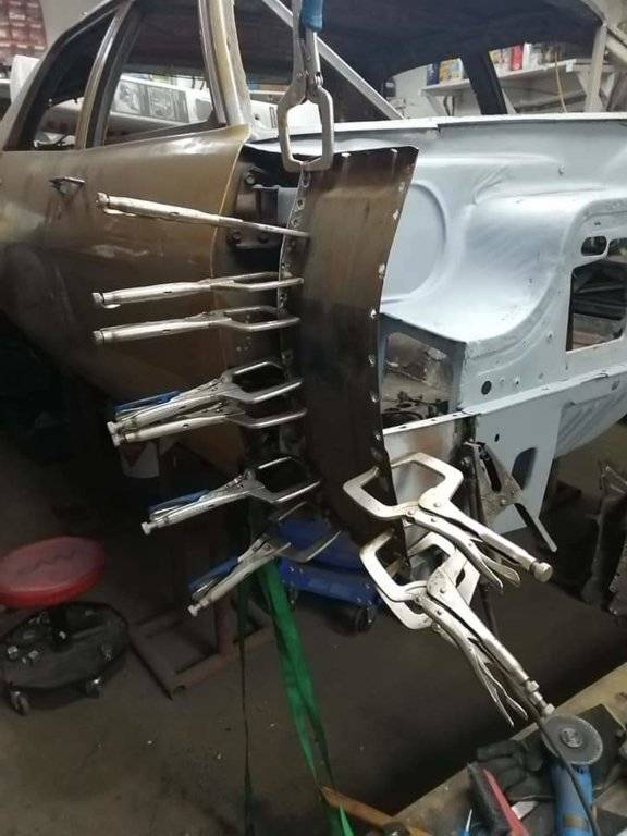

Plato once said "Necessity is the mother of invention."........... Turns out with the car up on the stands I can't reach the top of the firewall...so I used a few left over 8 foot boards left over from the old car trailer deck...
It's time to start attacking this firewall if I want to get this car back on all 4's...

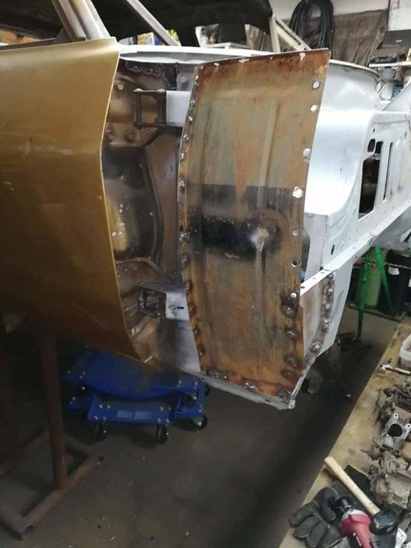

I removed more rotten metal.... Turns out the guy welding on the bottom of the side panel in Newark blew through the rocker panel...
I've got it all cleaned up, I just need to remove the upper portion I plug welded... I'm not overly happy with the other plug welds either, so I'll Deal with them also, plus I have the kick panel to deal with...
I was able this morning to get the spring mostly together before my electrical skills were required to figure out why the lights in the garden center were not working....
I should buy stocks in Irwin....
Got it all welded up tonight, I'll make the welds looks pretty tomorrow, it's nice and rock solid now, so that makes me happy..
Popped on a heater box panel for fun.

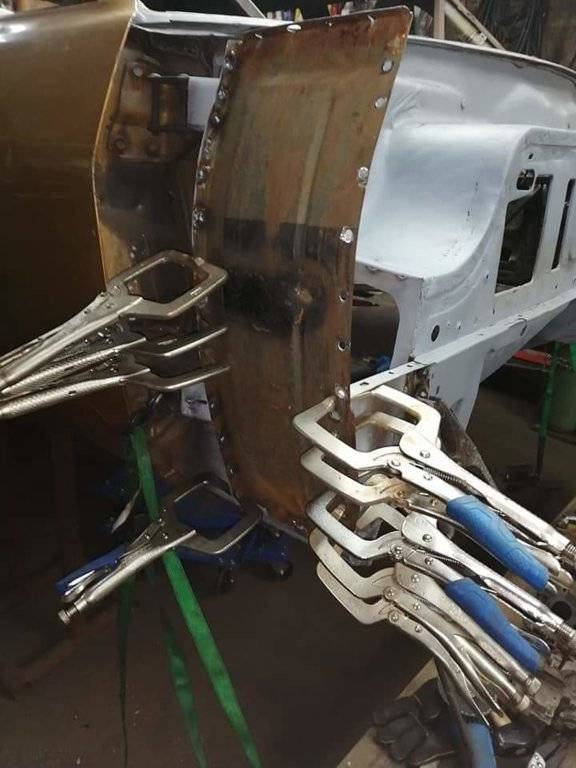

View attachment 366513 View attachment 366514 View attachment 366515 View attachment 366516
View attachment 366517 View attachment 366518
