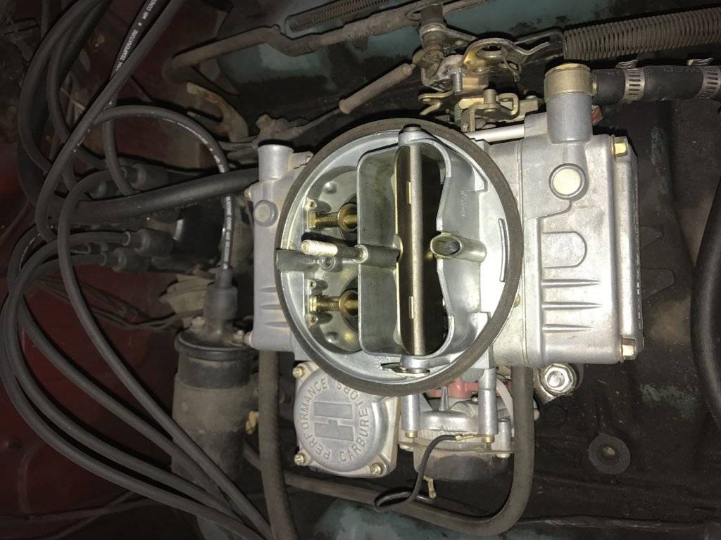

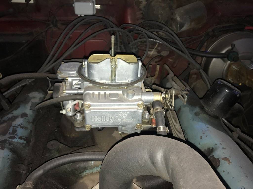

Mr Rock. You can do the whole swap for next to nothing. I'm running a Holley 600 vacuum secondary ( the Rodney Dangerfield of Holleys ) on my 69 318 fury. It has dual glass packs and I'm running points with my stock rebuilt alternator (60 amp I think). I've had a pertronix " jiffy pop " under the cap before and I'll just stick with points. Anyway the edelbrock is pure bolt on, 5 or 600 it won't make much difference with a 318. The Holley is same deal but harder to set up if you're not familiar with the float bowl best idle vs vacuum etc etc. the carter/edelbrock has metering rods , think of them as long goofy jets. They take two seconds to change. We used a specific set to pass emissions in az without changing anything but the metering rods. The Holley you have to crack open to fool with so go with the edelbrock if you don't want to mess with jets. You get better mileage and crisper response with the Holley but you gotta set it up for that.
If you really want to give it a shot buy a good two to four barrel adapter and bolt that sucker on. This way your not committed if you want to turn back. The linkage adapters are sold where the carbs are. They are Ford and mopar specific. You can Jimmie your throttle cable to work. It'll reach but you might have to bend the hold down up a bit. If the cable just won't work measure its shortcoming and an old school bike shop can lengthen your accelerator cable way cheaper than buying a new one. A high perf 289 air cleaner will work great and are dirt cheep ($25 swap meet fair) until you find that oval grabber air cleaner I know you want.

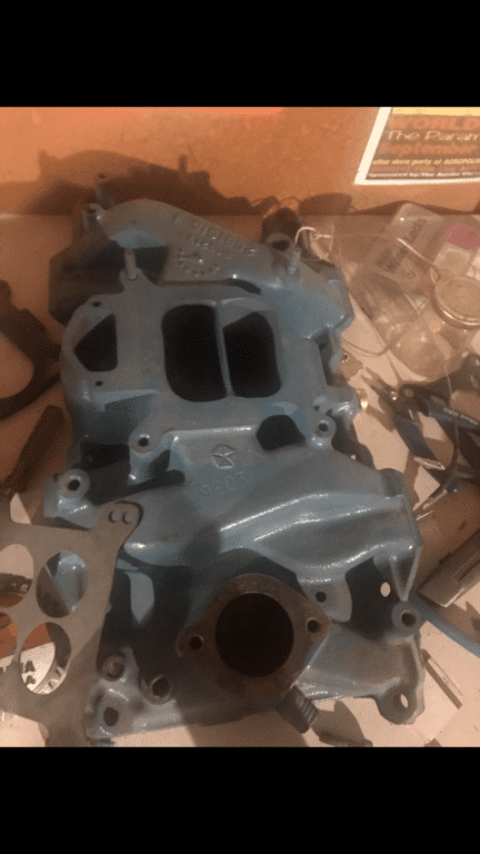

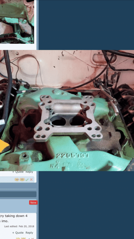

If you like how it works go intake shopping. Everyone who responded is correct you ain't gonna wind up with a race car. Do not buy a LD340 or a torker. Your best bet is a cast iron (non corroded!!!) 340 intake. Aluminum intakes are always for sale for a reason... it's dark outside I'll send some pics in the sunlight tomorrow. I've been doing 318s -trucks and 340s in everything else (c bodies too ) since 1983. Your whole project should be easy & fun and you'll never get into the secondaries with a two barrel !!!
Intake is a nice cast iron with the top cut out. I put a gasket on it so you get a look at how uncut stock will look vs mine.

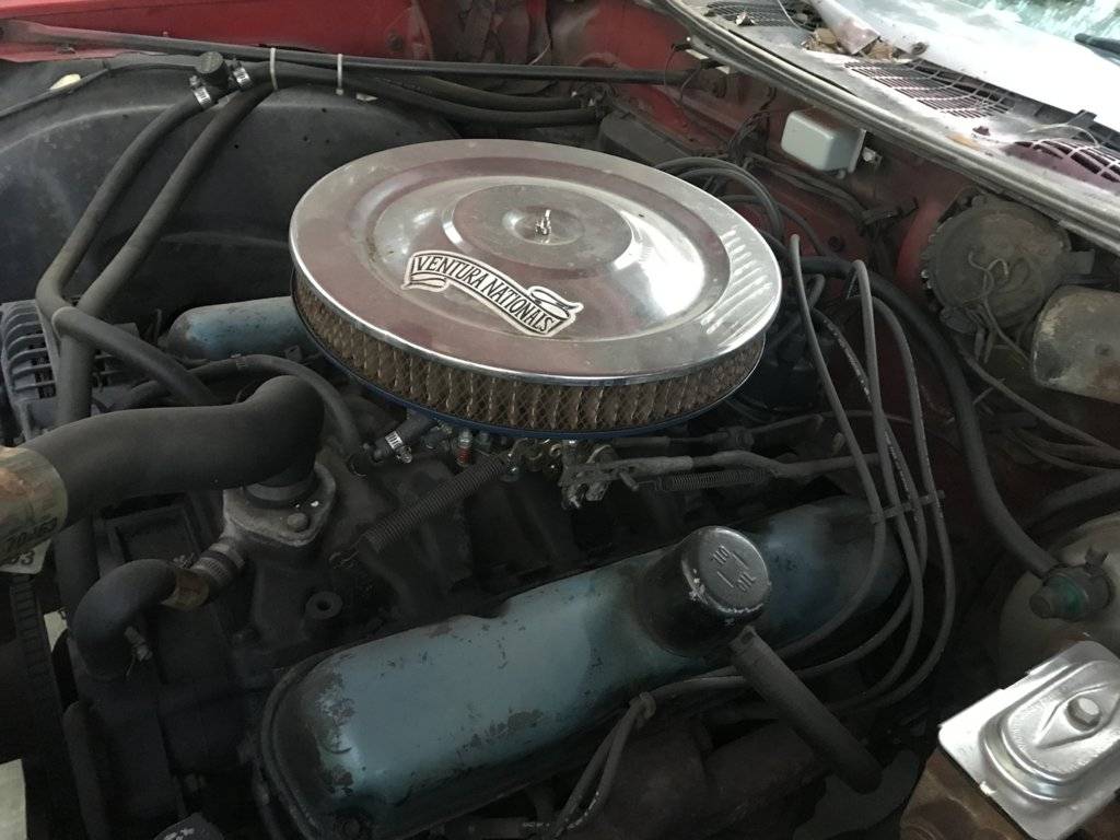

I haven't swapped the intake because it's run so good I just haven't bothered. I gotta put the car on our steam rack at work because the valve covers leaked oil for the last 20 years and the motor is a burnt tarry mess. After that I'll intake swap. If you've done the brakes suspension and under hood electrics then your ready to reward yourself with a little bump in horse power you can seat of the pants feel.
Here are my pics please forgive the grungy engine. The hoods never open except to check fluids now and again. I'll post pics when it's detailed. Orange or blue? A question for the ages !!!

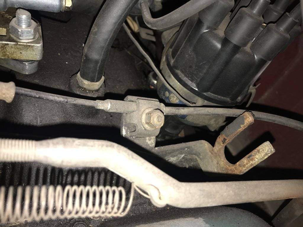

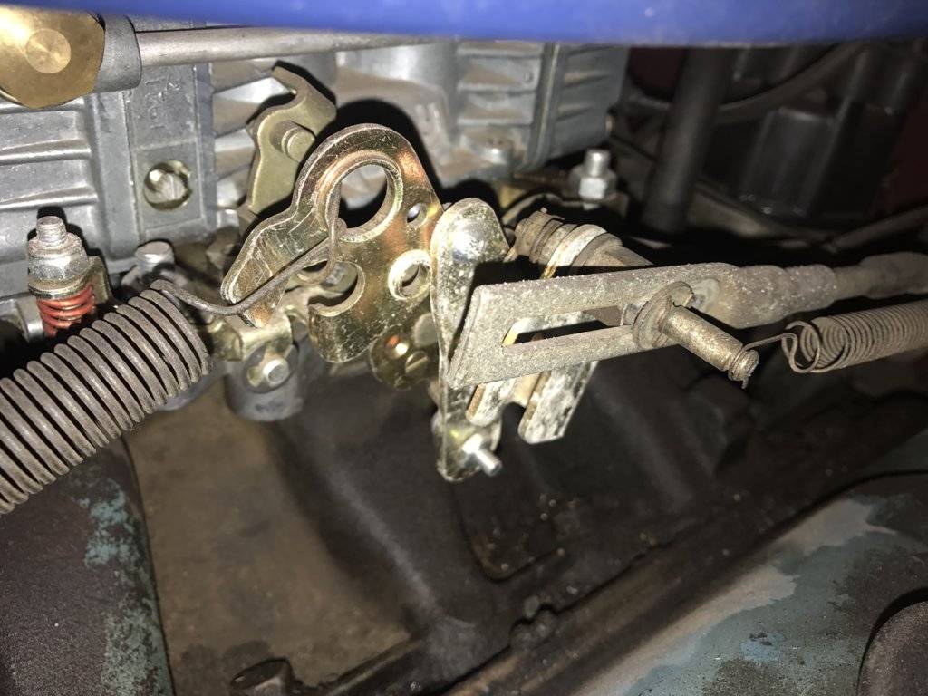

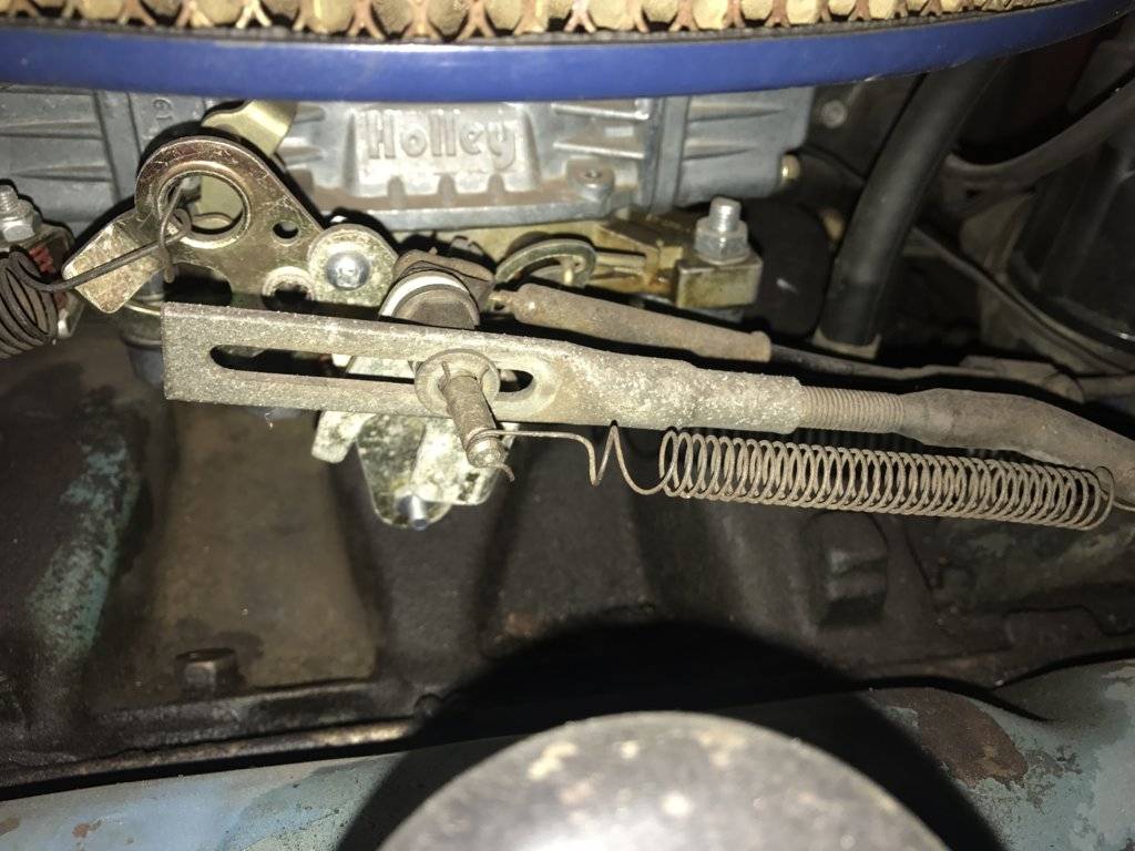

Here is the mopar linkage adapter they are ford and mopar specific. Edelbrock and Holley adapters don't interchange they are brand specific.
Choke is ziptied dead. Don't use it out here in SoCal. You can see with the correct adapter all kick down stuff works and is kosher. Neglect this at your transmission's peril.
