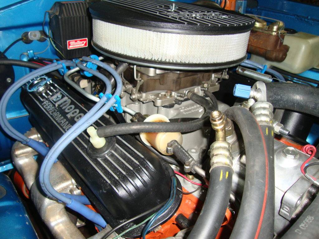

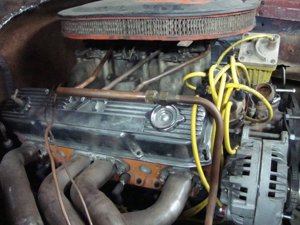

Here is my current fuel line set up.

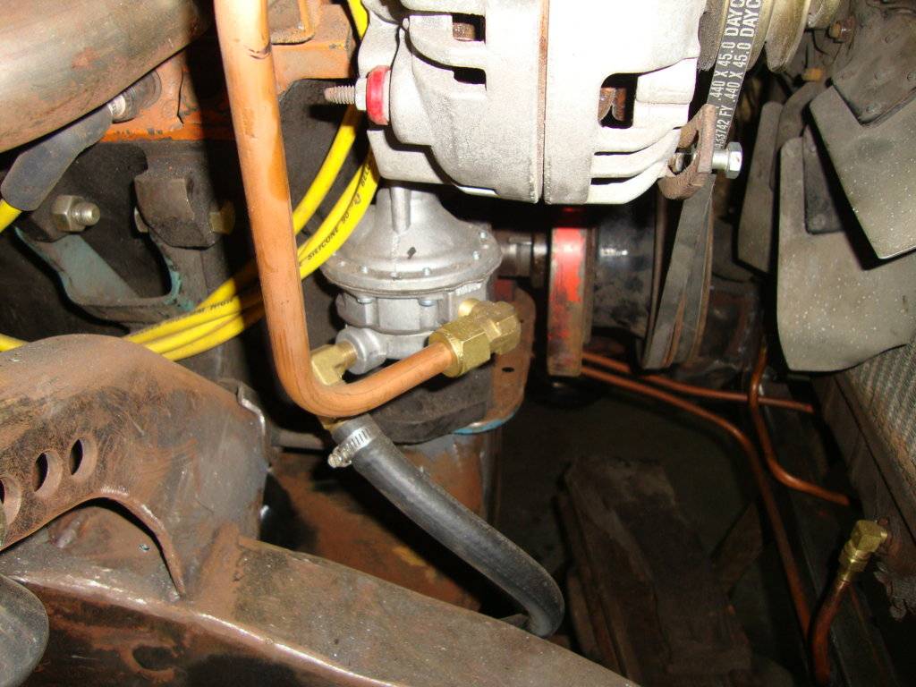

hows this one , you guys can run what fuel lines you like , some are just better then others . i've never had an engine fuel fire with metal or teflon , i can not say the same for my rubber hose setup , once that happen with full rubber runs . i've never gone that way again . and most ss braided lines are rubber under that sheath of ss braid , ss braid on teflon works very well . my methods can be a bit out there , away from the heat . this system has a large fram can type filter at the frame hosed end , copper back to the tank as well .

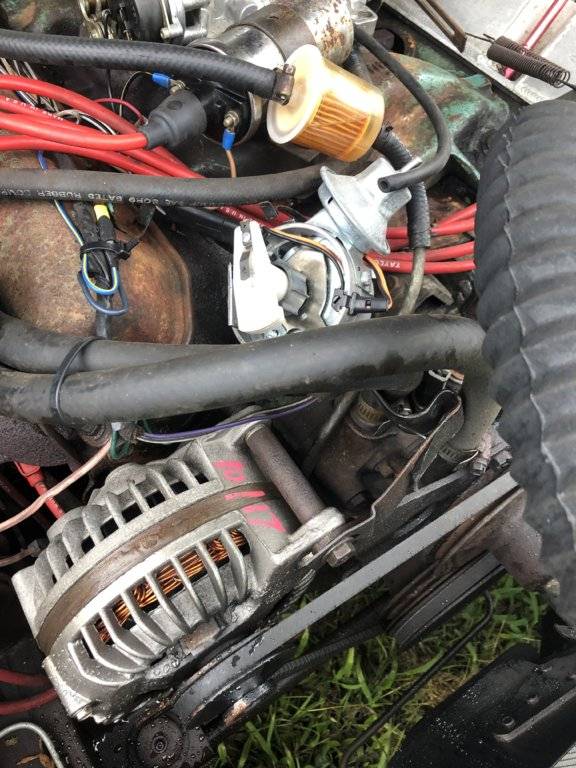

rebuilt the carb and added an insulator gasket. Took the car for a ride for about 20mins. When I got back home this is what the carb was doing.....
This is what was going on at the fuel filter...
And then about 10-15 mins later this is the hard start....
I set the float height at 7/8" using a drill bit as the height gauge and the drop was set at 15/16-1". Is this incorrect? What should they be set at?
When you were starting the car after the run, what throttle position were you using?
Reason I ask is that although it might seem to make things worse, with the additional accel pump shot from opening the throttle 1/2 way to start, it also puts more air into the engine to help clear out the over-rich mixture quicker. The Chrysler owner's manual recommends using 1/3 throttle opening for starting and that seemed to work well back then.
The OTHER thing is to make sure the timing is where it needs to be, or even advanced a few degrees more (as long as it doesn't trace rattle on acceleration), for good measure. Using some of the "fine wire" .040" center electrode "quick start" spark plugs might help, too, or the NGK V-Power plugs.
As for the rubber fuel lines replacing metal . . . it's a known fact that ethanol dries-out the rubber hoses, from the inside out. After it "cleans" the inside layer of rubber of its oils, the next layer is the cloth reinforcement layer, THEN that will probably start to seep through the outside layer of rubber, which can then flake off. Therefore, minimize the use of rubber fuel line segments to what Chrysler used. Use metal lines elsewhere . . . or possibly formed plastic (as current lines are).
As for the OEM carb specs . . . they were all designed for back when "gas was gas", not what we have now. So you might need to run the floats at the "minimum" rather than the "maximum" level. It might not cure the percolation, but it might lessen its duration a bit. And you'll probably not notice any difference in performance . . . as long as the fuel pump works right.
