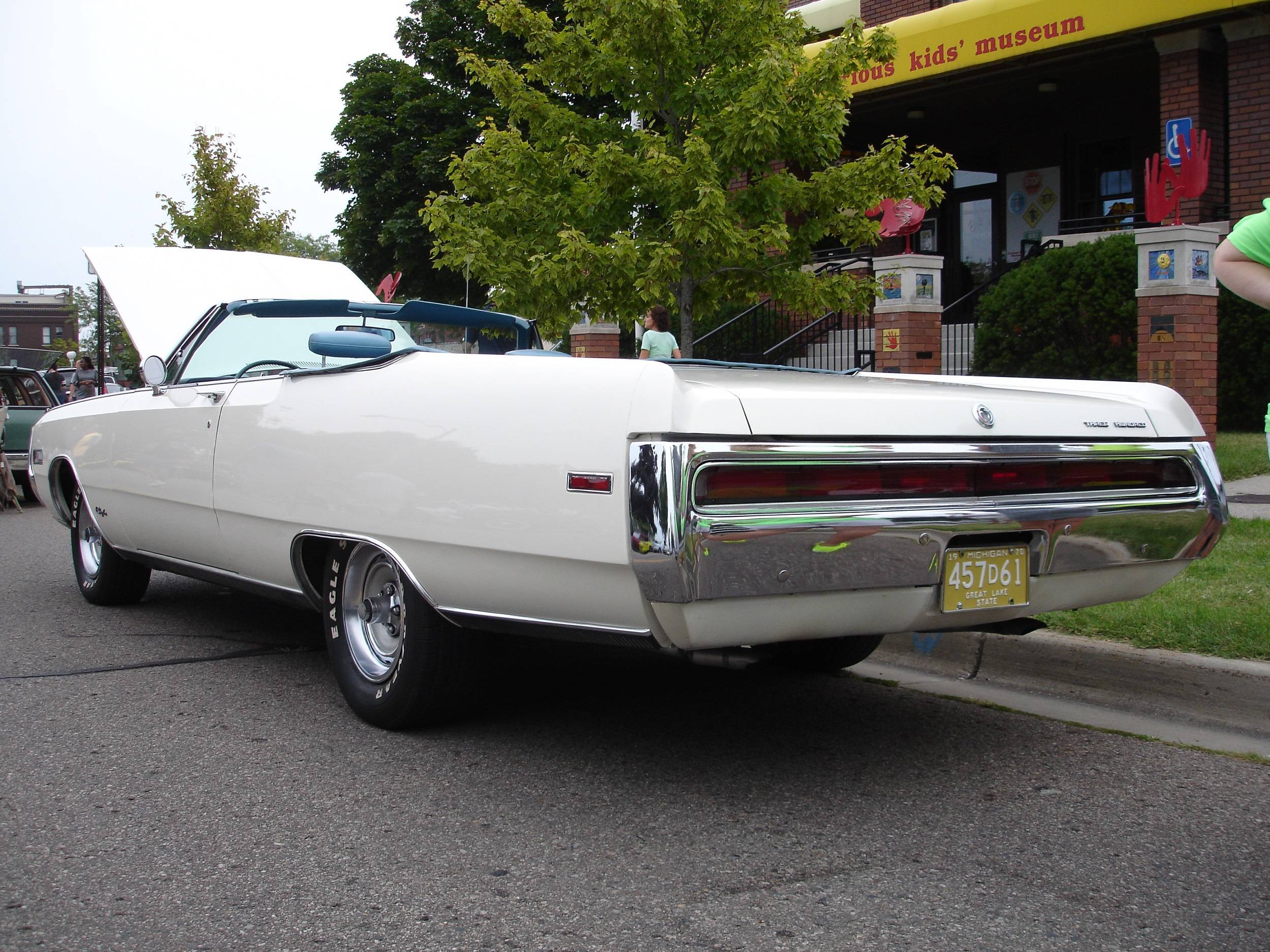

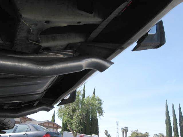

If you're referring to my pics above, the car was originally a single-exhaust car. The right side pipe is in the original position, but is not the original piece. The left-driver side pipe was added by my muffler man. I agree with Stanley, a good shop can make things happen.
They can be seen from behind, but they do not hang low. Nor do they stick out some 6 inches like I've seen on some cars. Personally, I think such looks bad.

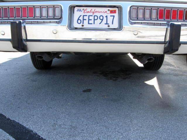

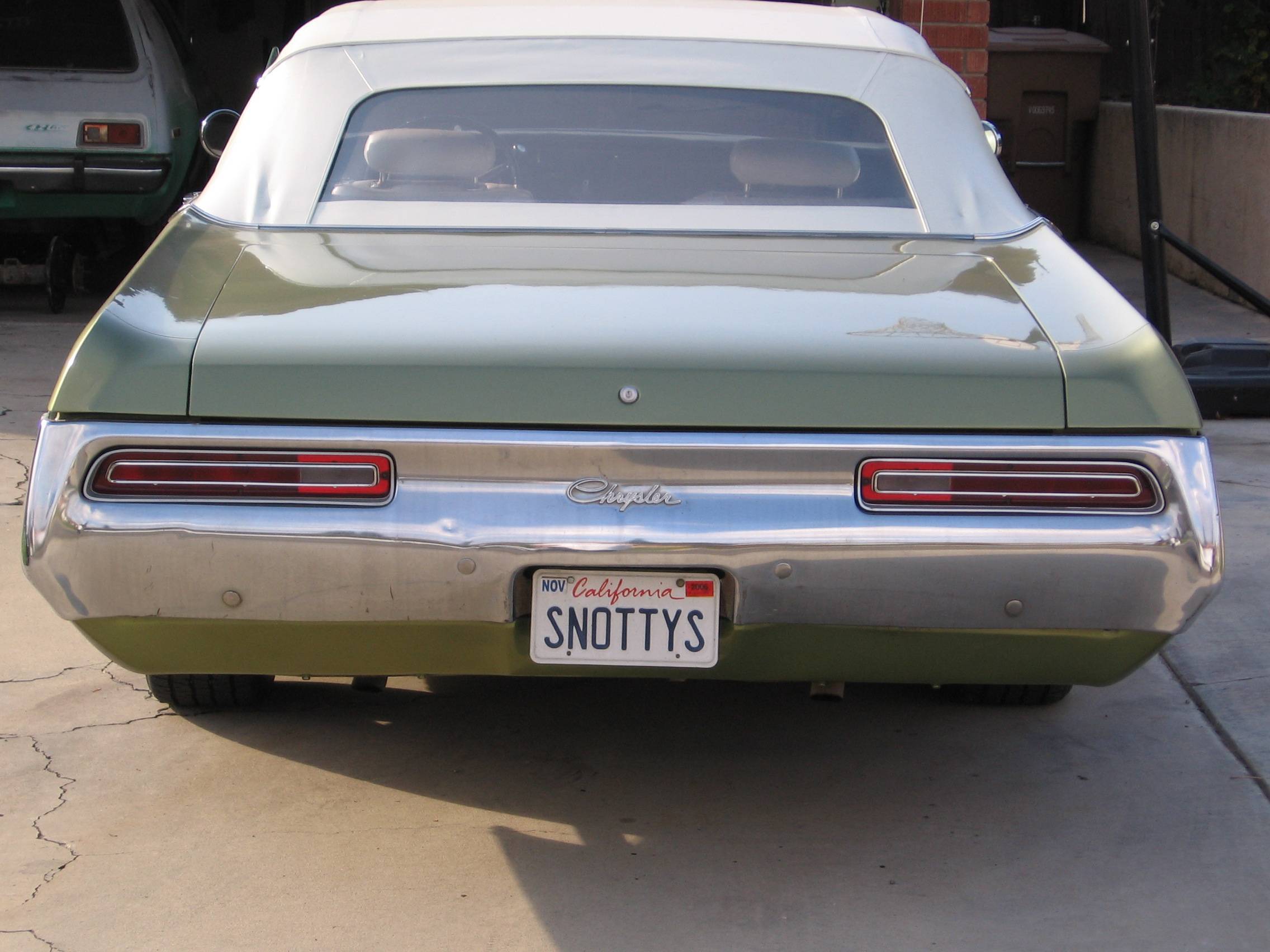

Here is my a picture of my 300. These tailpipes were bent up by Waldron's Exhaust using a set of NOS tailpipes as patterns. Couldn't come up with the correct hangers, so they might hang a little too low.

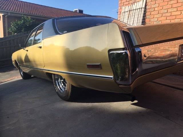

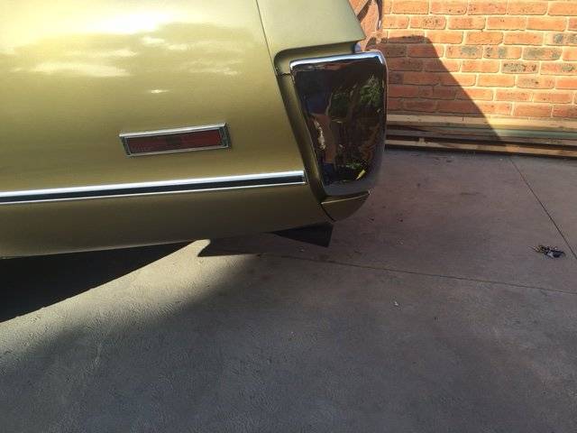

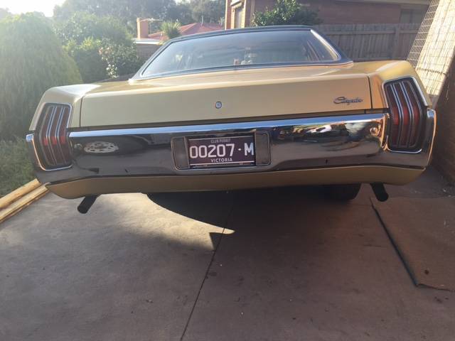

Here are some photos of the finished product Im pretty happy with the result
Sorry about the quality
Rear leaves getting reset an inche or two tomorrow
Love to hear your thoughts

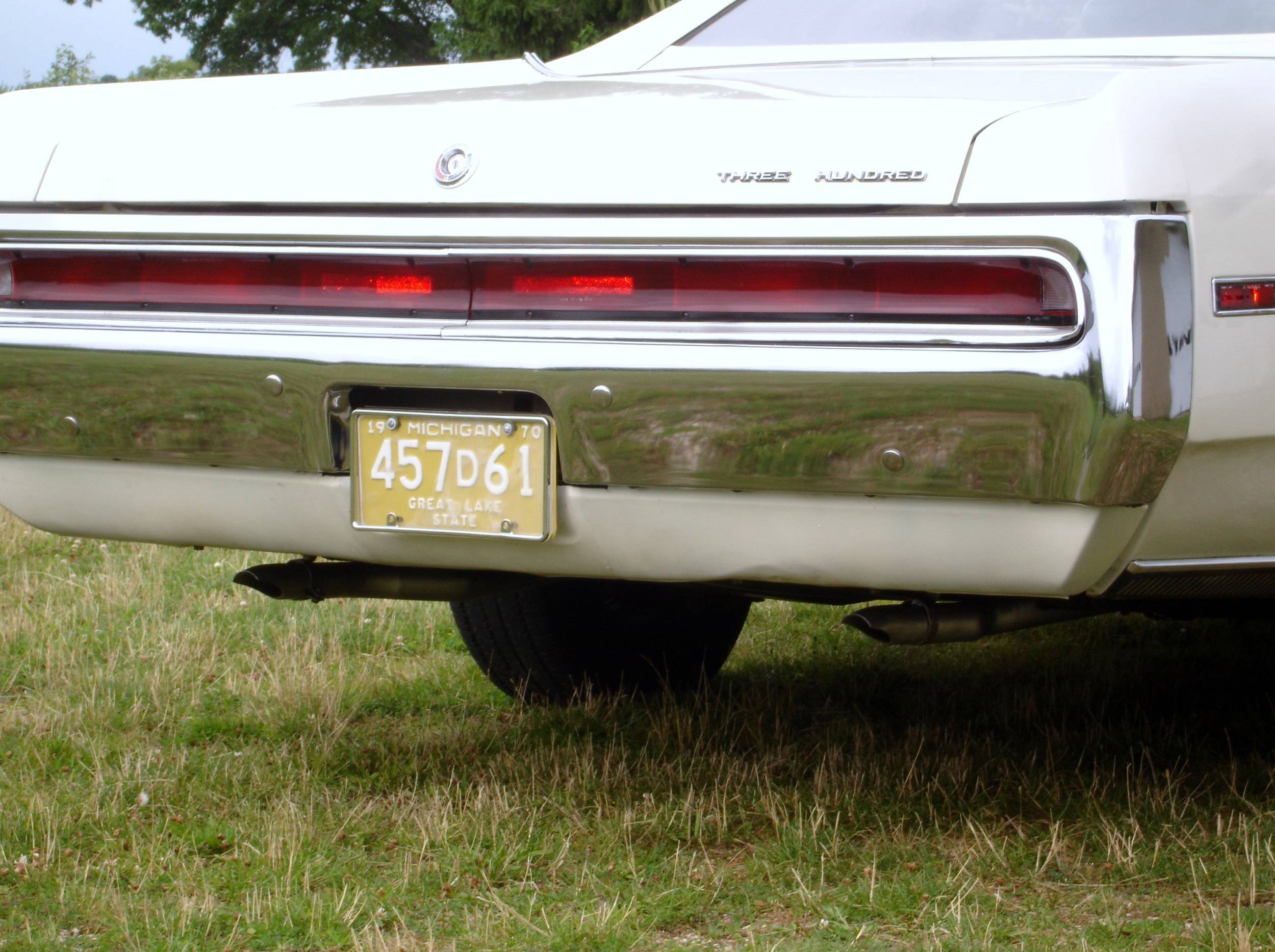

Skip the tips shooting out from under the bumper. It's not a GTX.
The tailpipes should not be seen in a side view of the car and the tips should turn down behind the bumper.

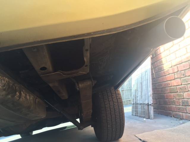

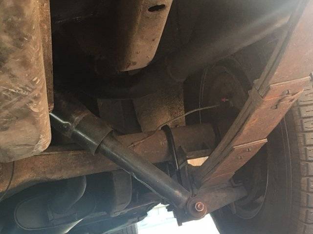

My exhaust. Not sure if original, but it has dual pipes. Yes right side pipe did bend when "dropped" it from trailer. :(
Dont have under pics yet.

I disagree with you Stan. Steve Fogel had dual tips behind his 300 Hurst and I think it looked sharp. "Should" is a loaded word. It's the way you would prefer, but there's no law against anything.

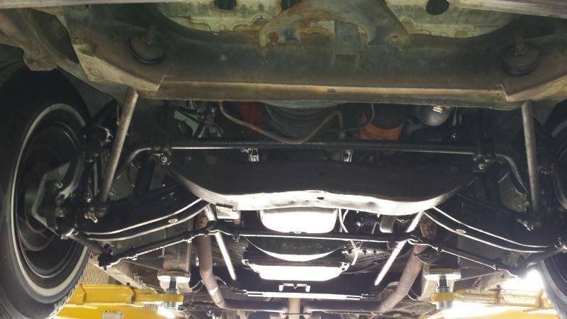

Deeply buried in the past threads. Single to a dual exhaust alongside the fuel tank.

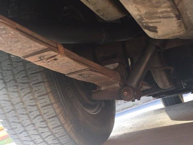

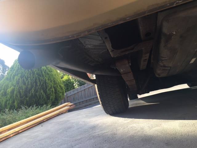

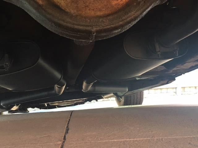

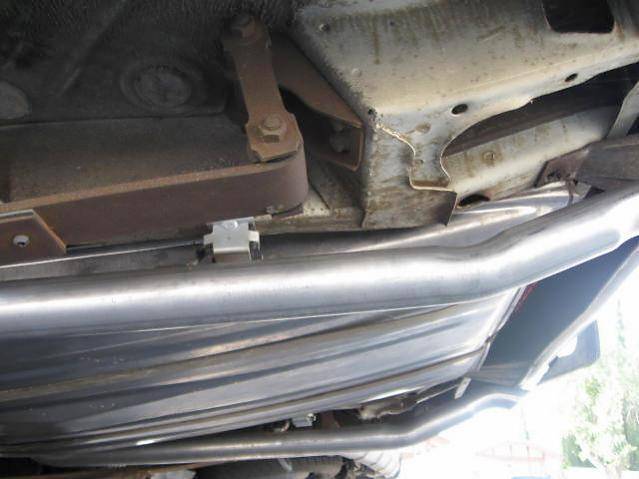

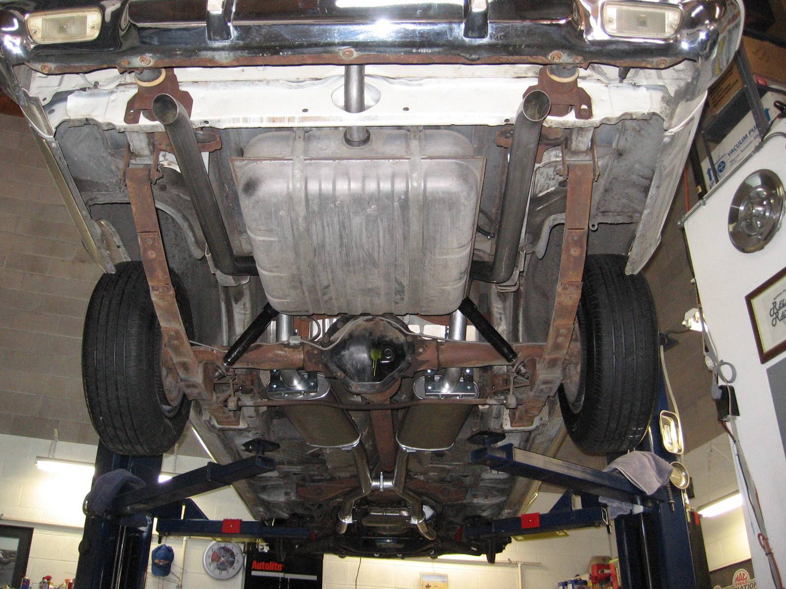

Hey jono67 your system looks fairly good, the only part I don't agree with is the tailpipes crossing over between the rear axle and chassis - this may compromise your suspension travel ( or not ). Maybe just one cadaver in the trunk at a time and no Duke boy stunts eh :)
Yeah the guy that made the system took all that into account and we appear to have plenty of clearance even at full compression
Changed the rear shocks today and the old girl sits level and she looks great
